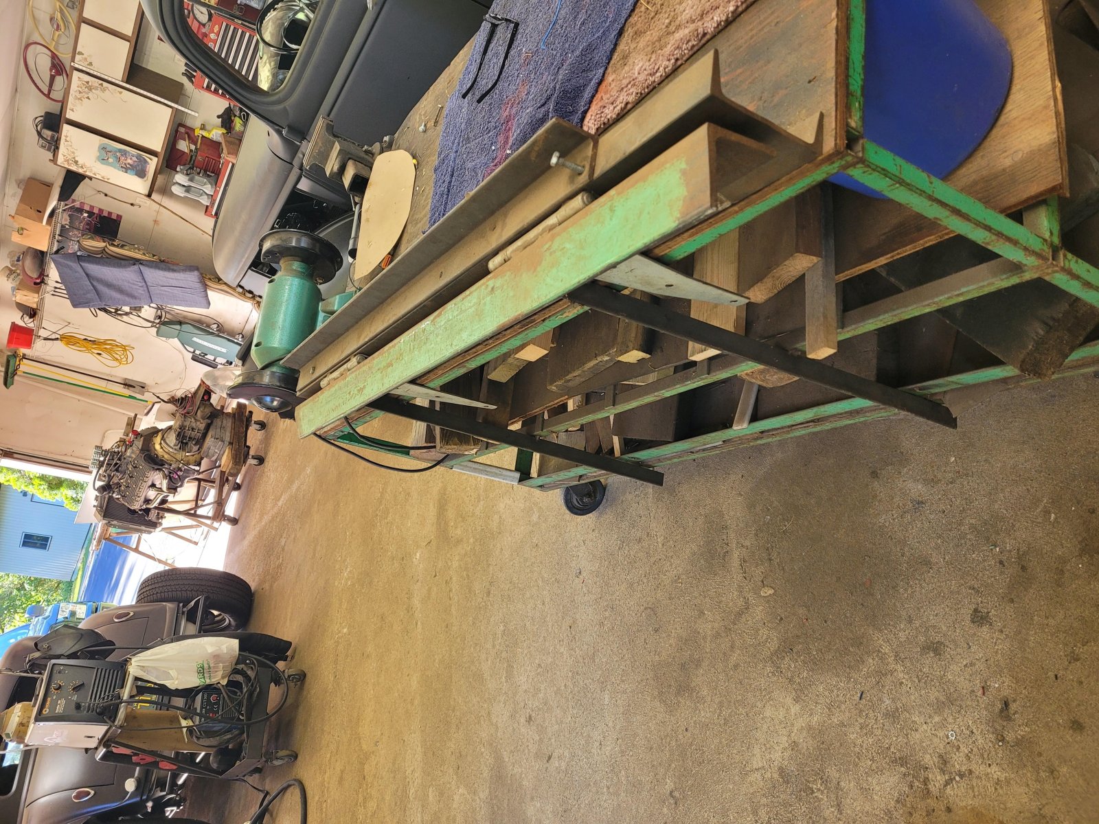

    I whipped up a wheeling machine to make some fenders and widen the tank on my fat bike. The wheels were just some old kart wheels my brother lathed true on a brake lathe at work. It seems to work

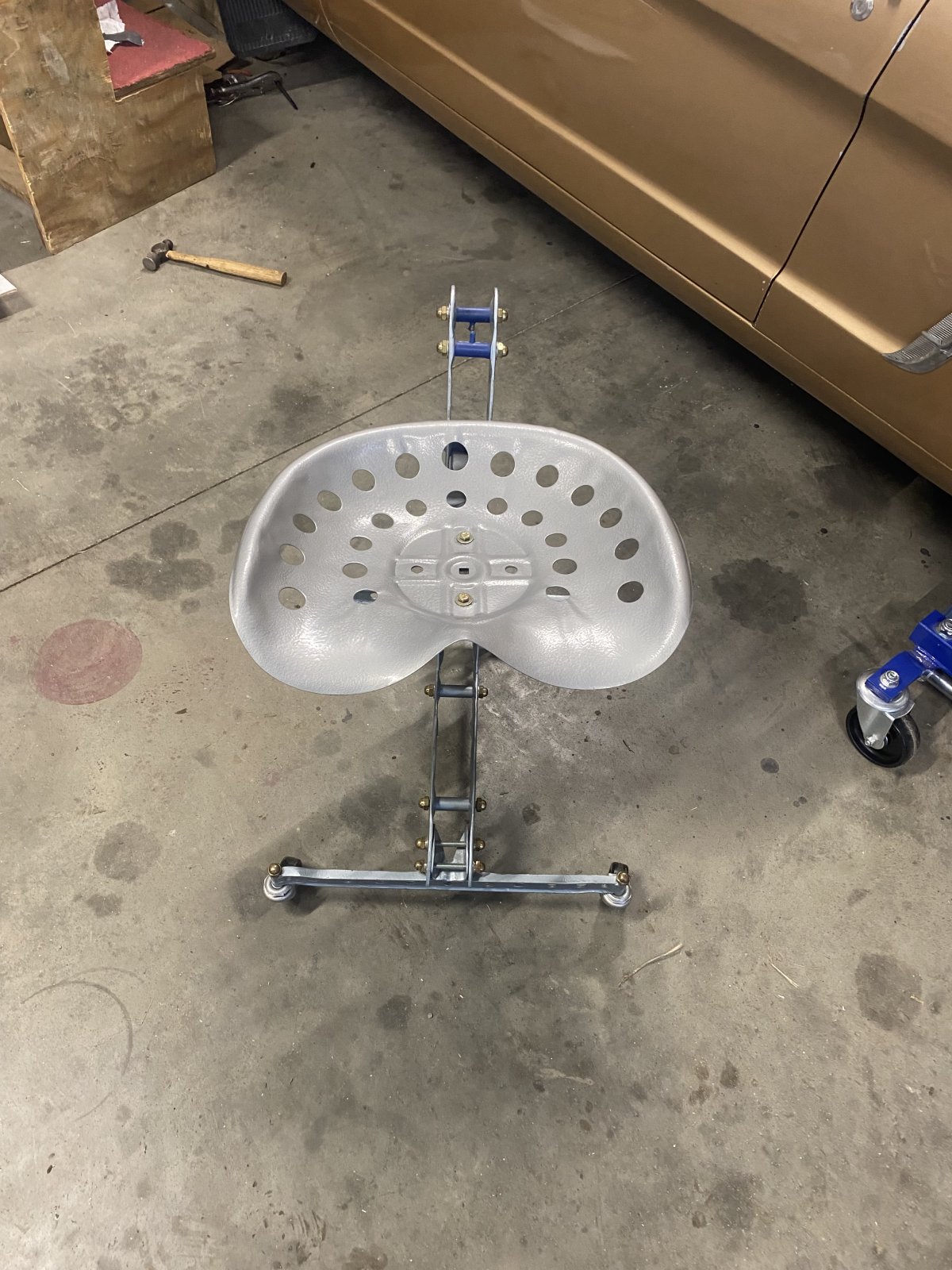

    IMG_0746.jpeg IMG_0745.jpeg 3 position shop stool. Seat is from an old implement, has a leaf spring from a Chevy 1.5 ton for cantilever.

  11. brando1956
    Joined: Jun 25, 2017
    Posts: 258
    brando1956
    Great idea and execution. Any more photos showing how it works?

  12. The 39 guy
    Joined: Nov 5, 2010
    Posts: 3,773
    The 39 guy
    Looks like a great idea. Can you please show us some more views?

    IMG_0747.jpeg 2 holes in leaf spring, allthread inside steel tube, each tube has 1/4” round stock to catch holes in spring. Just lift seat and pull out. Move it up or down, slide spring into frame and push down over pins on tube

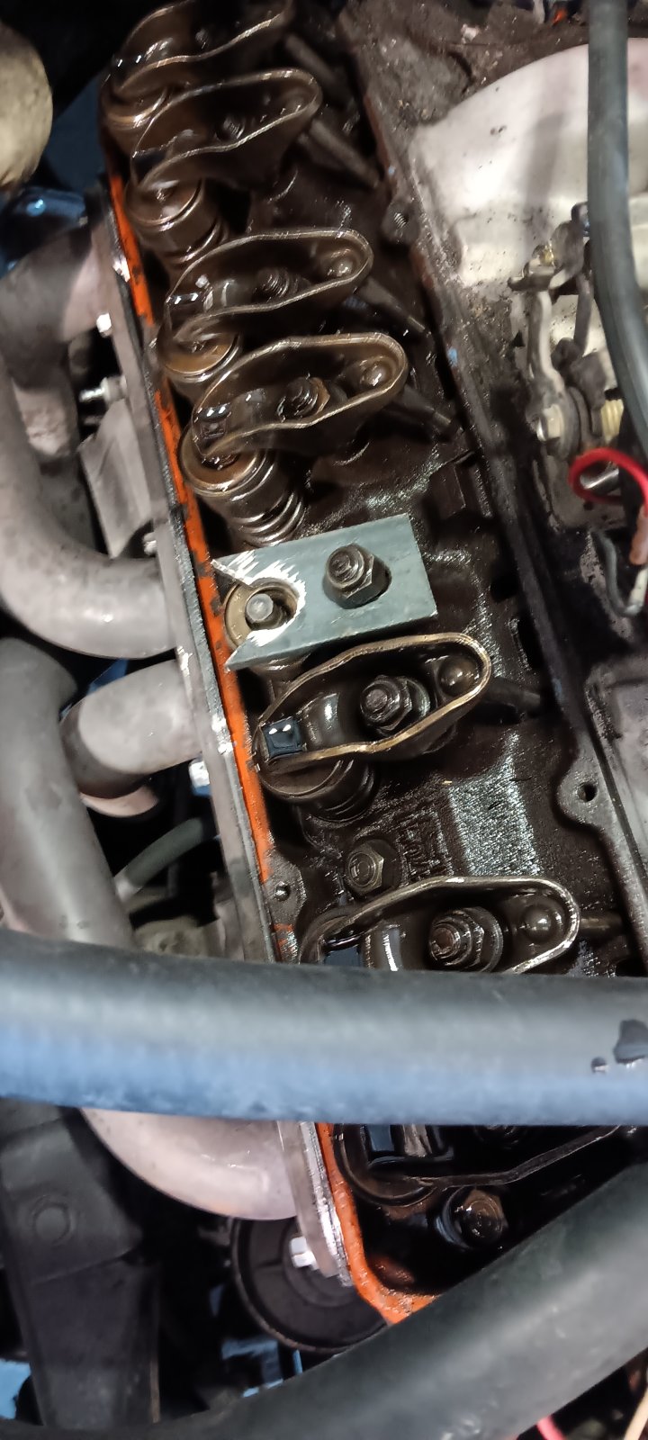

    It has been decades since I have done much transmission work. So I am building a Torqueflight and needed a spring compressor in a hurry. A couple pieces of plywood and some threaded rod and done. IMG_1307.JPG IMG_1308.JPG

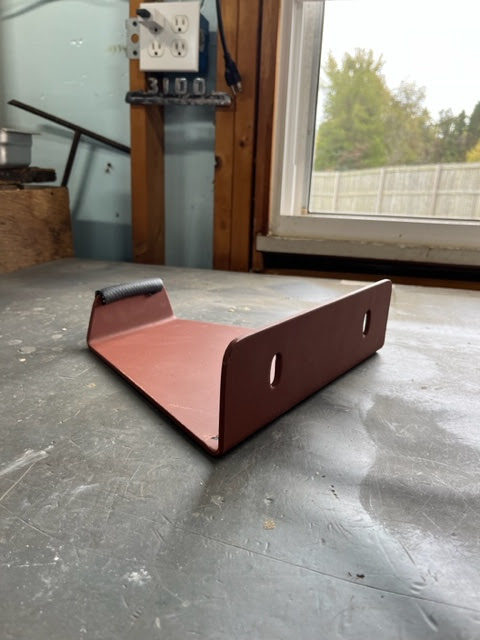

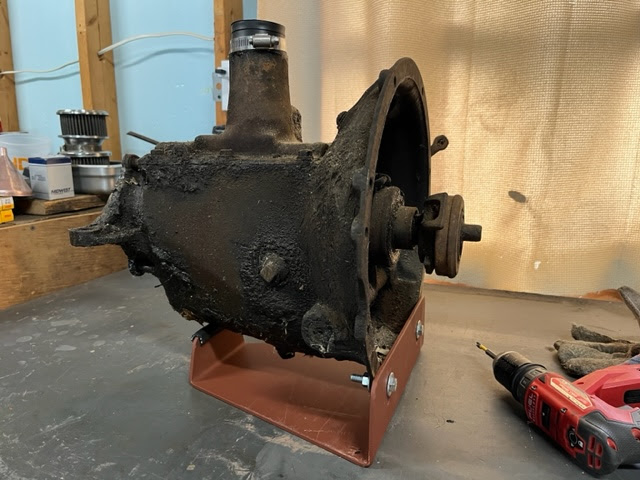

    I've been making these for about half a year. They're awesome. Shop stand for Ford flathead 3-speed transmissions. Hit me up if you want one.

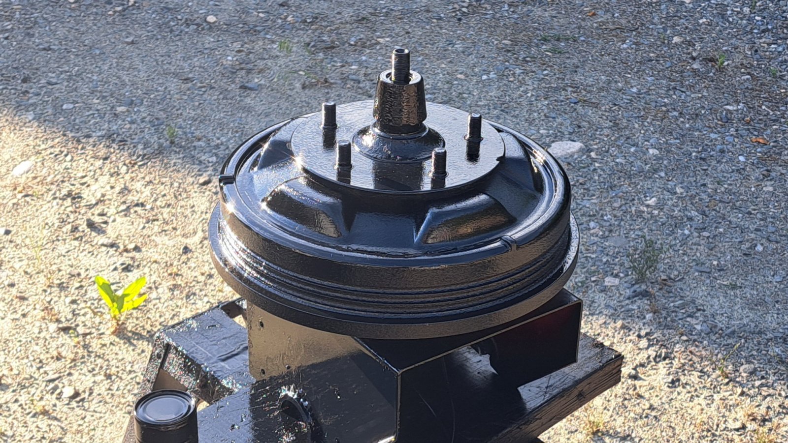

    I made this a couple weeks ago. It was finally nice enough and no wind today to spray my wheels.
    This is my "wheelie go round " or maybe it's a "lazy jethro" .....I don't know why Susan was so lazy , I had a couple beers while the paint was drying s , so "Lazy Jethro" it is.
    I used the end from a bent axle and a pellet stove auger motor to turn it. I stuck a drum on the axle and it worked like a dream. The auger motor turns at 2 rpm , just about right. 20240621_190022.jpg 20240621_190036.jpg 20240621_190043.jpg 20240621_190104.jpg
