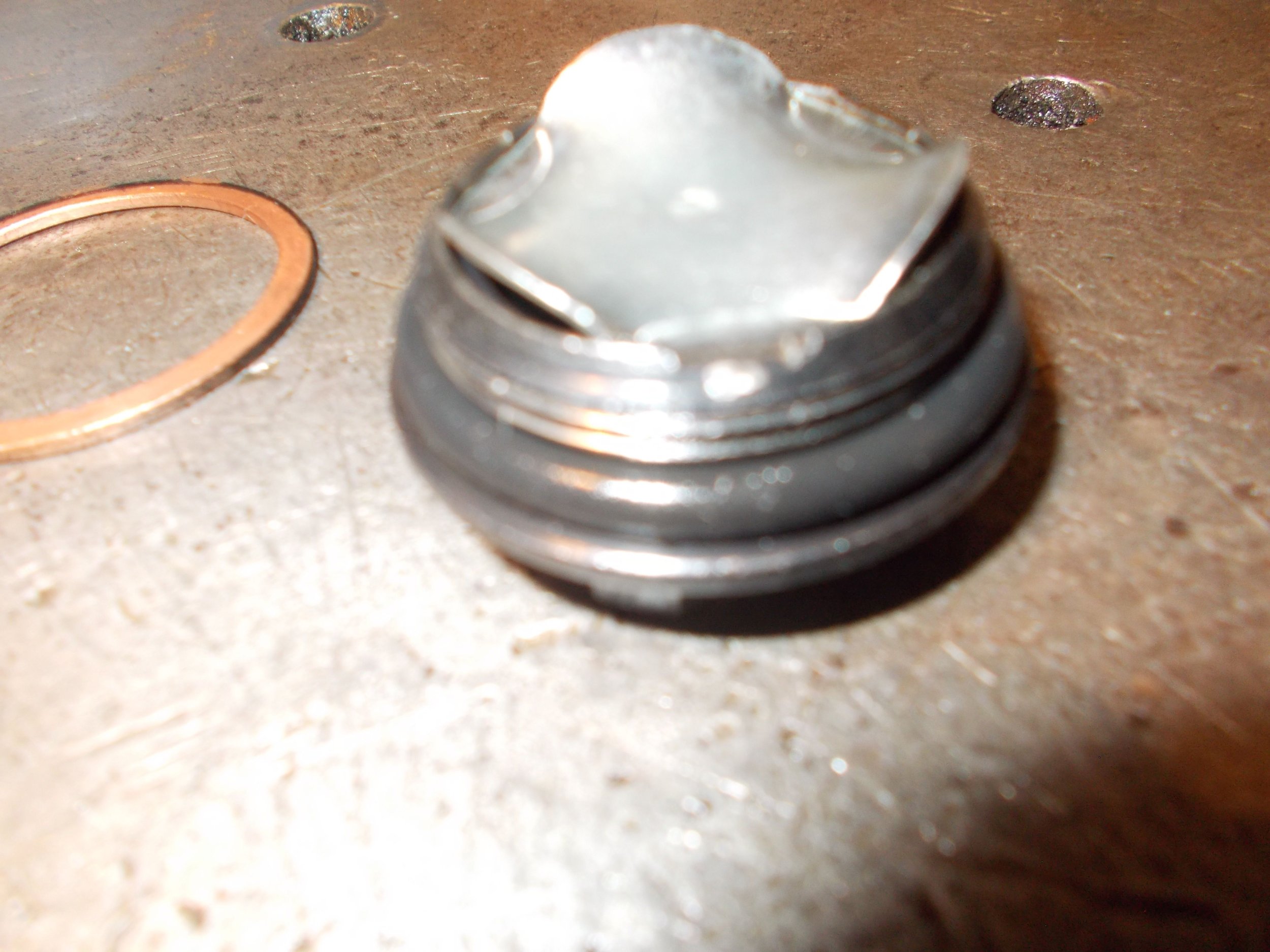

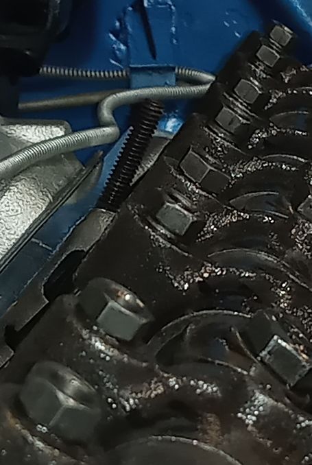

    It's not rocket surgery. I needed to drill some 1/4" holes in a floor pan. I was concerned in that there was an area just below where I needed the holes that I didn't want to damage.
    I grabbed a piece of 5/16" fuel line with an inverted flare end. Having a 1/4" ID I cut the tube to length, placed drill bit in, squeezed slightly drill.jpg in vice so it wouldn't slip out and drilled my holes without fear of damaging the surface below. Ron

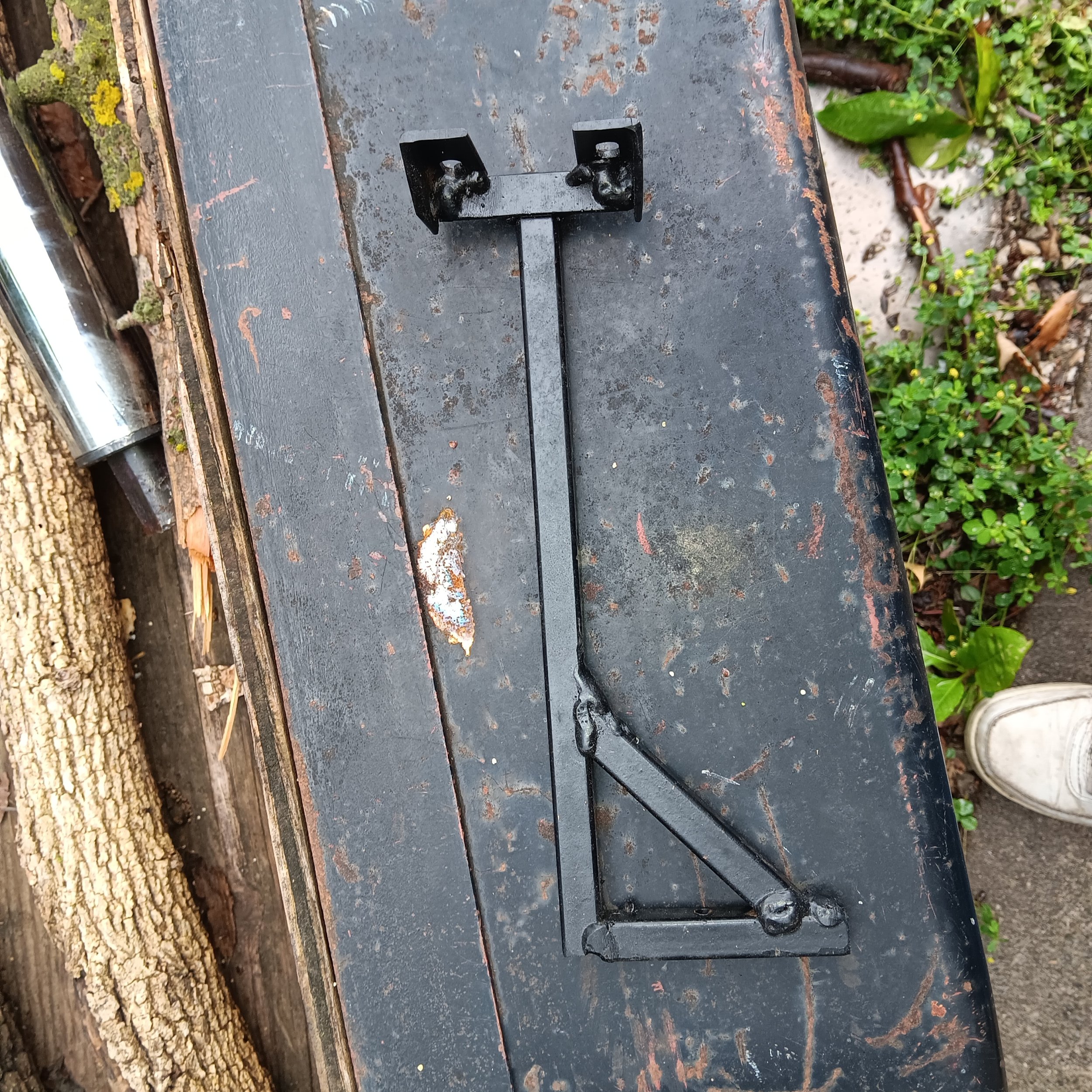

    Here are a couple I came across recently and snapped pix.

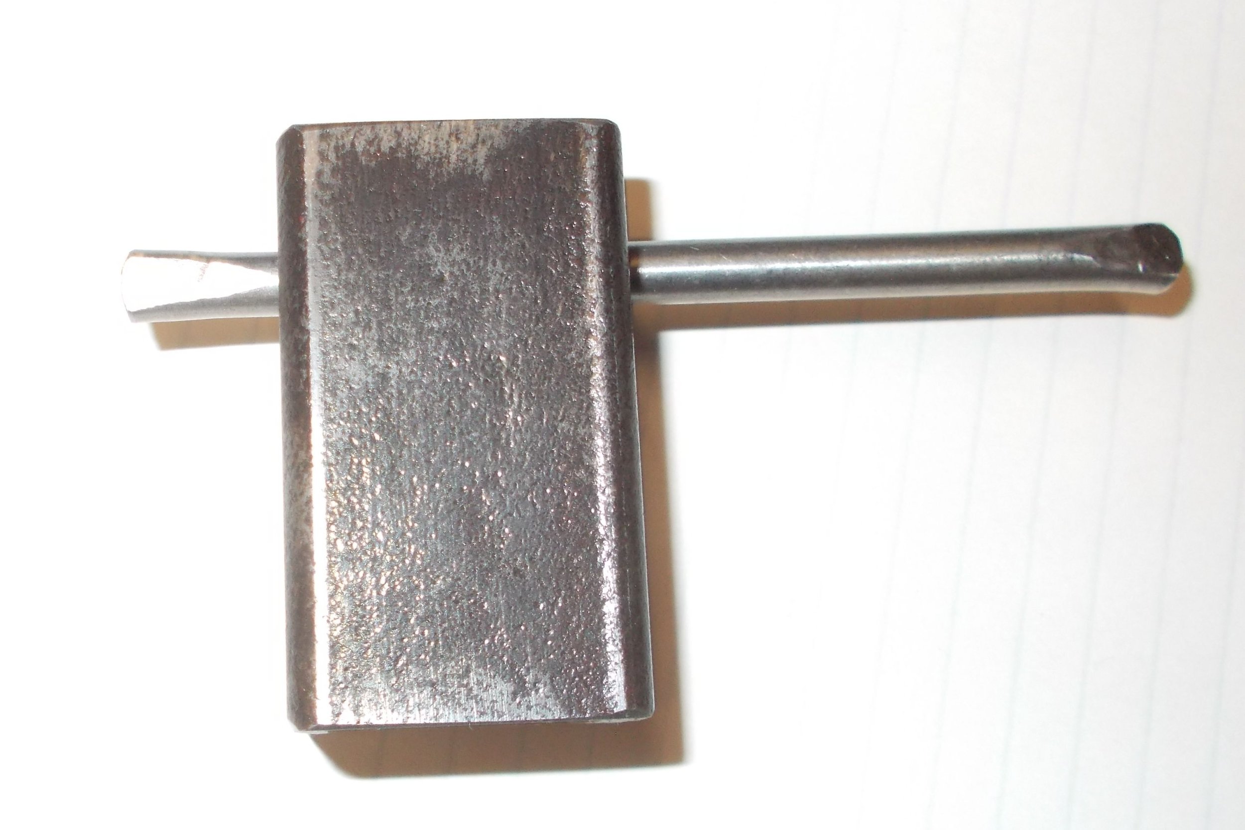

    This is a tool that I made almost 20 years ago to screw in the parking brake adjustment on a car with rear disk brakes. It's pretty rusty now 'cause it's been sitting in a drawer attracting humidity all these years. It got used once. I know I ought to throw it in the steel recycling barrel and get rid of it; "but what if I need it again???"
    This is a wrench that I made so long ago that I can't remember what I made it for. That handle shaft is 1/2" x 1/2" square tube so it's obviously for something about 1" across the flats. And for something that I couldn't get a normal wrench on due to it being a long ways "down." Please don't dis on the welding. I like to think that I'm a somewhat better welder now. b-t-w; it looks like my trailer fender is ready for a repaint, but it ain't broke so why fix it? This ain't no Pebble Beach trailer. 20250604_174747.jpg

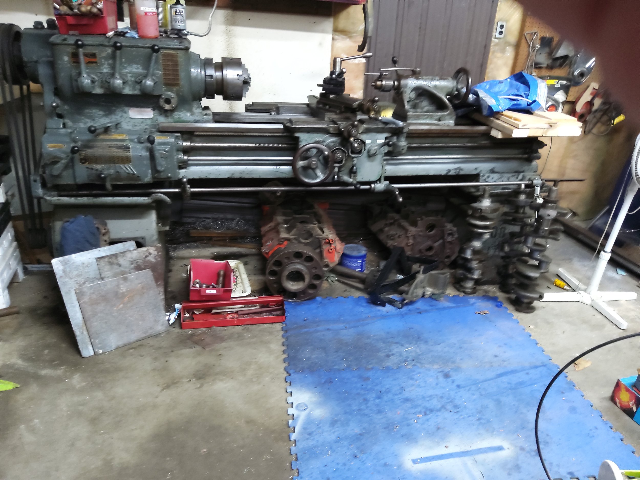

  20. 20250618_200254.jpg My toys. I love them. Last thing I made was some off topic car's gauge surrounds.

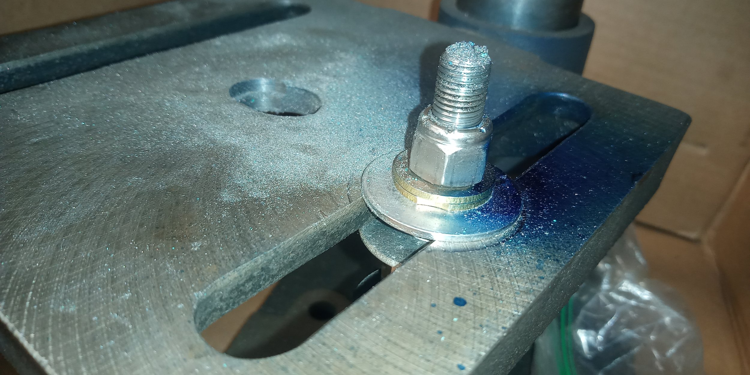

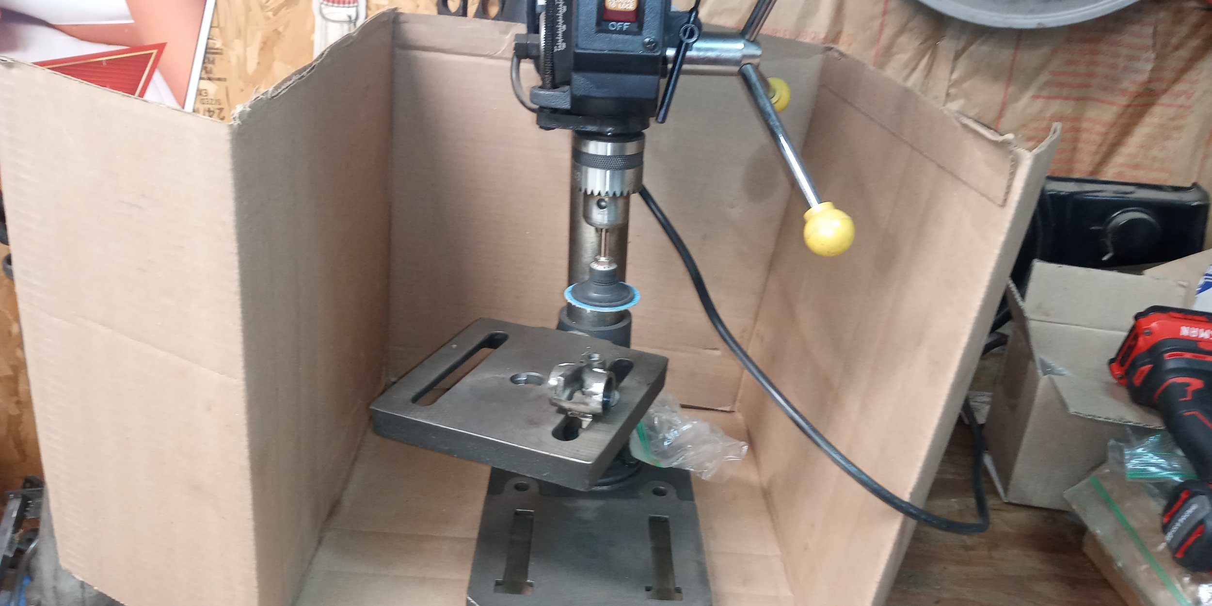

  23. b-body-bob
    Joined: Apr 23, 2011
    Posts: 714
    b-body-bob

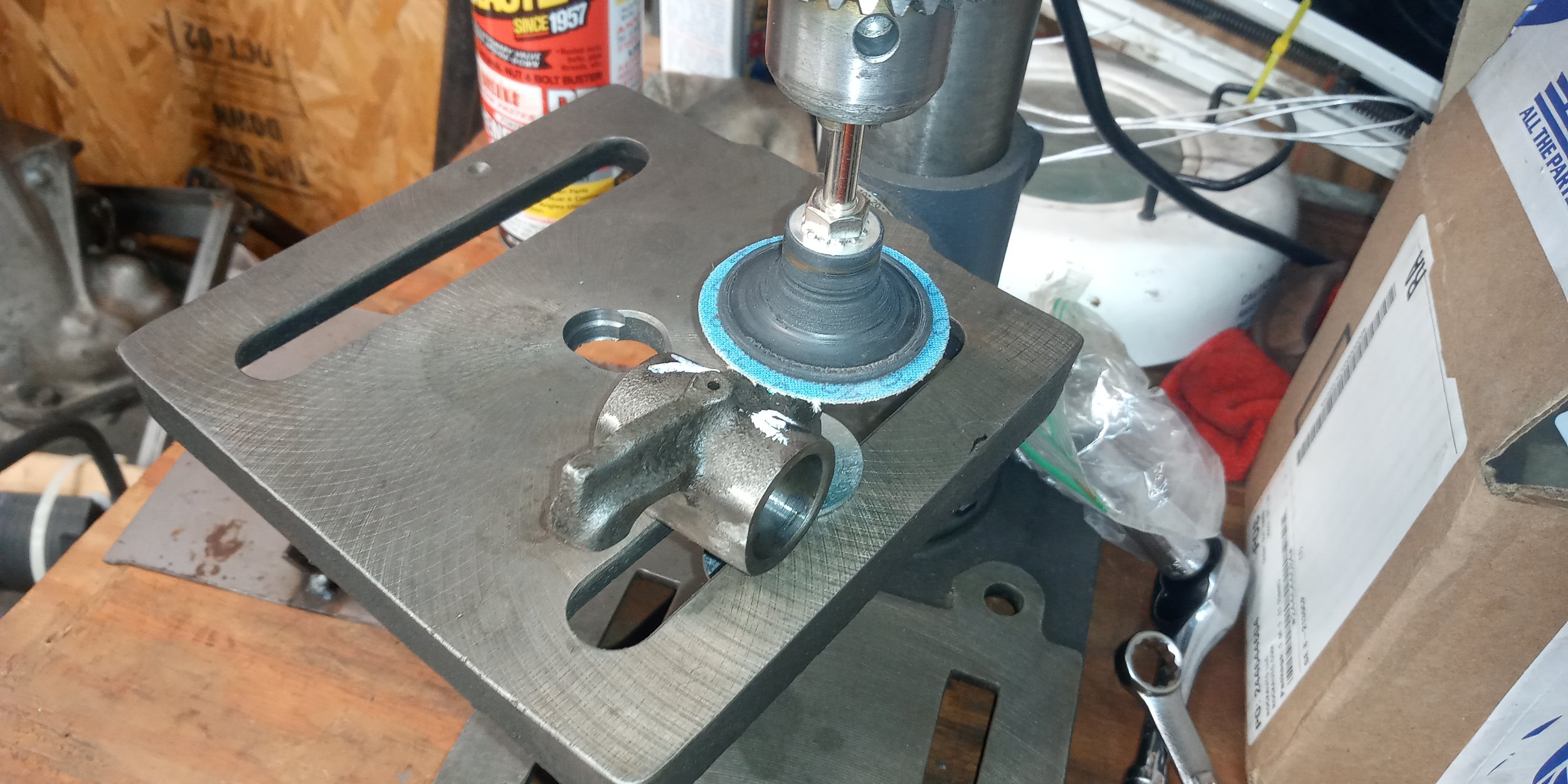

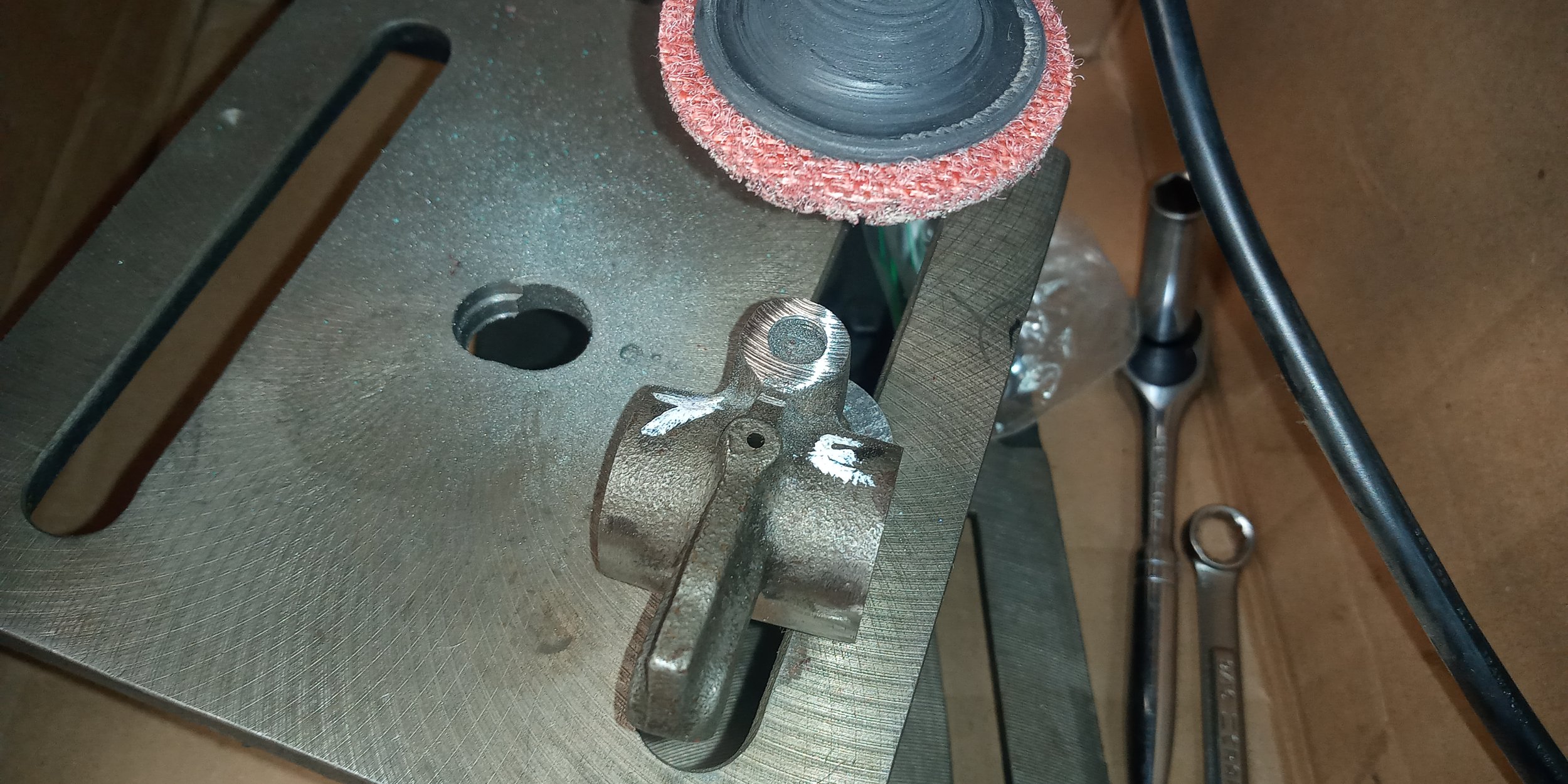

    I had to replace the adjusters in a set of Mopar 273 mechanical rockers with a set that uses lock nuts. So I had to spot face the rockers.
    I setup a bolt on the drill press, then mounted the rockers on that through the adjuster hole/threads.
    I put the drill press in a cut up box to cut down on the mess.
    I stuck an arbor for a Rol-Loc disc in the drill press, then adjusted things so it hit the right place on the rocker.
    It's as flat as it needs to be.

  26. 16" swing, also a bridgeport.
    Sharpone likes this.
  27. Cleaning lathe now for paint

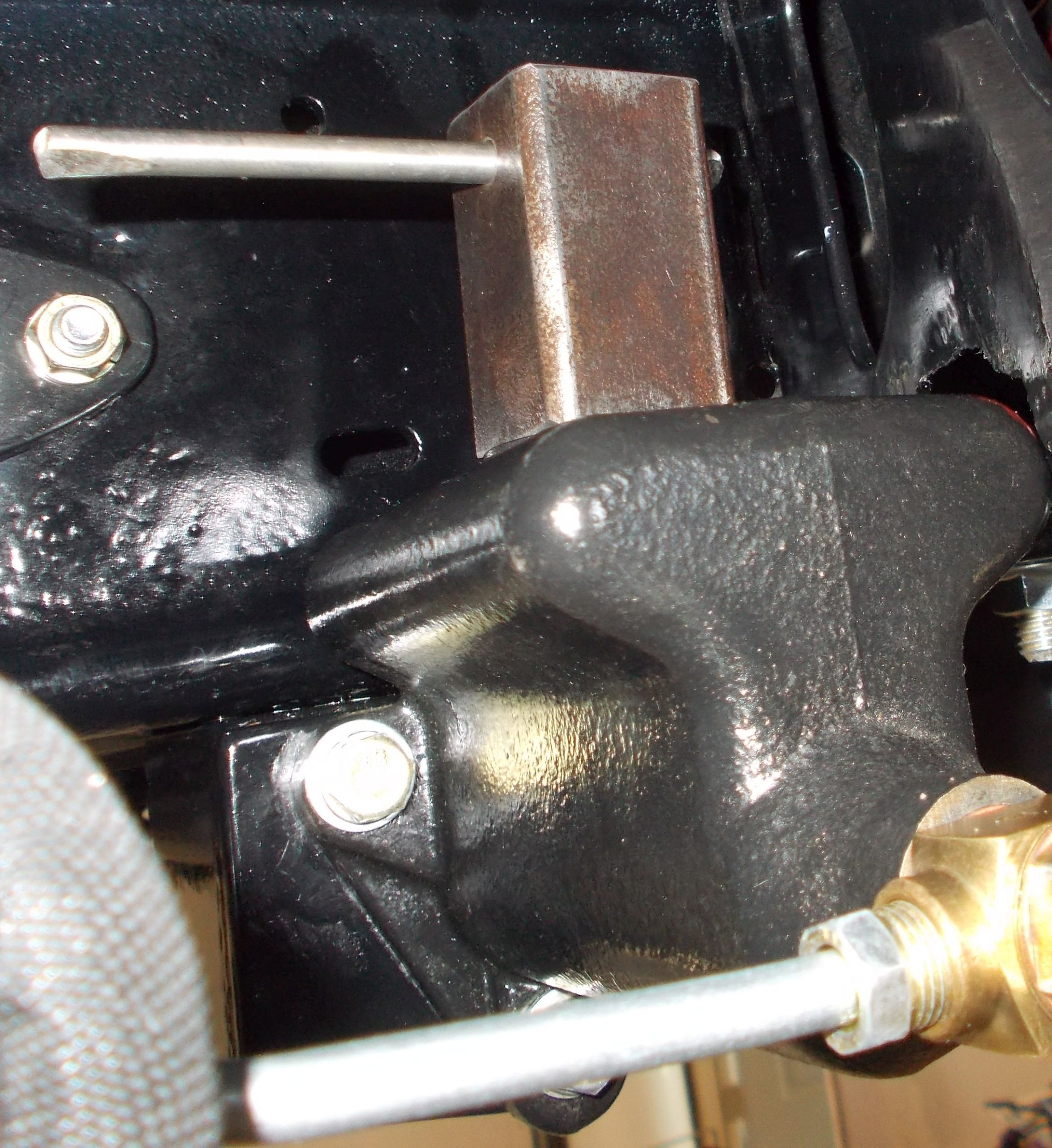

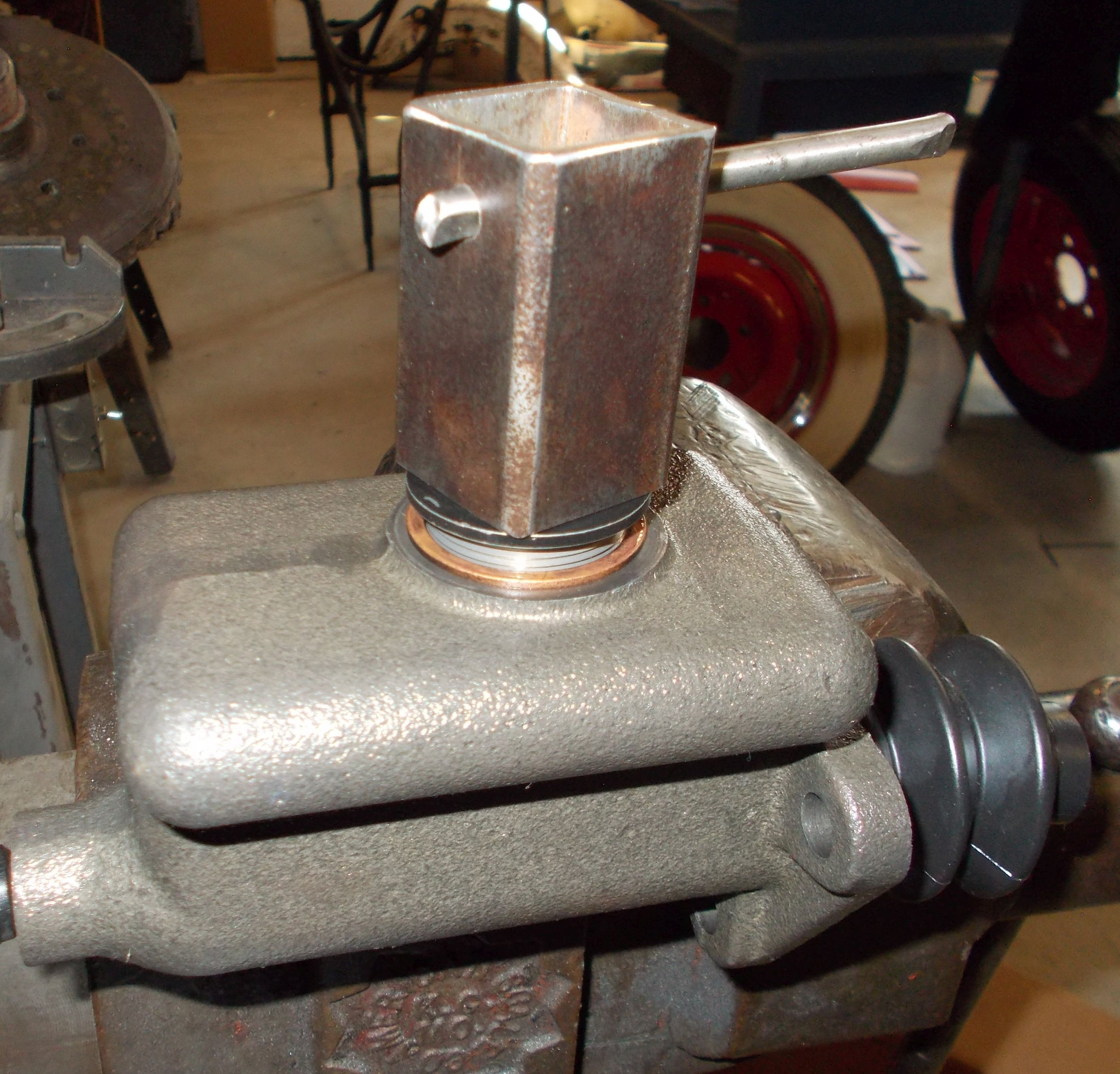

  28. seabeecmc
    Joined: Jan 28, 2005
    Posts: 1,285
    seabeecmc
    More not rocket surgery. Early Ford master cylinder under floorboards with limited room to tighten or loosen cap. From short rack I found a 1 1/4" X 1/8" wall square tube. 1" square ID fits cap perfectly. Ron brk2.jpg brk1.jpg brk3.jpg brk4.jpg brk5.jpg
