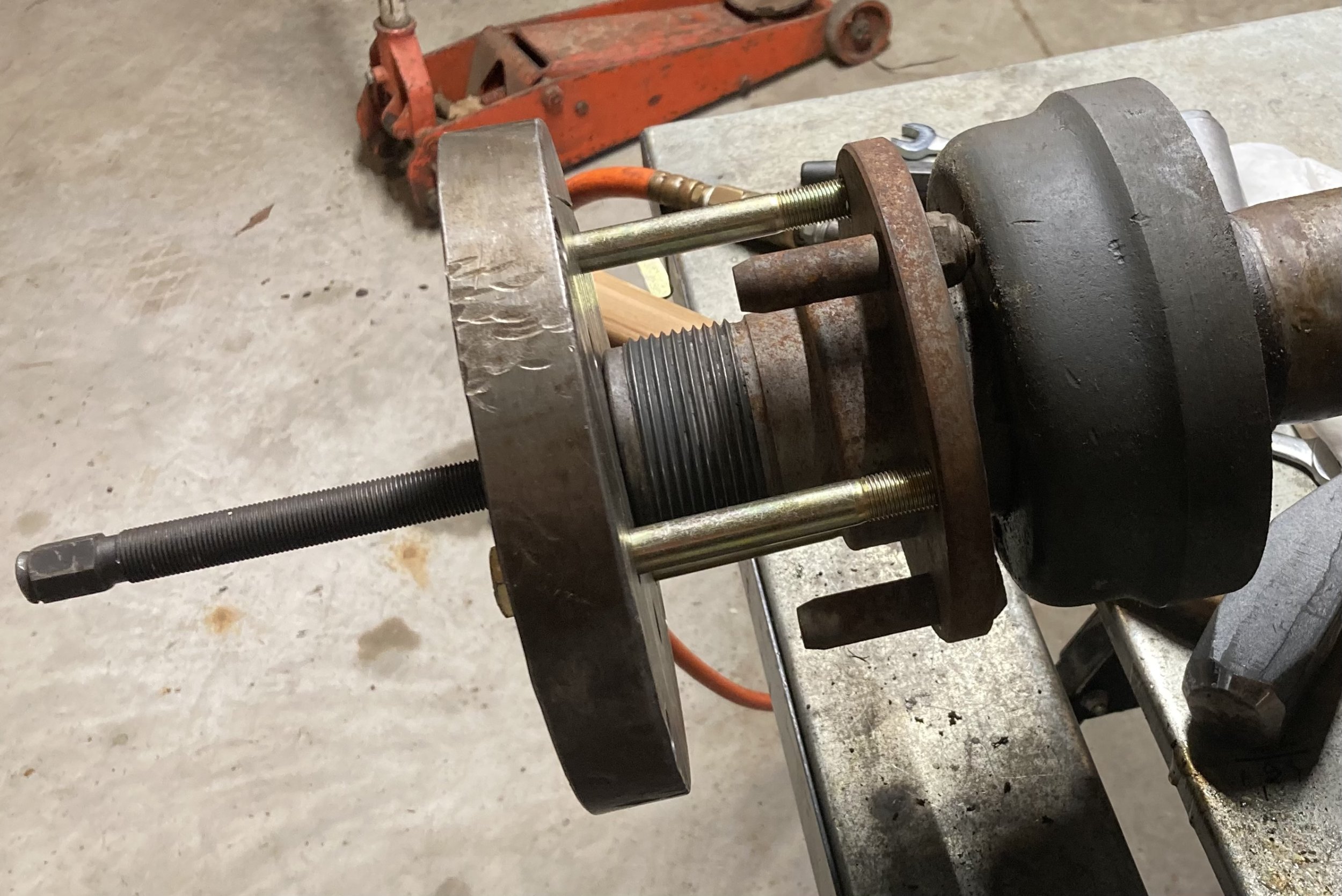

    Hub puller for vintage Halibrand and the like, tapered hubs for sprint/champ car open tube axles. Just a big, beefy hunk of steel, and some holes. Also useful for 1959 Mini flywheels…

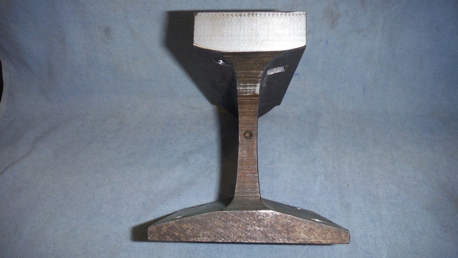

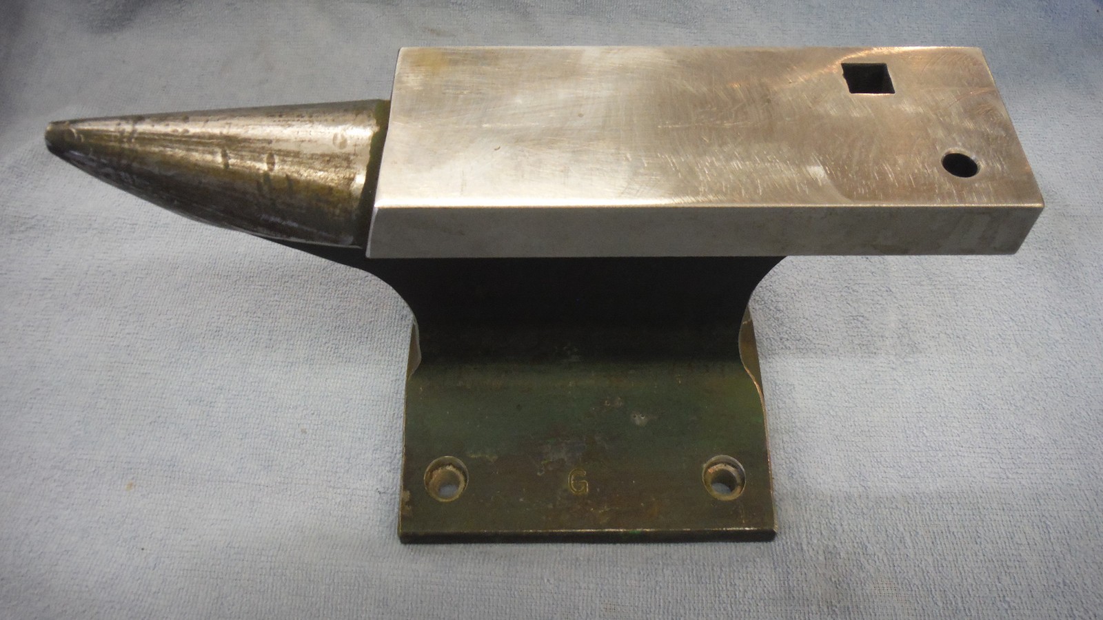

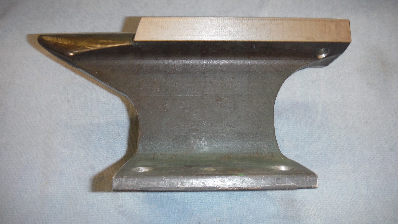

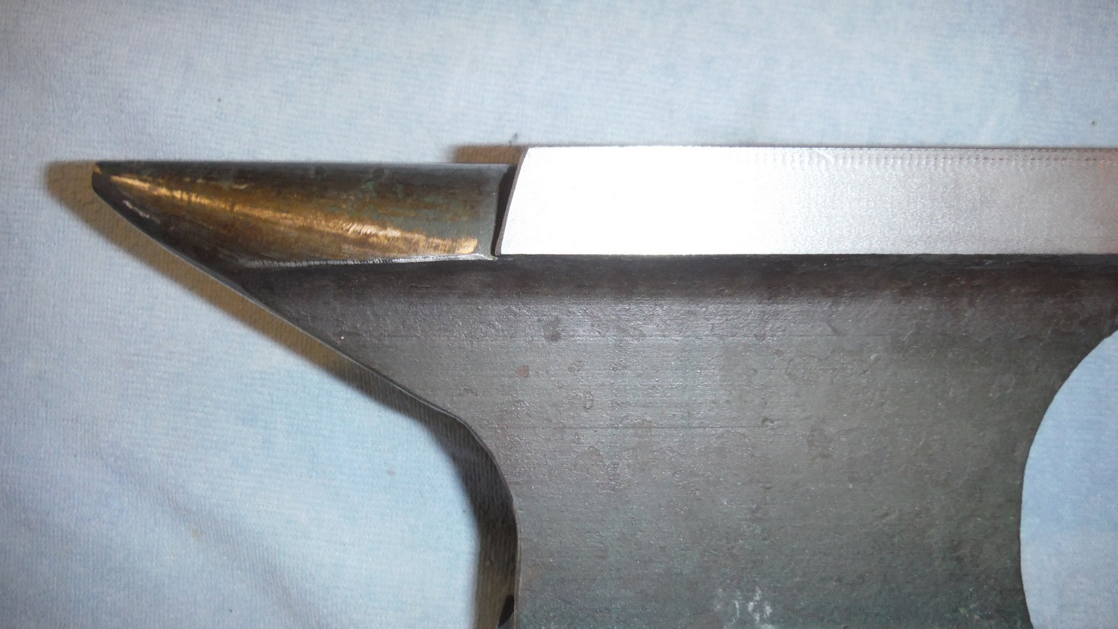

    This is an anvil I made from a rail when attending SECC at ****ord in the early 70's
    It was a project ! but turned out good. No CAD or prints, just winged it.
    The BICK was done on a big ol' lathe, chunk-a-chunk chunk chunk. Fun times
    Although I did have a little trouble getting the 1/2" sq Hardy hole in it.
    RED line is the axis for turning the BICK.
    The narrow end opposite is where a center-drill was placed for the live center at the tailstock

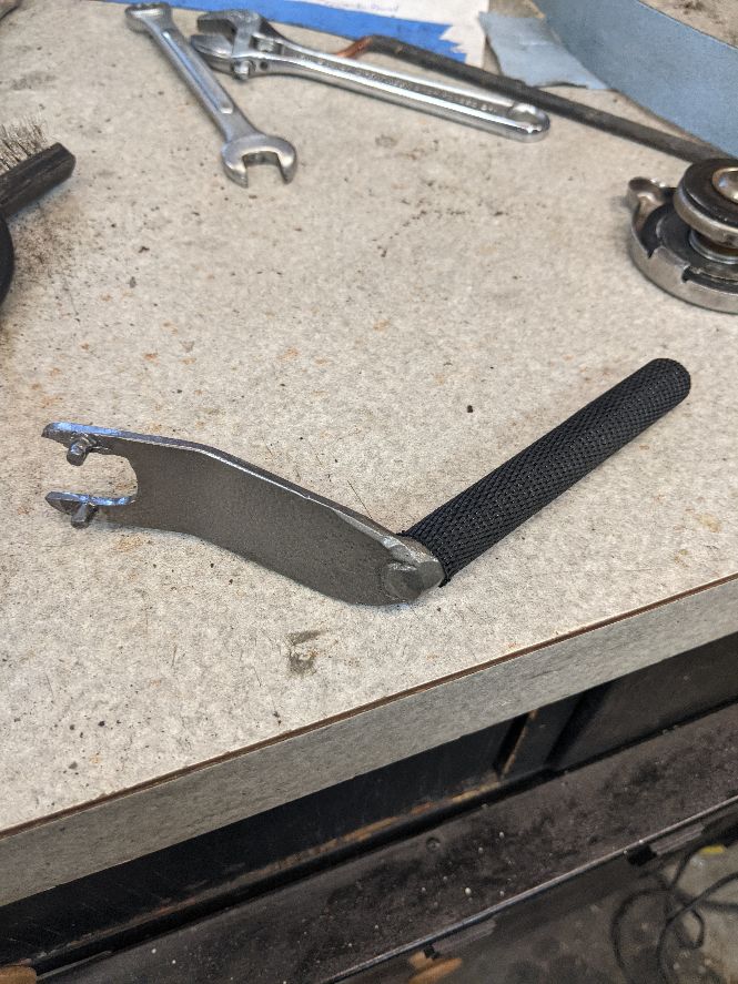

    Hmmmm..... you know how all your grinders take a different size pin wrench? You may have just inspired me to make a "one size fits all".

    if I can't get the nut loose by just turning the disc by hand , I grab any of the spanner wrenches I have .The "wrong " size wrench can be used if you catch one hole with a pin, then rest the second pin on the outside edge of the round nut.
