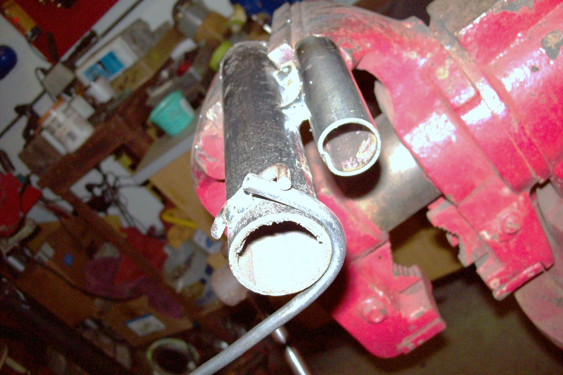

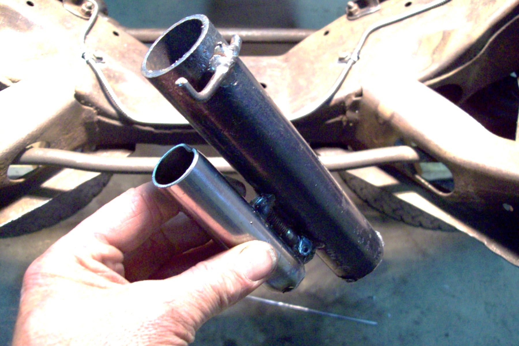

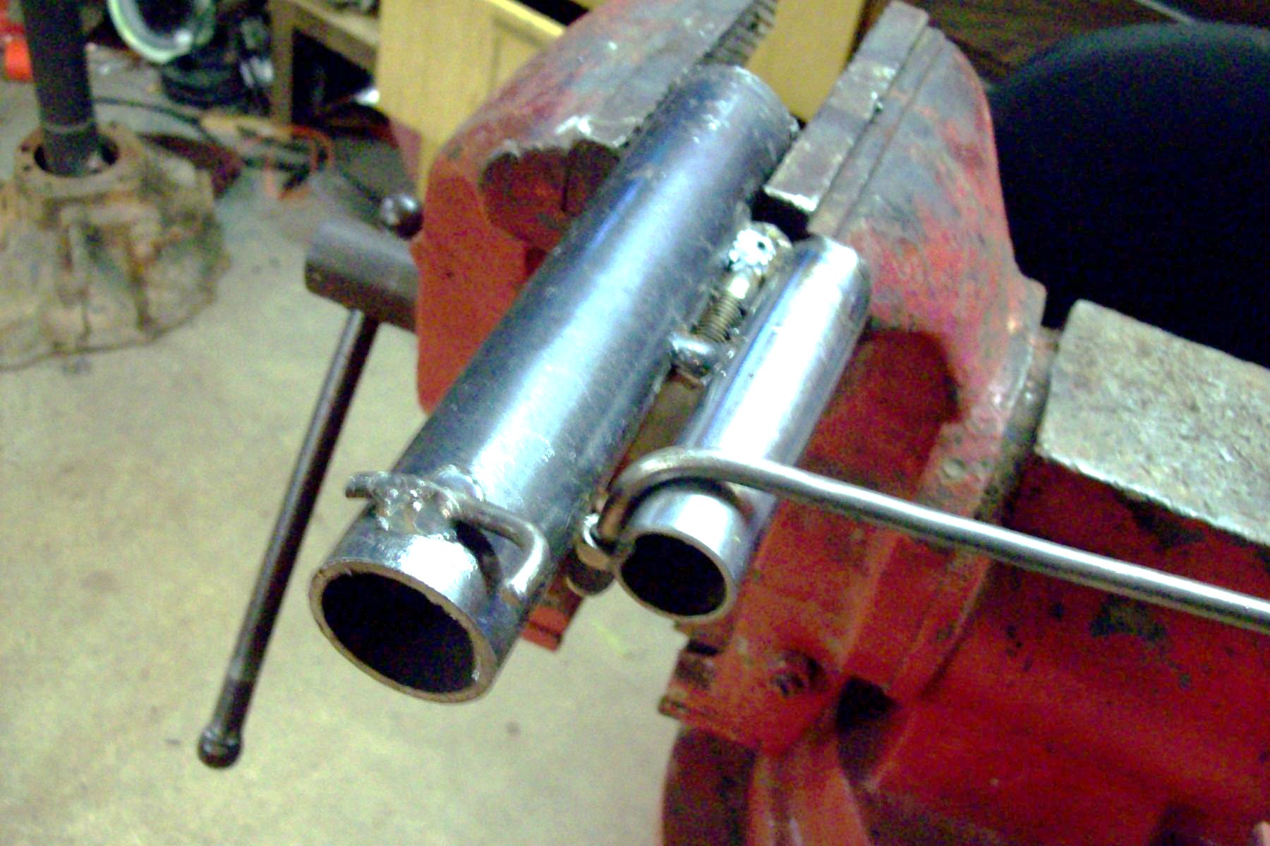

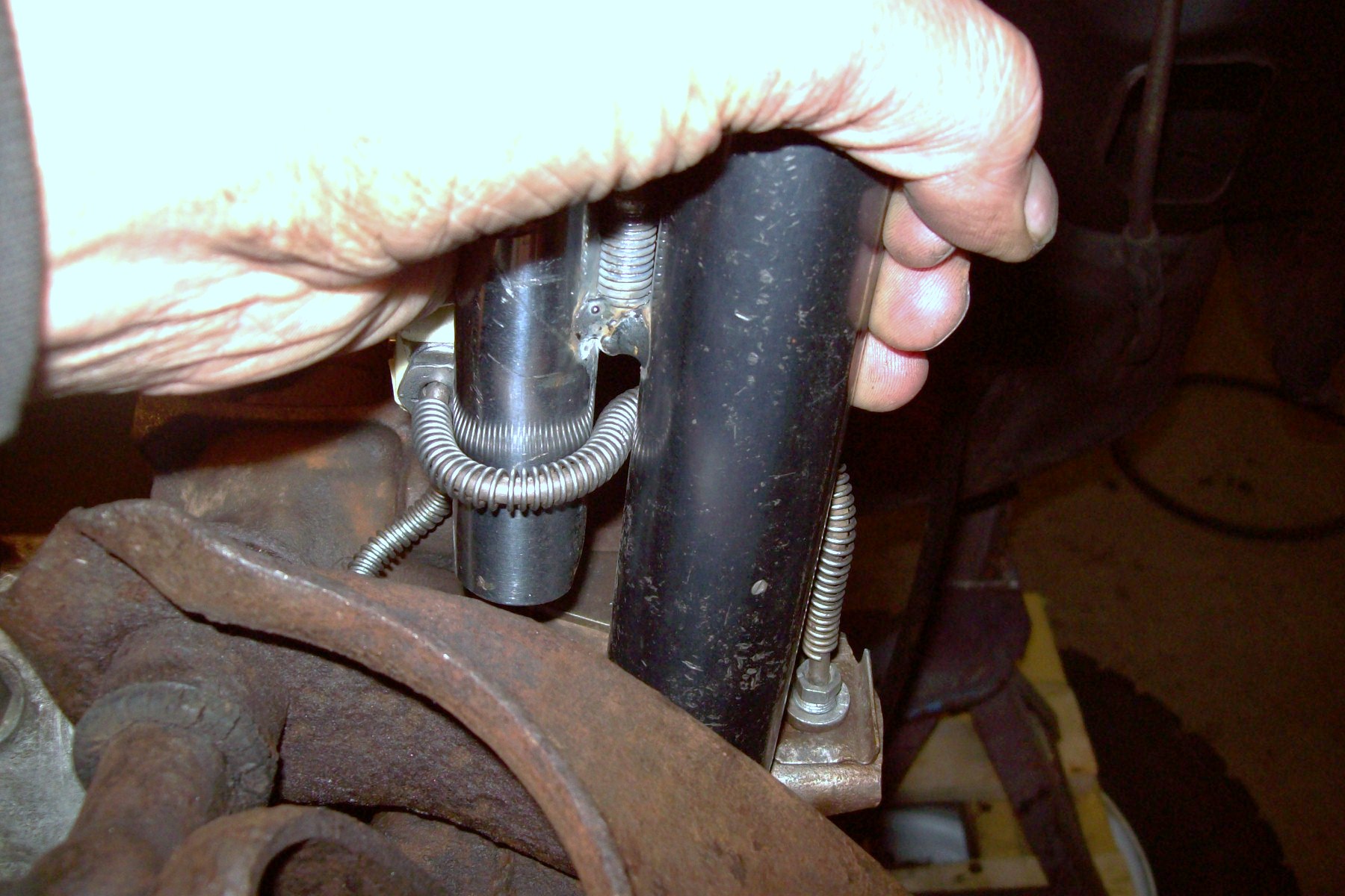

  1. None the less it looks like a really good and safe way to compress coil springs and it wouldn't be that hard to copy.

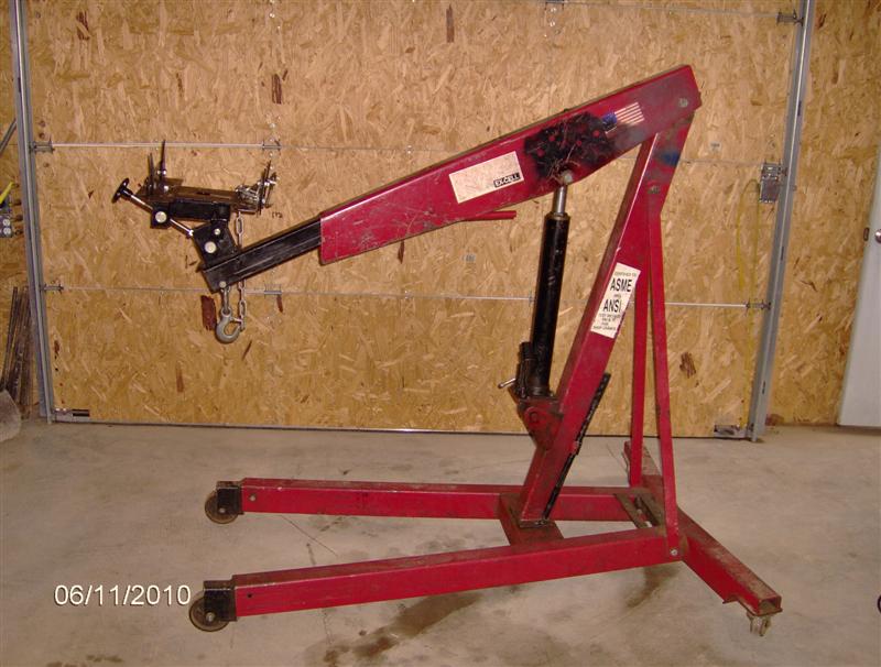

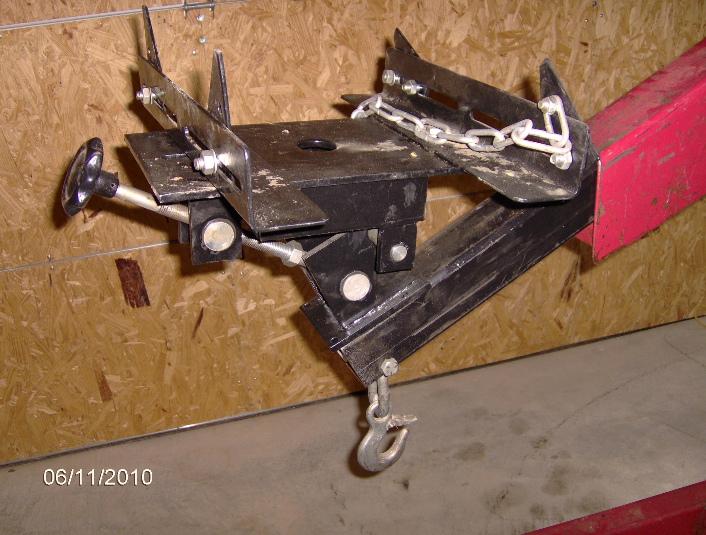

    I have a two post car lift and like to make good use of it. I hate to have to crawl around on the ground to remove a transmission. Well I am a cheep guy and it bothered me that my cherry picker was only good at pulling engines. It has a nice wide base and a long hyd. cylinder. So, I got a HF transmission adapter for a floor jack and modified the end of the cherry picker. I used a hole saw and drilled and taped a hole. Simple, sturdy and cheep!
