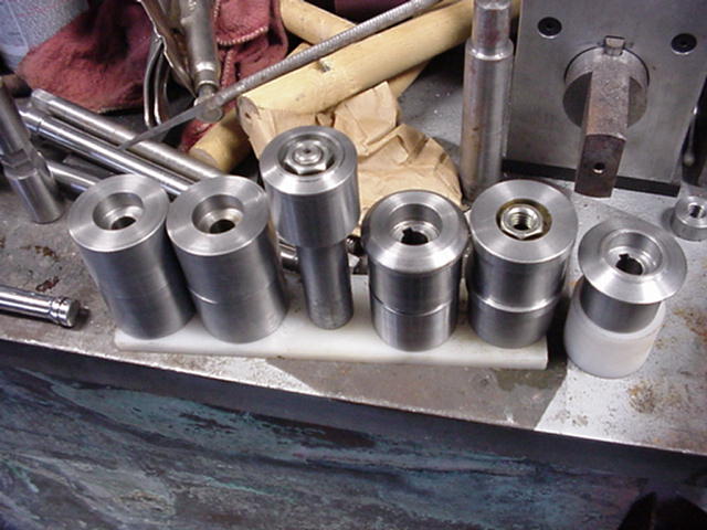

  15. vendetta
    Joined: Mar 22, 2007
    Posts: 125
    vendetta
    my latest-a 600 wide press brake.i can use the arm for bending light gauge and narrower parts.as i don't have a press,i might just put a bottle jack on top instead of buying a press for heavier/wider parts.
    second picture is of some dies for putting swage around 1 1/2 and 2" holes in sheet metal.

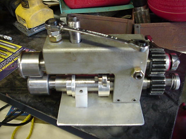

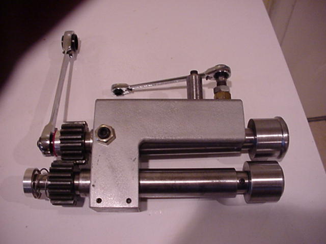

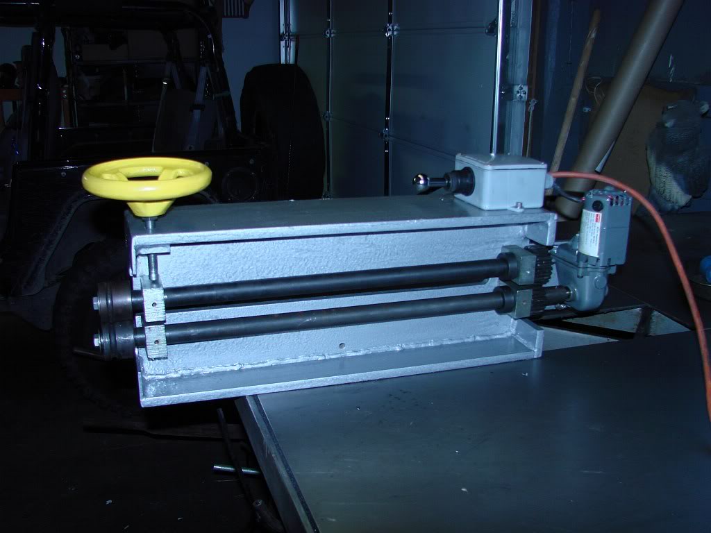

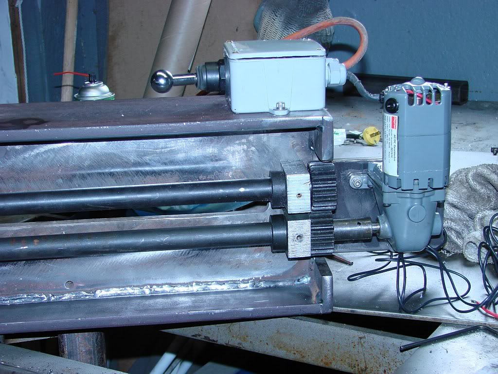

  18. Blue One
    Joined: Feb 6, 2010
    Posts: 11,509
    Blue One
    from Alberta
    I got hold of a Dayton gear motor, the same one Murfman used to power his bead roller. He posted pictures of it on one of the bead roller threads.
    It has a pair of wires which need to be swapped to change the direction of the motor.
    I'd like to be able to wire it with a switch to change motor direction and a single foot pedal to control it all.
    Anyone have any ideas or know how to do this ? It has me stumped right now.
    By the way I have been in touch with Murfman and he did reply back initially, we corresponded back and forth by e-mail.
    I asked him for details on how he wired his, as he has done what I want to do.
    No response lately to my messages and he seems unable (or unwilling) to help me out.
    Any help will be appreciated. Below are 2 pictures of Murfmans BR.
    Larry.

  21. Blue One
    Joined: Feb 6, 2010
    Posts: 11,509
    Blue One
    from Alberta
    Yes, the motor is reversible by switching a wire to the power supply it runs the other way.
    What I want to know is how to hook it up so both wires are hooked up and when switched it will run one way and then move the switch and have it run the other way.

  24. Blue One
    Joined: Feb 6, 2010
    Posts: 11,509
    Blue One
    from Alberta
    Ok thanks for the help :rolleyes: Now run along skippy your mother is calling. ;)
    Thanks I'll do that. Just thought maybe someone here had done it or knew how to do it.
  25. BISHOP
    Joined: Jul 16, 2006
    Posts: 2,570
    BISHOP
    Its all in the switch. You just need a switch that caries a ground, and two positives oposite of each other, its very simple. Its called a 3 way switch. Top is forward, center is off, bottom is reverse.
  26. Why not two pedals side by side, a switch in one wired for forward, the other with a swich wired for reverse. Very user friendly:):):)

    Joined: Feb 6, 2010
    Posts: 11,509
    Blue One
    from Alberta
    I have seen that done, and didn't want to go that route because it is too easy to switch motor rotation when the motor is under load by accidentally (or on pupose) stepping on the other foot switch.
    The instructions for my motor state that the motor must be stopped and not under load before reversing direction.
    I have found what I need is called a reversing drum switch. They have a neutral and you can stop the motor, switch direction with the drum switch and carry on with the single foot switch.
    The wiring is relatively simple with it too.
    So, a drum switch and a foot switch along with a little fab work and I'll have a powered bead roller.
    I bought a basic Magnum bead roller with an 18" throat. The fab work will involve beefing it up and mounting the motor.
  29. bobj49f2
    Joined: Jun 1, 2008
    Posts: 1,964
    bobj49f2
    A rigid pipe threader is wired in this matter. You need a heavy duty two way switch and a foot pedal. You should be able to buy a replacement kit from a Rigid distributor in your area.
