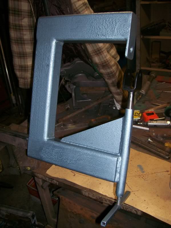

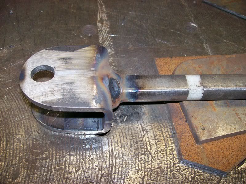

  20. Here is one I made yesterday, for pulling the pinion gear out of a banjo rear end carrier.

    VERY nice. How did you get the bend in the square stock?
  23. It's all hand hammered, took me like 6 weeks:D:D:D
    No, they sell circles for ornamental gates and stuff, at the the local Metal store, I just cut one in half.
