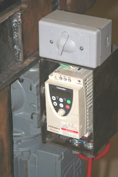

    Thats how mine is. It lets you keep both hands on the panel.

    That would be nice, but if you read what I posted above I have a valid reason for not wanting to go that way.

    To each his own indeed. So I do what you suggest, go against the manufacturer of the motor and do what I want.
    Then the motor fails and I wonder why and try to blame them.
    Makes sense to me :rolleyes:
    I don't operate that way and the small inconvenience of having to throw a switch to change direction is no problem.

    This is the way I've typically seen it done or a very similar version of such. You may (or may not) find that the rotary drum switch as economical as you'd like. They get pricey when the rating goes up. You can do the same thing with relays (contactors) or even the suggested dual switch getup. As for the twin switch setup - they make those with shrouds that would force you to move your foot from one switch to the other - making it a very deliberate motion and thus not accidentally done. I've done this same type of thing on various items - usually what dictates the method I use is what parts I score CHEAP!!! ;-)
    I even have my shop vac by the mill set up on a momentary foot switch - hey I'm too lazy to bend over - what can I say?
    There's literally a dozen ways to accomplish your task - not knowing exactly what your requirements are make it difficult to outline an exact schematic to do what you want, but the general idea will be what I sketched up.

    Thanks, I'll look into my options, that diagram looks similar to the wiring diagram for the drum switches I have seen.
