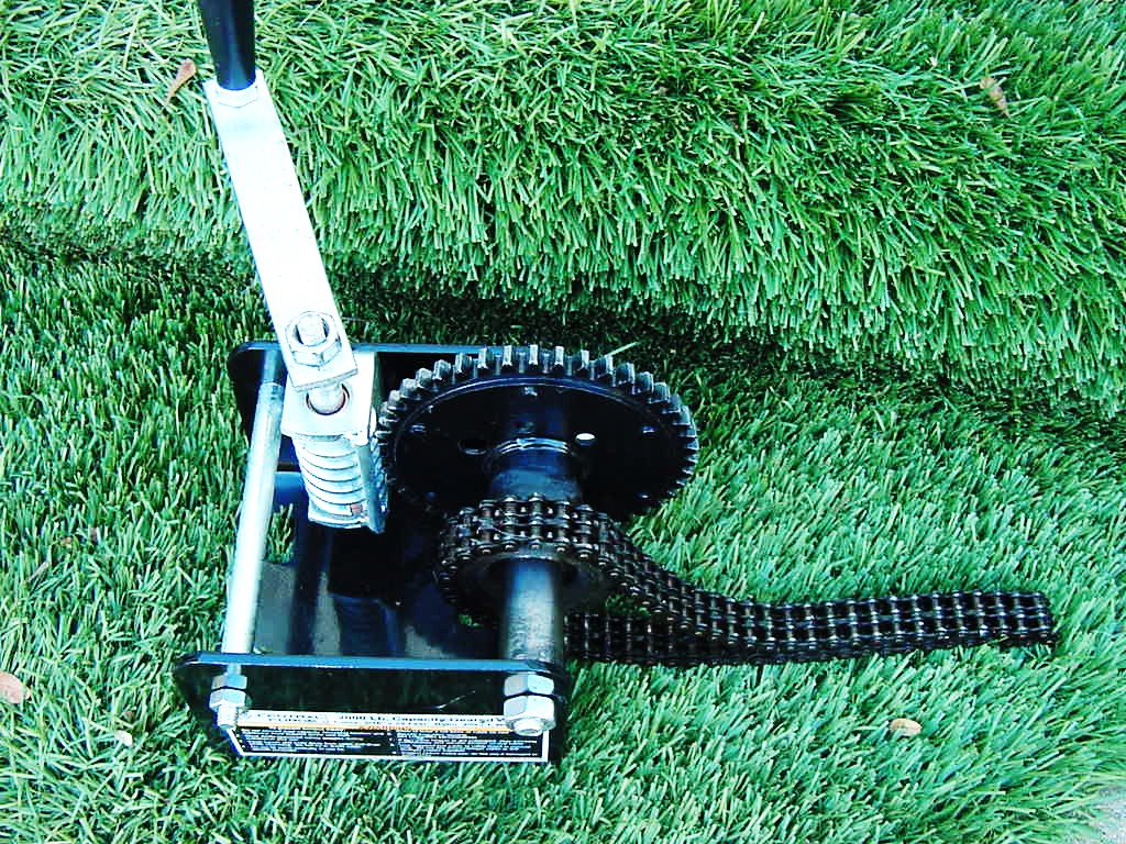

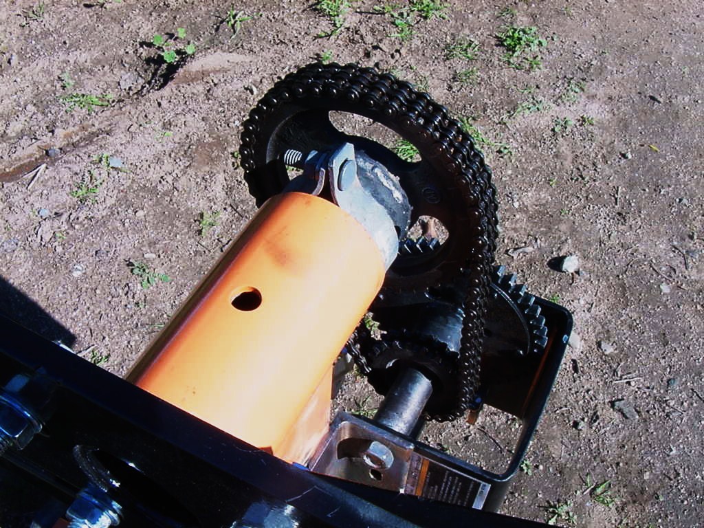

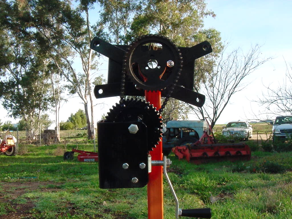

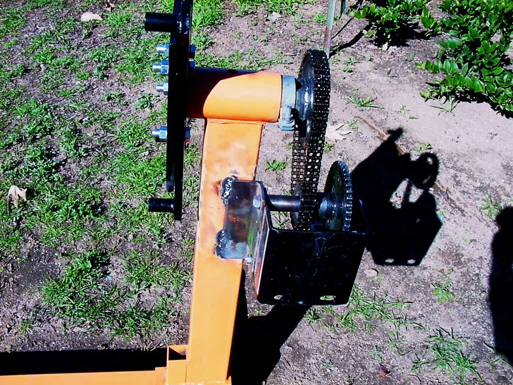

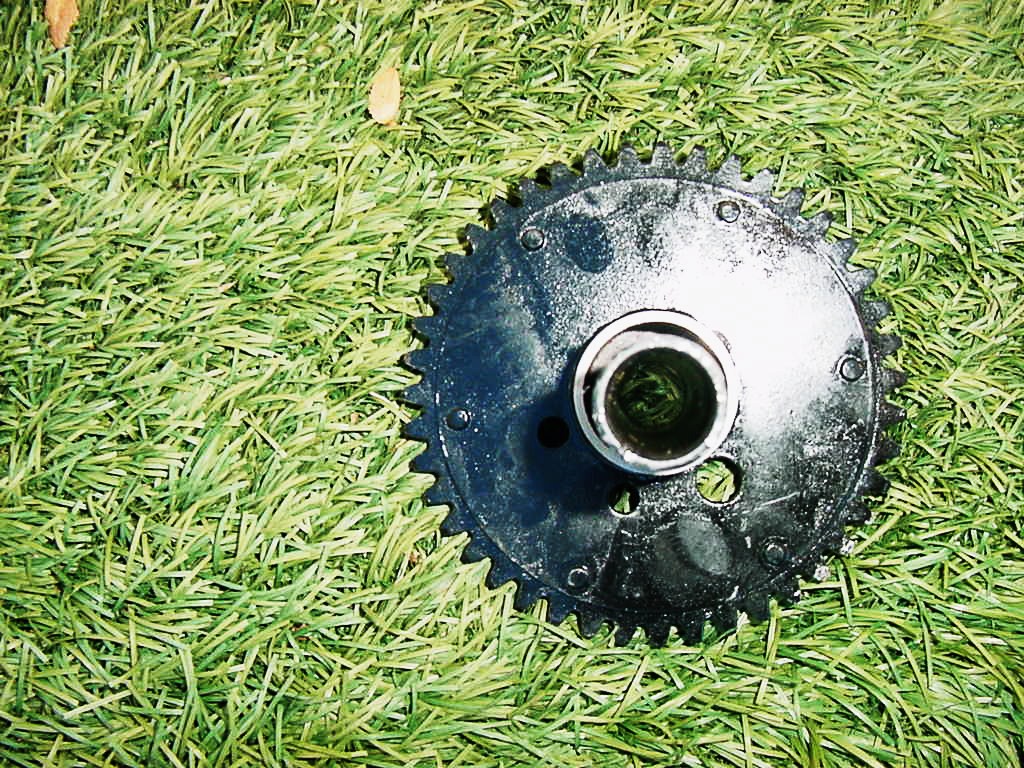

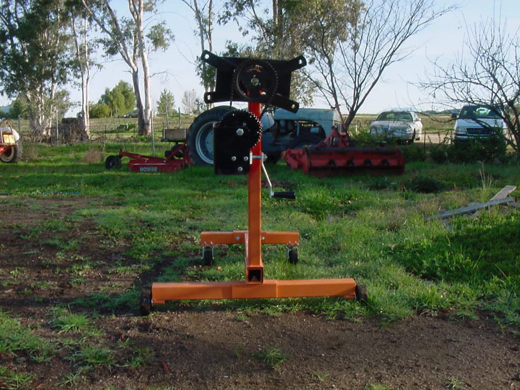

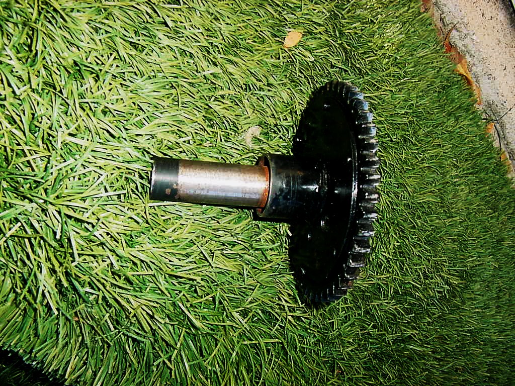

    Today I built a gear driven engine stand.
    If you have ever used an engine stand that has a tube handle that goes thru the hub that is used to rotate the engine you will recognize the short commings of this arangement.
    If you use a cherry picker to lift the engine to install it to the engine stand you will sometimes find it hard to get a good balance on the engine.
    Then when you pull the locking pin the engine is either hard to rotate or it wants to get away from you and rotate to where the heaviest part is on the bottom.
    Even if you do get an good initial balance on the engine, when you install or remove a heavy part such as the head you will change the center of gravity and then make it difficult to rotate the engine.
    There are two solutions. Purchase a $200.00 gear driven engine stand or make one out of your existing stand for $30.00 and some POH that is Parts On Hand.
    The parts on hand included a timming chain and the 2 timming gears that go with it. If you don't have a set you can probably get one free at an engine shop because they usually throw them away when they rebuild an engine.
    I also used a fence clamp and a 6" piece of angle iron.
    I bought a new Harbor Freight engine stand on sale for $39.99 and a cable wench for $29.99.
    The next one I make I will use the old Harbor Freight engine stand that is currently holding an engine project in progress.
    Again I will use Harbor Freight #5798 2000 lb worm gear cable wench $32.99 regular, $29.99 on sale.
    I recommend the worm drive wench because they don't unwind when the engine is left in an unbalanced position.
    The first thing that I do to the wench is take the bolt holding the spool off and remove the spool and the tube bearing that is inside the spool axle.
    Then I push out the bearing and set it aside so that it dosn't get damage.
    I then cut the inside of the spool about 1/2" to 3/4" from the gear side. The one in the picture is about 1 1/2" from the gear but the next one will be closer to the gear. See the 3rd picture below.
    Do not cut all of the way thru just far enough to go thru the outer spool tube. If you look at the 4th picture you will see an end view showing a tube inside a tube.
    You will notice that the tube on mine wasn't centered when it was welded but it won't matter because you are going to weld your small timming gear centered on the smaller 15/16" tube anyway.
    I used a lathe to cut mine off because I didn't know how it was put together.
    The next one I will chuck in my lathe turning backward and use a 4 1/2" cutoff wheel turning the opposite direction to cut the spool off.
    You could use a hack saw but be carefull to cut streight because you are going to use that edge of the larger tube as a sholder to weld the gear to.
    When cut thru the non-geared half of the spool will just slide off of the smaller tube because it is not welded at that end.
    Then I slid the small timing gear over the shaft and up against the shoulder of the larger tube.
    I cut a bushing to center that gear but the next one I will just find something about .2" in diameter to use for spacers to center the gear.
    I will then weld the gear to the larger tube and then remove the spacers and weld up the space between the gear and the spool shaft.
    Caution should be used so that you don't burn thru the spool shaft while filling the space. Tack weld then weld a little at a time untill done.
    Then when cool reinstall the shaft being sure to include the timming belt around the gear. I used some anti-seize on the spindle bearing.
    I used a galvanized fence bracket to hold the engine stand head shaft tight against the frame and welded the large cam gear onto the shaft. You can see that in the 6th picture.
    I was fortunate in that the flange on the gear was just about a perfect match for size with the shaft. I just held it as close to centered and tacked it. After making sure it was as close as I could make it by eye I welded it on.
    I then drilled the 6" angle Iron bracket to go onto the wench frame using the spool shaft bolt and the other spacer bolt to hold it to the wench.
    I then installed the timming chain over the large gear on the head and positioned the wench bracket against the side of the frame securing it with a C clamp.
    I adjusted the position untill the chain was straight and the crank could be turned the 84 turns it takes to rotate the head 360 degrees.
    The chain wanted to get tight in one place due to the fact that one or both of the gears weren't perfectly centered. I just tapped the bracket with a small hammer untill it turned without getting tight.
    I then welded the bracket to the frame. It could be bolted if you don't want to burn the paint.
    The end result is very much like the $200.00 stand except that this stand is not foldable and it takes about 25% more turns to a complete 360 degree rotation.
    I will never have an engine get out of controll with these engine stands.

    I took a couple of more pictures that better show the finished engine stand.

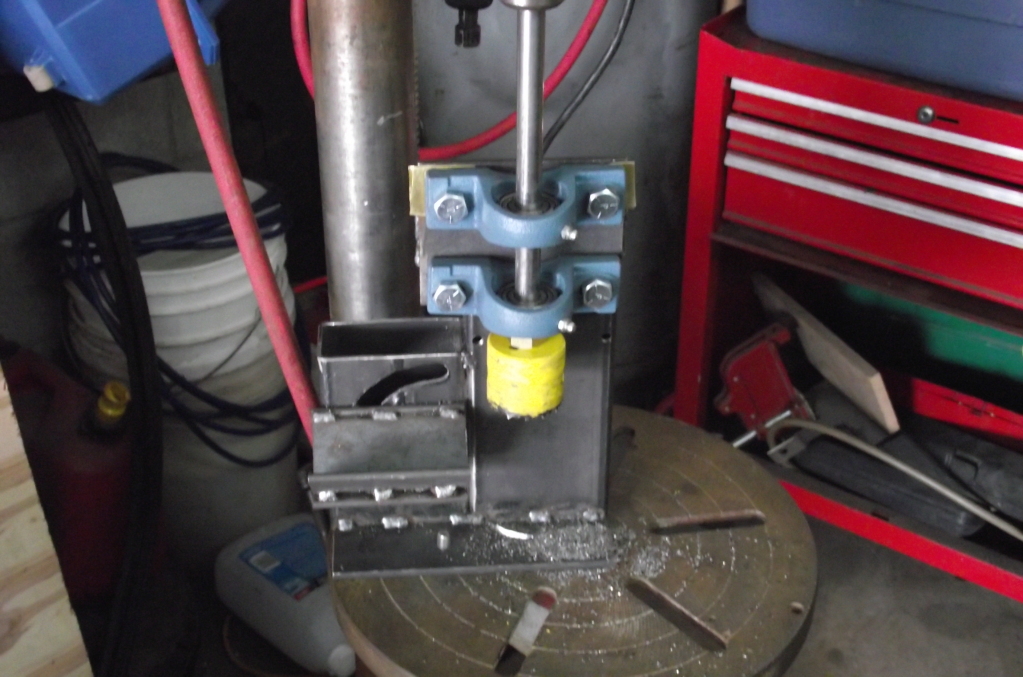

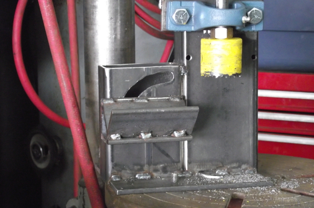

    I am looking to build a FED and knew I was going to need a tube notcher.
    After looking at the ones that can be purchased in my price range
    :)rolleyes: cheap), I wasn't impressed. After reading some of the impressions I decided to build my own.
    It was built using steel I aready had in the garage and all I actually had to buy was 5/8 rod for the shaft and the pillow blocks.
    The pillow blocks are a cheap vareity and required some shimming to run smoothly.
    The machine shop that I use regularly ,tapped the 5/8 shaft so that I could thread directly in to the hole saw without any adapters.
    Below are a few pics.

    thats on helluva nice tubing notcher.

    nice tubing notcher

    Thanks for the compliments.
    Works well to. Can be clamped in a vise and use a drill instead of the drill press if needed.
    Cost me less that one of the HF models, can't even get that one here in Canuckland.

    Nice job on the notcher. I was only the other day looking at them pillow blocks and wonder what I could make from them. This is one thing

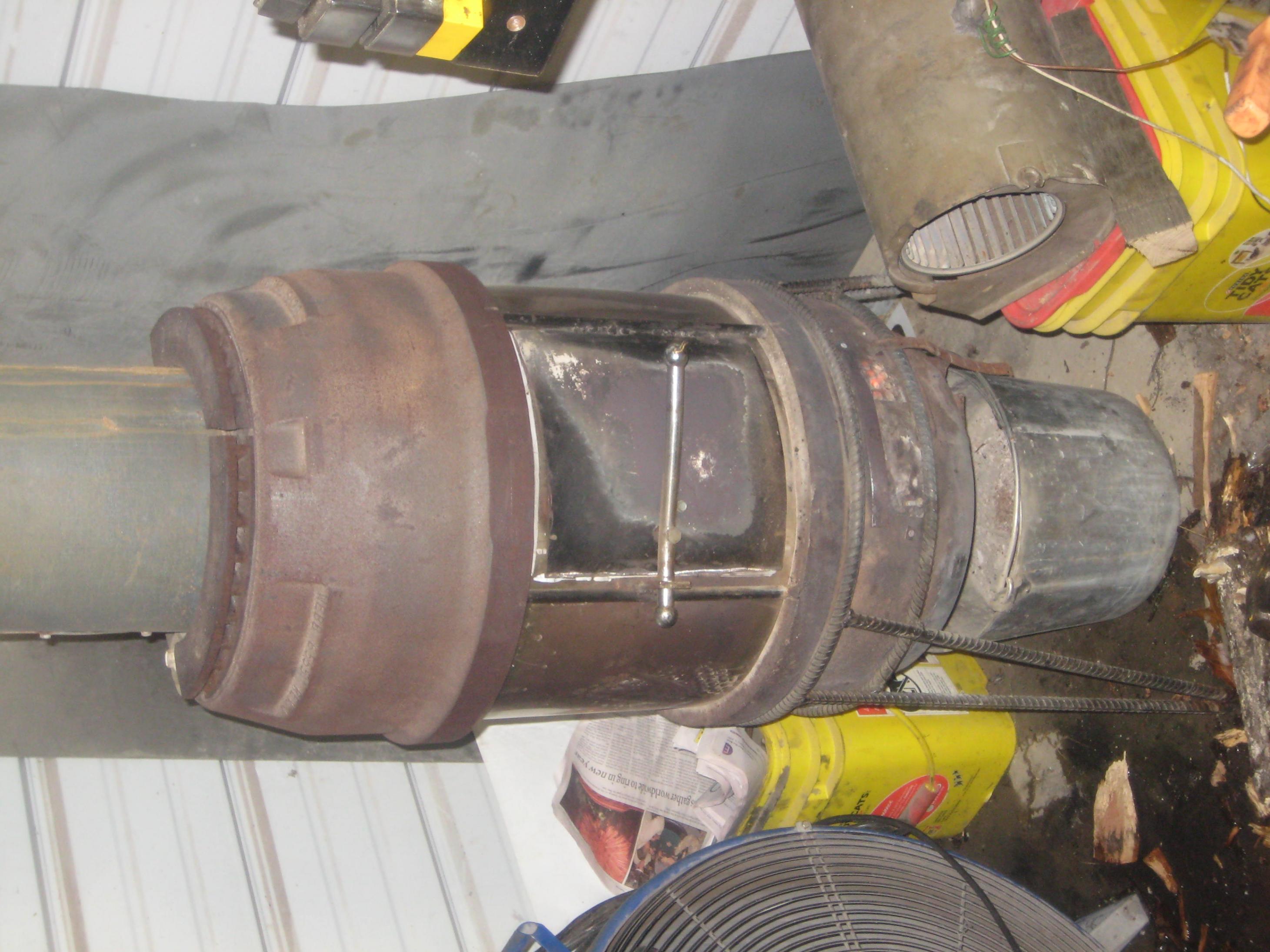

    wood stove made out of old brake drums from my dads semi...

    Built my own rotisserie. Drew it up on CAD, and then welded it together. I have full plans if any one is interested. PM me for details.

    Likewise, did the research and built my own rotisserie and body hoist that attaches to top arm of engine crane. Also built a trammel bar to measure ch***is, wheelbases, diagonals etc. Ensures accuracy etc. Can do measuring yourself. ;)

    Very similar to FrozenMerc's hoist except that spigot takes the load directly under the centre. Rams attach to brackets under spigot and on lower corner and spread the load evenly. Rams are parallel to vertical posts. I plan to drill the underside of spigot and tap a hole for a grease ****** so it remains lubricated and easy to turn with weight. No friction as short of interference fit, definitely not sloppy.
    Spigot itself and all RHS is 5mm wall so it will take a Galaxy 500 wagon body with complete drive train and interior. Definitely not a lightweight by any means. I'll add wheels later when I downsize current house and shed. There are a number of intermediate bars that attach between the lower horizontal arms to maintain integrity once there is weight on vertical uprights.
    Spigot has holes at every 45 degree and plenty of flexibility. Shaft has adjust-ability every 6". Base is 6' wide to add stability when loaded. Each hydraulic ram has a 2' stroke and 10 ton capacity so I can get it up to whatever desired level. Will definitely be even better when ***embling the car and better for us old folk, save crawling underneath on a creeper.
    My 46 Olds sedanette weighs roughly 3.6K lbs in stock form :eek: so no lightweight. Whole unit has plenty of adjust-ability to get centre of gravity right. Not the best pictures, still working on driving the new phone:eek:

    This is the body lift that attaches to top of engine crane, other one for inside car.
    External one (JPJ) just slides into RHS after you remove the extendable arm, internal (PDF) attaches to engine crane and balances once everything is centred. It can be made to pivot by using a large bolt over solid attaching flanges.
    I'll post my engine / transmission balancing tool with pivot that can be adapted similar to arm (PDF). Again lots of adjustability depending on what angle you want, great for front and rear ends and easy to balance weight distribution by using available holes. Again 5mm wall RHS. Better to over engineer than under engineer.

    I tried uploading this earlier but it would not upload for some reason anyway,
    This is a wood stove my dad and I made out of some semi truck brake drums,some rebar, some stainless steel sheet,and some other s****es, it works awsome for my little shop.
