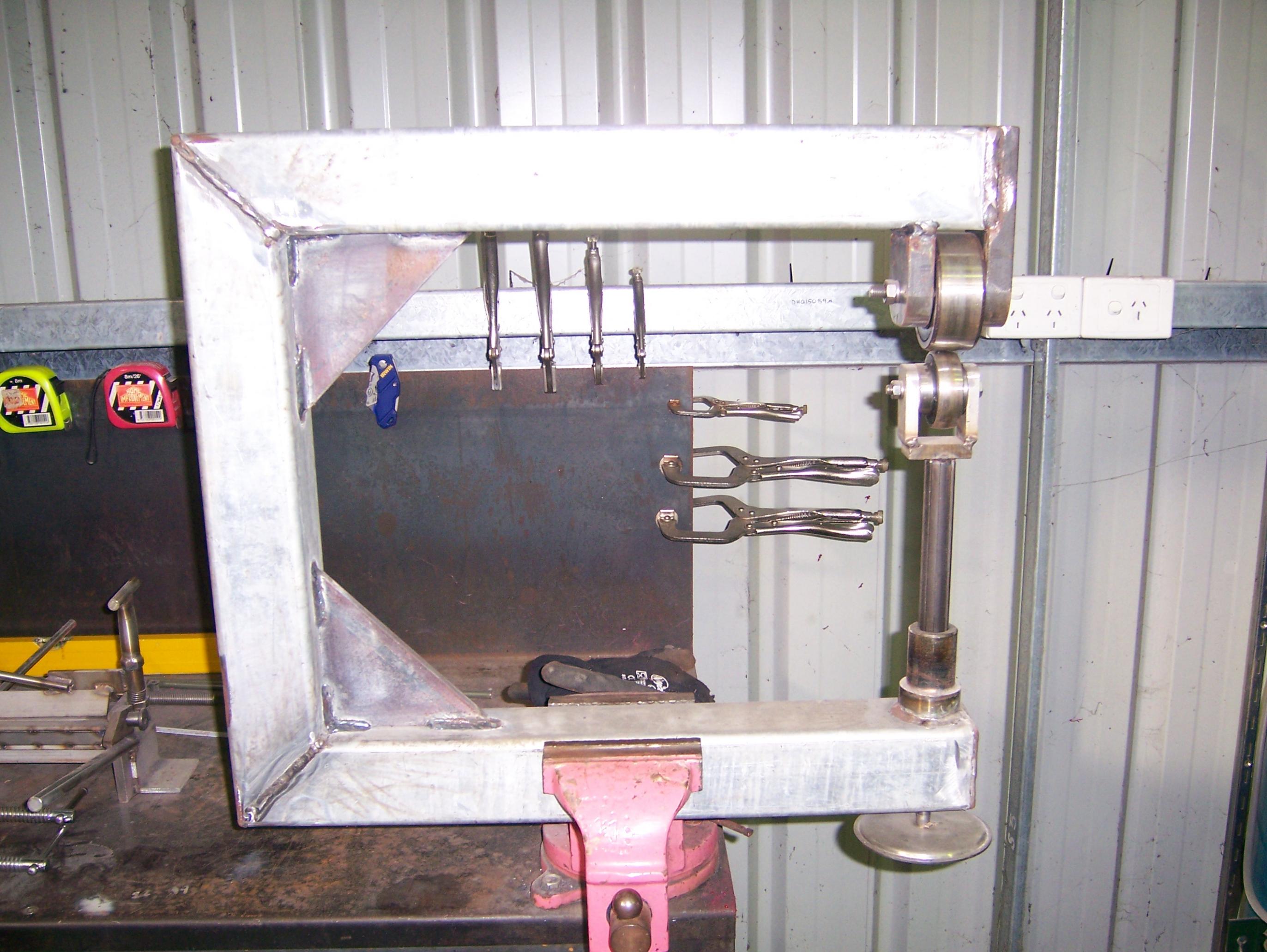

    Oh yeah bring that combo **** on!!!
    I've allready built an english wheel and beadroller after reading this thread. I also have a air chisle to make a planishing hammer out of.
    Realy keen to see this built.
    How about incorperating a mechanical louvre punch as well like the williams one?

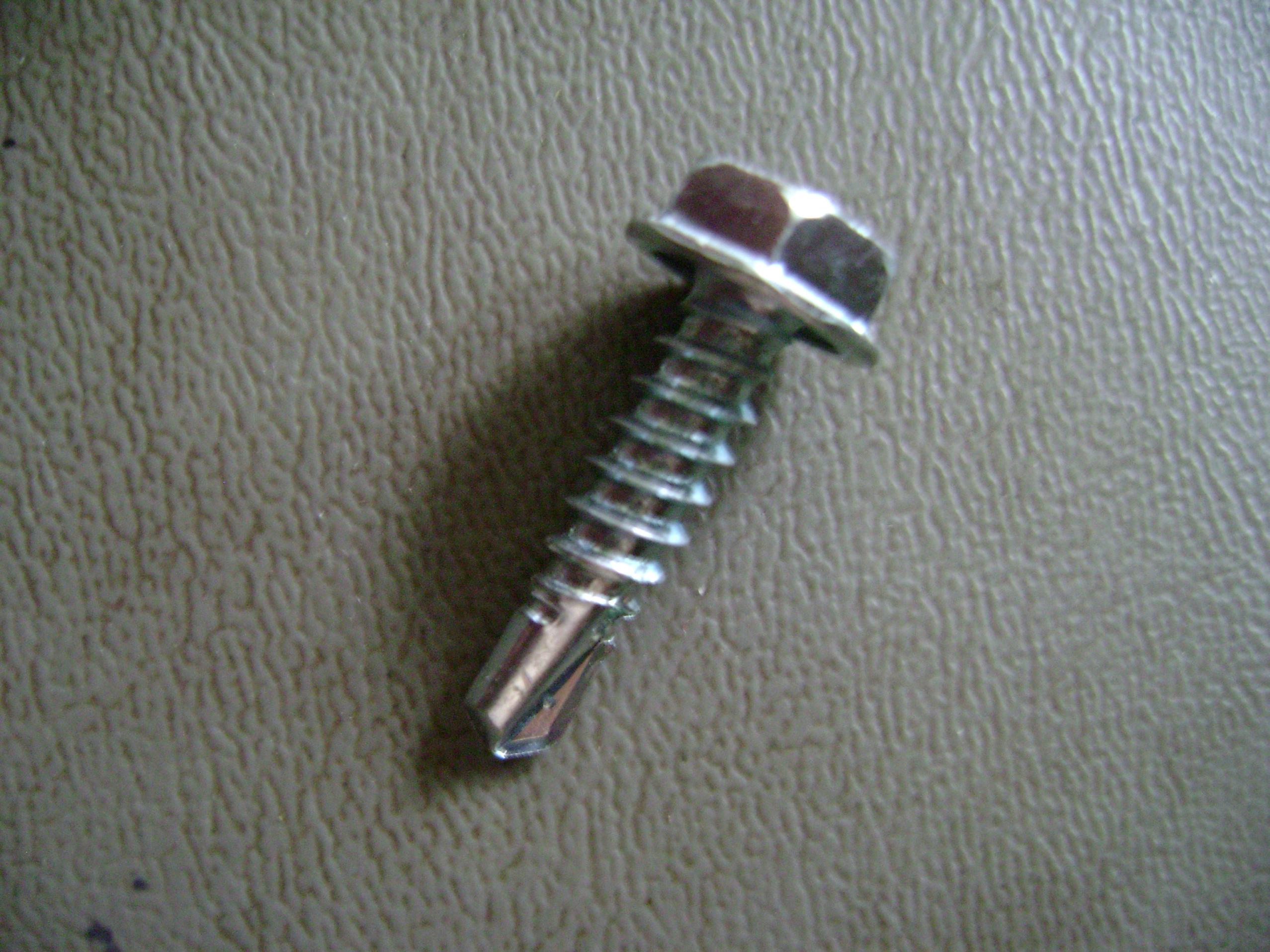

    I did not make this, as you can see, but while in the process of running my fuel line on my sedan the square tubing is 1/4 in. wall i finally ran out of drill bits and i didnt really have room for my angle drill and bit, so i got one of these self drilling screws, works great in that 1/4 in. steel for a pilot hole, am i dumb, or did all you guys know this.....plus you get a full box for 5 bucks..

    Ya,,,, Found out about them back in the 90's. There the Cat's *** Man.

    Yeah, they make great taps too. :D
    I've used them when installing clamps or hold downs in tight locations to be able to drill and tap the hole, then replace it with a better screw (I can't seem to get the self drilling / taping ones tight enough, the heads twist off before it happens :( ).
    Just make sure to get screws the same size and thread pitch. :D

    the next thing to this is when you chuck the screw (1/4 hex ones)directly in the drill.for one,its hard to drop,especailly if theres a ring terminal and wire on it-great for under dash ground wires.also makes great short bit when an angle drill is all the room you have.

    I've been using those for years instead of clecos cause theyre cheaper and no one steals em!!

    Here they are.

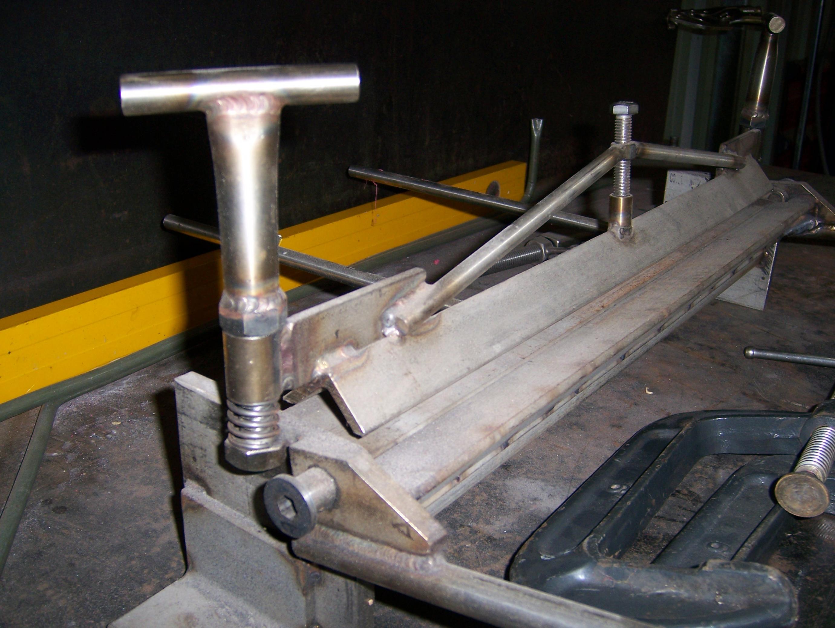

    Also an 18" brake and a 12" anvil

    Is that anvil made from a rail road track?
    Also do you have tge building plans for the 18" brake? I like the simplicity of that one you have there.
    Makes me wonder where you can buy surplus rail road track now days?

    The brake is a mixture of what came out of my head and looking at the six footer at work.
    Yes the anvil is rail road track. A guy i work with gave me three foot. Ask around, Now I have some every one seems to offer it to me!

    do you have a back shot of that brake? I would like to see more on the clamp setup. I built a break a bit back, but neet to improve on the clamp. That looks good.

    I'll try to get a couple more shots up soon for you guys.

    Hope this helps. The third shot is from behind.

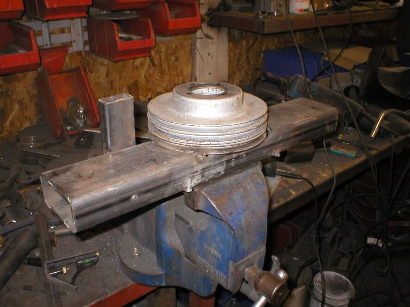

    10 minute square tube bender, [​IMG] [​IMG]
