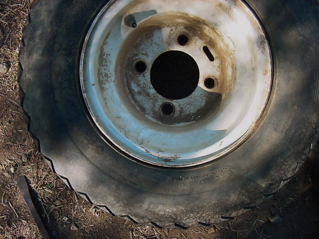

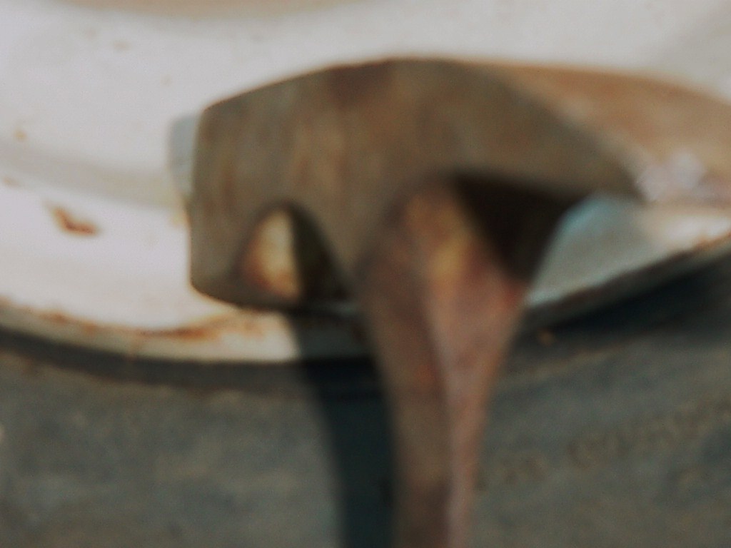

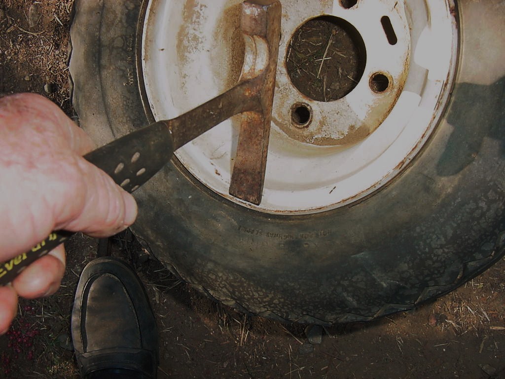

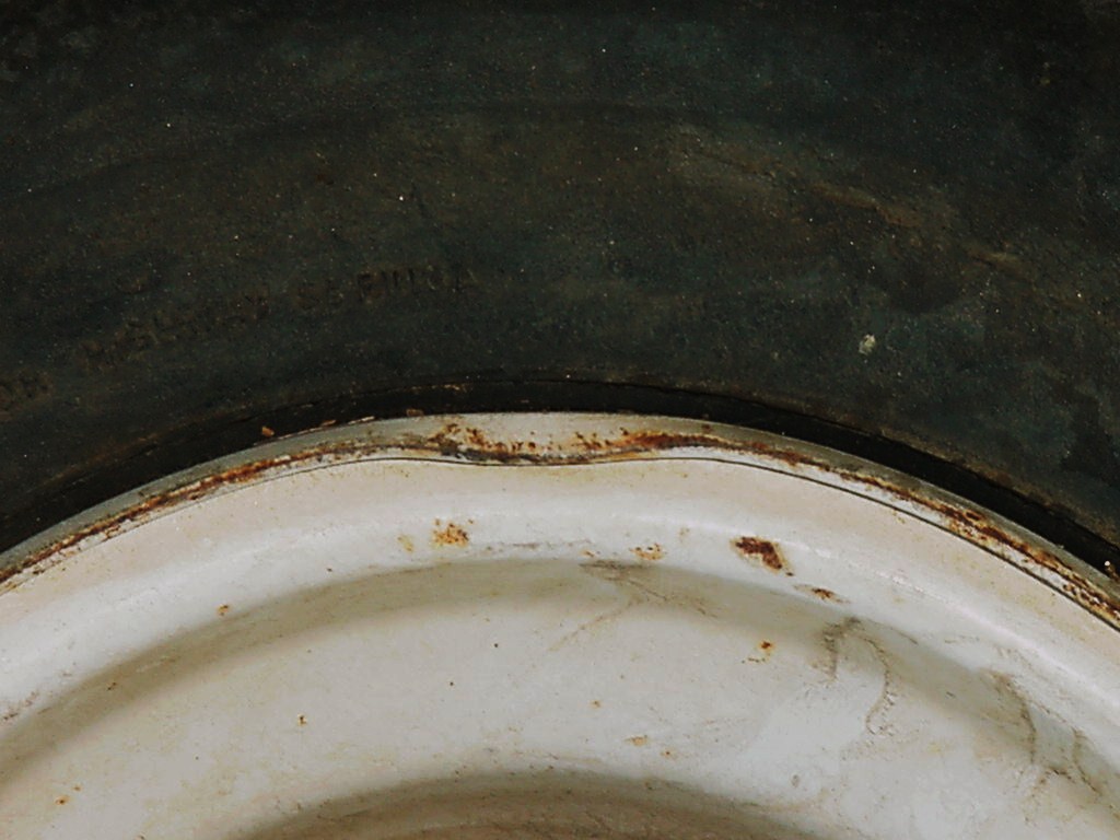

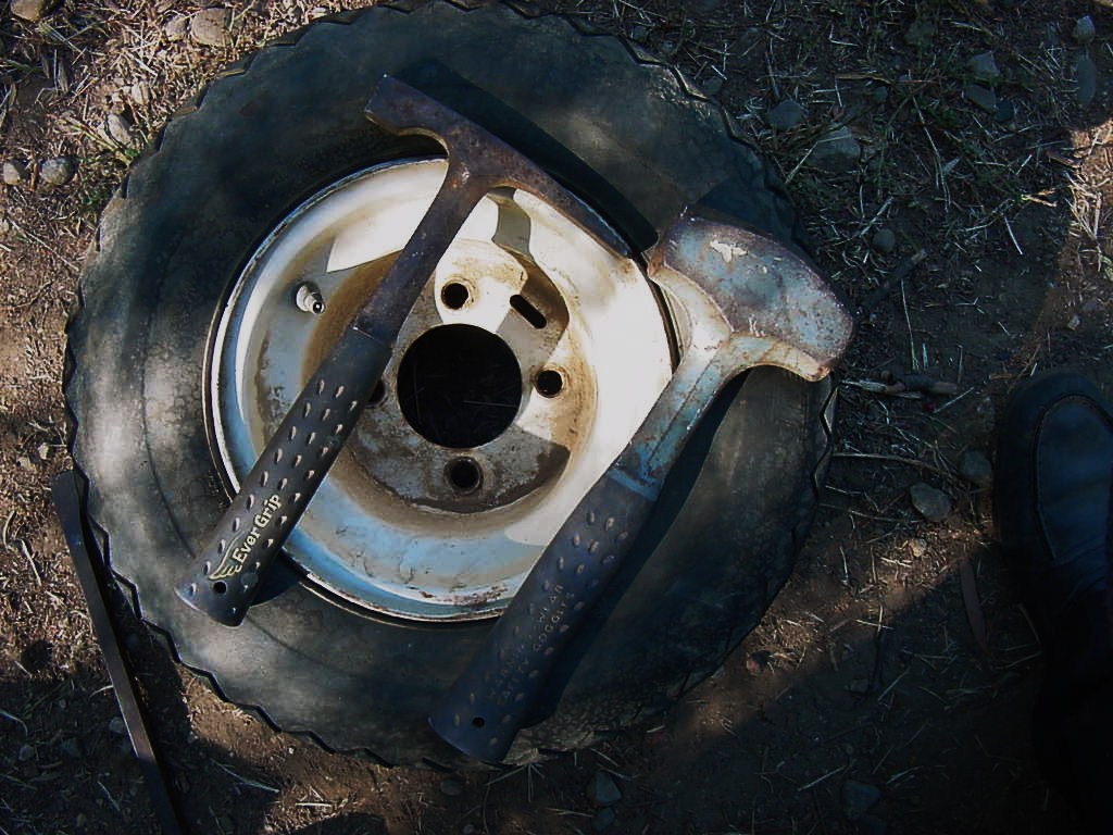

    This is not a homade tool but more of a handy use of existiog tools.
    I have a lot of early Ford spoked wheels in addition to other wheels including golf cart wheels.
    In order to take pictures for this thread I could only find one golf cart wheel for illistration and it only had a slight dent on the rim.
    However the dent was bent back intill it almost touched the main body of the wheel. Kind of a worst case scenario.
    The first picture dosn't show how tight the rim is to the wheel but I used the much dulled and rounded cutting end of an old brick hammer to get behind the fold and started hitting it with the 2 lb hammer.
    Warning: Wear face and body protection to avoid steel fragments from the hardened faces of the hammers fragmenting.
    I have never had this happen but at can happen.
    Anyway each time I struck the brick hammer I would change the angle of the hammer bringing the cutting head incontact with the rim.
    After I got the rim away from the main body of the wheel I turned the hammer arousn and placed the bottom edge of the face against the rim and struch the flat top of the hammer to complete the straightining job.
    Sorry for the bad focus on one of the pictures.

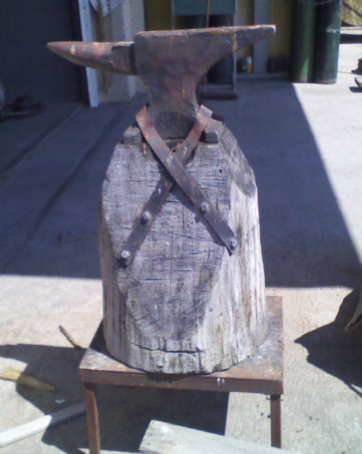

  13. realkustom51
    Joined: Nov 14, 2005
    Posts: 664
    realkustom51
    The Anvil!:)

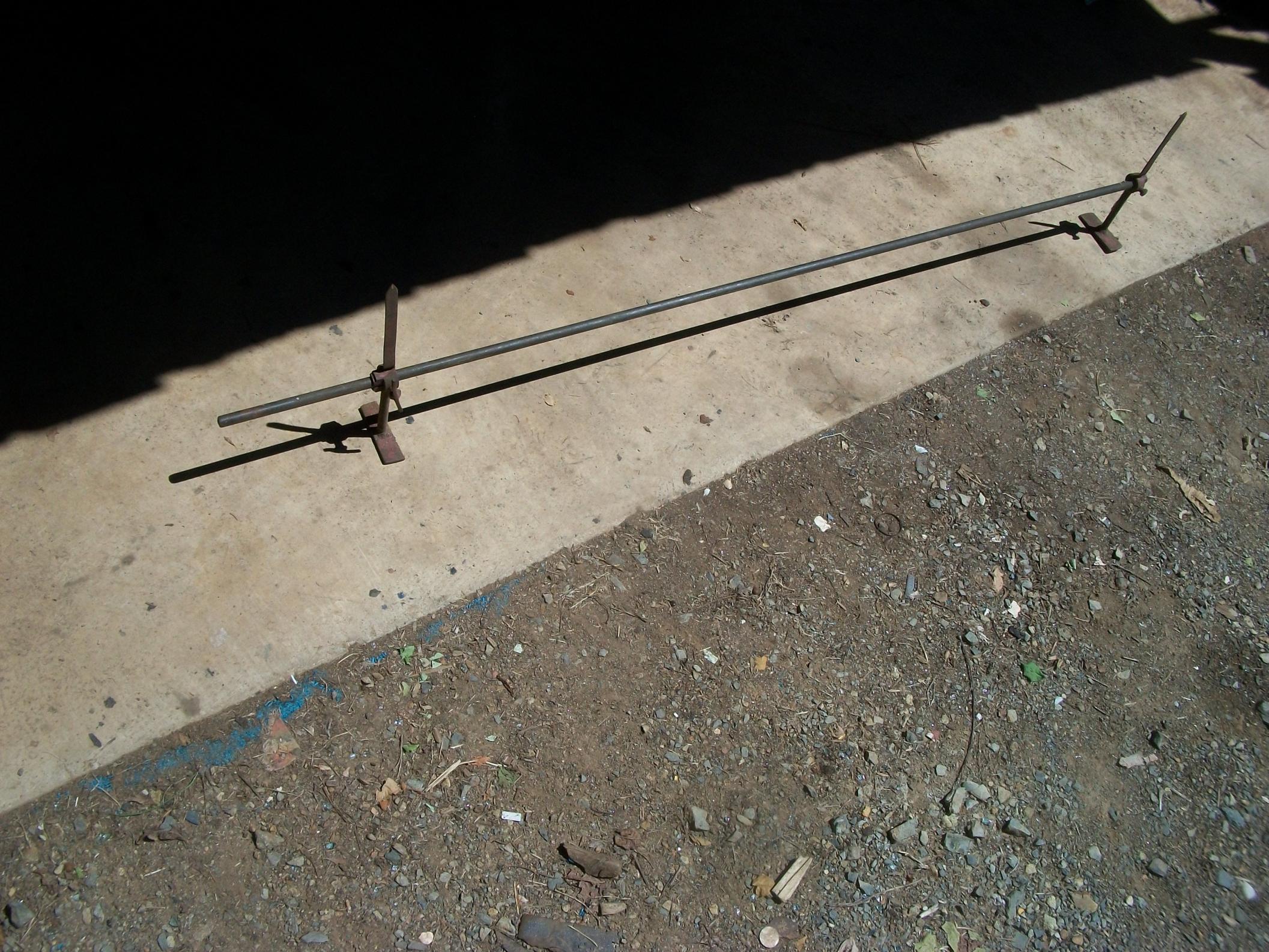

    This toe in tool is a ground rod, two parts off flathead Ford starters and some flat strap.
    I used it after my sons Jeep was broadsided, bending the rear axle shaft and the rear axle housing. My son took the Jeep in for a 4 wheel alignment after I installed another axle out of another wrecked Jeep where I had to cut off and install replacement sway bar mounts.
    The fancy new laser wheel alignment machine said my installation was 3/10 of one degree off. :)
    j-jock likes this.
  23. dawford
    Joined: Apr 25, 2010
    Posts: 498
    dawford
    chrisntx said,
    "A large adjustable crescent wrench works Very Well for this job and is easier and safer than using a hammer"
    The picture did not show how tight the rim was to the main body of the rim.
    Any size adjustable end wrench would not fit into the very limited space that there was available.

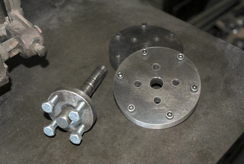

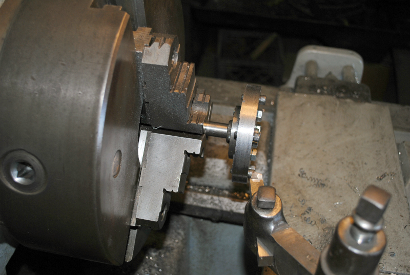

  29. Needed a mandrill for a bit of lathe work. Fortunately, I had an old Chevy water pump laying around.
