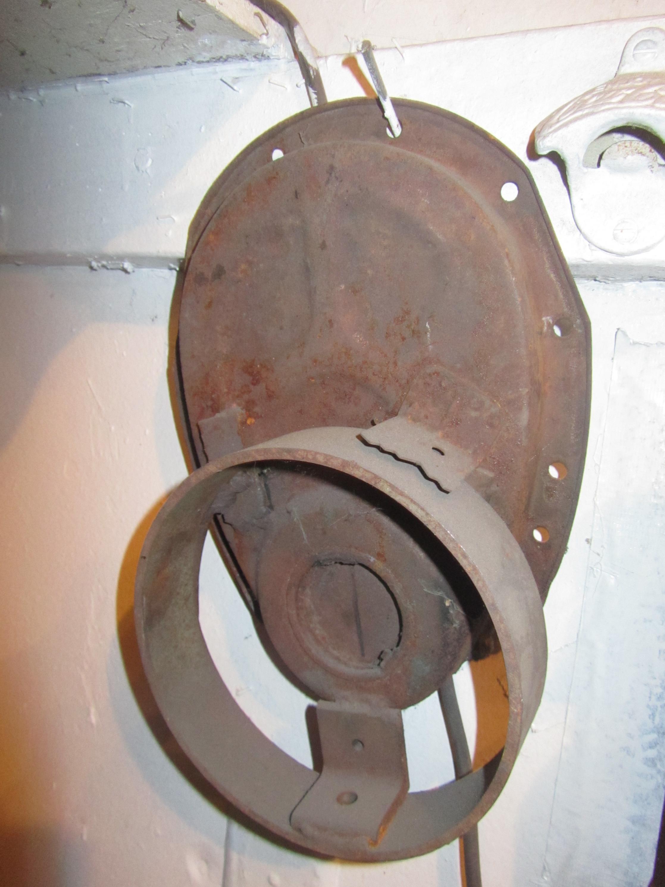

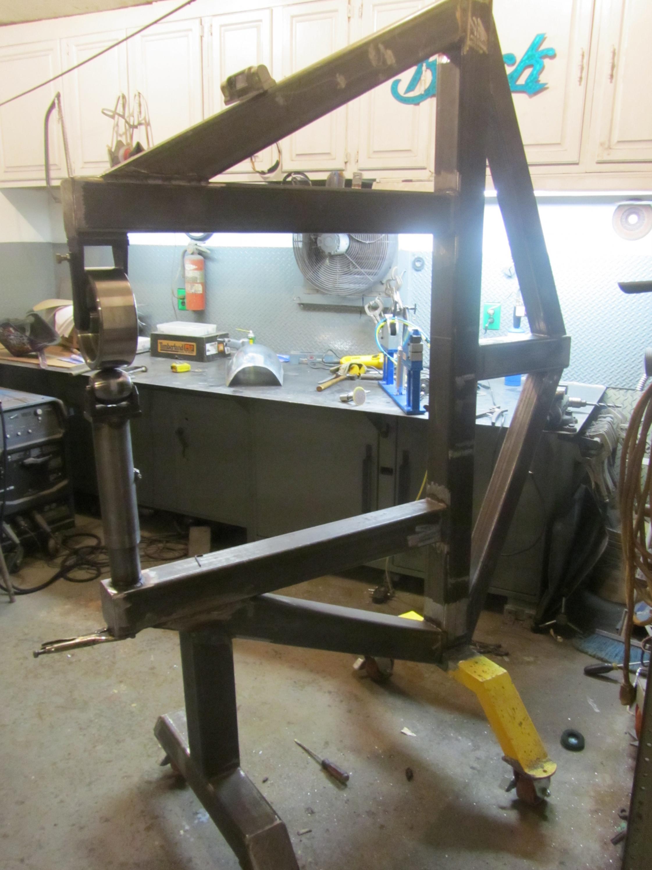

    Here is some stuff I have made
    English Wheel is 4x4 1/4 tube with a 36in throat. You can see the yellow rear leg from a POS HF wheel:D. The adjuster I used is parts from a old radial arm saw. For the upper wheel I called up Joe from Hoosier patterns and had him engrave are club name into it. I also got the quick release and lower cradle from him. The lower 3X3 anvils also from Joe I picked up off Ebay cheap. I still need to build a kick wheel for it I just need to find a 10in steering wheel. Once it's all done I'm going to shoot it with some Flake and do some crazy candy panels:cool:
    Curved T handle is just some 5/8 round bar welded to some s****
    Timing cover I use on my plastic mock up block to check clearance

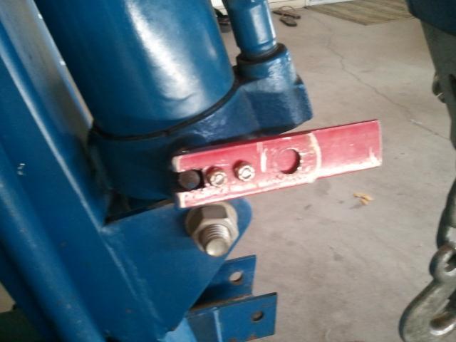

  5. A big thanks to Tooljunkie for a great idea... just finished making a handle for my cherry picker. :cool:

    thats why i posted it.i have used a couple ideas from this site myself.guess i should have posted pics of the depth guage on my hydraulic press.just a piece of tape measure and a pointer.

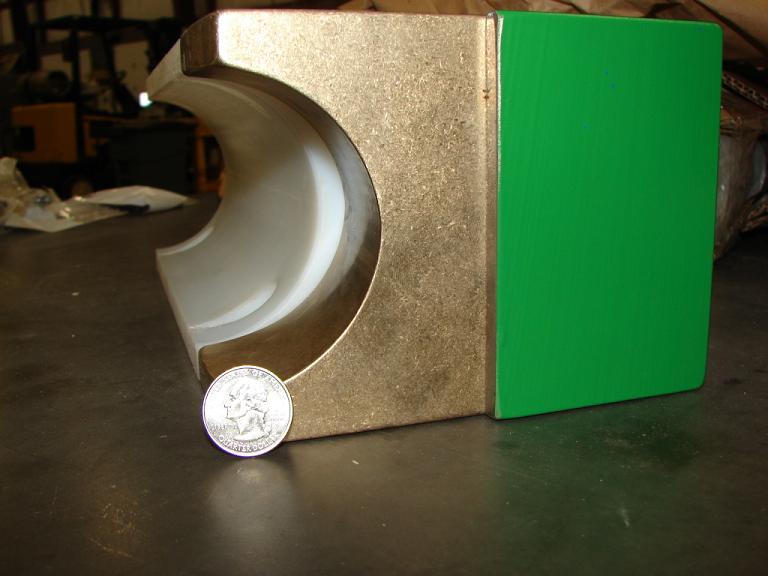

    Hello I am planning into make a tube bender
    I have seen two options for the follower, will like to hear opinions on what is best????
    roller or block

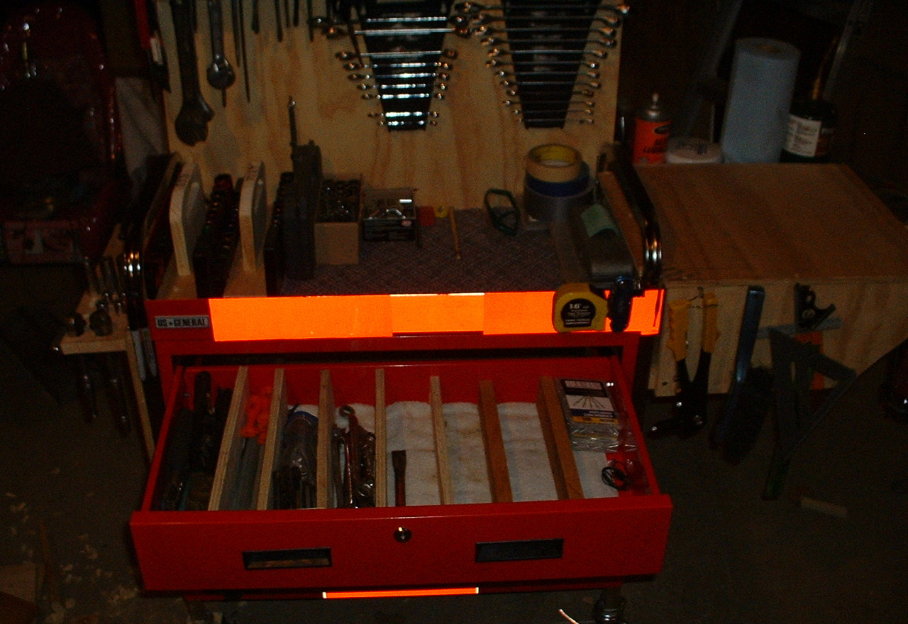

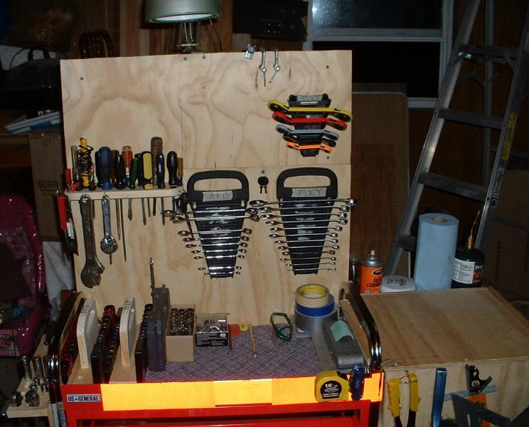

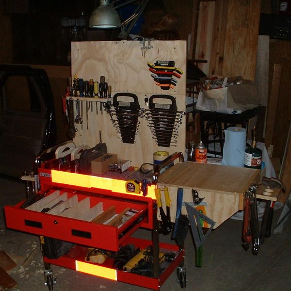

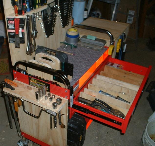

    My Tool cart Mods.
  11. RidgeRunner
    Joined: Feb 9, 2007
    Posts: 906
    RidgeRunner
    from Western MA
    Neat!
    I might think about locating the torch a bit further away from the towel roll and aerosol can though.
    Ed
  12. bkap
    Joined: Dec 2, 2007
    Posts: 119
    bkap
    Nice, indeed. But just because one stores a torch next to towels and aerosol cans doesn't mean its used there. :)

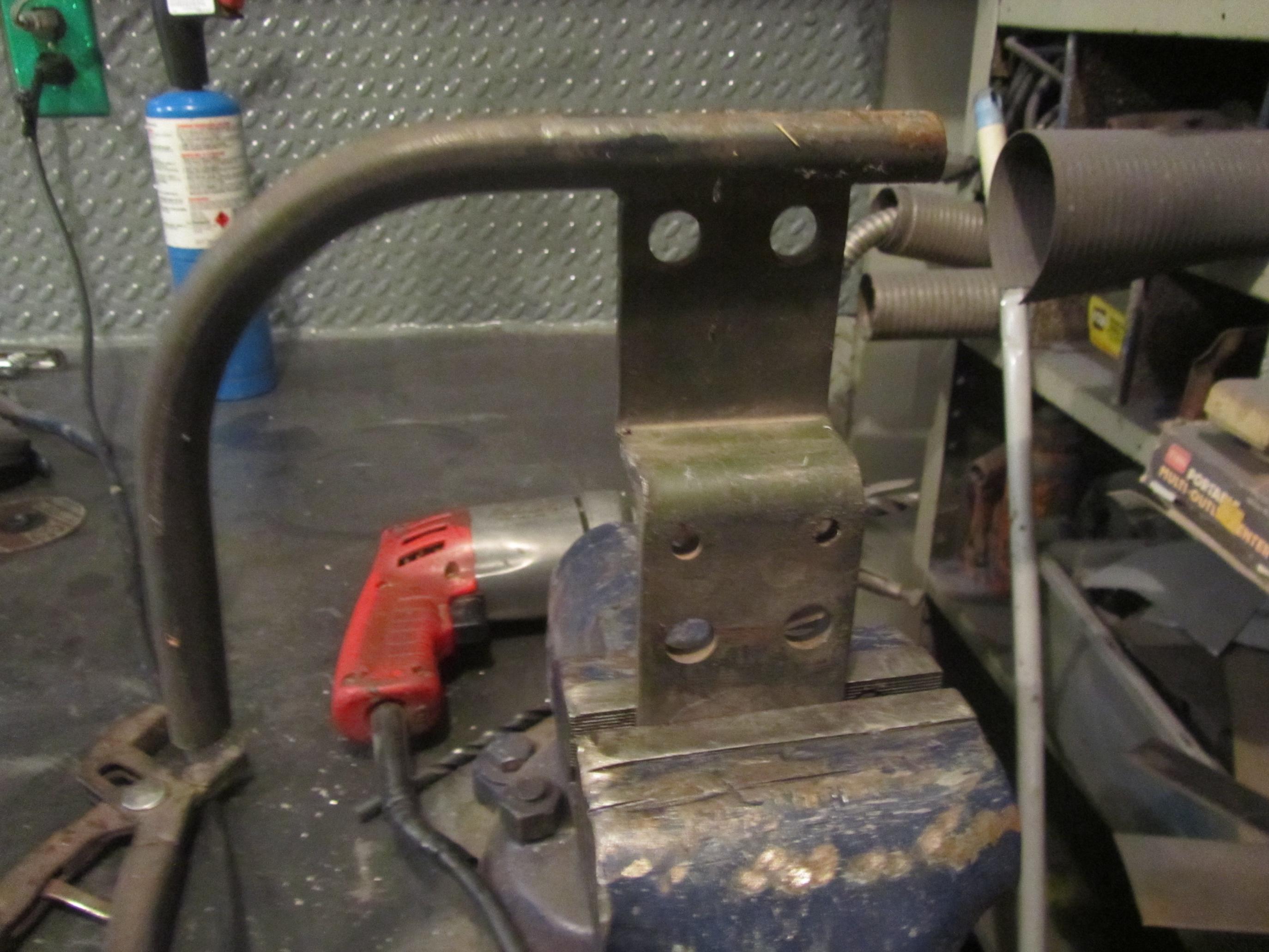

    Since it's raining I have some time in the shop today so I threw a couple of s**** pieces together and made a handle (thanks tooljunkie) [​IMG] . Call it overkill if you want but I added a knob I had laying around on it. I've already tested it and it works real good.
  15. dallas1
    Joined: Oct 31, 2011
    Posts: 11
    dallas1
    Right!:)

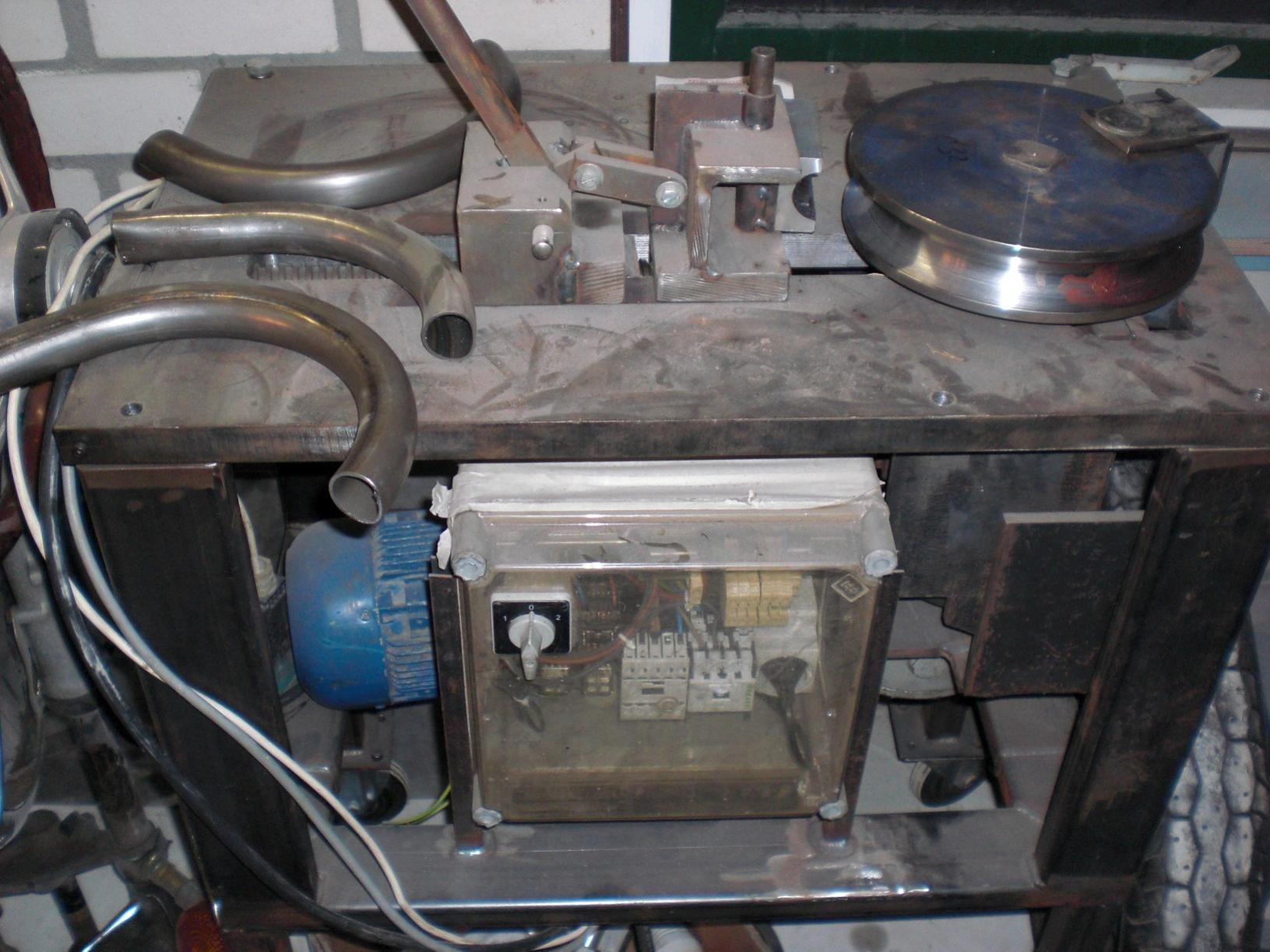

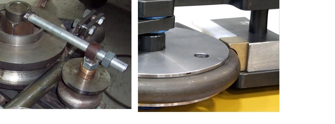

    i've build a bender myself and used a guide block and one thing you have to keep in mind is that the block needs to be elipticle (?)/ oval shaped so the pipe is bend in a counter shape so it won't deforme as much during bending. Sounds logic? ;)
    A pic of what i mean.It's a baileigh.... it made a lot of sense to me...
    Post a pic when its ready!!
    This is mine..(still in progress (for a while)):p.
    I've made the guide block's before i talked to shane so its "****" with thin walled pipe, you can see the D shape in de bend.....
    Good luck!

    i didnt realize how handy it was til i used it a few times,especially on the hydraulic press,makes for quick easy adjustment.no fiddling with a two foot long pipe.

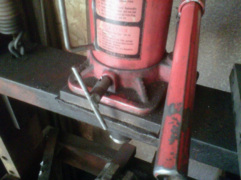

    I just thought I would throw this up because a few of you like the other variations.
    The part that connects to the jack in my press is a thick walled tube with a deep notch in it. It is then slid on and crimped together with a large pair of channel locks and a handle is welded on. From what I hear that handle has been on there for 20+ years. I will say it is very handy..
  23. plym49
    Joined: Aug 9, 2008
    Posts: 2,802
    plym49
    from Earth
    Simple yet elegant.

    venturesomerite
    from CT
    I really like that release on that jack, I may have to do something similar.
