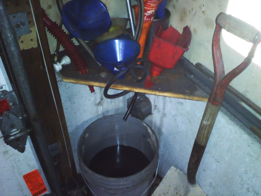

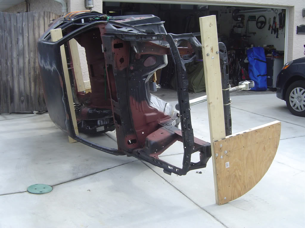

    The rotisserie is not mine but the other two are...

    good use of a corner!
    i put a pail there,never thought to put the funnels above it.
    now ,with the plasma torch i can make the ***orted holes i need,a lower pan for draining filters-man,the creative juices are flowing.
    Thanks,Joey-D

    That rotisserie is the ****!! I'm gonna build a few!

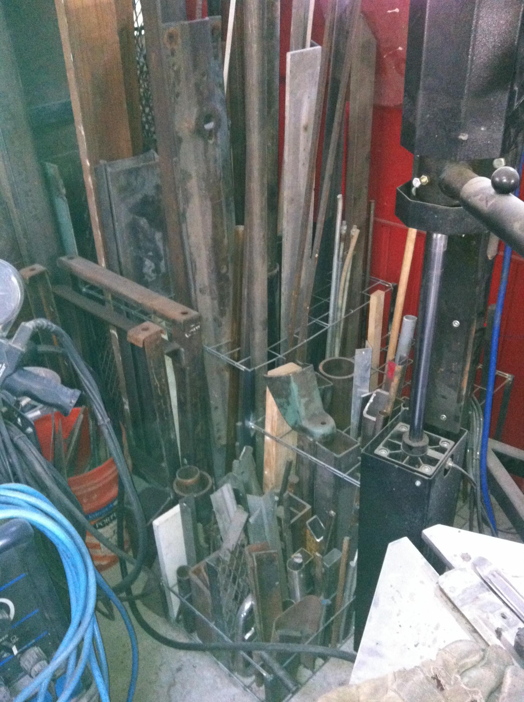

    He is my steel rack made out of s**** wire shelving. Now I can see what all of my off fall is.

    Great idea. I just reorganized all my s**** metal using old milk crates and buckets for similar types: like round, solid, square, angle. I like your's for the longer pieces.

    Lots of great ideas here. I appreciate all the postings. I was fighting the s**** metal mess in the shop today. I'm using Joey-D's idea tomorrow to help sort the long pieces. Thanks.

    Joey-D, great steel rack. I have had one similar to that in my shed for about 12 years now that is used on a regular basis. MikesIron, those vise grips are too neat stacked like that. Mine are stored in a similar fashion, however, i have vise grips one end, and G clamps the other end.

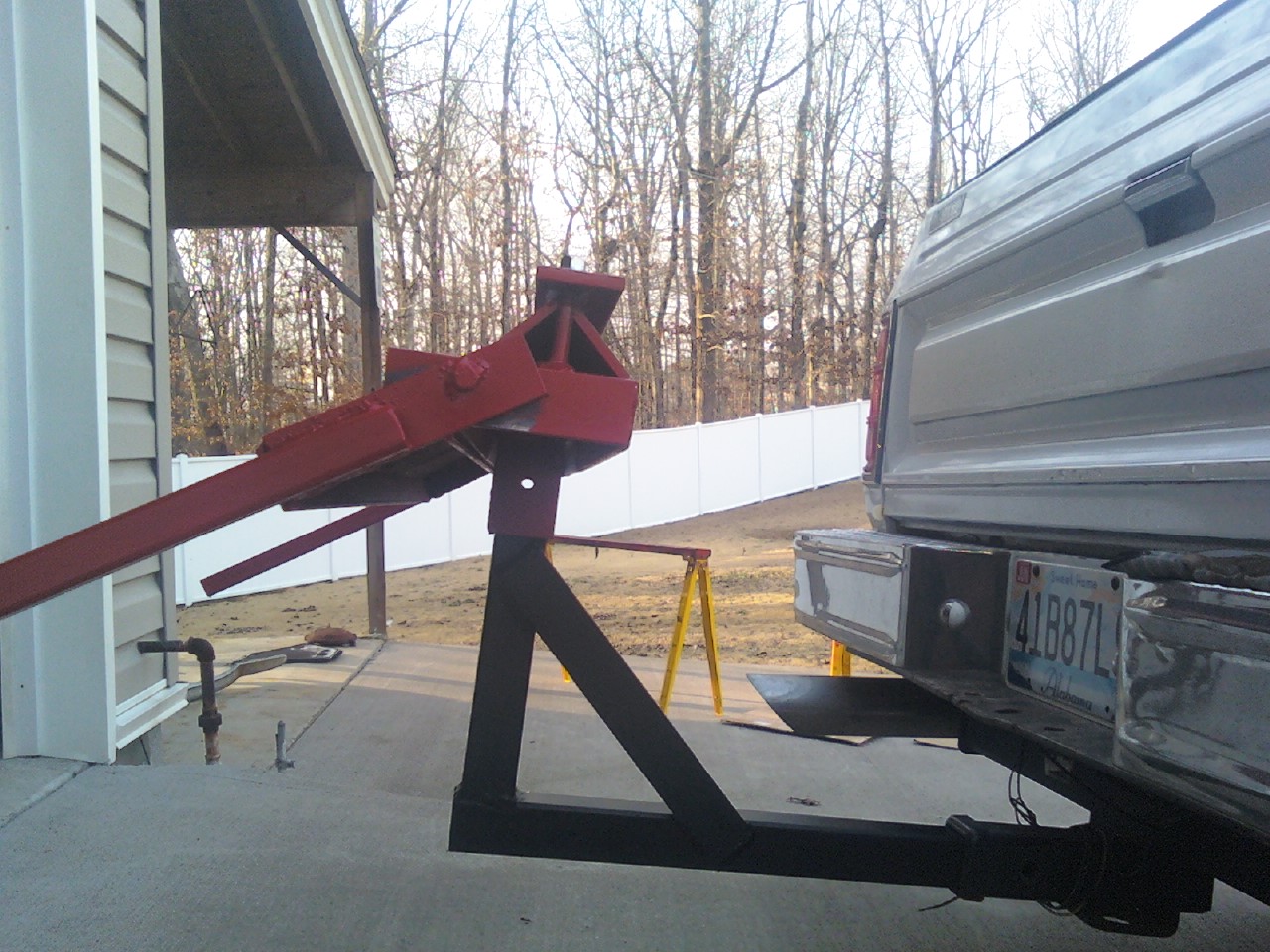

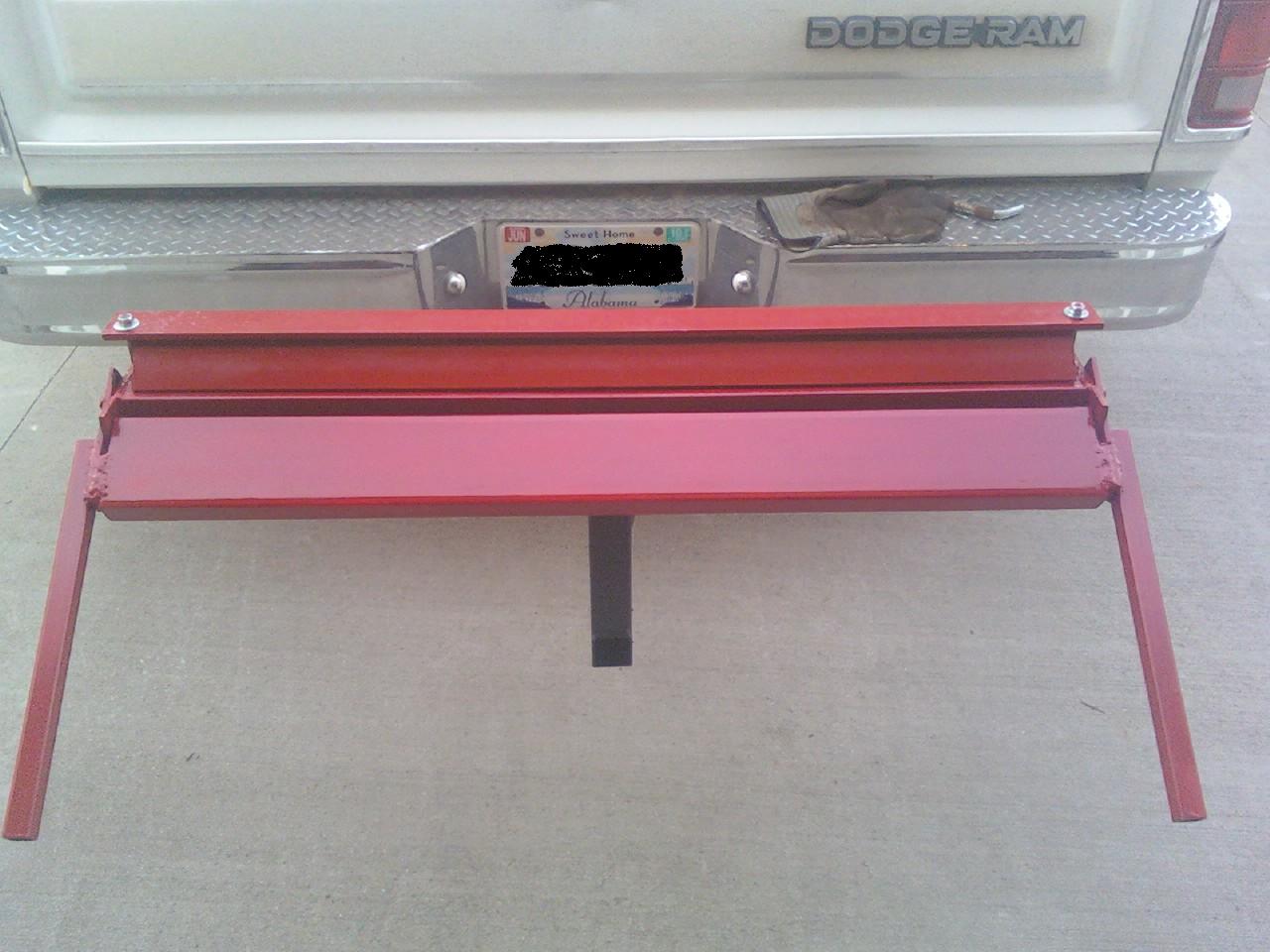

    Made this a couple of years ago. Wanted it portable if I needed to take to another location to help friends so I made it so that I could slide a hitch pin in to hold it for transporting. Another advantage is, with tailgate down, the truck bed acts as a table to hold long pieces or sheets of steel. Have bent up to 1/4 flat bar with no problems.

    another brilliant idea! portable and rigid.i made my brake ,but havent figured a base,considering my vise is on a reciever already,and i can use it in my hitch,i never thought about doing it with my brake.

    Damn nice build

    You could mount receiver tubing under your workbench so you could use it in the shop as well. Nice design, really versatile. [​IMG]

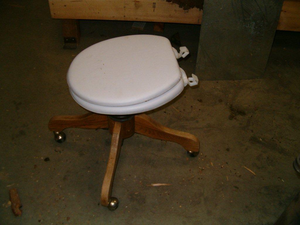

    new shop stool
    PADDED!
