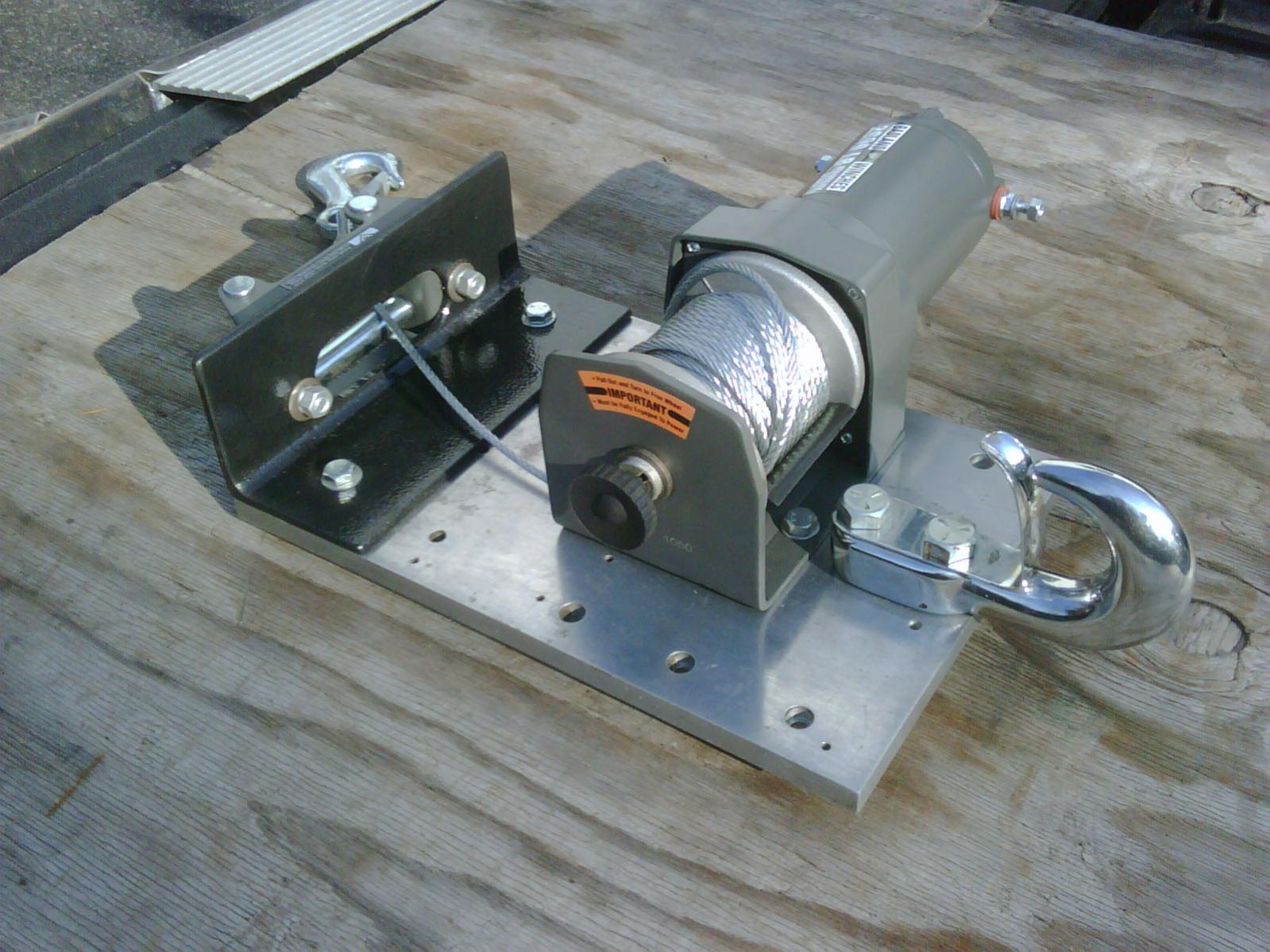

    Quickie portable winch for loading and unloading trailers:
    It's the HF 200 0lb 12v el cheapo ATV winch (I was surprised that it was better than I expected), aluminum plate, tow hook and a wide angle iron mount for the fairlead. Built from s**** on hand. I tried it out this weekend to pull a cement mixer up into the bed of my truck. Worked fine. I am going to add wooden lateral skids to help steady it but wanted to see how it worked first.
    Note: It is not attached to that plywood; it is just sitting there.

    That's exactly what I had in mind, with that $49 HF 2000 lb atv winch! I didn't know if that winch would hold up, so thanks for the little review ; ) I was going to attach the winch to 2 2"x4" boards (stacked & bolted to make 1 4'x4' for rigidity), run horzontally and attached at the front stake posts behind my pickup cab. Then winch up the heavy items on atv ramps. Once I get 240v in the house I am at now, I will eventually weld up a steel horizontal piece, and attach it to the bed sides with grade 8 bolts.

    Yep, we are thinking alike. That is indeed the little 49.95 HF winch and I was very surprised as it far exceeded expectations. Note - the shear pin looks puny and I am sure that that will go first if you overload the unit.
    The stake holes on my truck are covered with a bed liner. So here is how I secured the front of the winch: I took a long rope and looped it under the frame between the cab and the bed. The rope went up between and then over the front edge of the bed. Rope against bed liner did no damage. This is strong enough to pull up a cement mixer (as I did) or a quad. It also gives you a better angle as the winch sit in the dead center of the bed and the rope angled down, then a straight shot down the ramps. Your plan will work, too, and I might well have done it that way if I had access to the stake pockets.

    i had a small winch mounted in the back of my truck years ago,was a piece of angle iron bolted on front box rail,had more than enough support to pull up a quad.

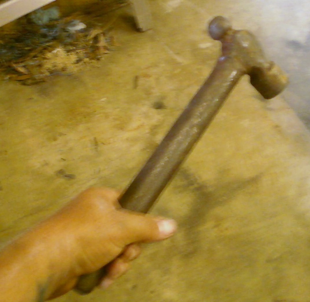

    the hammer is what i use to beat the hell out of stuff.
    the handle works as good as the head.
    a piece of rod is welded to the head, then pipe is slipped over that and welded on allowing the rod tovibrate when you hit things.
    no vibration to your hands that way.
    both ends are welded up to keep water and other stuff out.

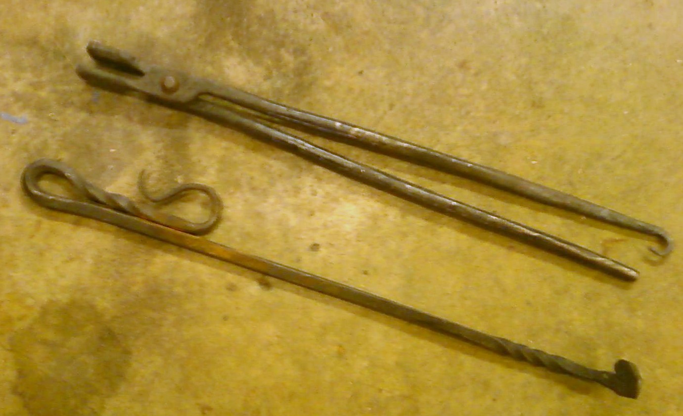

    the poker and tongs are just a little blacksmith practice

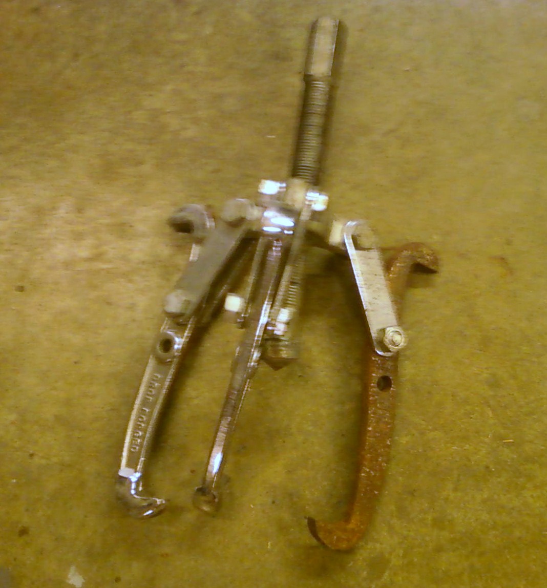

    and i made a piece to repair the puller
