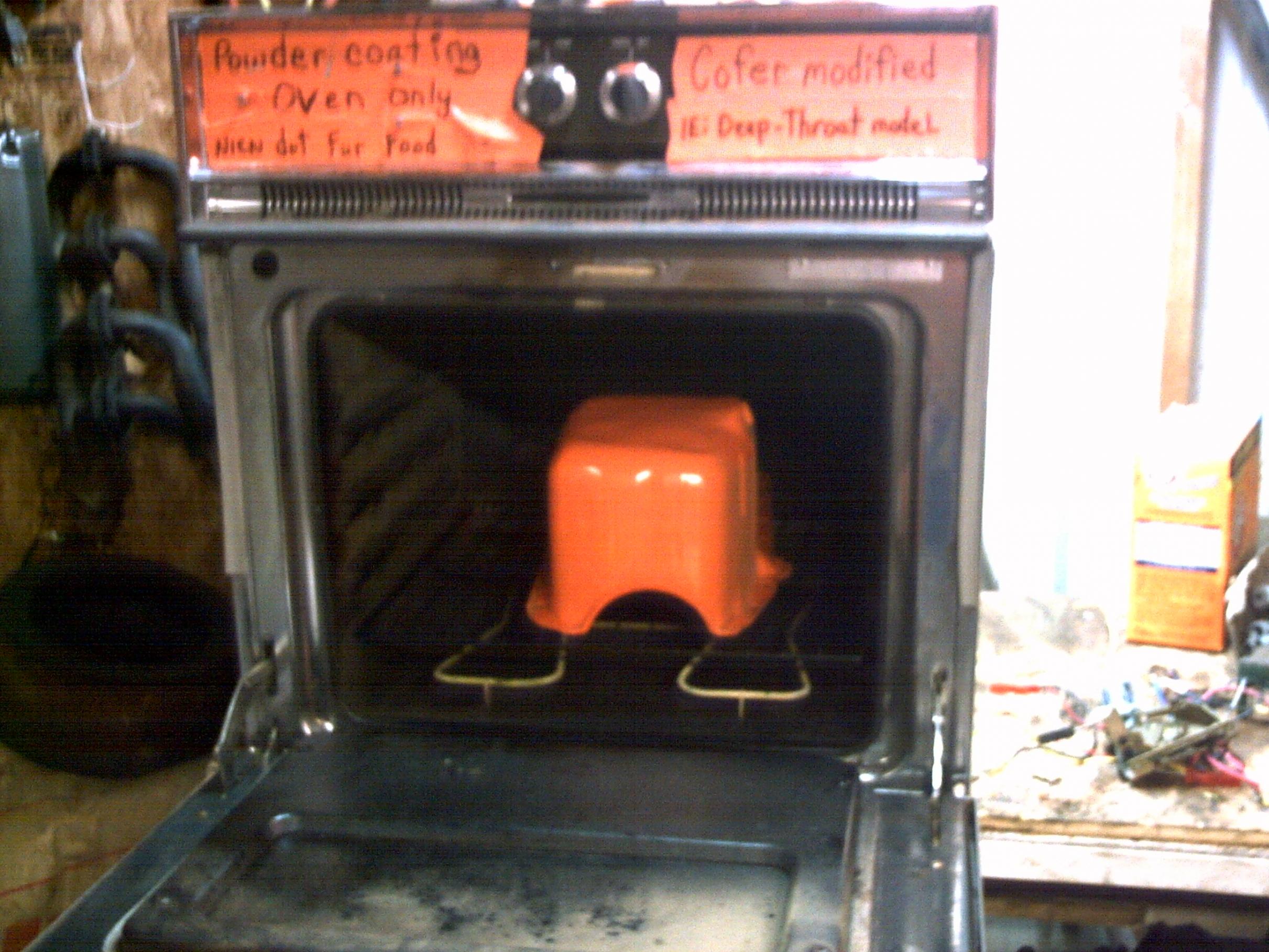

    Shop sized powdercoat oven to do small engine parts.
    A oil pan would not fit, and had to do valve covers one at a time.. and I am impatient..
    SO, I cut the back out of oven, extended it back 10 more inches, welded the old back onto the rear, now is "DEEP THROAT" enough to swallow a oil pan and ask for more.. or a set of valve covers, timing cover and pulleys.. I wrapped the box with "cer-wool" is what looks like comes in them ovens.. or buy two ovens and weld them together and put the insulation back on. I seem to do everything the hard way.
    Powder coating for the uninitiated is like baking cookies.. you get the oven hot, pre heat up the parts, take them out, spray them with powder till they look like velvet, then put them back into the oven at (mostly 400 degrees) and "time" after the flow out, (gets wet and shiny) and the polymer sets to become a very hard coating you can't get off even if you want to easily. It just shoots clean with a water hose.. easy to take care of. Resists chips and scratches when done right.
    Eastwood and other suppliers have cheap pc guns.. mine is a puffer, a fan, no air hose, and a cup to put the powder, a high voltage clip to "static cling" the dust to the part..
    THIS is for a V8-sized parts.. if you got a six cylinder or tinker with them they are longer..

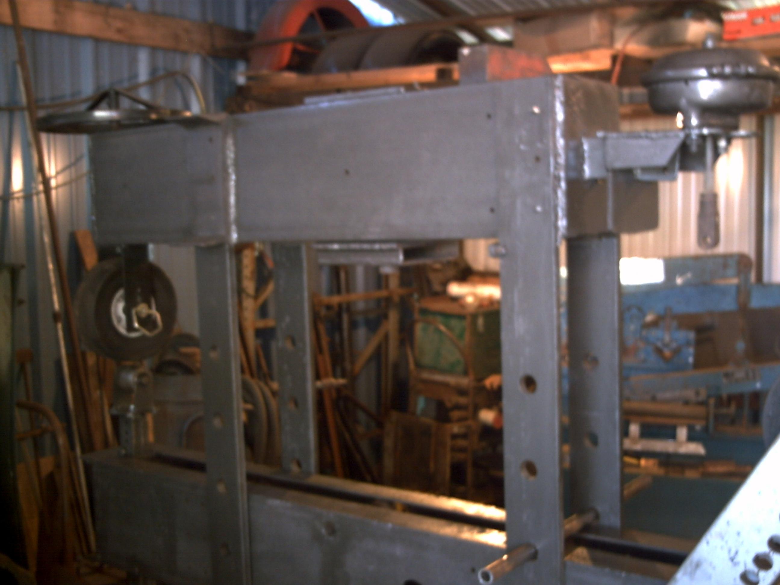

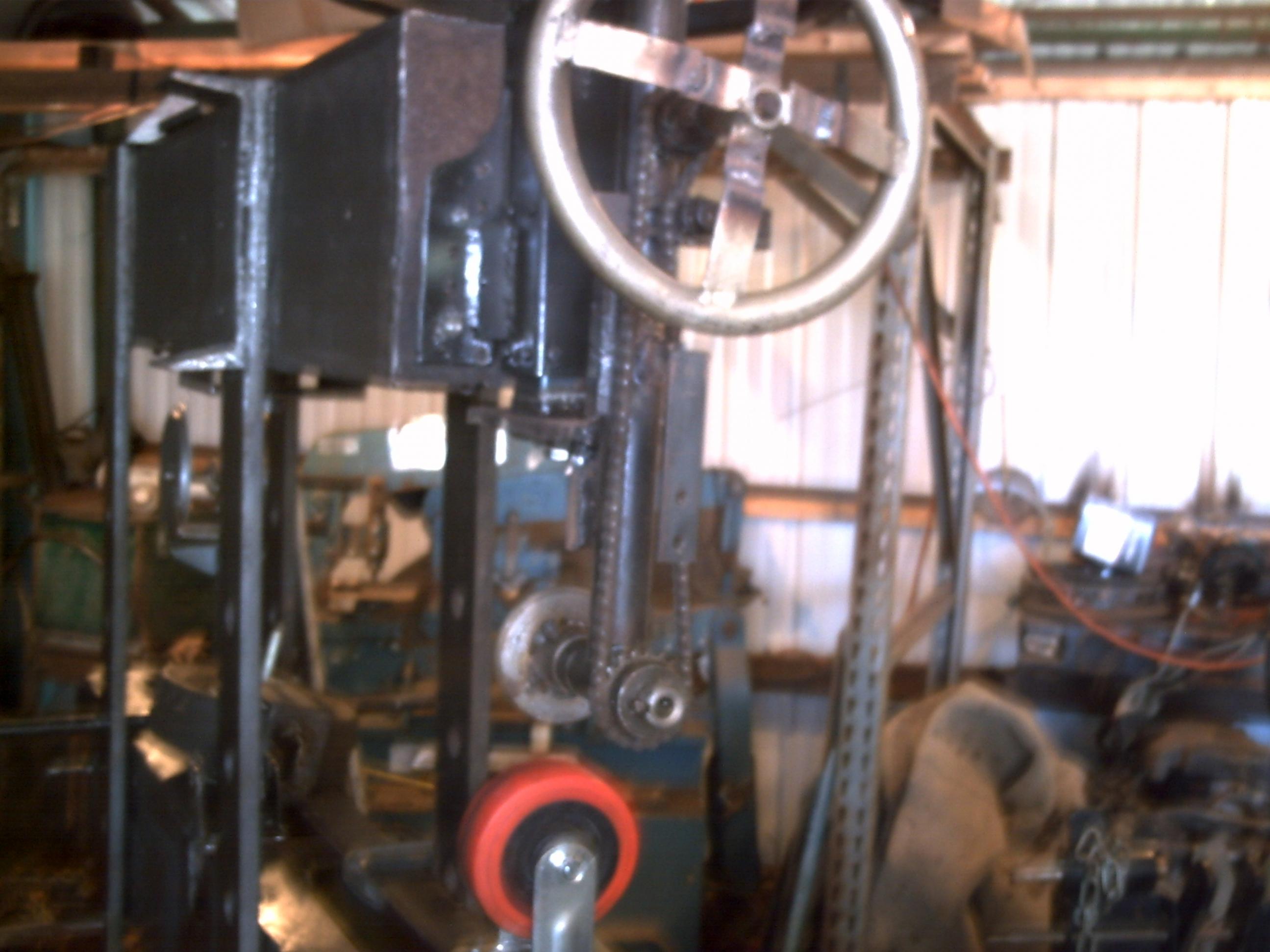

    A C-frame press.. lower bed slides from end to end, has a e-wheel top adjustor on one end, has a yoke to put rollers on bottom.. makes a fair e-wheel.. has on the other end a Brake pod off a semi truck to push things.. and in the middle is the normal press area.. thou I have used the screw press-ewheel adjustor as a bushing press on a antique harley case.
    The thing with the orange urethane wheel is a tipping roller, to break the edge on sheetmetal for a flange..

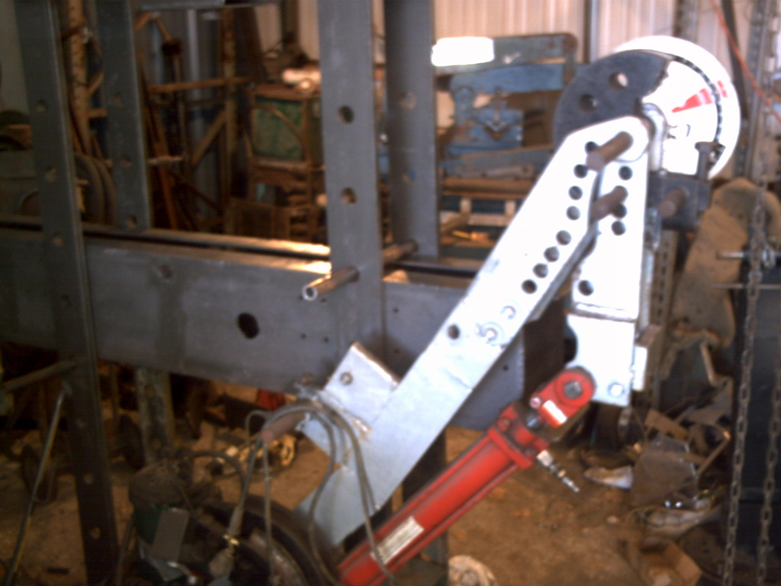

    That tubing bender hanging there.. I think it has to move.. It pivots down out of the way, but I got a job that it will be in the way of..
    (it's been painted since the photo)
    Rock on..,.,,

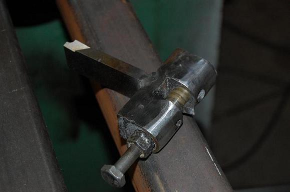

    Here is one that I kind of forgot about until I was looking at pictures on my pc. I needed a die for my bender and could not wait until one was shipped to me. I made a simple radius cutter out of 97 Jeep Wrangler rear shock mount. You cant really see it well in the picture, but the aluminum used to be on old wheel that was melted down and poured into a coffee can.

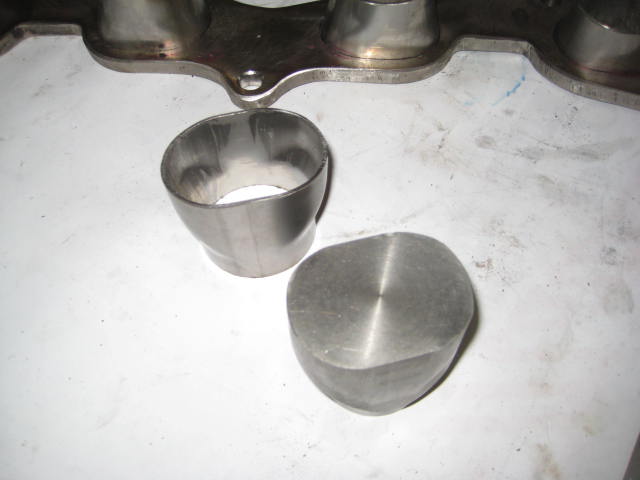

    Header flange die, for 304 SS 16g. tubing. I hope the photos explain most of it. machined a tapered die on a my lathe minus the the thickness of the tubing. Then milled the sides down, minus the thickness of tubing. Then sanded to blend the rest. works great doesn't split the tubing.
    Ago
  30. MikesIron
    Joined: Apr 27, 2011
    Posts: 62
    MikesIron
    from Union, OR
    OK -- that's pretty slick. ***ume you machined the header plate (not too familiar w/ CNC, but would think that such is req'd for a plate like that), and that you have a tubing bender to finish the rest of the job? Pretty sweet if you do!!!
