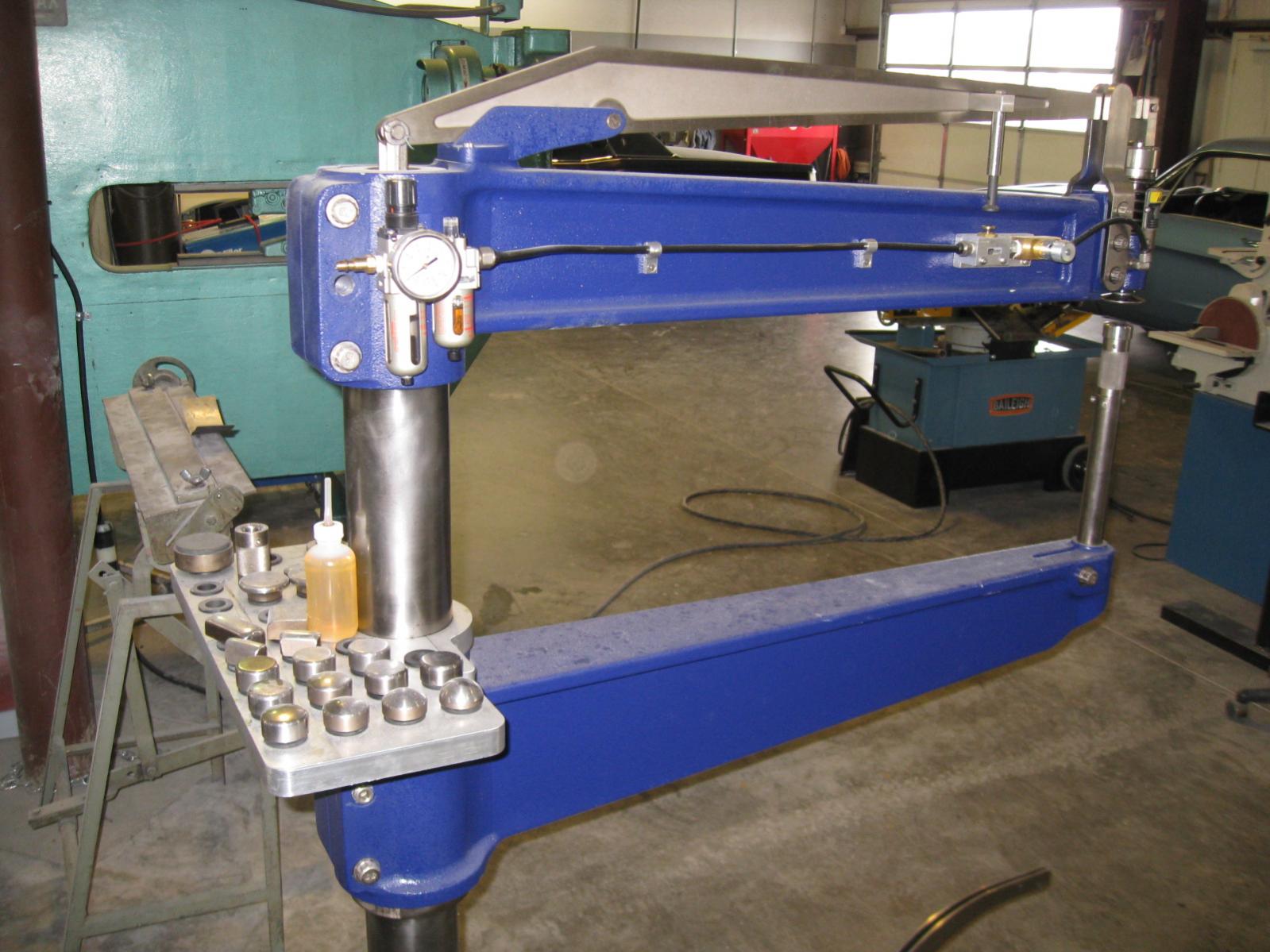

    I needed a Planishing hammer and i liked the previous one i used,unfortunately this wasn't mine.The model is a 36" throat Proline model (shown in the first picture) retailing at $9300.There are cheaper models on the market,but not as well built.So i decided to build my own and here it is.

  21. AntiBling
    Joined: Jul 25, 2004
    Posts: 612
    AntiBling
    Did you machine the dies for that yourself or buy them from somewhere?
  22. 383deuce
    Joined: Jul 10, 2009
    Posts: 3,668
    383deuce
    Where did you get the parts to build this? and what is a ballpark number of total cost to build?

    bought all the air parts on line and hammer head off ebay.It cost me under $1500 in parts and materials.

    Canu be more specific on the hammer head Doc? A link perhaps.

    the dies came with the hammer head.I am going to machine some bigger dies and heat treat though.

  28. I don't think $1500 is out of line, try to buy a tool like that, probably 3-4 times as much.

    yardstore.com has upper dies, in .401 and .498" shank.
    They call them Flush Rivet Sets.
    Michigan Pneumatic Tools sold the air motors separately.
    They also had lower dies.
