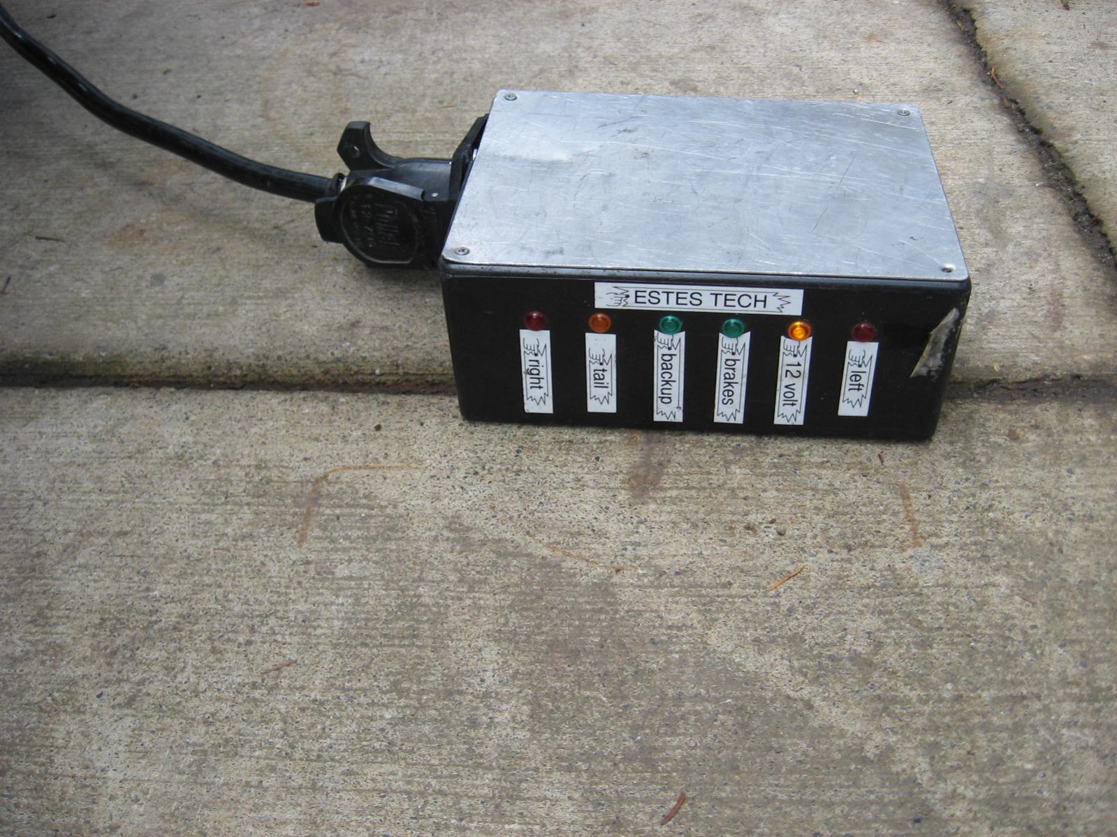

  19. Here is the other piece of testing Equipment I made to go along with my tester box. With this box, you plug it into the back of the tow rig, set the box next to the left rear tire, make sure the tow rig is in Park and parking brake set, turn the ignition switch on, apply pressure to the brake pedal, slide the gear selector into reverse & test,. The box should light up to show 12 volts, and light the circuits that you've activated, along with trailer brake circuit if you have a brake controller in the cab. Now turn the left turn and right turn. Test complete. This box has sold lots of Fuses, and found trailer lighting issues on the truck.
    For your information this box contains one electric brake magnet inside so brake controller will recognize the trailer plugged into the tow vehicle.
    Parts for this box made up from parts gathered at Radio Shack, and my local trailer supply house. Use L.E.D. lights for brightness.

    awesome!!
    i'll put the vehicle tester on my to-do list,never thought about a magnet,i happen to have some laying around....coulda used it this past weekend.

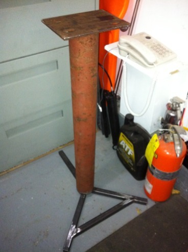

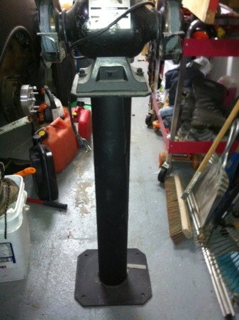

  23. Some simple projects... But I hope it helps some people.
