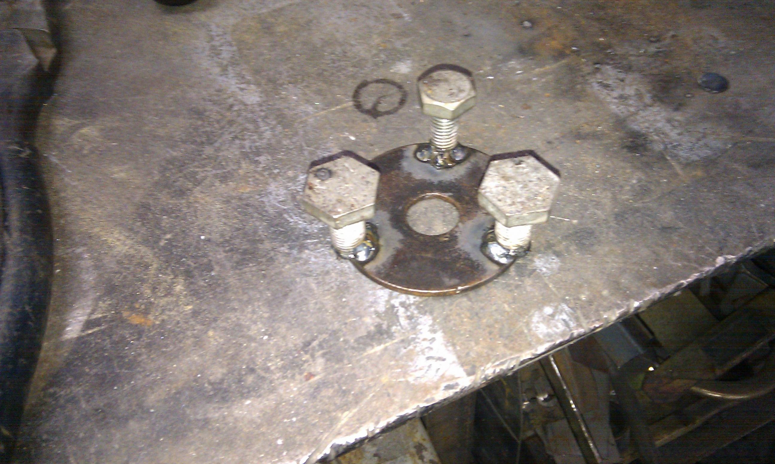

    Made this today.. ever have trouble getting that clip off a Gm colume? Well with a large flat washer and 3 old bolts I made a quick little press.. worked pefect..

    Lock plate depressor..................Good Idea!!!

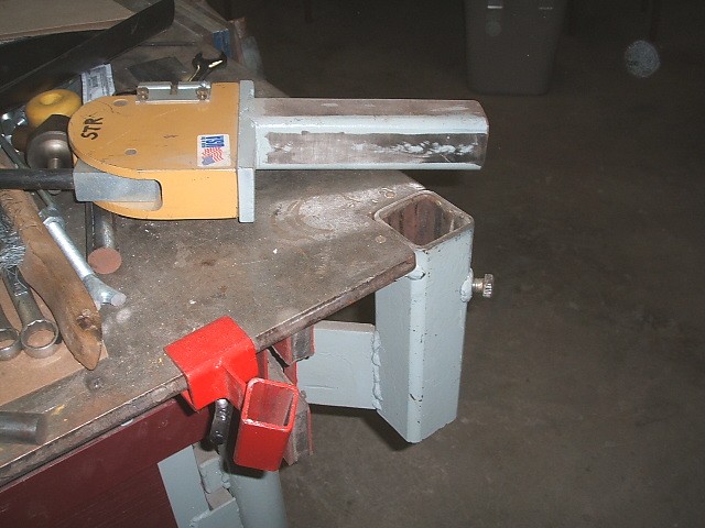

    Same idea except I have a piece of receiver tubing welded into my fabrication table so I can slide tools in and lock them in place. I also have a Beverly shear (clone), planishing hammer, vise, bead roller and probably some others I can't think of right now.
    The red clamp on MIG torch holder is really handy also.
