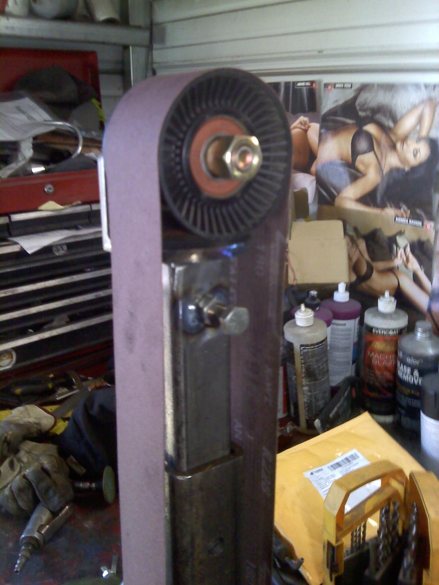

    My handmade 2''x48" vertical belt sander...

    Made everything but the 2 forward coated wheels. Is you can see in the 3rd pic the pinch bolt can be loosened and the "head' can rotate 360 degrees, this allows you to have the big wheel out front, small wheel for tight areas, flat platen (as shown in pics) and reverse from the way the pics are and you can grind loose belt for deburring and such.

    Chris, did this come from a plan or is that your own design? Looks like a very versatile tool.

    I seen some basic pictures on a knife making website , Took those and designed my own. I use it for anything from sharpening lawn mower blades to sheet metal fab. The good thing about using the 2"x72" belt is, they have any grit known to man in that size due to that being the standard belt for custom knife makers.

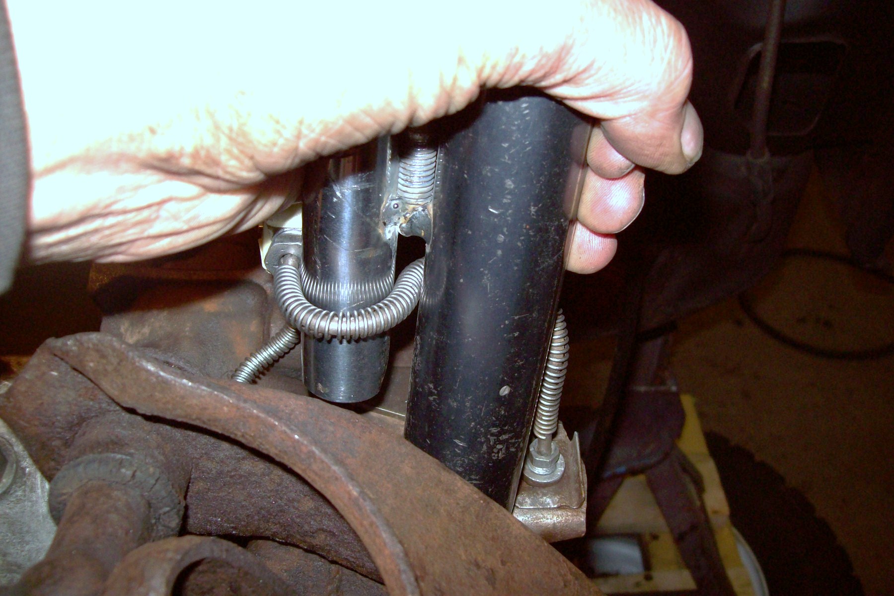

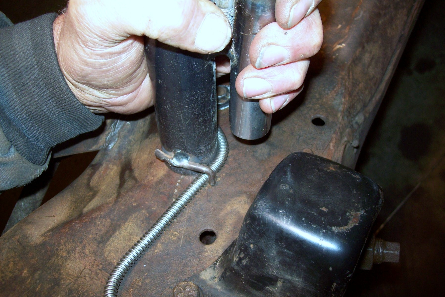

    Interesting home made vice accessories?
    Brake & fuel line bender,,,, You can make the nice tight bends without bitching to much. Just make sure,,, Like we all been told hundred's of times,,, To put on the fitting and flair before you bend. And you can take it with you under the car for tweaking.
    The only reason I say that is I was unable to find my other bender after the flight lessons I gave it. :D
