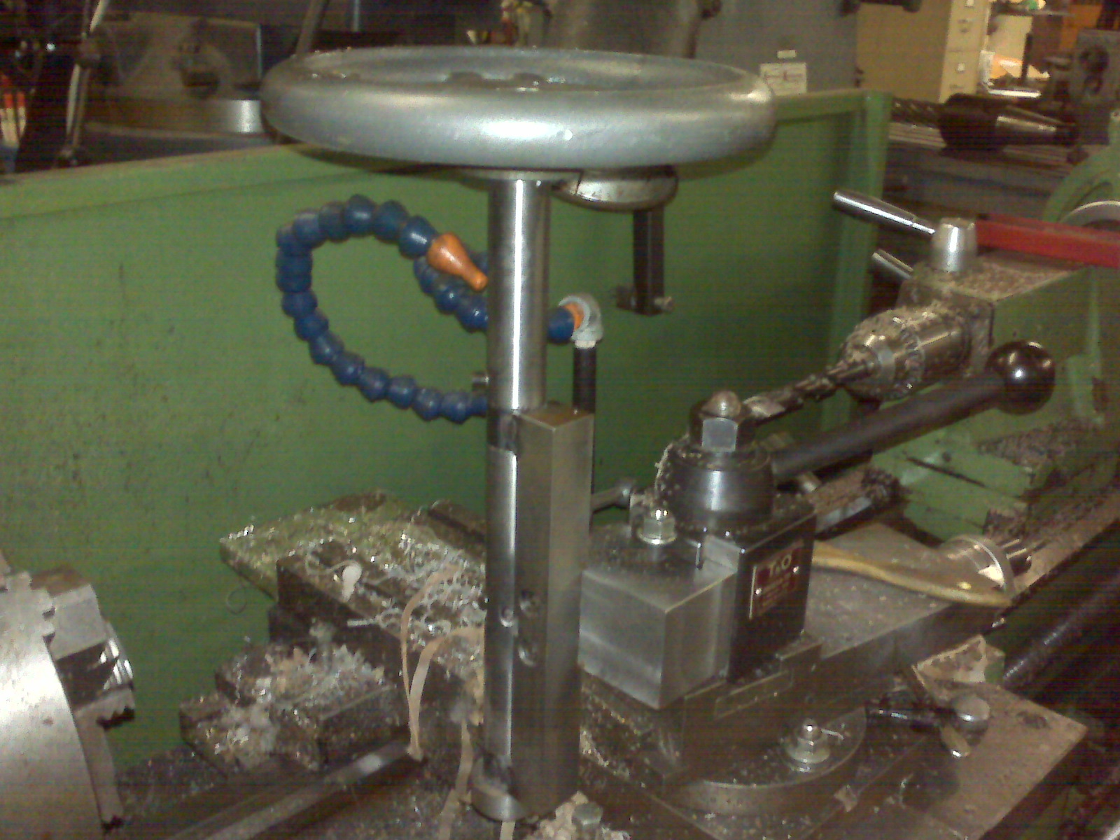

    First 2 blurry pics are of a radius cutter. It was designed to sit on my Nardini lathe's compound cross slide. It utilizes 1000 lb rater tapered spindle bearings. I machined the entire thing. The rest of the body is made from cold rolled heavy bar stock.
    The third pic is of another radius cutting tool that is used on my lathe. It uses a carbide insert in the vertical shaft. It allowed me to make the tube bending dies in the subsequent pics. One was a die for my Hydraulic tubing bender (started life as a 10" diameter piece of 8620. The smaller die in the lathe and being machined was one of a set of 3 dies that will be used on my roll bender that is still in the works. The roll bender uses 50mm shafts and will let me bend tubing up to 2" without batting an eye.

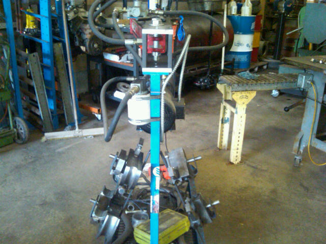

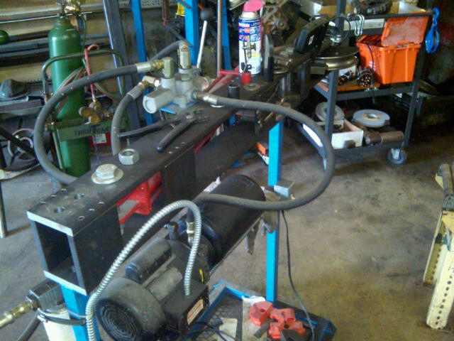

    Here are a few of my hydraulic tubing bender. I machined the top portion of the bender to ensure it was square and did not buckle and twist like my previous version. This set up is excellent. I use BendTech pro tube bending software to eliminate tube waste. It uses a Tube Bandit Digital readout as well.
    A basic tray top on my MM210 provides a great **** collection site:D

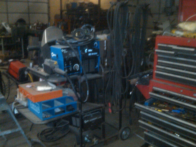

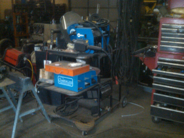

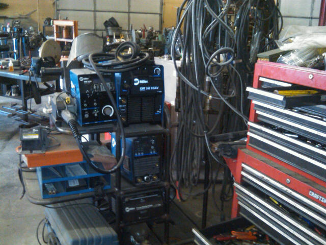

    The very last pic is of a cart for my XMT350 and Dynasty along with leads.

    Hay Jack,,,,, Do you have more photos of your welding cart in your last pitcher? I'm in the proses of doing one and changed it 3 times now. Looking for inspiration hear,,,,,,,,

    Here are a few more pics of the welding cart. Additionally, there is a picture of the modification I made to my chopsaw. I basically mounted it to a long 13ft steel table. I recessed it so that the stock being cut can just lie on the table top and no need for additional support. Works great.
