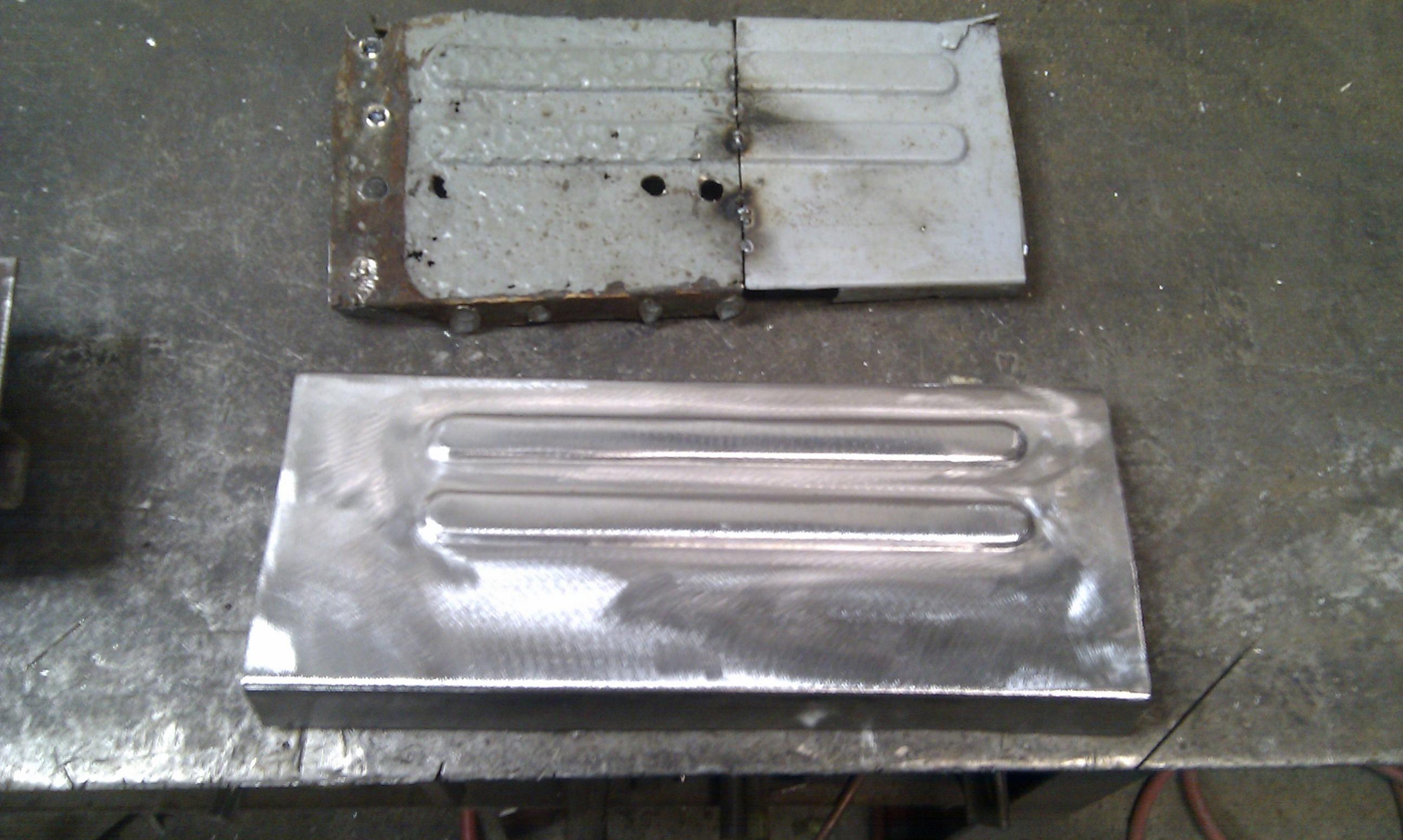

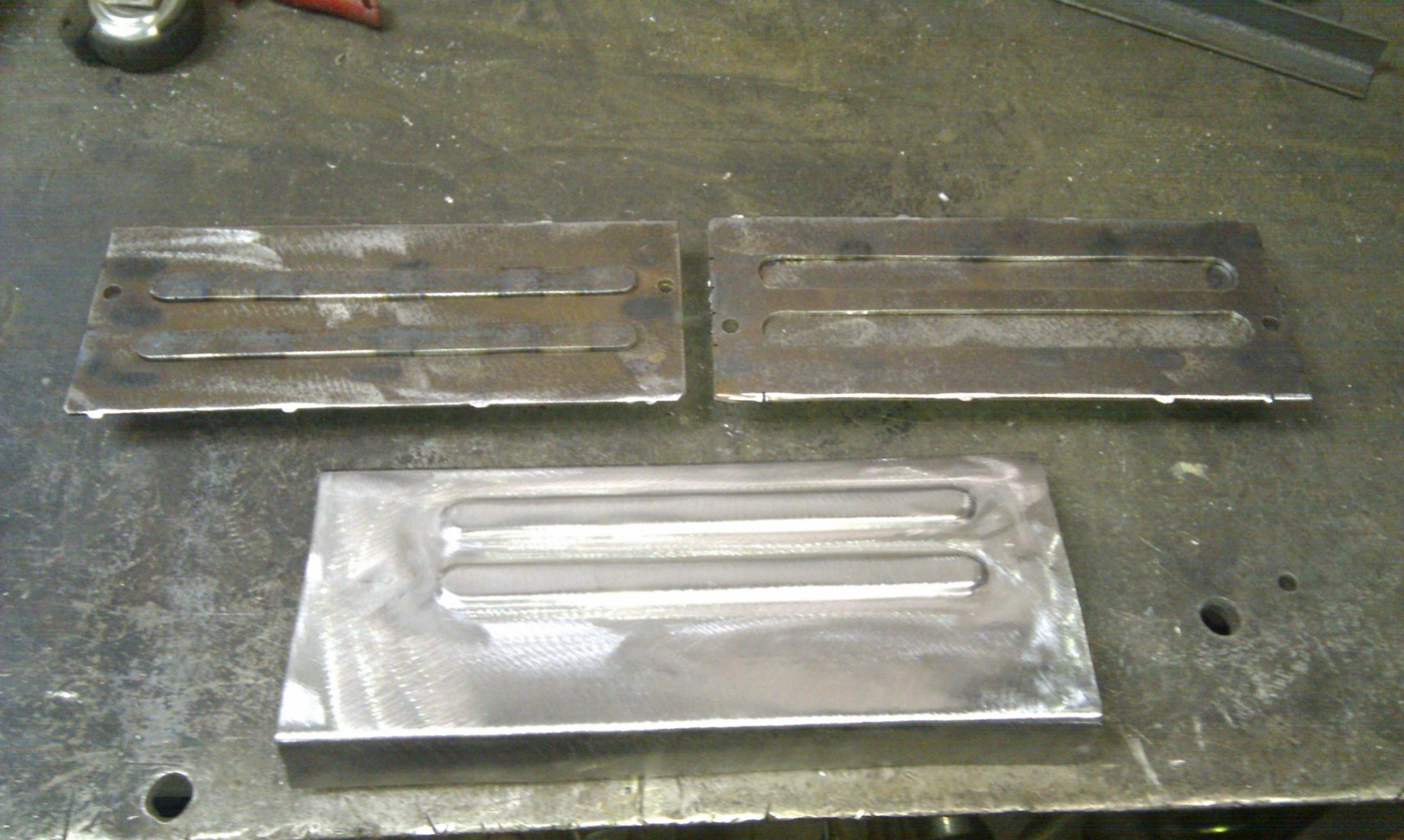

  12. fitzee
    Joined: Feb 26, 2003
    Posts: 2,862
    fitzee

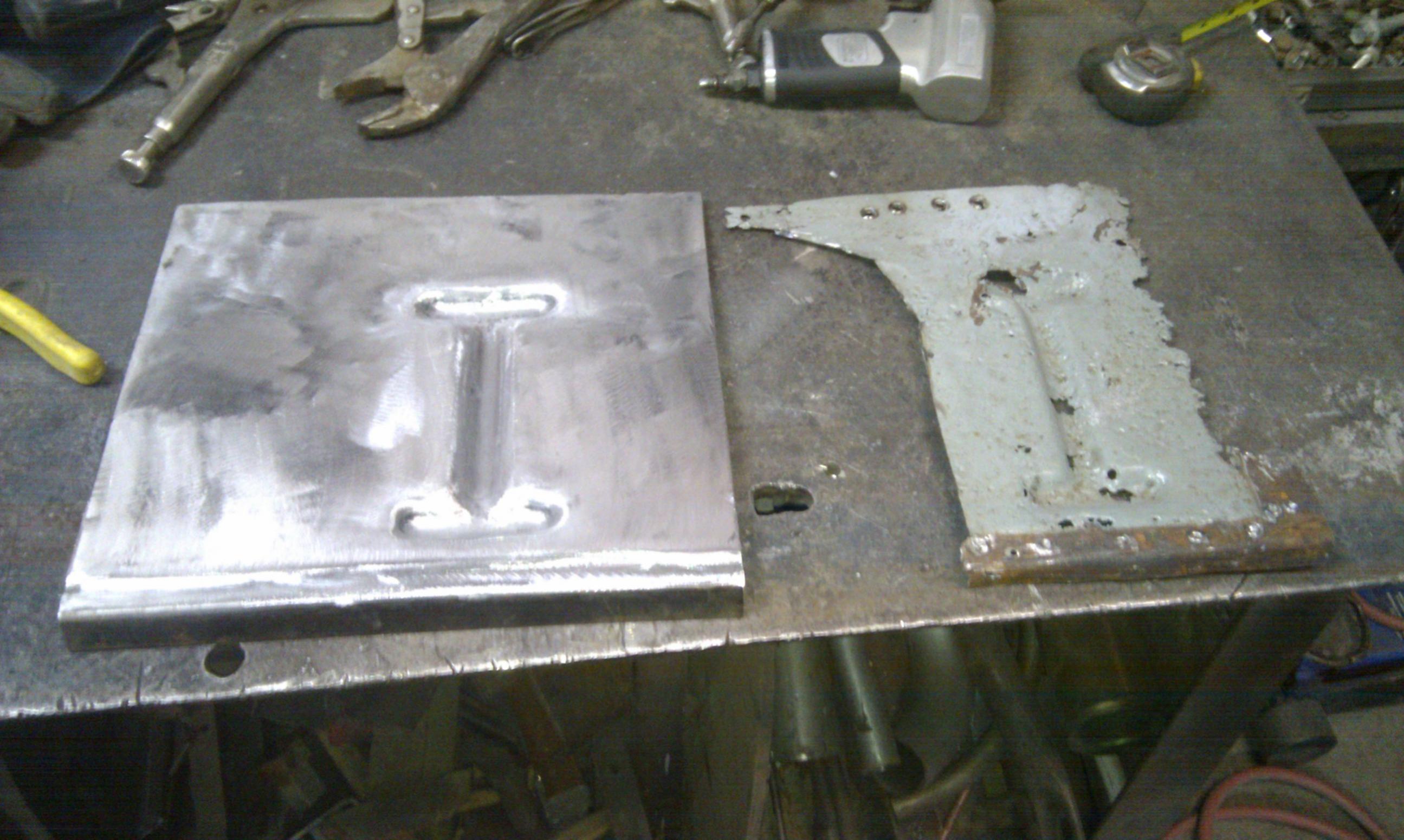

    Well here is my drop in the hat.. now they may not look the best but this was a paying job so spending hours making the tool look good was not my plan.. build it..tune it so it worked and do the job. these are two different dies I made for beads for the step and floor for a 66 Dodge Van.. one was a press type while other one was formed with a air chisel..

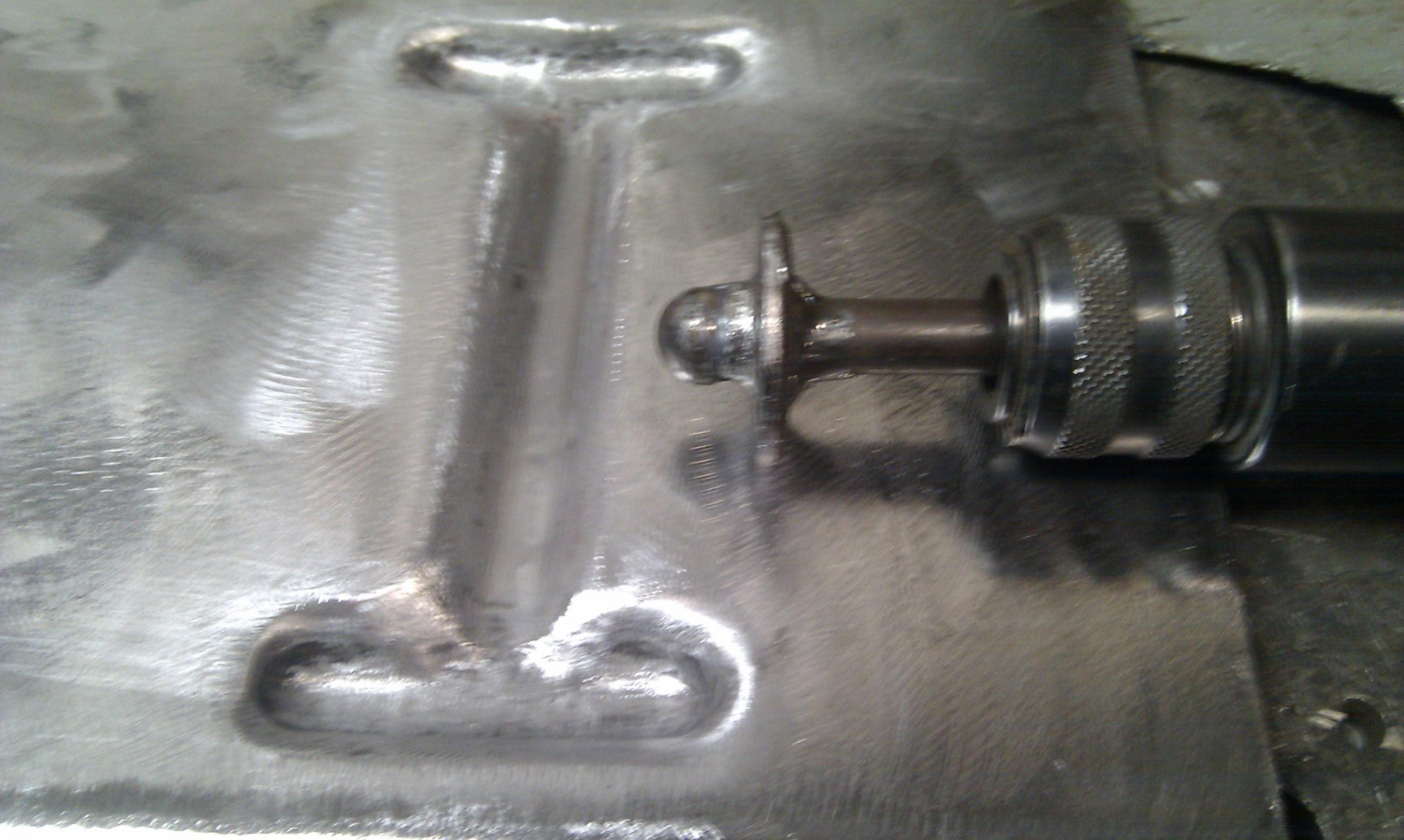

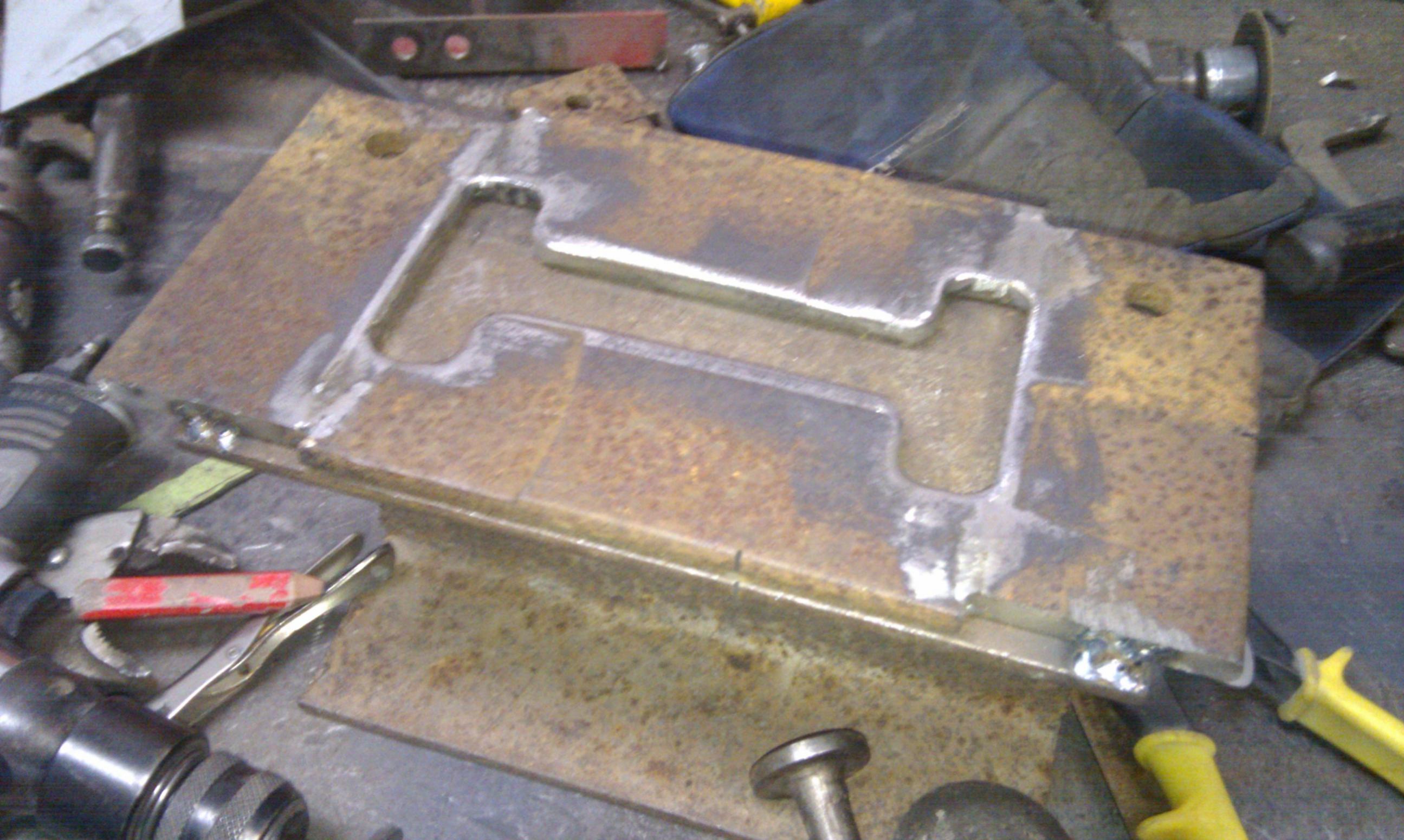

  17. bjinatj
    Joined: Jun 24, 2008
    Posts: 438
    bjinatj

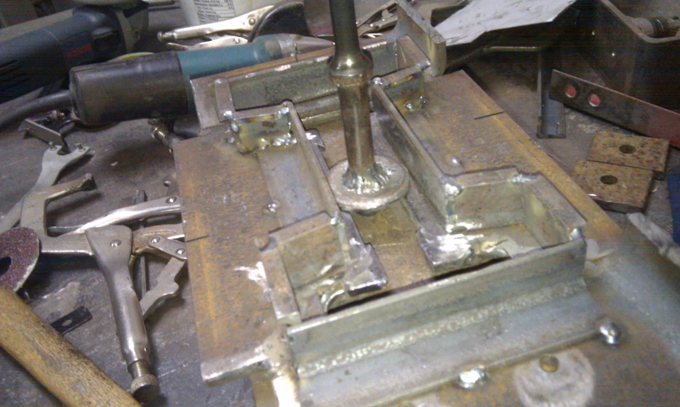

    After making the machine I posted yesterday I started on the task of creating dies. Here is a pair of dies I made in about 10 minutes and a couple of pictures of what they are for.

  19. bjinatj
    Posts: 438
    bjinatj
    There was a group build on www.allmetalshaping.com, pay attention to their rules and you will be fine..
    I just read as much as I could and started building it. That 29 rear piece was punched out in about 15 minutes. That machine will mangle a piece of sheetmetal into any number of unrecognizable forms if you don't have a handle on what you are doing from the get go..

    Motorbreath
    On the bead tooling. Am I correct that this is a ball bearing or ball peen hammer end, welded to a plate, thats then welded to the "mount". I've been wondering how I could do something kinda similar, I believe you have shown me how. Thanks!
  21. bjinatj
    Posts: 438
    bjinatj
    You're welcome..
    The smaller bottom plate has a hole drilled in it and the ball bearing is welded from the reverse side. It is them welded to your bottom post. You need to have enough surface area around the ball to create a place the top die can form against to create the radius. This surface also helps in planishing the part.

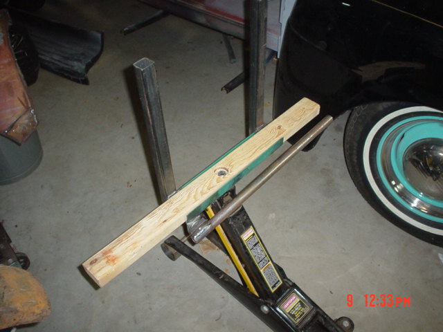

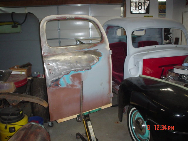

  27. charleyw
    Joined: Aug 5, 2006
    Posts: 2,321
    charleyw
    Regarding floor jack mods, Here's my contribution. In my cramped shop this works better for me than hanging the door with a cherry picker. The round pipe swivels to make loading it a little easier. The wood strip supports the bottom jamb. Crude but effective.
    This thread is great I've got a lot of ideas here, Thanks to all.
  28. tooljunkie
    Joined: Oct 18, 2010
    Posts: 209
    tooljunkie
    from manitoba
    bolt a piece of 2x2 square tubing to the floor jack,slide your new reciever hitch on and its held up in place with jack for easy to line up and bolt on.
