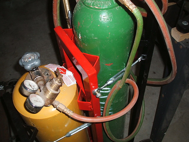

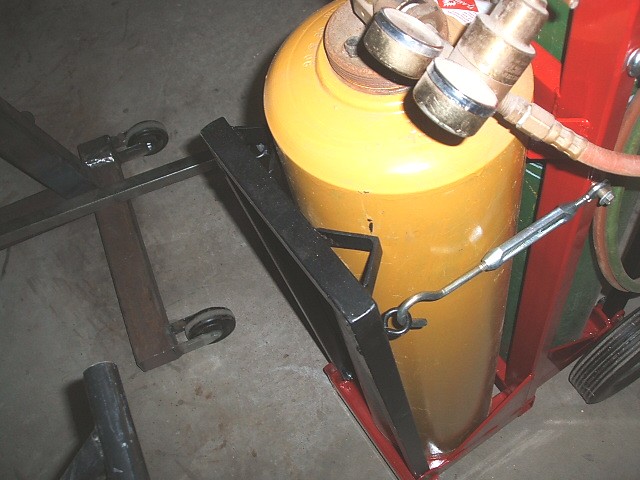

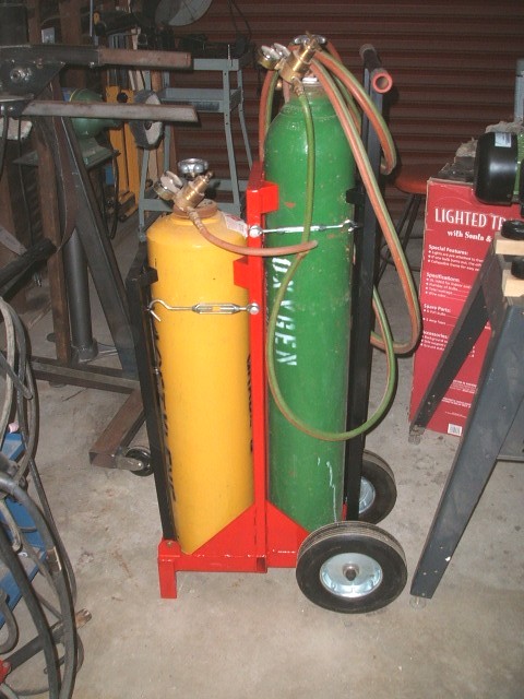

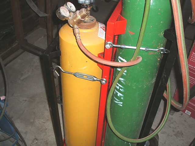

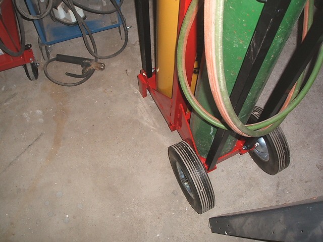

    On the subject of welding carts, my 40 year old homemade gas welding bottle cart was becoming a pain because the bottles were side by side. To save space along the wall I always slid it in sideways but that meant that I had to wiggle it out before I could roll it around. That was fine when I was in my 20's but I was getting sick of it now. My new cart mounts the bottles fore and aft so it rolls in and out from the wall. The handle and the front cylinder retainer (the black pieces) are hinged at the bottom so the cylinders are easy to get in and out. When they are swung up they lock the cylinder in place with chain and turnbuckles, very solid.
    I can't believe I put up with the old one for 40 years.

    Nicely done, I may have to build one of those myself.
  9. My welding cart has lasted 40 years also, That"s a great cart. Would like to build one like your cart. But I have to Many other things I need to do !!

    I used to have a piggy back trolley like yours many years ago when I worked as a plumber & gasfitter in the construction industry. Not as hi tech as yours, made out of 3/4" water pipe and I fitted wheels from a mini minor - made it really easy to get over rough ground.
