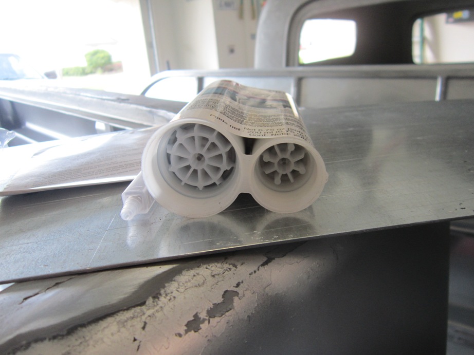

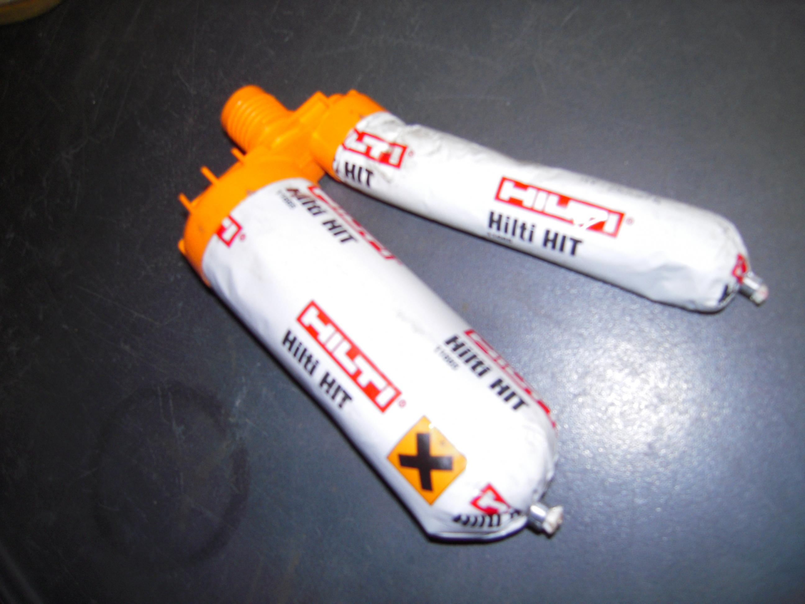

    Warning, this is severe ghetto rigged tools born by cheapness....
    So say you find a need to use a non-traditional application of 3M Panel bond but your too darn cheap to buy the expensive appicator gun (95 bucks)to do it....This was my instance, I found a need in which 3M panel bond was a better option than welding due to the large expanse of flat steel I didnt feel like warping by welding....I've never had the need to use it before and don't see another reason in a long time to use it again.
    SO I bought a tube of the 3M panel bond and as you can see it's odd sized tube sizes....

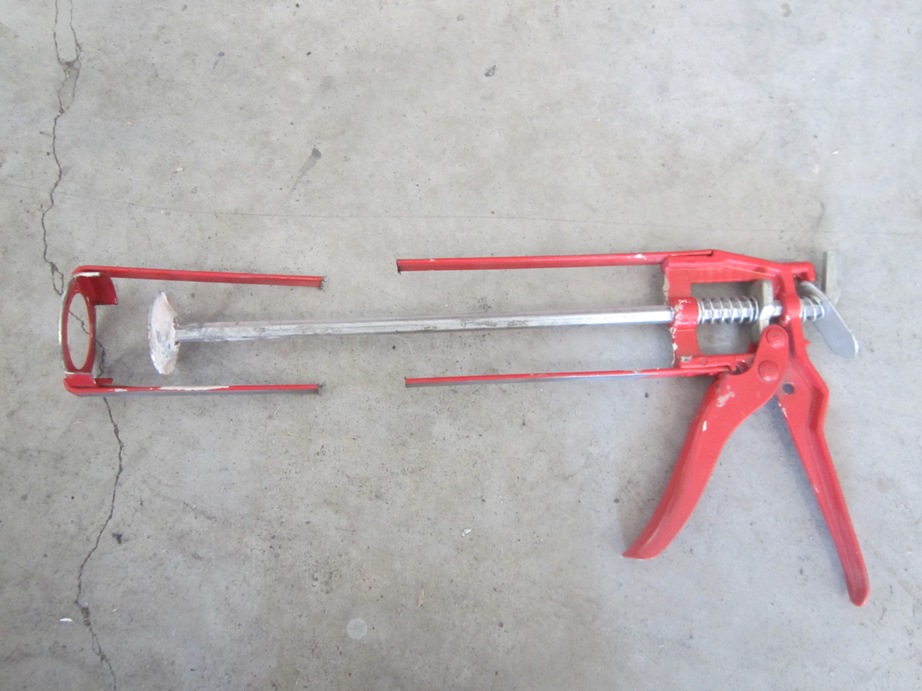

    My original thought was to split the tubes and mix it like mud and manually apply it....then I thought, you know I have 6 caulk guns I bet I can figure out how to make one work.

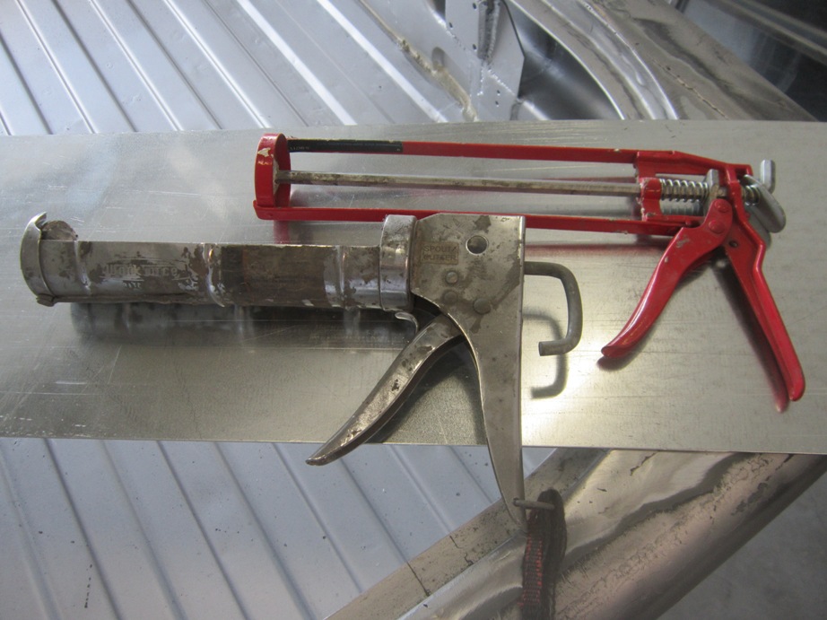

    Here's the two styles.
    I picked the one on top mainly cause I could fit the odd shaped tubes in between of the uprights. Cut the ***embly off as shown.
    and trimmed the bottom peice to capture the odd sized tubes so it doesnt slide around.
    As you can see it's off center a bit as it needed to be a little centered for the plungers I'm about to make.

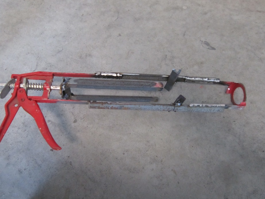

    All of this was built with s**** 1/2" angle iron....it also should be noted that this took me less than an hour, did not use a tape measure (MK1 MOD 0 eyeball) and found that the metal that the chinese used to construct the caulk gun was absolute **** and did not like to be welded so it's UGLY.....like horible, not proud of it F'd up UGLY....BUT it works....

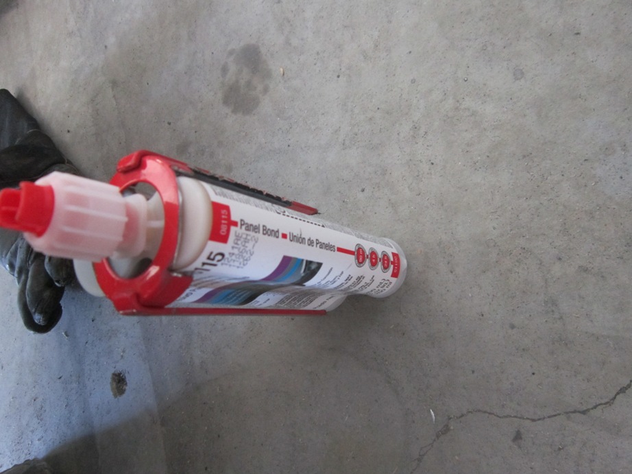

    and with the tube inserted
    And there you have it, a free tool to combat the expensive ***ed 3M gun.
