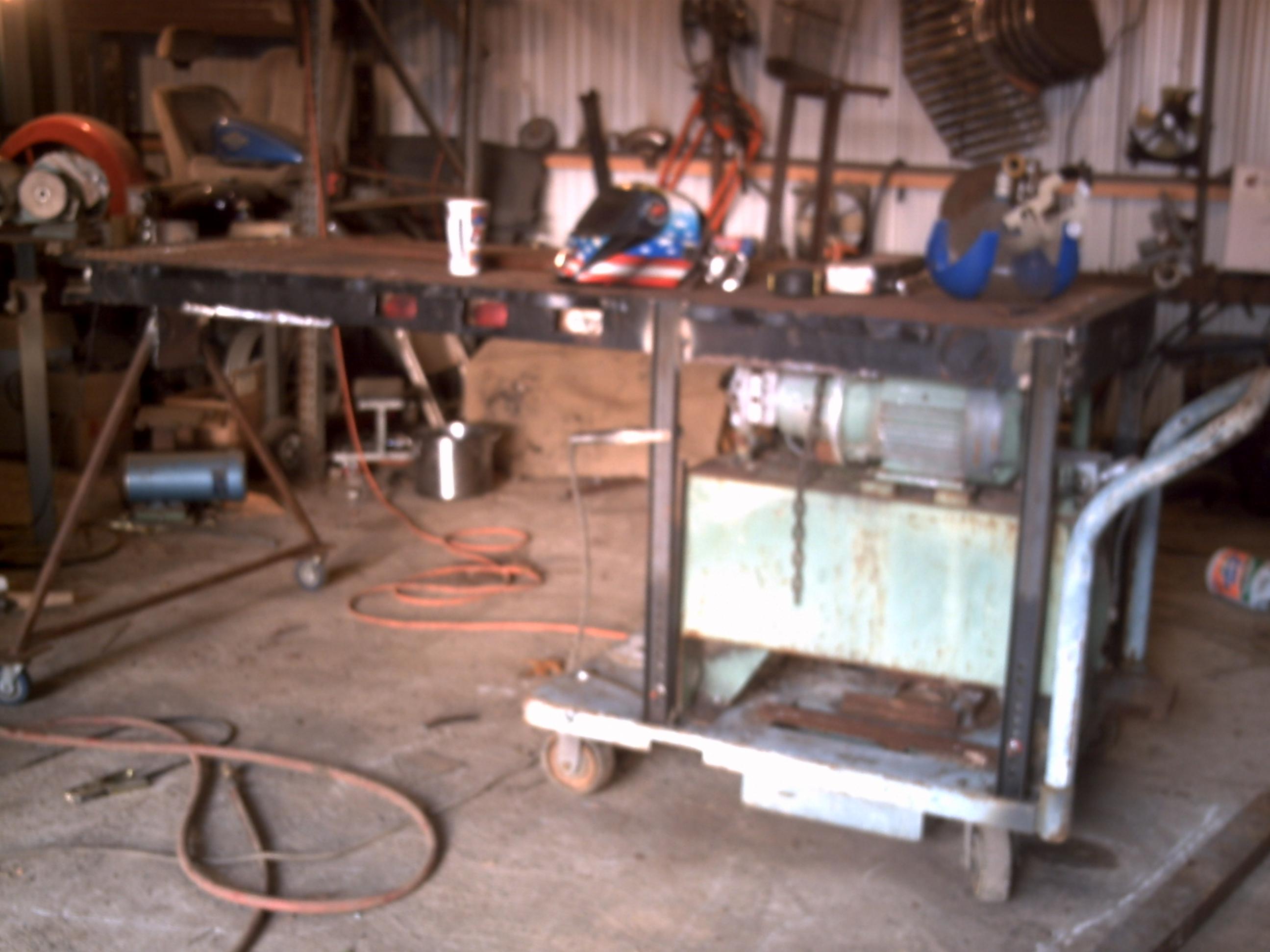

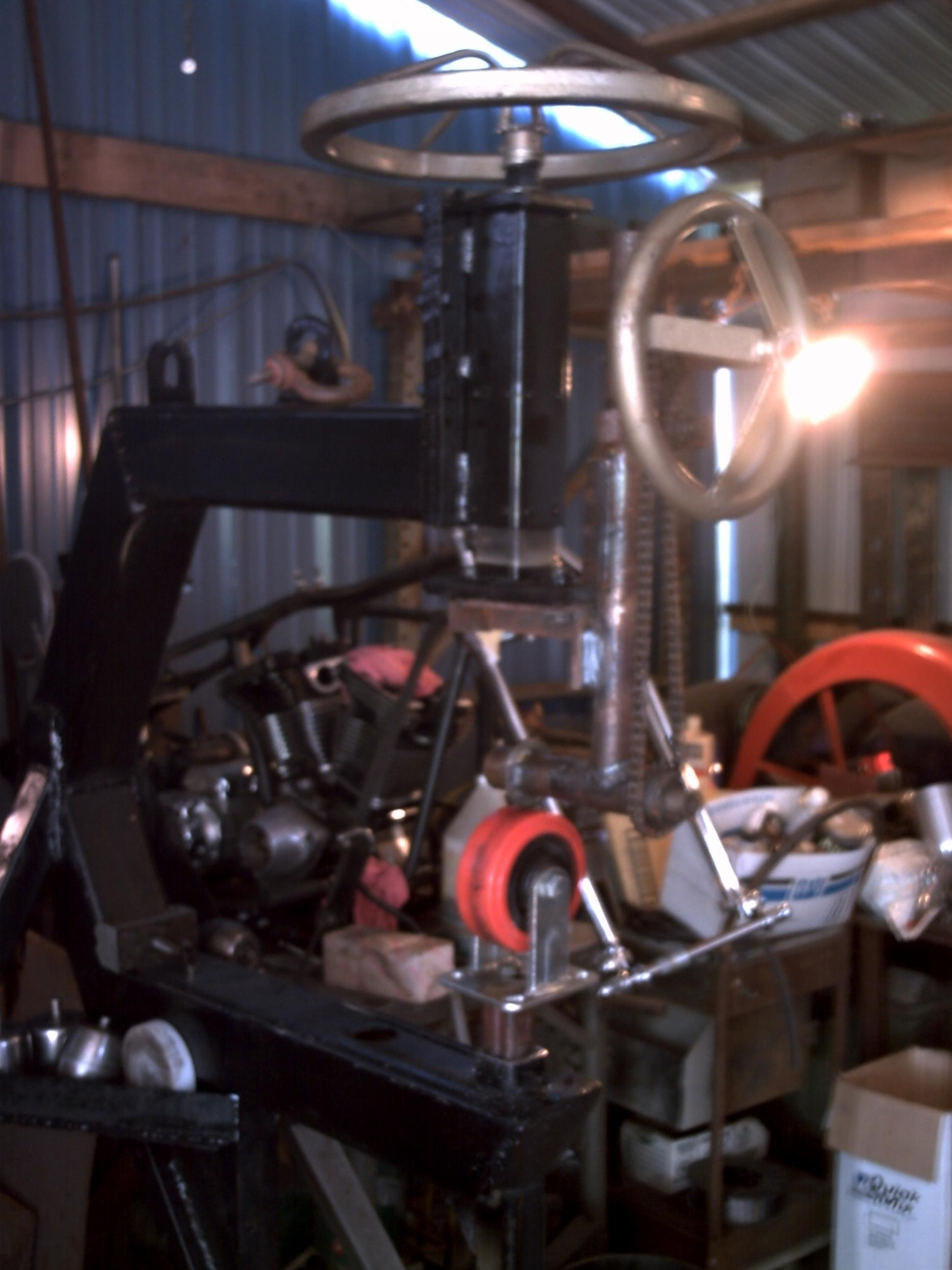

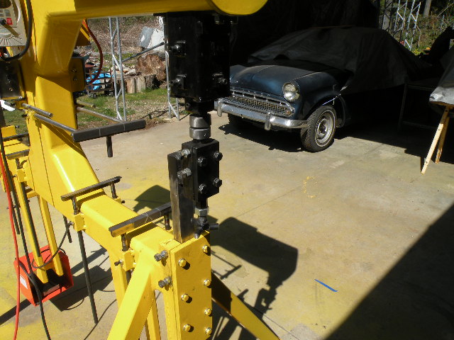

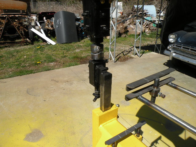

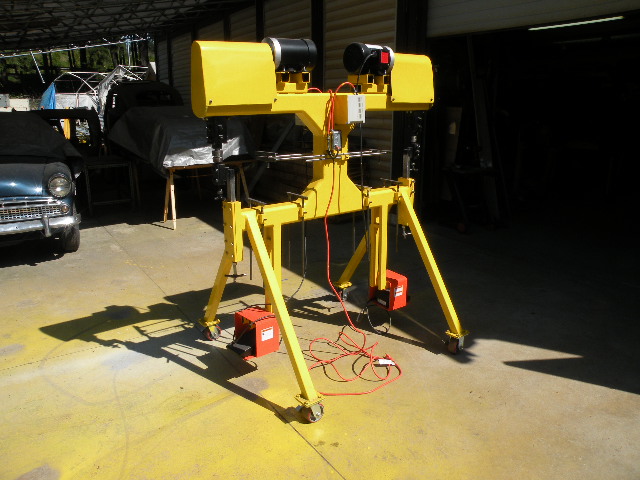

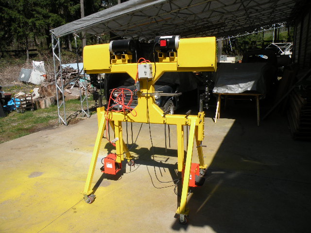

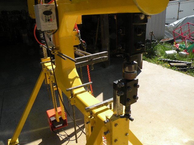

    I was looking for some pictures for a friend & found a misplaced camera chip. Here are some pictures of a double headed recrocating machine I custom built on order back awhile ago. I has dual 3/4 hp motors runs on 110 power with variable speed vfd & foot controls. The foot controls a hanging up in these photos. Nice thing about the dual headed machine is you can go from one step to the next with out switching tooling. Here it is set up to shrink on one end & smooth & planish on ther other. Tooling changes takes about 90 seconds per side & has dual height adjustability & 24 inch throats.
  2. Dyce
    Joined: Sep 12, 2006
    Posts: 1,980
    Dyce
    That's a sweet looking setup Danny!! Who's is it?

    The guy lives in eastern Washington he just plays with his 55/57 chev pu's & stuff on his farm.

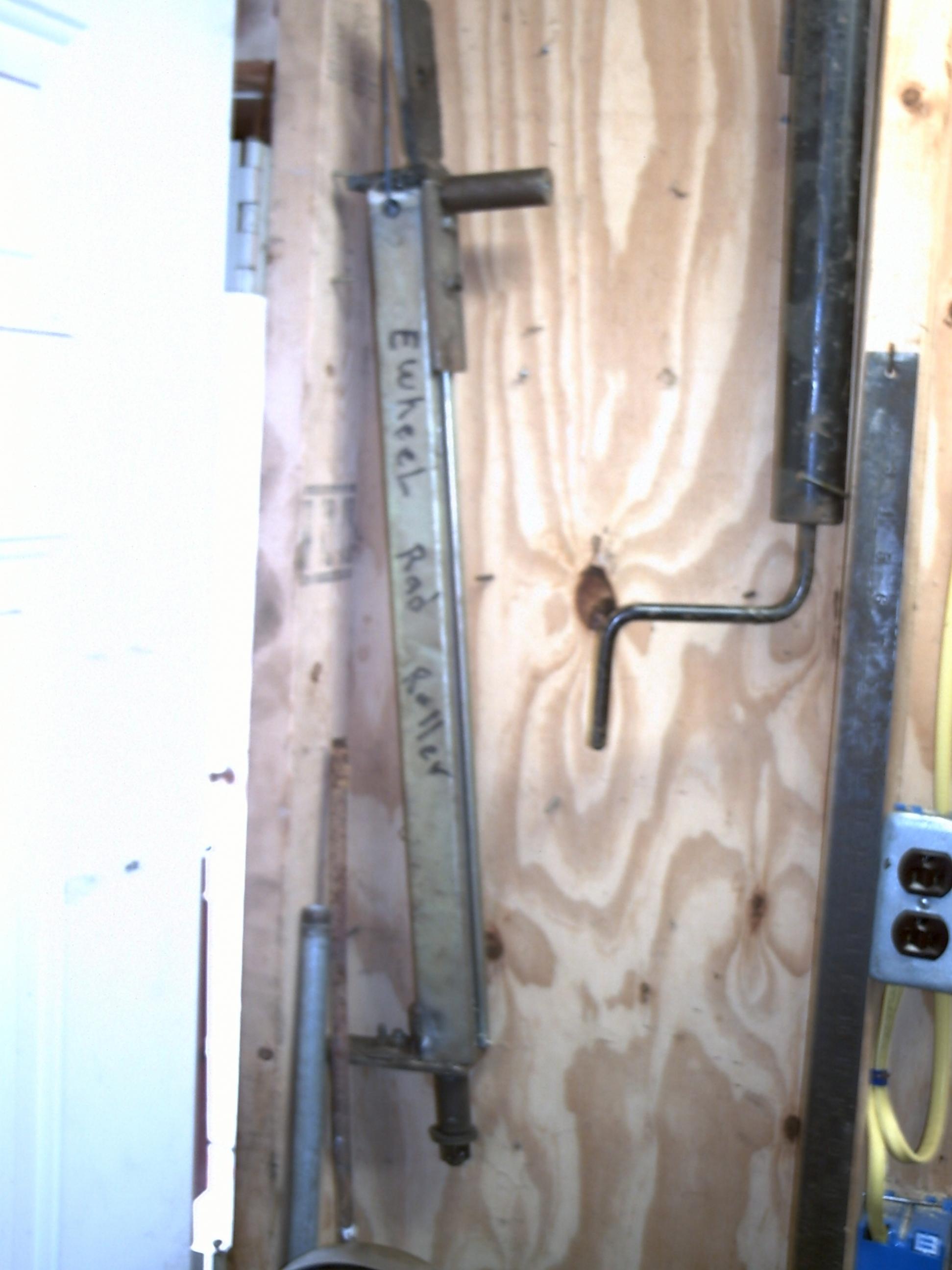

    I cut a one ton dump truck down, frame and bed, the last part of the truck bed made a excellent heavy duty shop table.. hydraulic power pack is used on home made bender and hyd roller. (I'm dying to wire up one turn signal on the truck bed to mess with my alcoholic buddies)
    (2)
    Needed to build a tipping roller that did not require a ratchet or close to panel rolling.. (pizza cutter like wheel that rolls a break in metal to fold over) it is over a Northern Tool urethanec caster, which works well.
    (3)

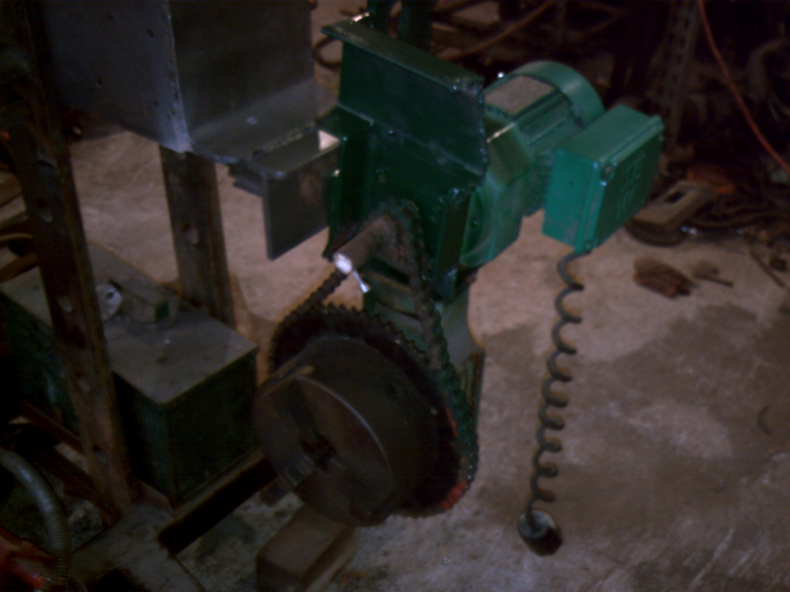

    Needed to build a welding fab-positioner to roll driveshafts and other things slowly while I tig weld them.. Used a 82:1 gear-motor and old lathe chuck bought at auction, mounted on a large bearing I tore out at a sewage plant job. A buddy with a welding helmet works to roll as you weld, but very few friends come around any more..
    I did a harley frame about a year back, tacked it up in the jig, then put a rod in chuck and tack welded it to the rear axle mount, rolled it over to weld instead of standing on my head. Bought a guitar waa-waa pedal and wired it into the VFD, it controls "speed and stop-start" of the 3 phase motor.. I use a old copper battery strap to make ground on the driveshafts as it rotates. (usually only goes one rotation) . a Vee pipe stand on the other end.
    (4)
    GO cart slick-bend roller.. forms a roll bend, driveshaft tunnels, slight curves, on the end of the C-press frame with acme screw-hand wheel adjustor. That C-press is the handiest thing I have ever built for my shop, will function as a ewheel too when pressed in center to stiffen it.
    (5)
    Radius roller "center" for ewheel frame allows to roll a "bump" for air cleaners or other circular projects.. (full stainless hubcaps) It bolts under the lower anvil cradle, you adjust the "center" in and out with the acme screw on the end.
    (6)

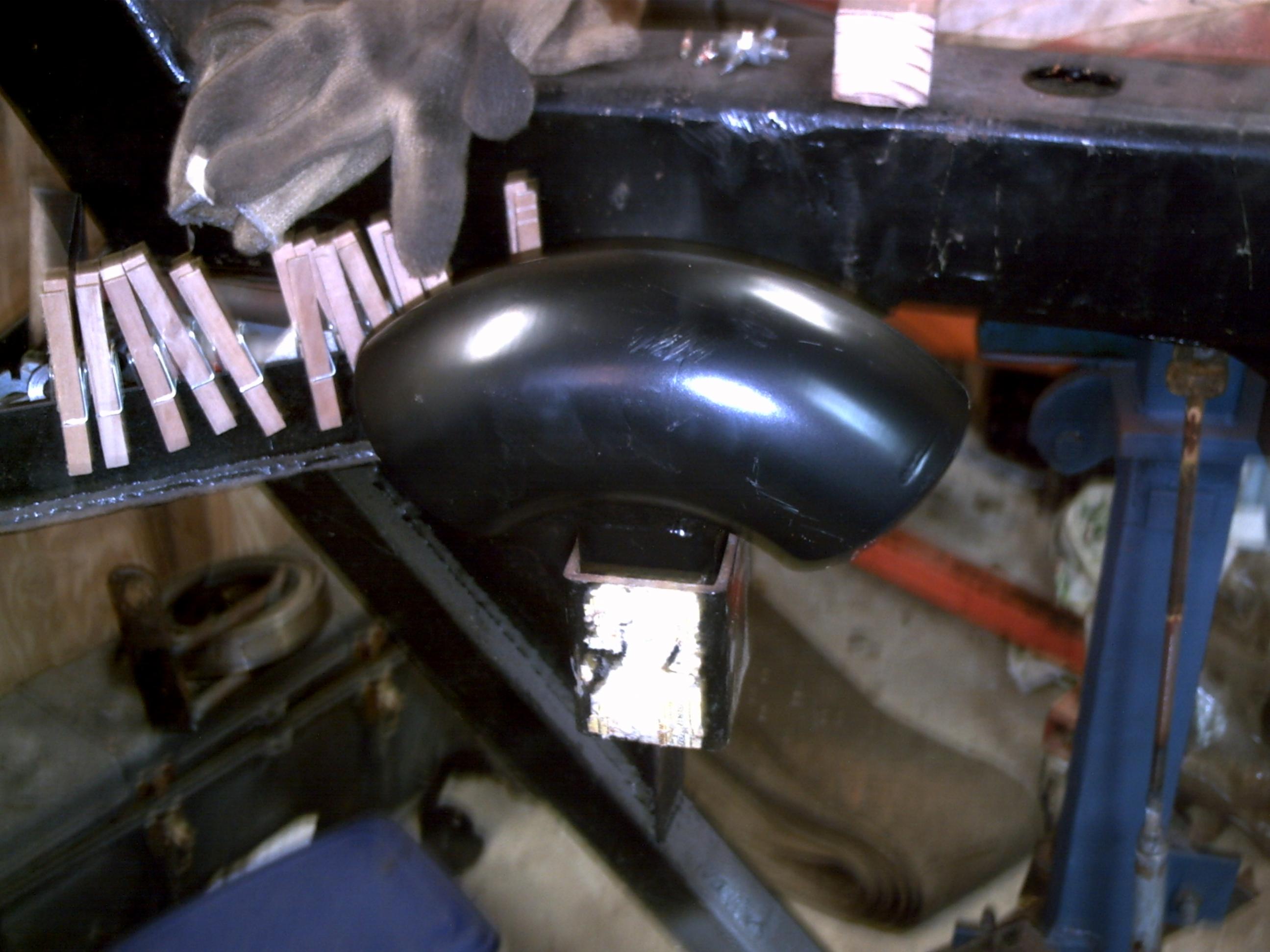

    CHEAP *******s, made from one ton truck spring. plasma cut, then you grind the rough shaky hand cut out.. I've gave away all the finished ones to newbie metal shapers. Bend a slight offset in it so you don't rap your knuckles.. POLISH.. it transfers a slick surface to metal you are forming.
    (7)
    Why do you need a 2x2 trailer hitch on your ewheel frame? To mount all the neat tools to save you a step from the dolly-sandbag-stump-tucking forks.. Note the 90 adapter I made, when I started doing this I could not just do sideways or vertical socket mounts, I did both. Note the 3" weld ell? it is a perfect dolly for fender shaping.
    (8)
    and I put them 2x2 mounts on everything.. used this brake-bender on the back of a service truck to bend copper bus bar in a switch yard..
    (the bad? now my buddies are doing the same thing and want to borrow tools) I can drag the tools outside on a pretty day, on the back of the truck or a post dolly with 2x2 socket on top.
  6. Dawai
    Joined: Oct 1, 2007
    Posts: 263
    Dawai
    from North Ga.
    Welding positioner picture did not "take" for some reason??
    Here it is.. it too is on a 2x2 mount, can rotate vertical or horizontal.

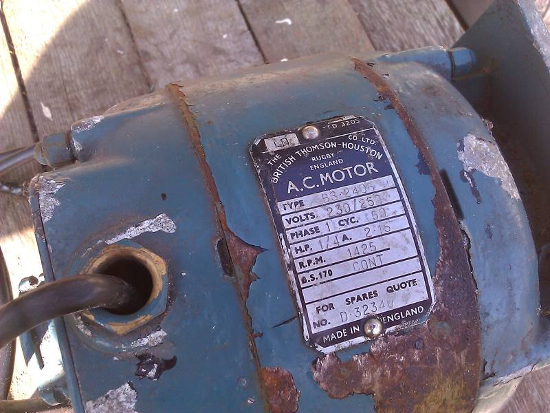

    this thread has remonded me that I have this smallish motor kicking about:
    which I'll try and use now, rather than letting it take up room on a shelf :)

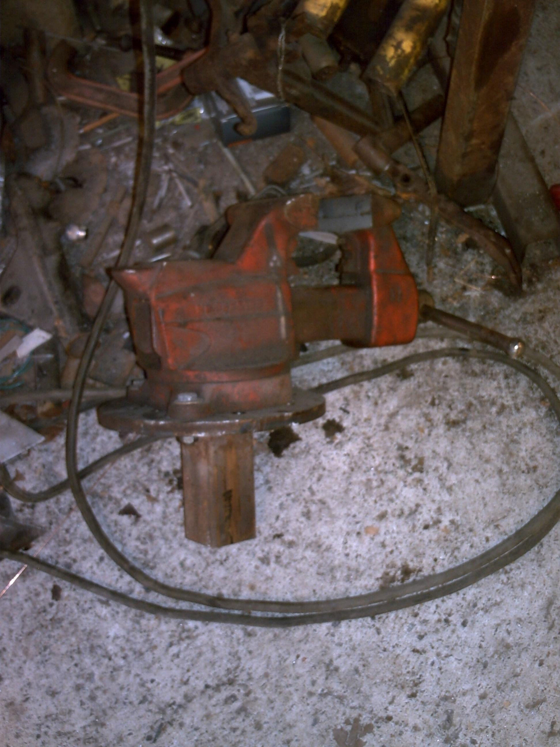

    made my own 'grinder bench'
    it's in primer at the moment, waiting to dry :)
    the grinder i have has the switch on the side, so one of the side plates needed 'clearancing'

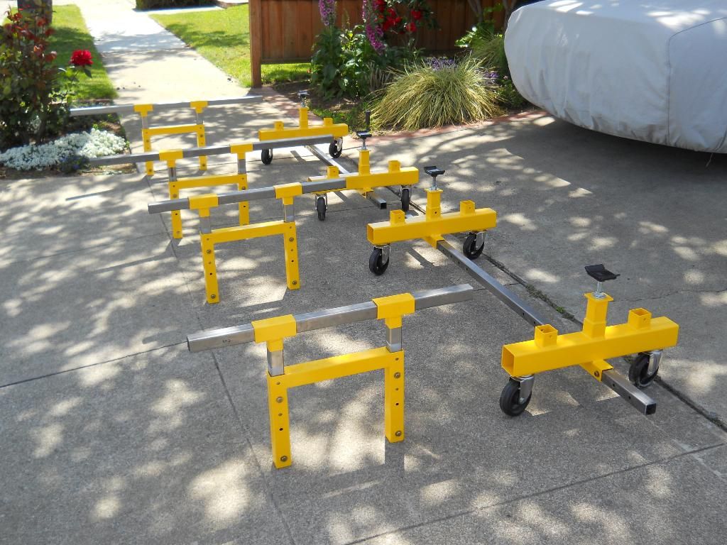

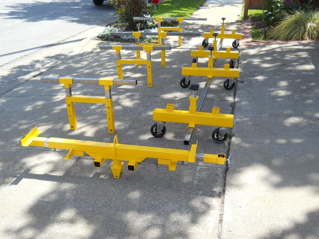

    Doing an old chevy truck project now....
    Need to remove the bed and cab....
    There's a guy on the 67-72 truck forum that sells plans for a one man cab/bed lift....so I ordered the plans, bought the metal and made it - then painted it.
    After that I designed some dual purpose dollies to:
    Set the frame of a truck/car onto and wheel around. It can be adjusted for width and height.
    OR
    Bolt in the uprights (in picture) and set the truck cab, truck bed or car body onto it. Also has adjustable for height and can use different length bars.
    Yes, it was more work than I intended but this should be real useful.

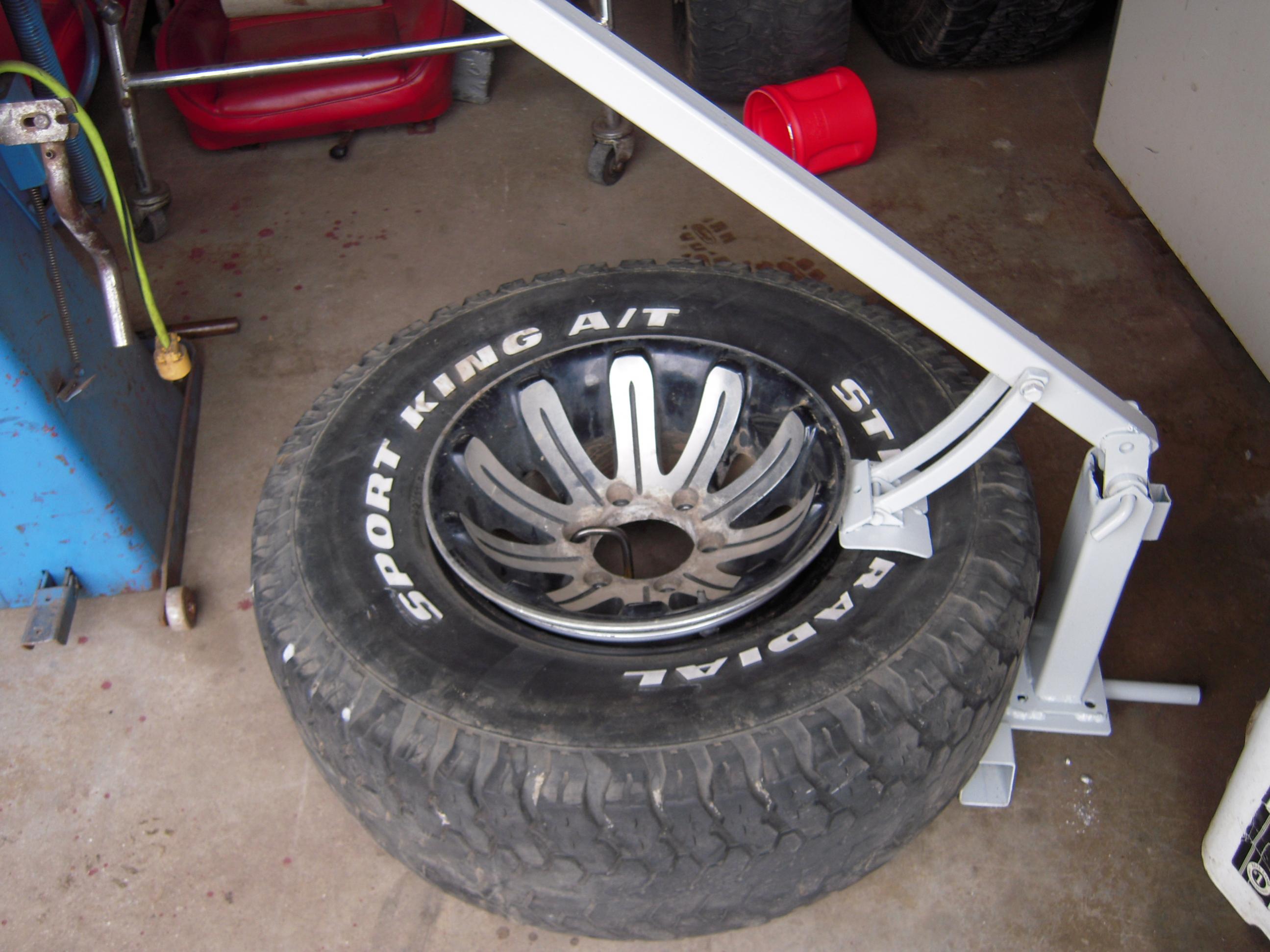

    Tire changer wouldn't brake the beed on bigger wheels. We can't have that,,,,, So this is what we came up with. 15 min. later we where back on the road. Dam thing worked so good I went ahead and painted it. Like the model A peddles.
  19. biggeorge
    Joined: Dec 8, 2006
    Posts: 1,732
    biggeorge
    That looks great! Yes i like the a pedals

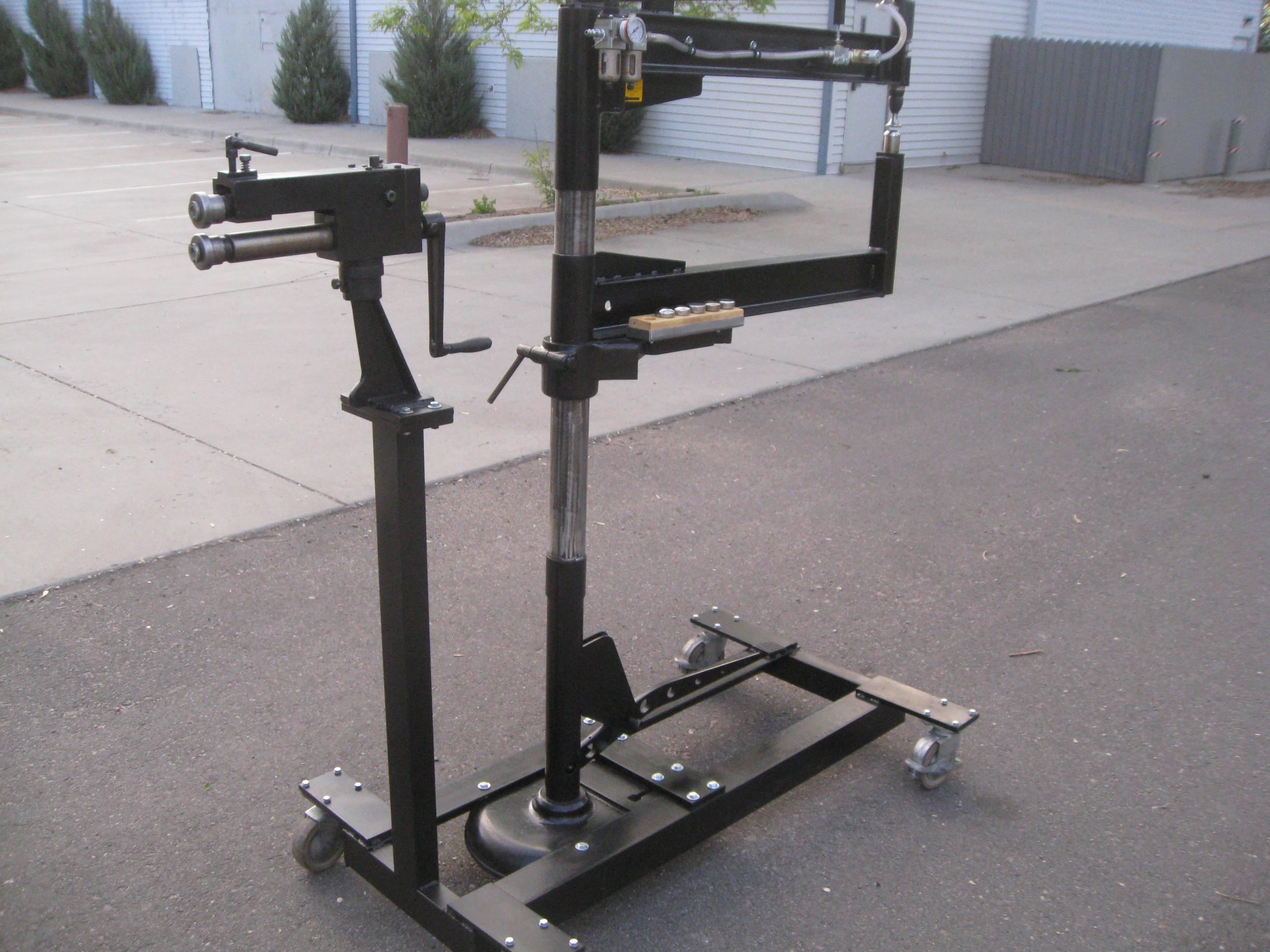

    Homemade bench English wheel and bead roller.Picked cart up for $40 from metal recyclers.

    bjinatj
    Here is my homemade reciprocating machine and e-wheel. I welded the spine of each machine to each other to strengthen them and then welded them to a large ibeam. The reason I decided to put them at 90° is because the action of each tool is on the same side. I did not want to have to walk around the machine to use it.
  24. the metalsurgeon
    Joined: Apr 19, 2009
    Posts: 1,237
    the metalsurgeon
    from Denver
    i like the reciprocating machine,do you have more details,plans?
    thanks for any info
    my weekly metal work blog www.themetalsurgeon.com
  25. bjinatj
    Joined: Jun 24, 2008
    Posts: 438
    bjinatj
    The machine is basically a 5/8" shaft supported by 3 locking pillow blocks and a pulley on one end to be driven by a small electric motor. My 1/2 hp 1725 electric motor will easily move 18 gauge steel.
    I took a piece of 3/4" solid round and chucked it in the lathe with a shim on one of the jaws to drill a 5/8" hole slightly off center. I then slid that piece onto the shaft and welded it on. Once the shaft ***embly was completed I built a connecting rod with bushings to slip over the off center section of the shaft and built a quill that accepts 3/4" tooling.
    There was a group build on www.allmetalshaping.com. There are no exact plans, but there are a lot of better explanations on that site. I hope that helps..
