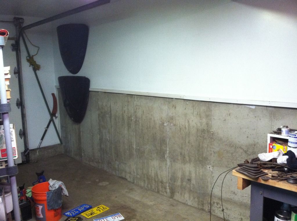

    Hardly tooling.. But, I finally built a work bench and put up some newly scored cabinets..
    Before..
    After..

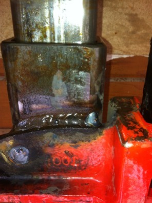

    That'll be handy Todd. Speaking of vice mounts, This is what I did with mine. The top pivots and the vice swivels so I can use it for welding and grinding.

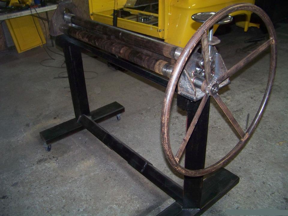

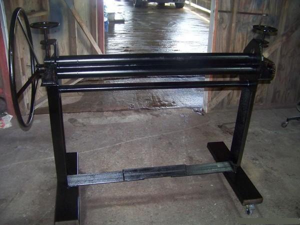

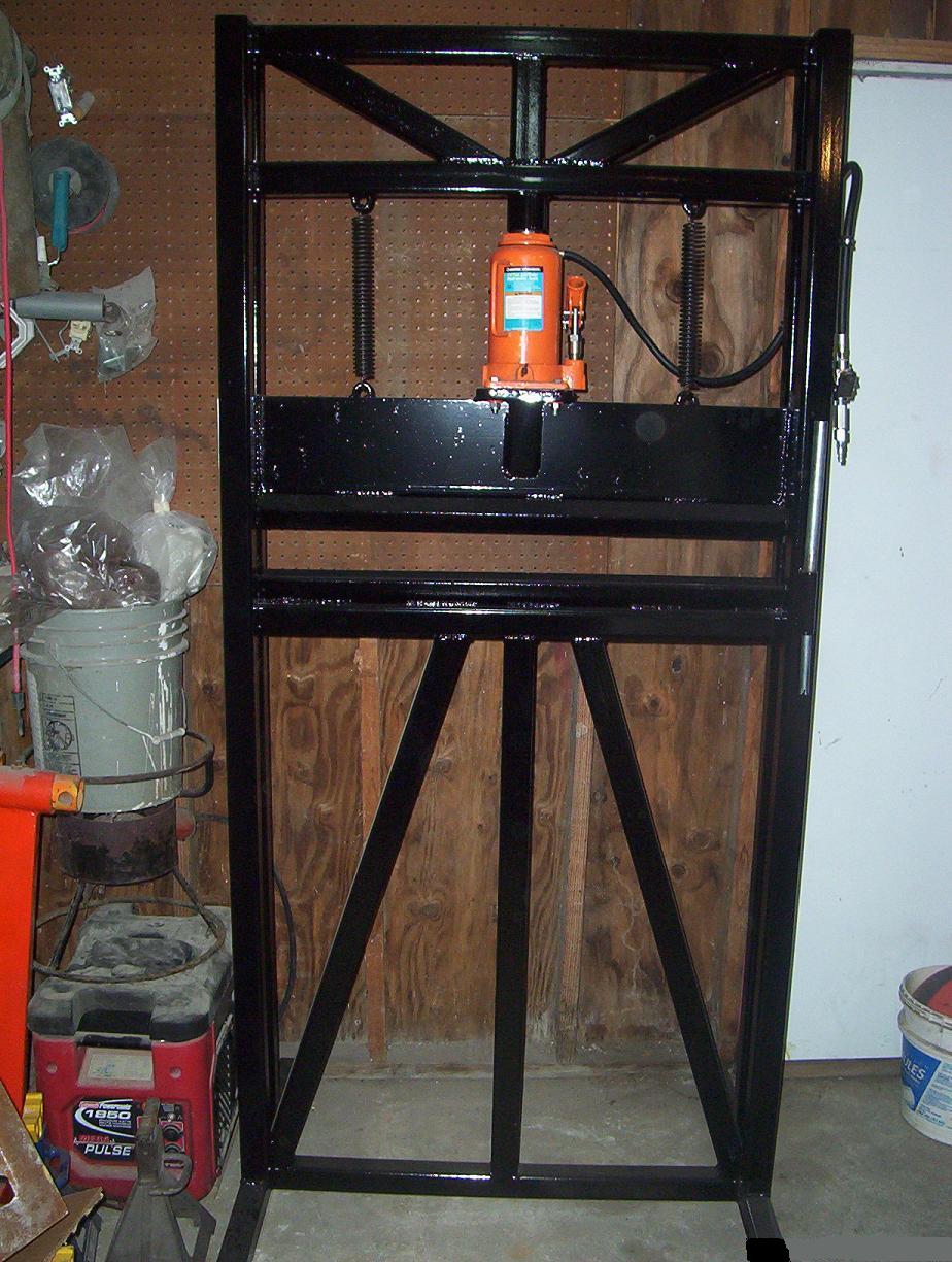

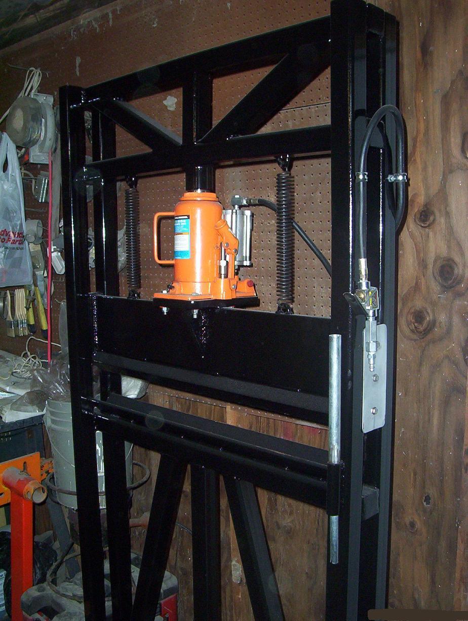

    Here's a roller and press brake I hand made.. 20 ton's on the press brake,

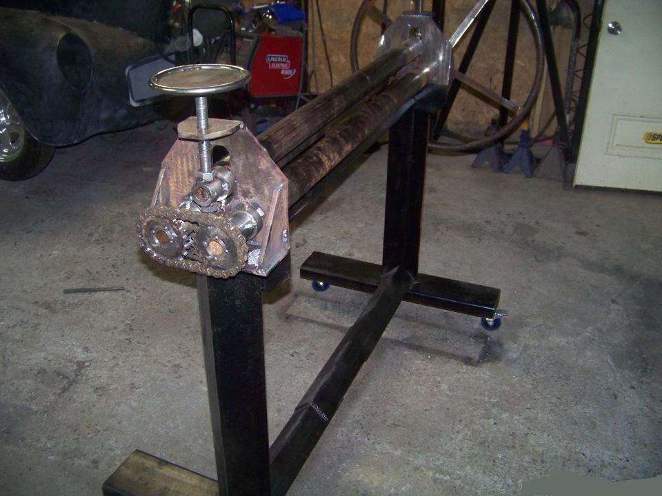

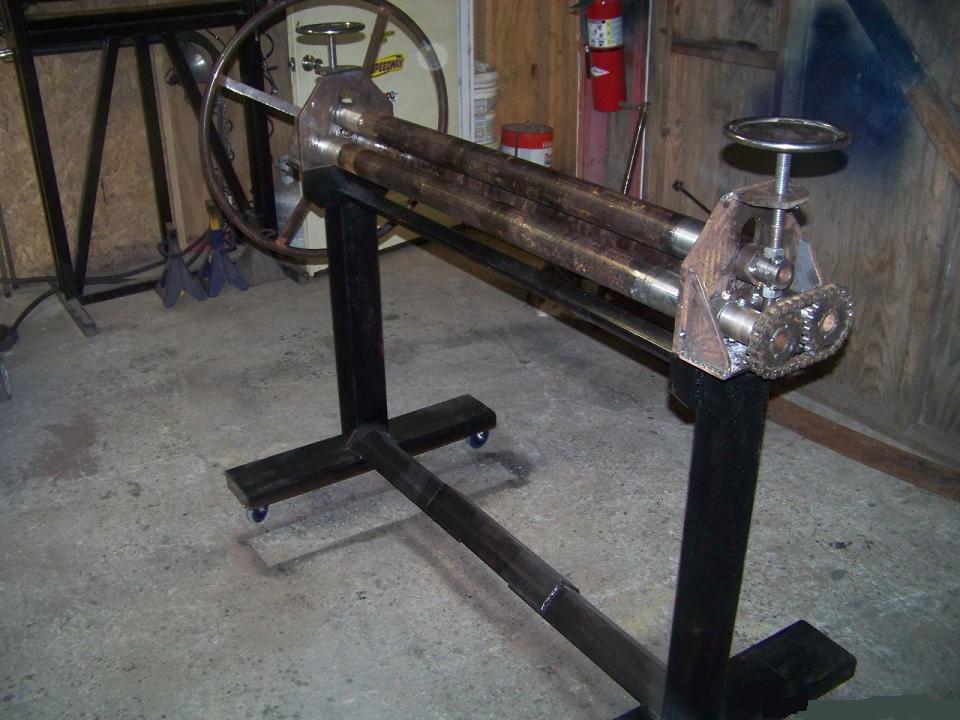

    No limits - Do you have a pic of the ends showing your adjustments?

    I guess your talking about the roller Ron ...Yes,, Here's some..
  20. Incredible fit and finish. I need to get my milling machine up and running.

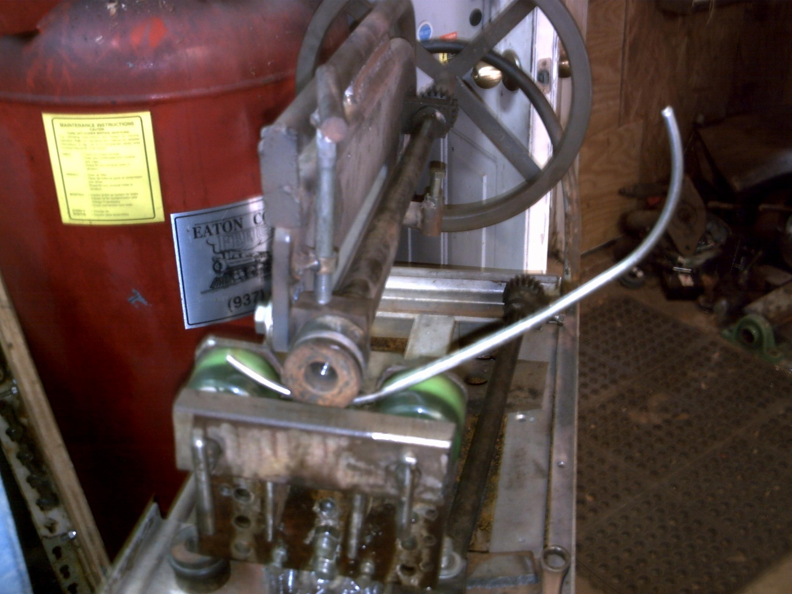

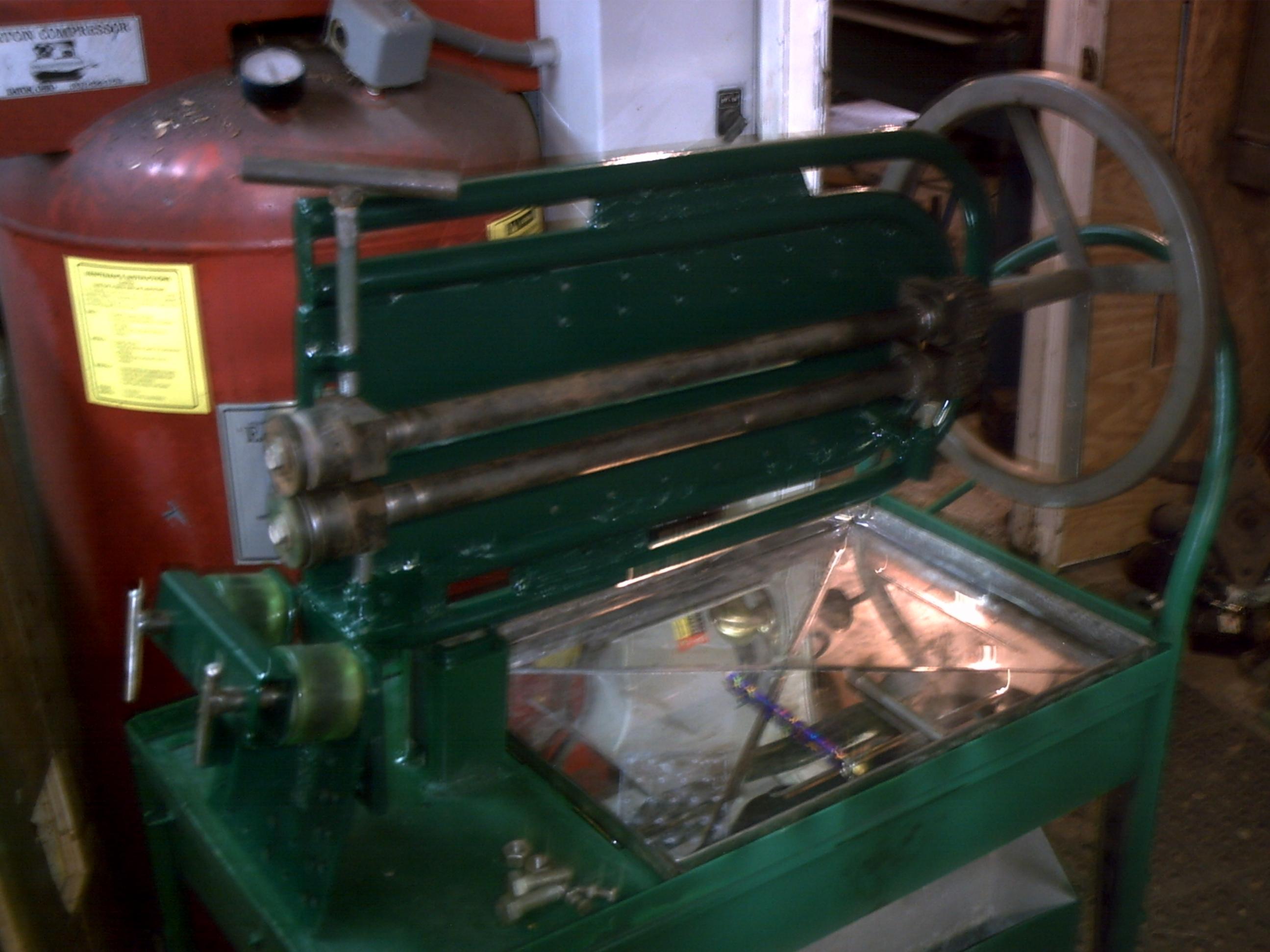

    SLIP roll to go onto the end of a beadroller. A adapter plate to bolt onto the lower part of frame, the upper roll descends down into it.
    Rework, I am going to drill closer axle holes in it, build some steel rolls for small rod and flat rolls for flat stock. THE top axle now needs to adjust on both ends to be level while at rolling point. (meaning now I get to grind some powder coat off and weld another adjustor)
    THOSE skateboard wheels are for a "Lazze" inspired project, rolling stainless trim spears here for a toy. I tried them on this, but don't think they are staying, think steel rollers are better for this app.
    Good point? it goes on and off quickly.

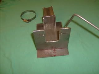

    I think I got this idea from metalmeet or C*** Nowrocki book. Easy to add to my E wheel and works a treat.

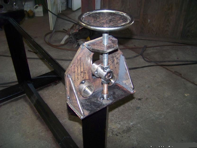

    Here's a couple pic's I took while building my vesion of Dan's shear;
    I used 3/16" stock out of my s**** bin.
    If you are cutting sheet metal, take the time to build one of these. You won't be sorry!
