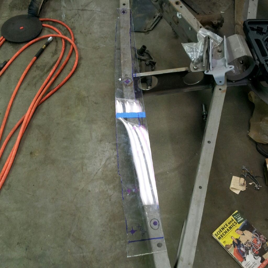

    I use plexi sheet for a ton of things. I traced some 36 ford subrails mounting holes and all from an intact car here and put them on a bare frame, and then used the plexi as templates for steel.unfinished but you get the idea...

    the plexi is an awesome idea,i have used it many times.

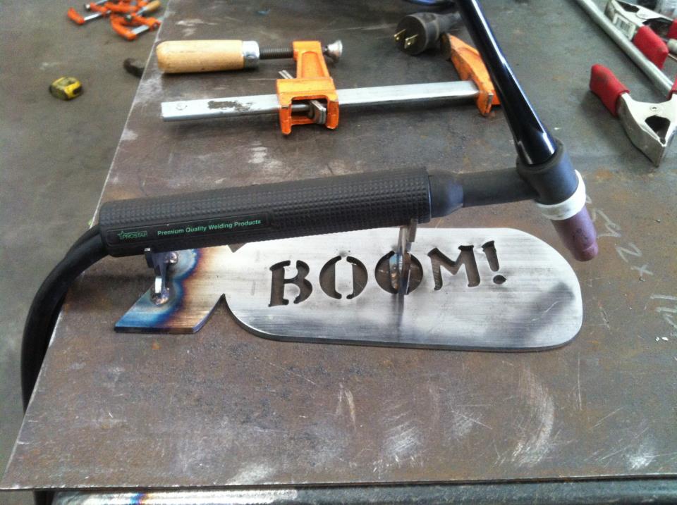

    So I made this today, just another thing to add to the back of your minds. I got fed up with my tungsten getting messed up from the torch sliding around on the bench top. There isn't anything that pisses me off more then either breaking a gas cup or snapping the tip off a freshly sharpened piece of tungsten. I'm not sure why I went with a bomb or the saying "BOOM!" but it works and looks totally rad on my welding table.

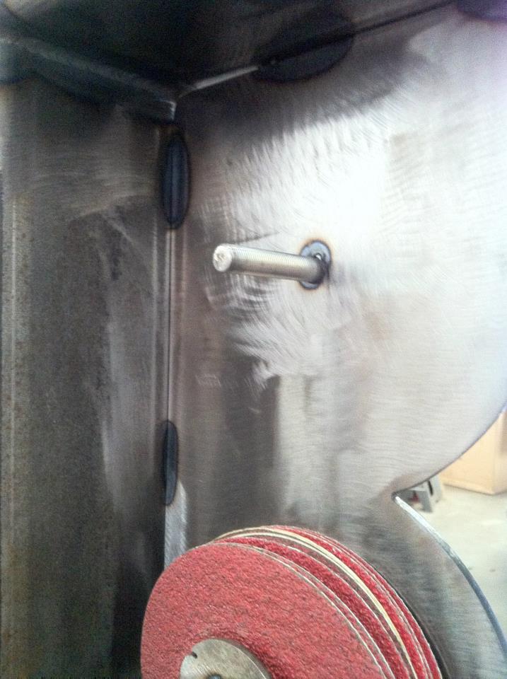

    The second thing I made is a sanding/grinding disc holder. I have disc strewn across my shop and it's hard to not only keep them organized but keep them flat. I hate that when you use a disc it ends up looking like a pringle's chip. I just cut this on my CNC Table and then used some all-thread.

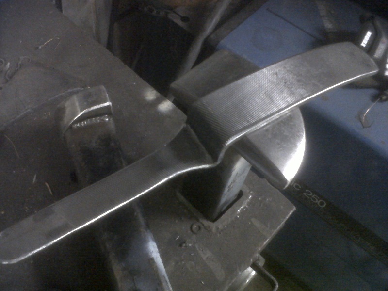

    ******* made from a 2" wide cross hatch file that works very well. I ran a DA with 80 grit over the grooves in the file. It was a crosshatch file so works much like a shrinking hammer, but with more spread and not near as much marking to the panel...

    I usually just set the hot tungsten tip on my leg so it can burn a clean hole in my skin :eek:
