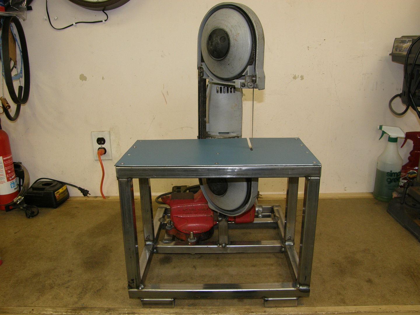

    How about a portable bandsaw conversion. I was inspired by this.........
    ........but to cheap to spend $140 so I made my own. A stick of 1" square tubing, a $2 garage sale vise and my Craigslist 6230.
    It works surprisingly well. Cut most of the 2"x3" steel and all the bracketry for my roadster frame with it.

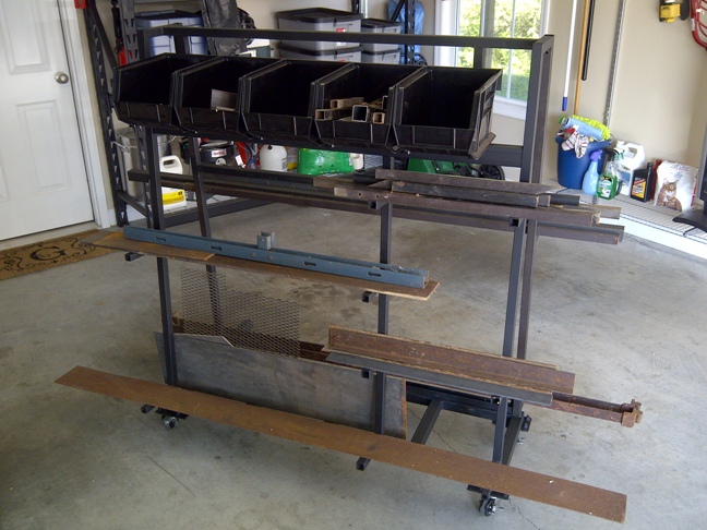

    I have attempted many searches for a metal storage rack and could not come up with anything. After reclaiming an old store awning; I designed and built this version. I just finished it and hope that you guys can use it for ideas or a good laugh.

    Looks good, I want to make something similar. I'd suggest adding a 90* upright to the ends of the rack arms to prevent stuff from falling right off onto your foot when trying to get something out of the rack.

    That's a lot better than the one I had! :)
