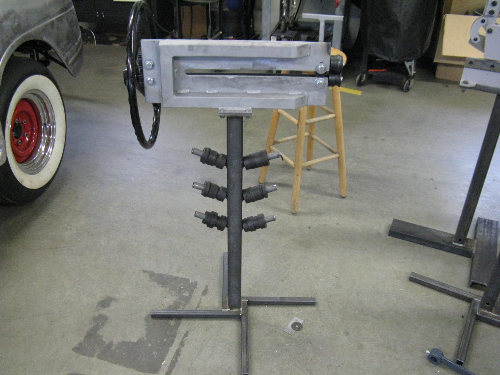

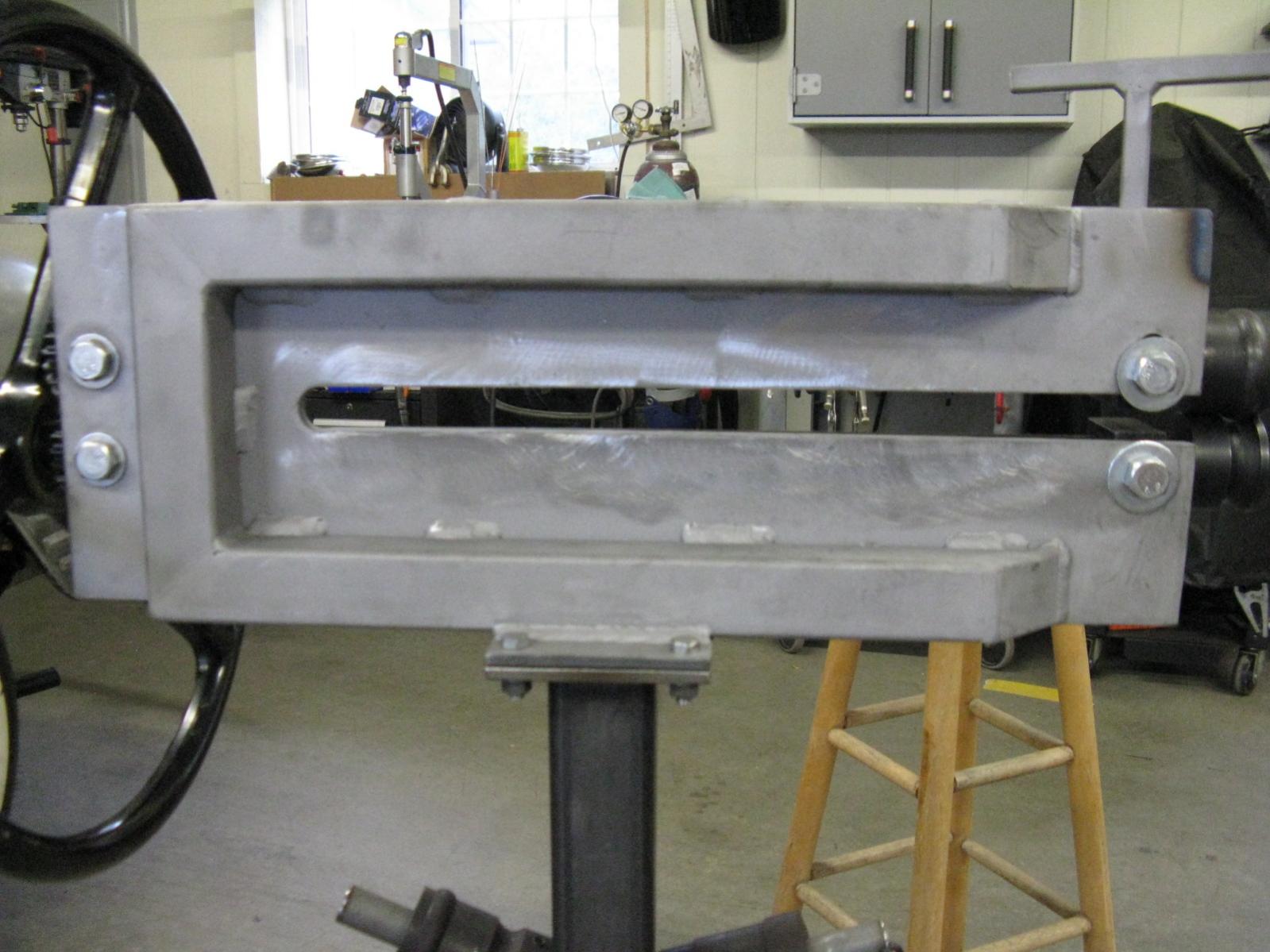

    Well, I finished up modding my HF bead roller this weekend and I'm pretty happy with it. I reinforced the frame with 1 1/2" sq. tubing, reinforced the screw down tab, made a t handle screw down, put a mount on it, grease fittings and a tractor steering wheel.
    I also made a fence of 3/4" tubing. The two screws allow you to get it square and keep it square. You have to lift the upper roll to install it. Works pretty good.
    I also build a stand to house my roller and my dies. Nice weekend project.

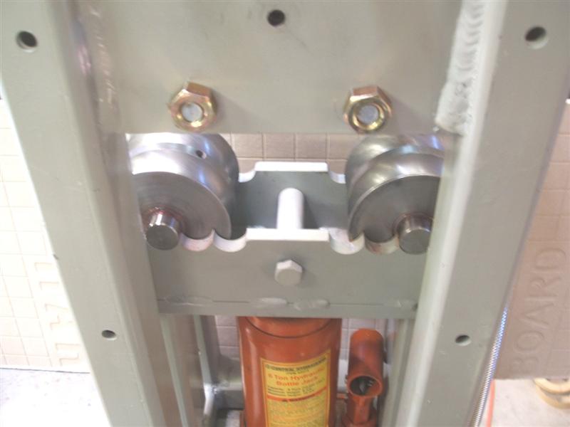

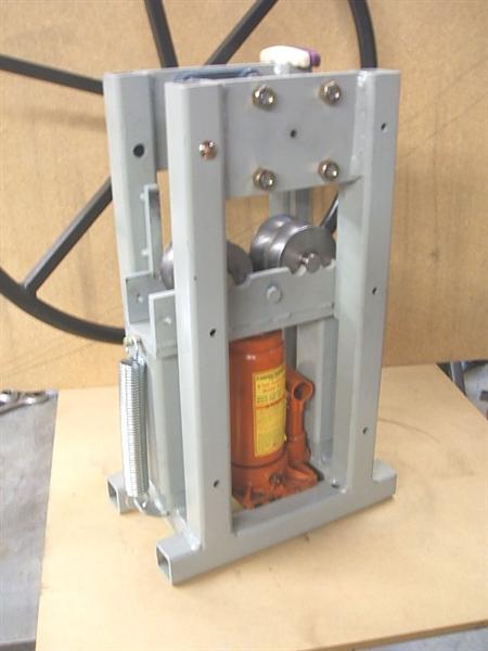

    I made this to roll curves into tubing but with flat wheels I have rolled 1/4" plate 2" wide into a 10" diameter ring. It would probably do 3/8" plate but I haven't tried.

  15. Jim Stabe
    Joined: Oct 31, 2008
    Posts: 178
    Jim Stabe
    Bruce
    To do what you want to do requires a mandrel bender. My machine rolls much more gradual curves. About the tightest I have rolled any tubing is 1" .060" wall steel to about a 6" centerline radius to make a handwheel for my English wheel but even at that I was starting to get a little flattening of the tube. I made the machine to form a gradual bend in 1" tubing that would be the ****pit rolled edge on my MGB and I couldn't figure out any other way to do it.

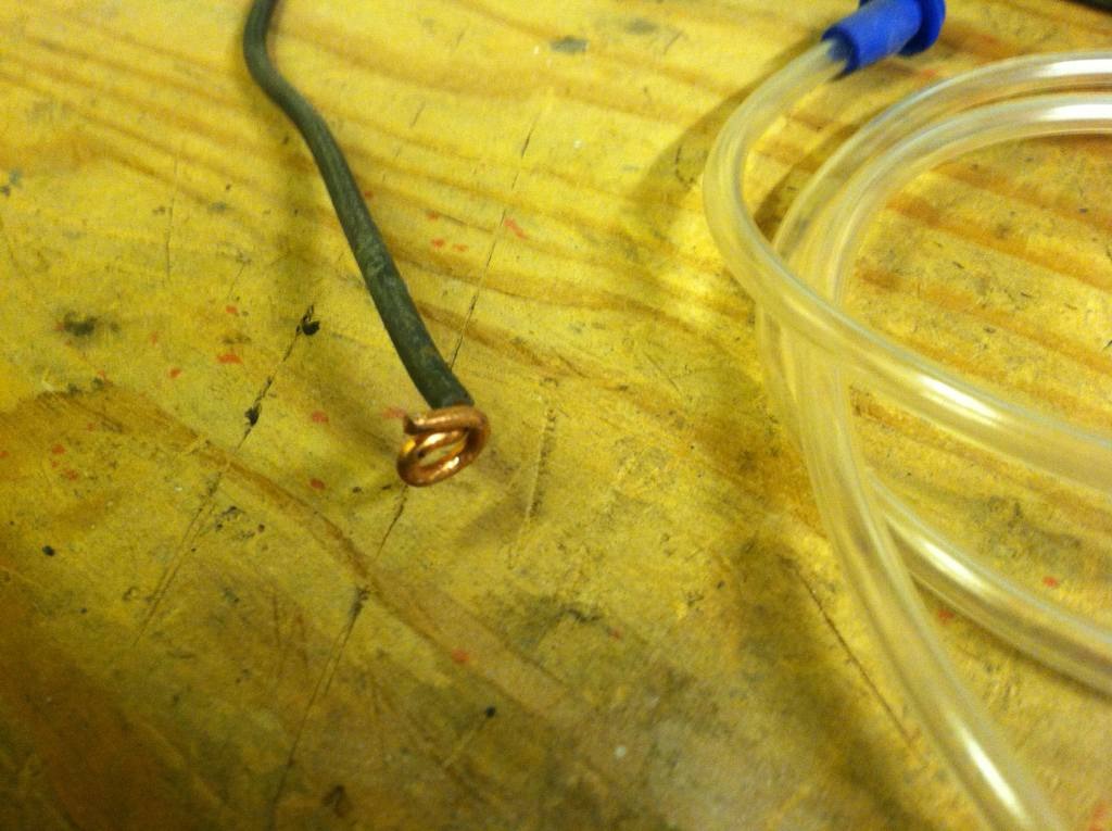

    My dad used to put his ear on a long screw driver and touch it to different parts of the motor to figure out where the noise was coming from. When my wife's DD started whining and everyone said it was the water pump, I didn't want my face that close the moving parts. Solution? I made this listening device out of a breast pump vacuum hose, some ear plugs and a length of #12 solid wire. ImageUploadedByTJJ1349722559.349310.jpg
    I put a point on one end of the wire so it would fit in the tube:
    And made a little foot on the end that would make contact with the culprit. (I discovered that this worked best through trial and error):
    The tube is long enough that I can hold the wire at arms length and still keep it in my ear. The next step was to drill a hole through the earplug to allow sound the p*** from the tube to my ear and jam the hose in:
    With the tube in one ear and the other earplug in the other, you can explore around for the noise and keep your head a safe distance from the moving parts. It works great! I've used it several times since then. You hear every little vibration on the foot. Even just dragging it along the bench. Leaving the insulation on dampens out the sound of your hand on the wire (trial and error again). The culprit BTW: it wasn't the water pump, it was the idler pulley.

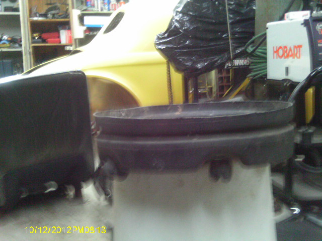

    What too do with old roll a round shop vac? Me and 8 Bud lites later , I think i will make a roll a round drain pan!! when you are finished , hand it on the wall!!
