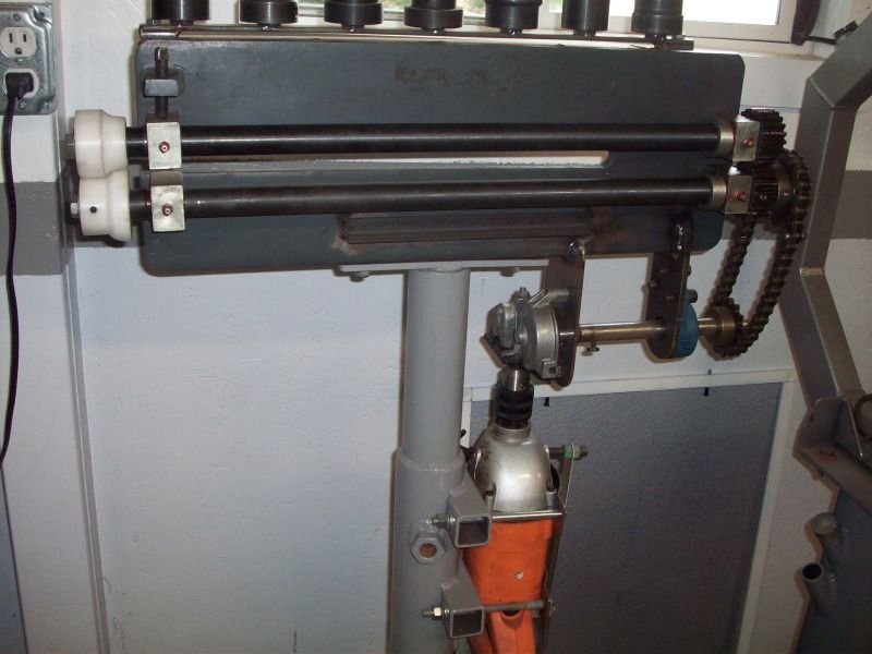

    I used a HF 1/2 "D" handle drill to power mine. $28.00 on sale. It drives a GM power window transmission to get the 90 degrees and for the gear reduction.

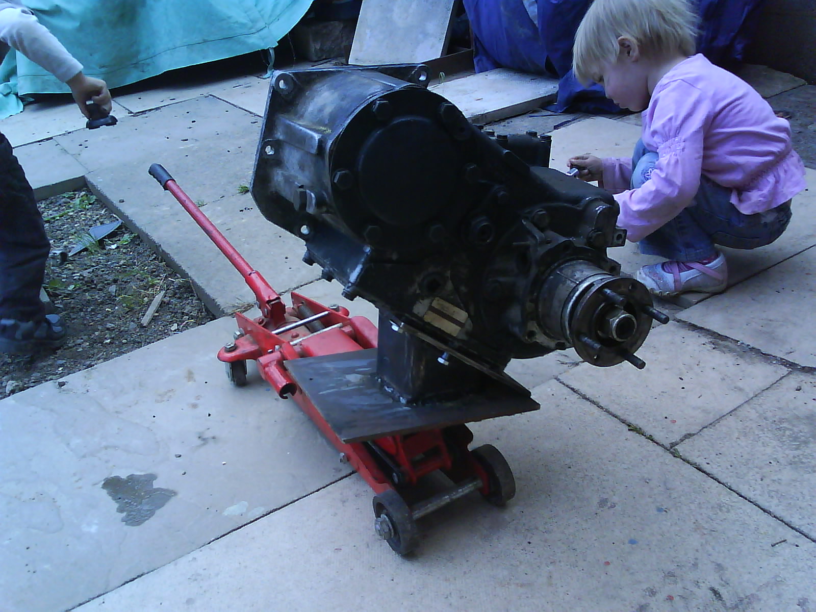

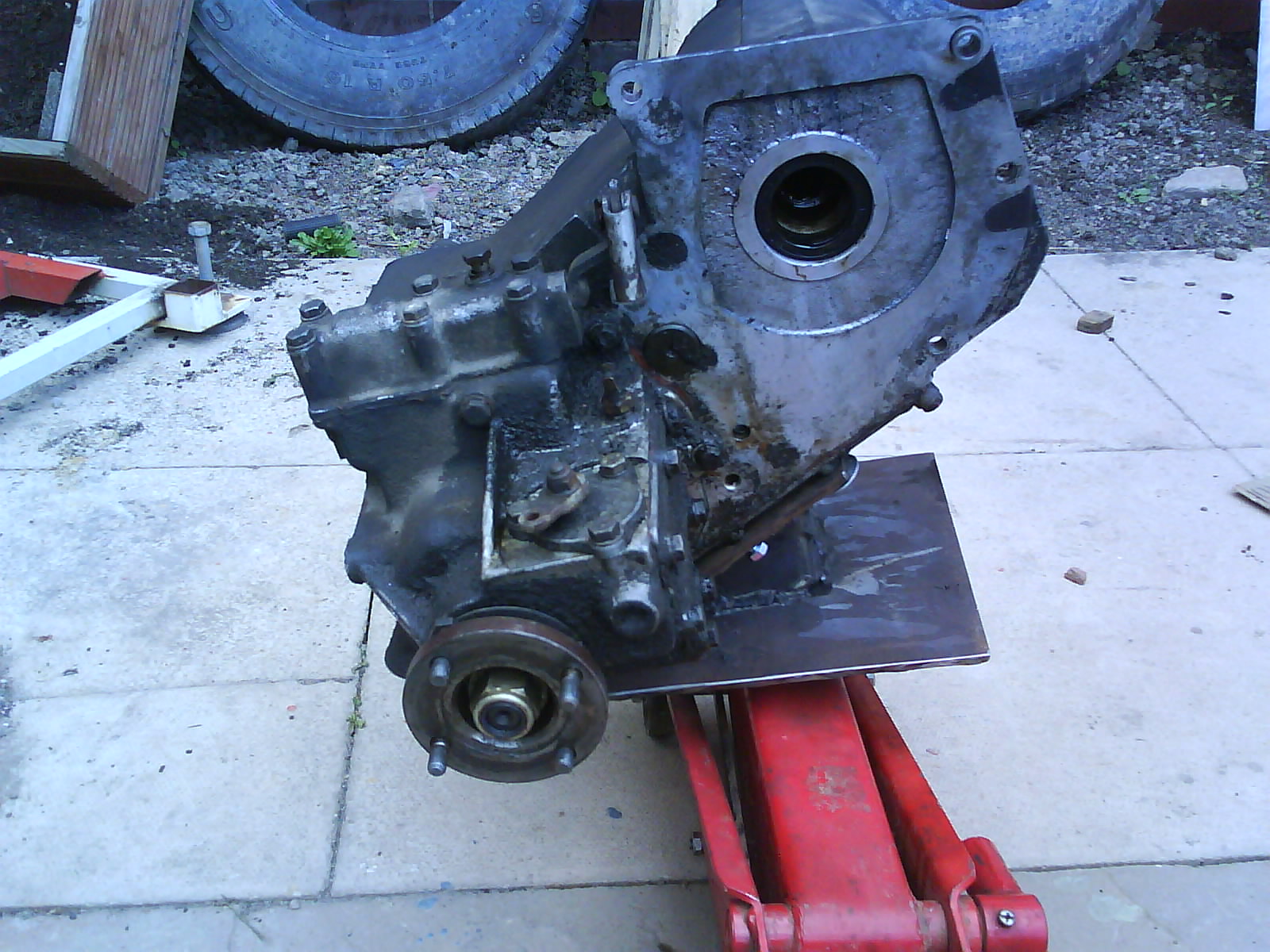

    heres a transfer box adaptor i made to my floor jack allows me to lift it square to gearbox then slide it on.
    you may notice most of my tools are for landrovers.
    even got pic of boss in one, not allowed to do anything without her helping.
    she is actually a fair way from jack just looks like she is next to it.

  9. Can you reverse, and control speed?
  10. RICH B
    Joined: Feb 7, 2007
    Posts: 6,013
    RICH B
    I saw a similar set up, where a homemade foot pedal operated a bike cable
    which in turn pulled the trigger on the drill for variable speed. There is a video somewhere on you tube that shows it in operation.
    If you wanted to dedicate the drill to the roller, you could probably get inside
    and wire a remote reversing switch. We used to put remote switches on the big 1-1/4" Black and Decker drills we used on our shop made truck frame drills.

  16. How does that wiper transmission hold up ?
    My bead roller has some huge motors and gear boxes on it.
    It will roll 11gauge too.
    Treadmill motors are great for stuff.

  18. cabriolethiboy
    Joined: Jun 16, 2002
    Posts: 892
    cabriolethiboy
    Yes for both.
  19. cabriolethiboy
    Posts: 892
    cabriolethiboy
    It has held up so far. Like I said if I had to do it again I would do different. But if it doesn't break, I won't fix it.

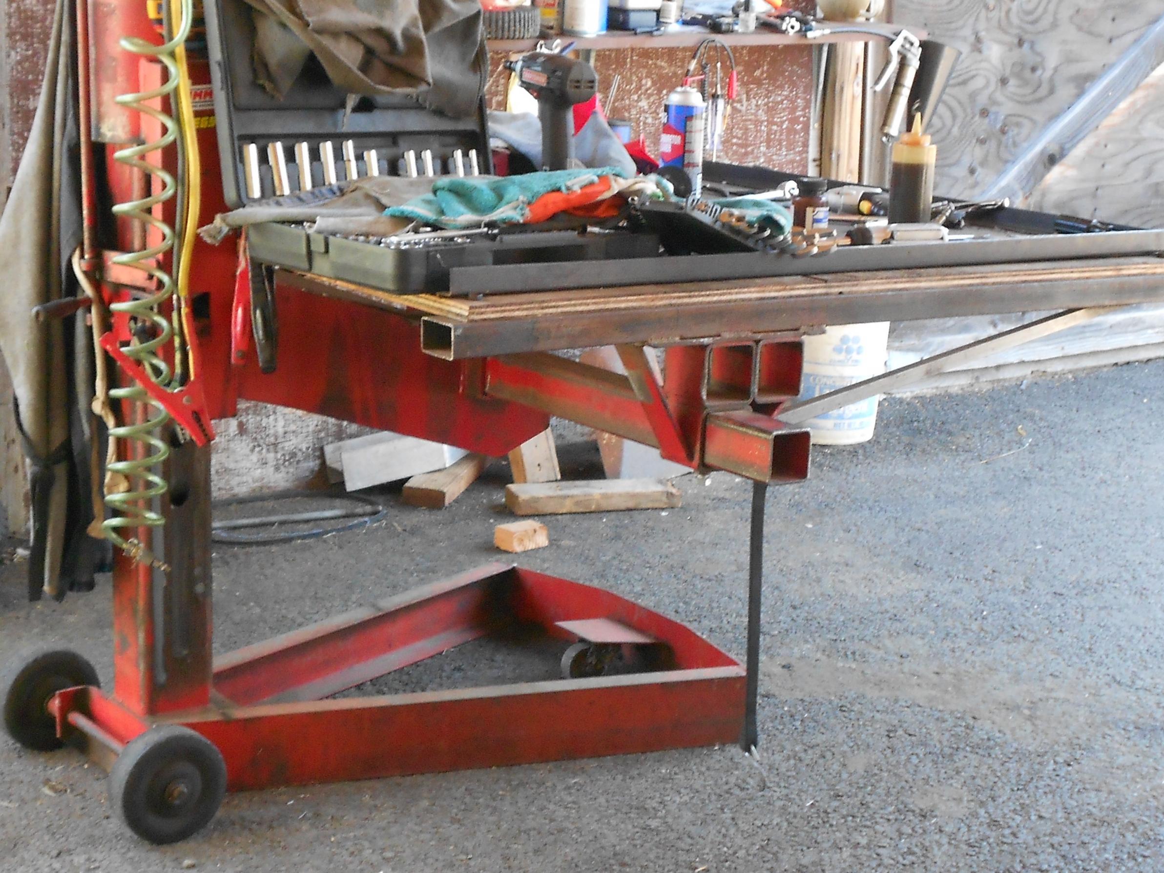

    lift table made from a front end lift...

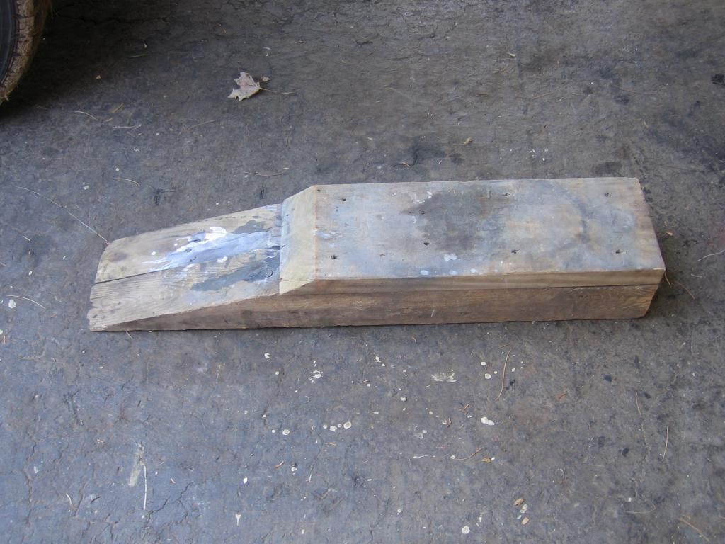

    My Ramps. Great for low cars and free to build
