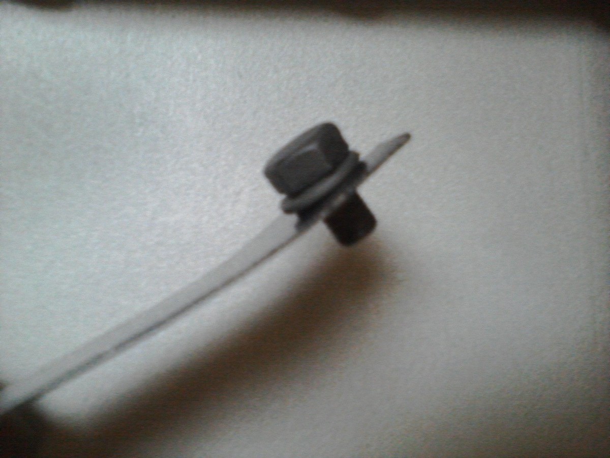

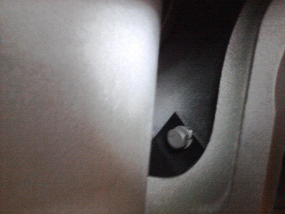

    When using HotHeads adapter for 331hemi-to-727xmsn, there's very little room to get at the torque converter bolts. In fact, it's near impossible from the bottom area; so the next best place is where the starter mounts. Even then, I couldn't get the bolts started. (dexterity and fingers not being what they used to be)
    Had a piece of heavy banding material laying around. I think it was 1" wide and fairly thick. Made a notch in one end that held the bolt firmly and made a slight bend about 1 1/2" down. With the bolt in the notch, I fed the "guide" down through the starter opening, then held onto it while using the other hand to start the bolt. When it was turned a few revs, the handle was pulled down and out of the way for a short socket.
    The notch can be done by drilling a hole first, then snip the middle out; as long as the result will capture the bolt but not too hard, so that it can still be turned. Helps alot to buck the material while drilling.
    BTW.....There was only one position for the 4 holes of the flex-plate and TC to line up. Best to establish this and mark somehow beforehand; else be cussing like a sailor.

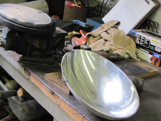

    At Good Will found some heavy Aluminum cast bowls. Ground the bases off and mounted them to plywood bases. Neet shaping dollies for aluminun and light steel, Ray

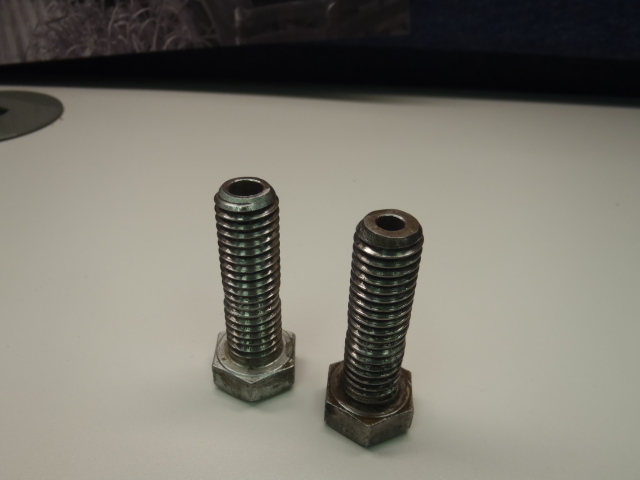

    Here are some jigs that I made to drill out broken exhaust bolts.
    I'm sure they would work for other applications where the bolt is broken flush with the surface.
    Here's how I use them for broken manifold bolts:
    1. Remove exhaust manifold
    2. Tap a thread in the manifold hole to match jig thread
    3. Re-install manifold
    4. Screw jig into threaded hole
    5. Drill through broken bolt
    6. Repeat process with graduating hole sizes in your jig until most of the seized bolt is removed.
    7. Chase the hole with tap.
    8. Yo, problem solved (vanilla ice)

    question - how did you drill the bolts to make the jigs? mill?
  27. Caddy-O
    Joined: Aug 8, 2006
    Posts: 1,664
    Caddy-O
    Used a metal lathe to make these...but you could probably find the center on the bolt head and drill it with a drill press...

    Okay.. I am confused as normal.. if you have a metal lathe, why tap the manifold? why not make a dowel that is a press fit in the exhaust manifold hole?
    That would be like a tapping block to hold the drill-tap square to the face of the work.
    Gun-drilling on a lathe is a art in itself, getting a straight hole that does not wander as you drill, A resharpened bit is a nightmare on a deep hole. I had a loupe borrowed at one time that had a angle etched into it, you'd look across the end of the bit and check cutting angles on both sides. My eyes watered up when I had to return it. No clue where you buy them. I am no machinist. (retired electrician/tech)
    I started making a home-made edm to burn out bolts. Bought a book on them and "he used" a vibrating engraving pen, a rod, fluid and reverse polarity on a stick welder to "burn out a center hole" in a broken bolt. USING your idea on centering that'd make a guide if you made if of UHMW, Nylon or other non-conductor. My home-made edm makes the lights flicker in the house next-door, as everything else I do it is overkill.
