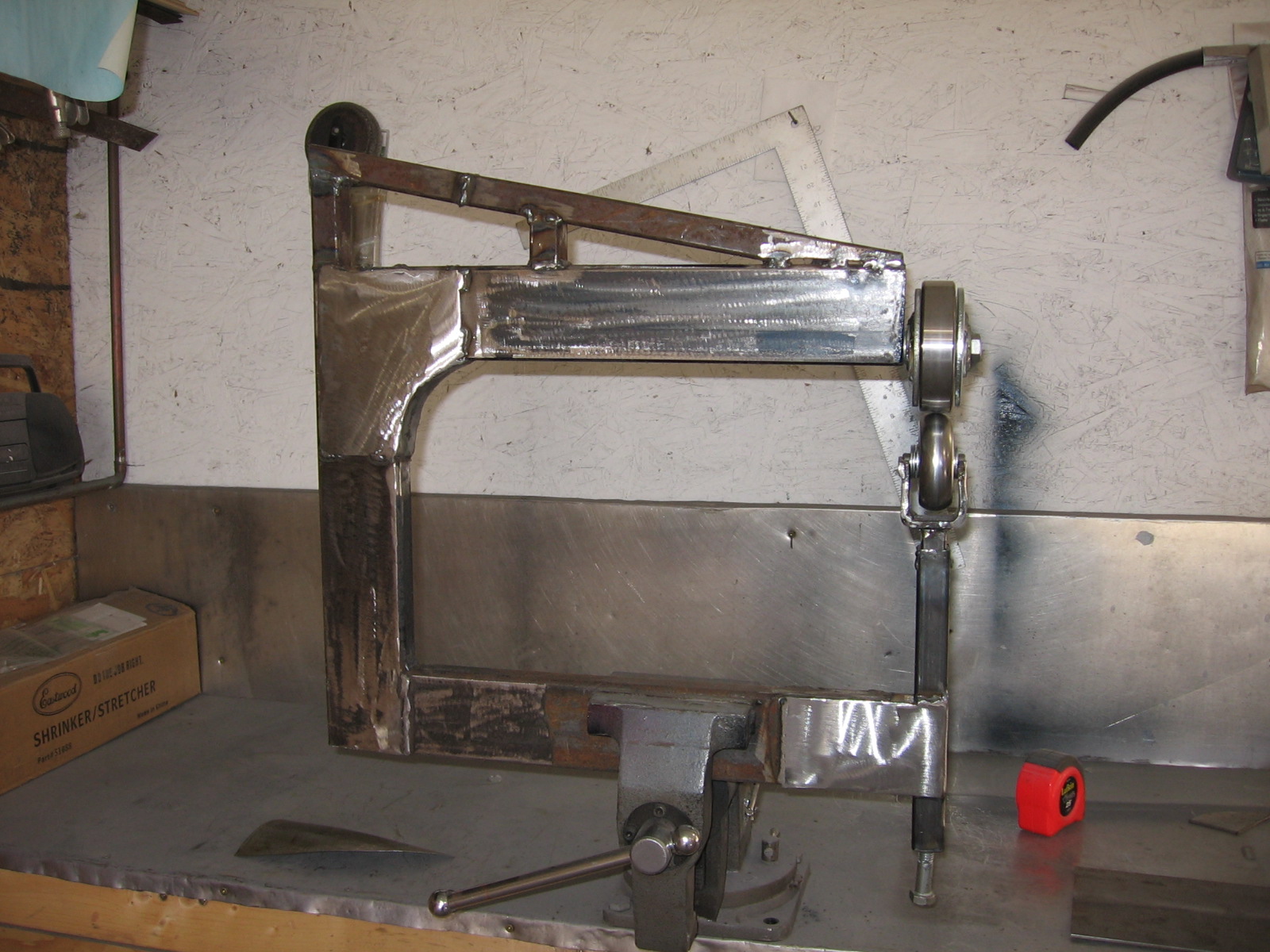

  1. Heres another E wheel for ya . I knocked this one out in a couple days . Just a few more tweaks here and there and its ready to be prettied up LOL !!!

    :cool: pretty clever mate. Will do one as well. :cool:
    LOL thought i was the only one that noticed

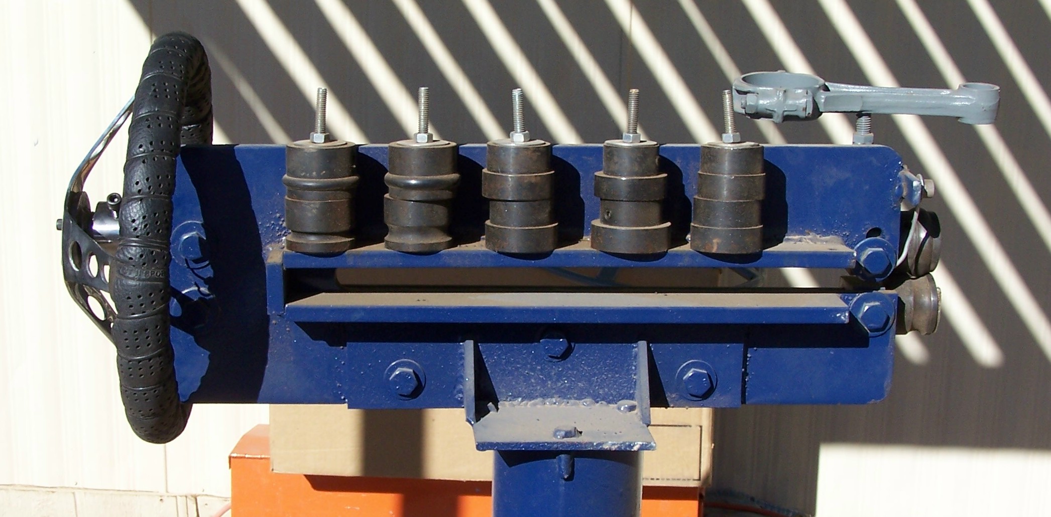

  4. Here is the adaptor. It bolts any Grant 3 bolt style wheel to the bead roller. Cool part is, you can also invert the wheel if you want it closer to your work.
    If ayone wants one, just PM me.

  16. Thank you, now I expect to see some cool artwork on the bead rolling thread from you.

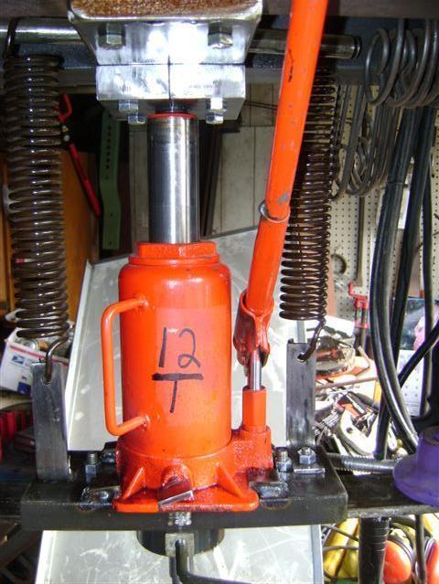

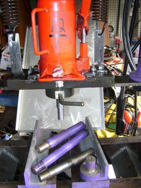

    I started this 17 years ago and just up graded the bottle jack to a 12T from the 6T i started with. I cut down lots of driveshafts for the local street rodders and they always come in with the u joints and i need to remove them. I also have a little machine shop and need to broach in keyways in some of the parts i make as well as press in bearings. I can make tooling for about anything i need pretty quick. Thanks for looking...Bob

    Thats nice. Ive been thinkin of buildin one for some time. I understand the purpose of all the tooling pictured, but when you say "i cut down a lot of driveshaft" what do you mean? What does an hydraulic press has to do with cuttin? Im just curious im not talkin shit.
  20. Just read the post/posts- the driveshafts to be cut come in with the u joints still in and those u joints need to be pressed out before the cutting process happens.

    It really has nothing to do with cutting them off per say. But when i turn the cut off end in my lathe to remove the weld from the yolk the u joint has to be out for my live center to poke in the end of the yoke. Hope this helps...Bob

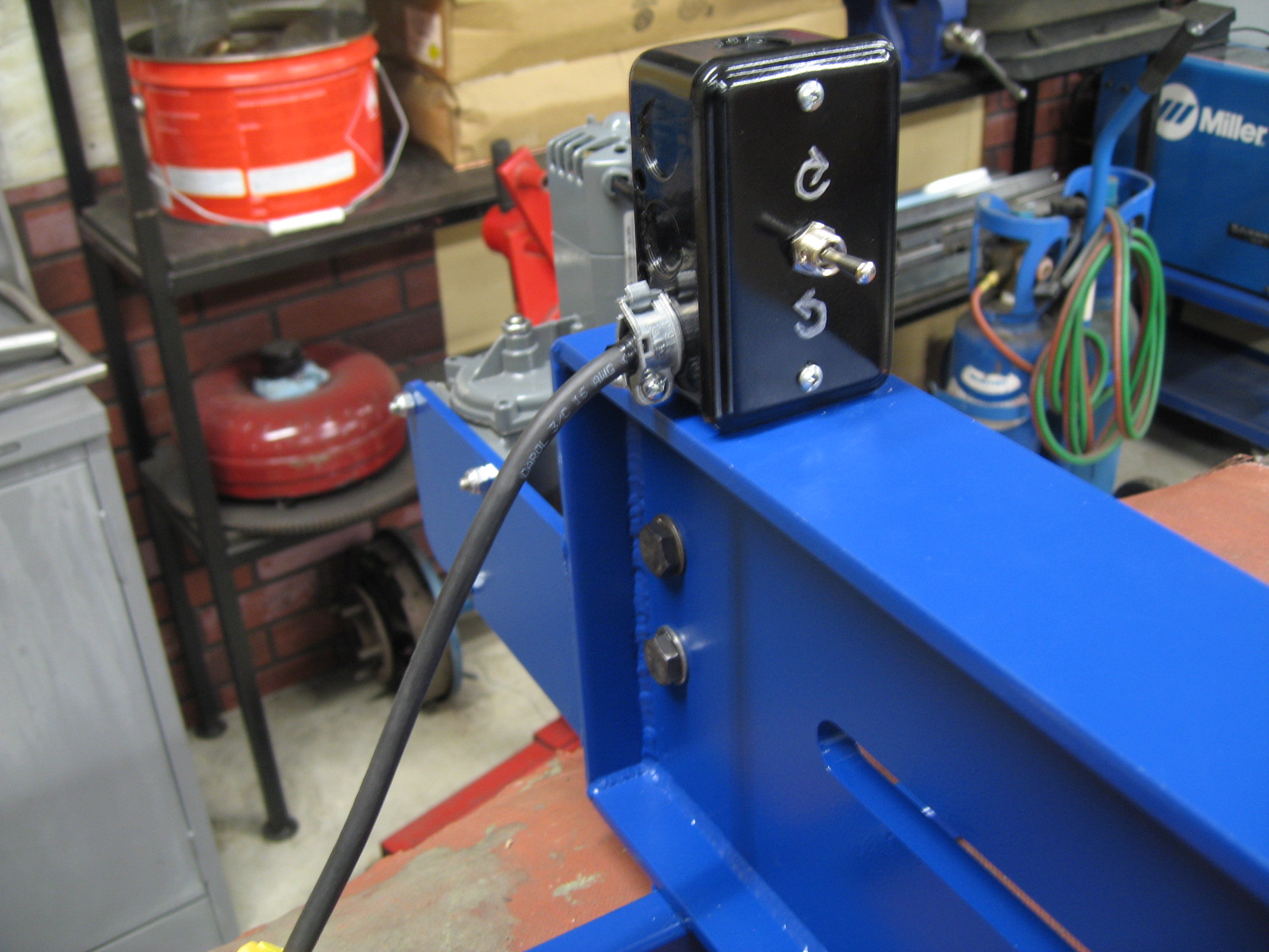

    I made a separate thread on this but it should also be here I think.

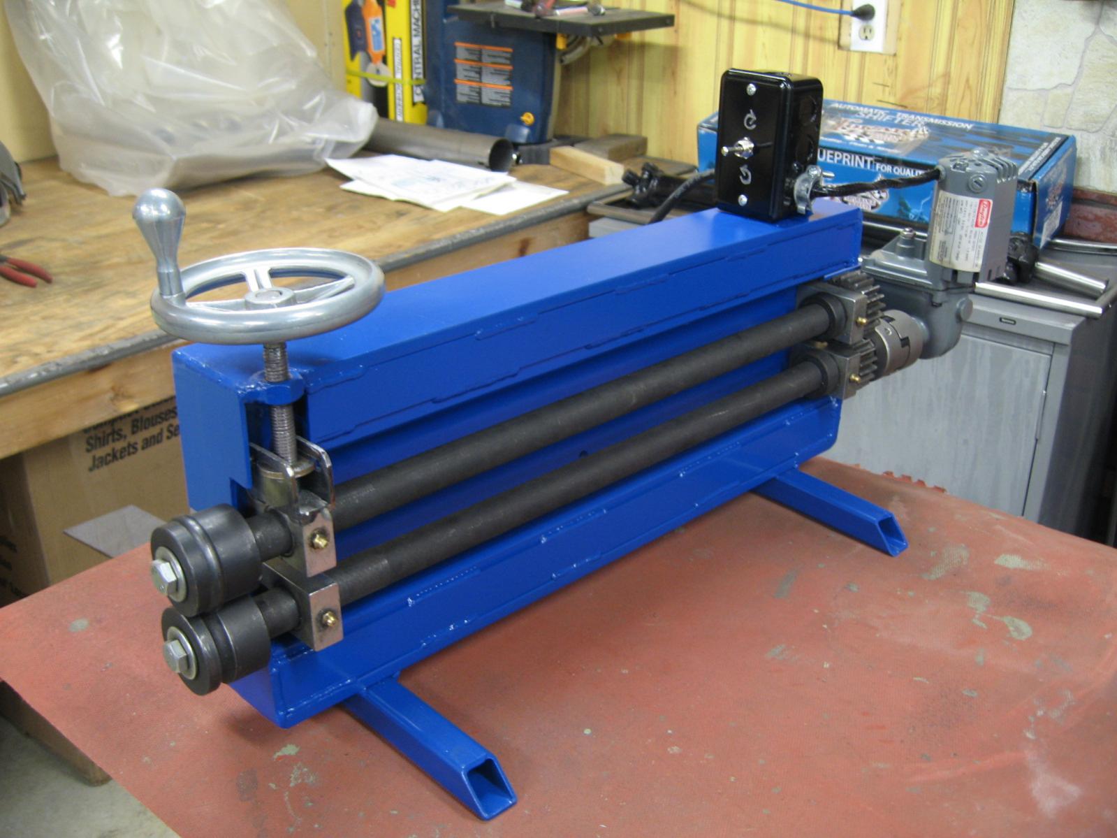

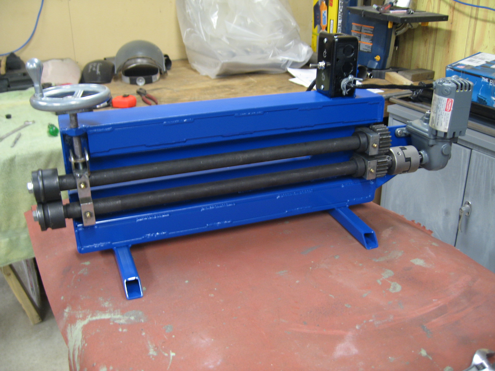

    I bought myself a Magnum tools bead roller and decided to beef it up for stiffness and to also power it with a gear motor.
    I welded some extra metal around and into it which greatly stiffened it, it will now roll 16 gauge without protest if needed.
    I also modified the top die pressure screw so that the top die can be turned down and also lifted for changing dies without loosening any bolts.
    The gear motor is a Dayton which has a 1787:1 reduction so it gives about 2.8 RPM speed to the dies under load.

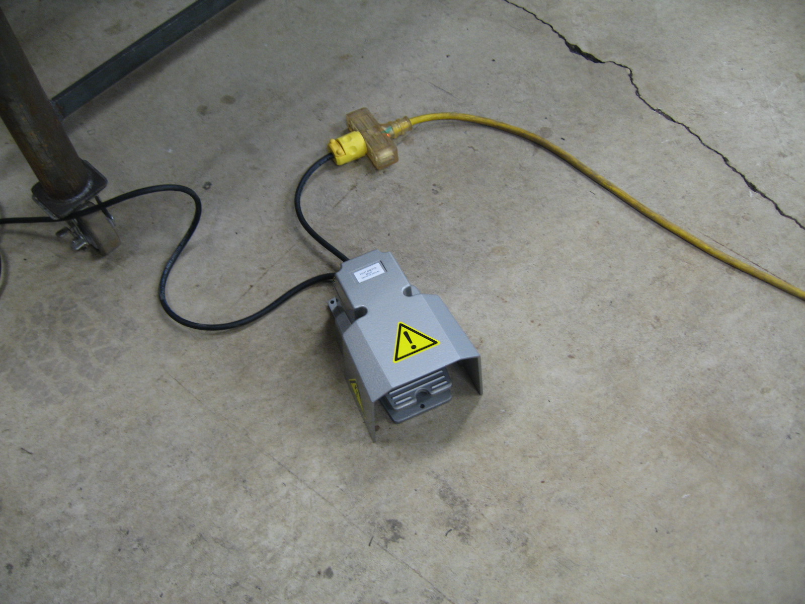

    I wired it so it is reversible and it operates with a foot pedal.
    It came with the basic stepping and bead rolling dies, I'll add to my collection as I go, likely tipping dies, and louver dies too.
    Pictures.
