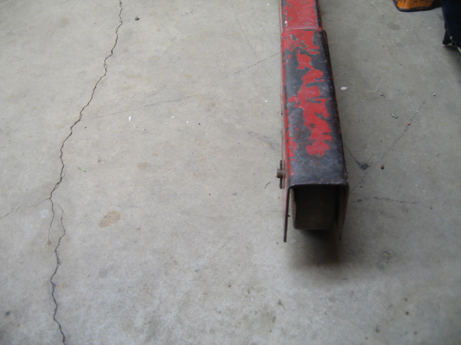

    While I like the idea behind the bigger wheels on your hoist what kills it for me is the extra height you now have at the front where you will want to roll it underneath a vehicle.
    I have found mine to be too tall already in the stock form.
    The idea I have to modify mine is to move all the wheels up in the frame and then have the front wheels set into the front of the tube essentially lowering the whole thing closer to the floor.
    In the construction of my 26 RPU the only way I can get the hoist under the car is to have it sitting up on the 4 ramps.
    Sitting on the tires there is no way it will go under.
    My son has a hoist I used to own that is a much better design. If I can I'll get a picture or two of it soon.

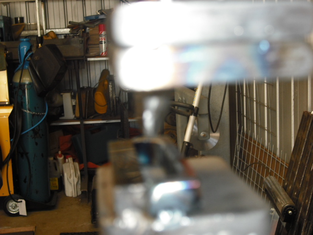

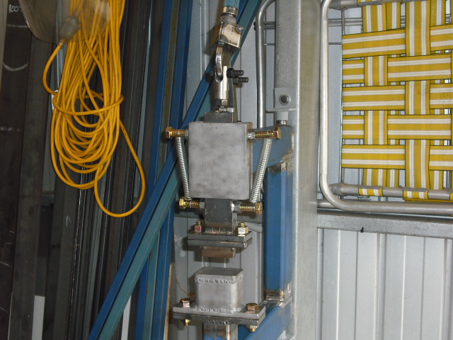

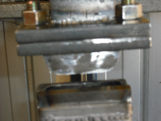

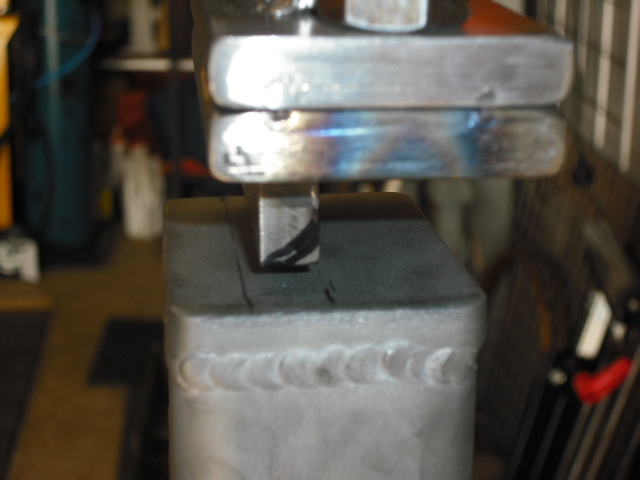

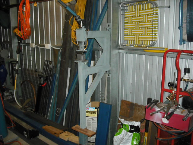

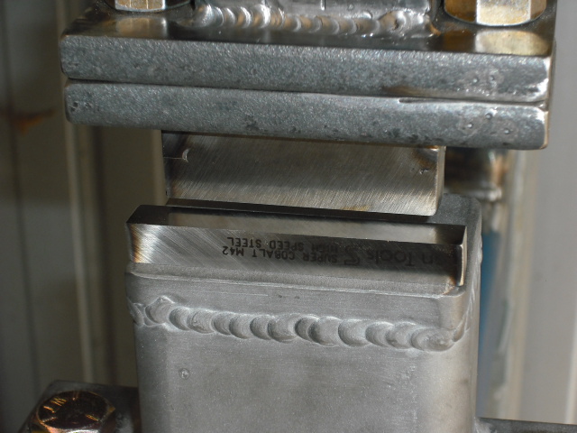

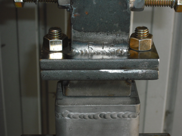

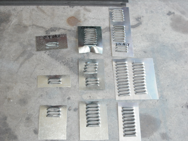

  12. My latest home made tool is a louver press. 1 of many tools I have made myself. I am running out of room to store them all!!!

  13. barrnone50
    Joined: Oct 24, 2010
    Posts: 573
    barrnone50
    from texas

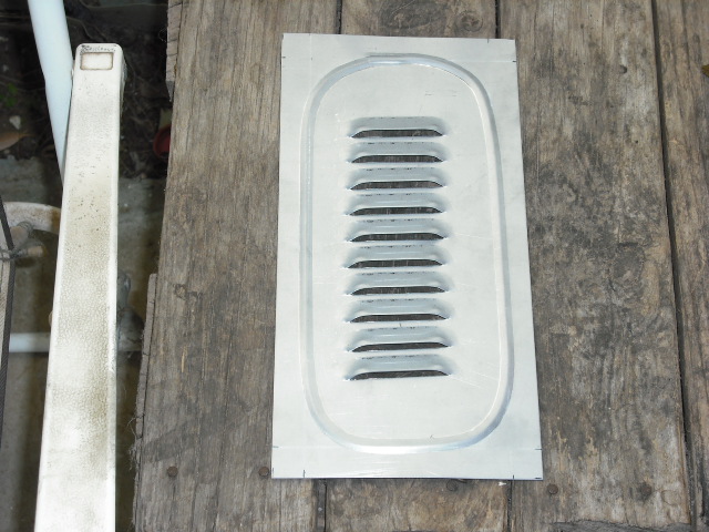

    Sure like your louver Press! Does it cut the louver or do you have to make a slice,and press threw?Would like to see a close up it you don't mind,not to copy but to get my little brain around the upper structure, I have a Idea with a hydralic unit. Thanks George:D

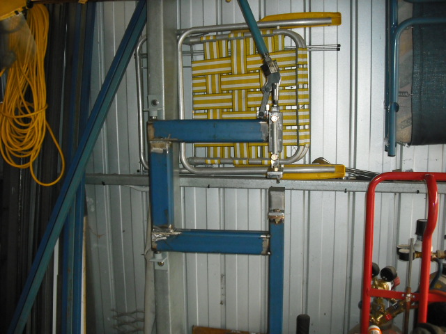

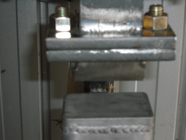

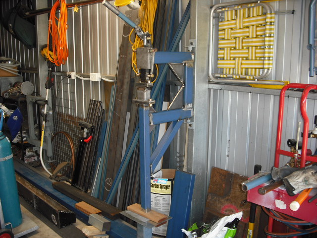

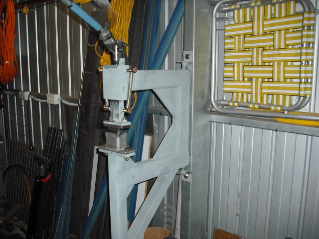

  15. No worries barrnone50. I have included all the pics of the build. I have to say this is not my idea either. I got it off the net as well. And to answer your question, I use a hand-lever to punch and press all in 1 go. No need to pre-slice the panel. The top and bottom cutting blade is made out of tool steel. I have only been able to press up to 1mm thick but if my press is going to be used quite often, I will change it to a hydraulic set up or an air ram to press thicker material. Hope this helps in any way. I couldn't load all the pics in this thread so checkout the next thread from me.
    Mtw fdu.
  16. Continuing on from my last post.
    If I change my setup to an air ram I will use a foot pedal as well. Much easier and definitely faster than using hydraulics.
    You can see in 1 of the pics that I can easily store it out of the way because it is on a couple of bushes top and bottom.
    If you need any more help or questions I am happy to help in any way.
    Mtw fdu.

    really like the louvre press,im planning a rig for my small hyd.press.
    the wall mount is awesome,a real space saver.
    shop space is a premium for me too.
    the building in the avatar is only 40x80,but my wife only lets me use it in the summer,she fills it with boats in the winter.storage business is ok for a little money,helps with property tax.

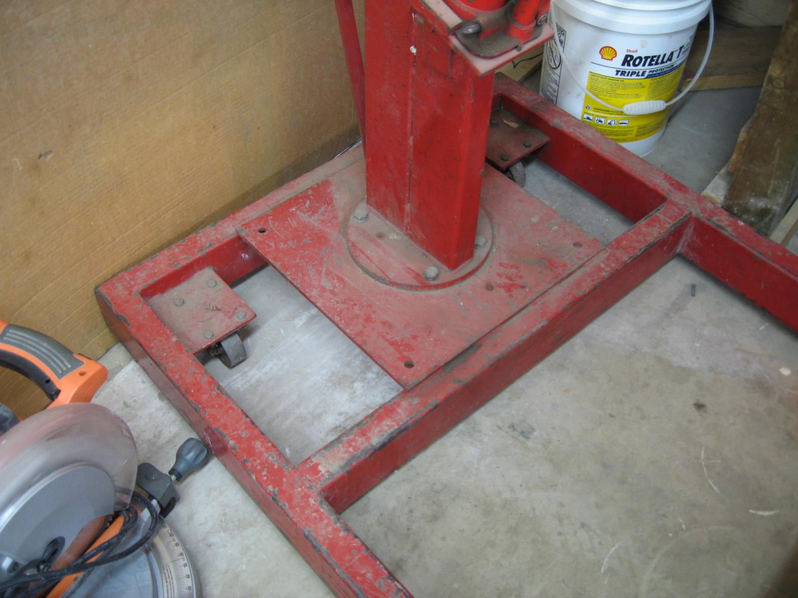

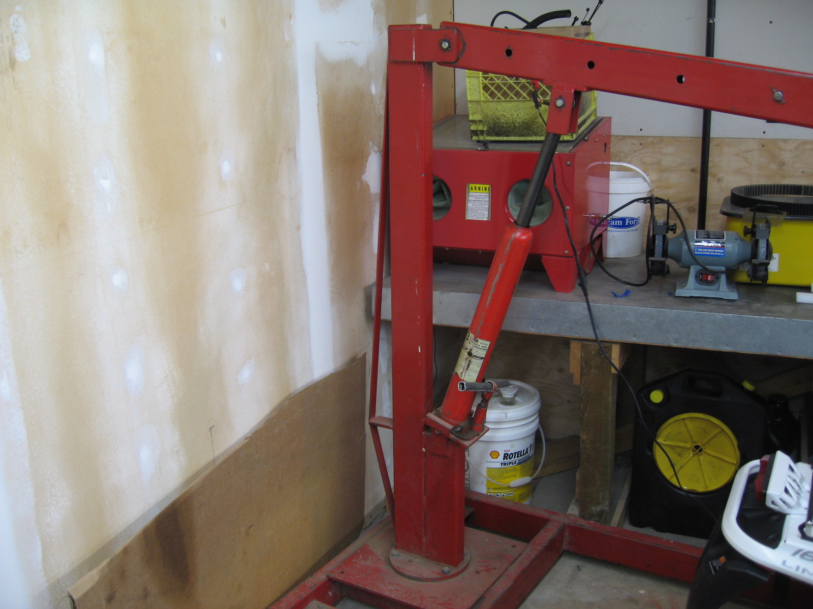

    A different engine hoist design, my son owns this one.
    The legs don't fold up but you can unbolt the jack tower part of it with 4 bolts to stow it away.
    The main advantage of this one is the low height from the floor so it is stable as well as easier to get under low vehicles.

    fibertech
    But that setup only allows for swivel wheels in the rear. if you need to swing the hoist sideways from the front your screwed. That's why I chose my design.

    I gave that hoist to my son after having used it myself for over 20 years and on many different projects and even for different purposes.
    I intended to build one for myself but ended up buying the folding one instead. I may still build one in the future.
    I can tell you the non swiveling fixed front wheels are not an issue most of the time.
    Even with an engine and trans hanging off of it you can slide the fixed wheels sideways on a concrete floor easily by shoving with your foot on the front leg.
    Believe me it doesn't take that much effort, so you are definitely not screwed.
    If your floor is extremely rough concrete, maybe so, but otherwise it's a piece of cake, I did it many times over the years.
