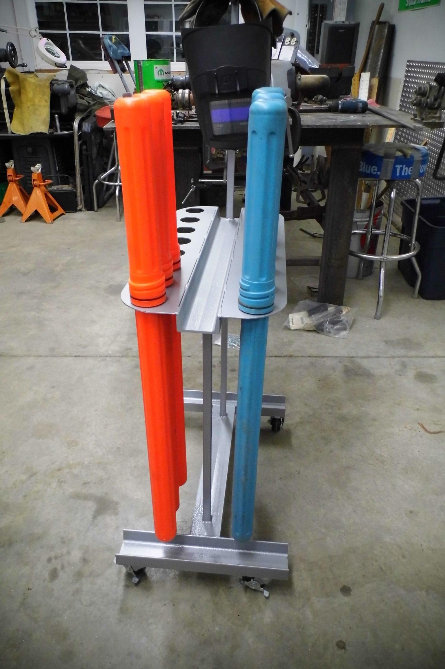

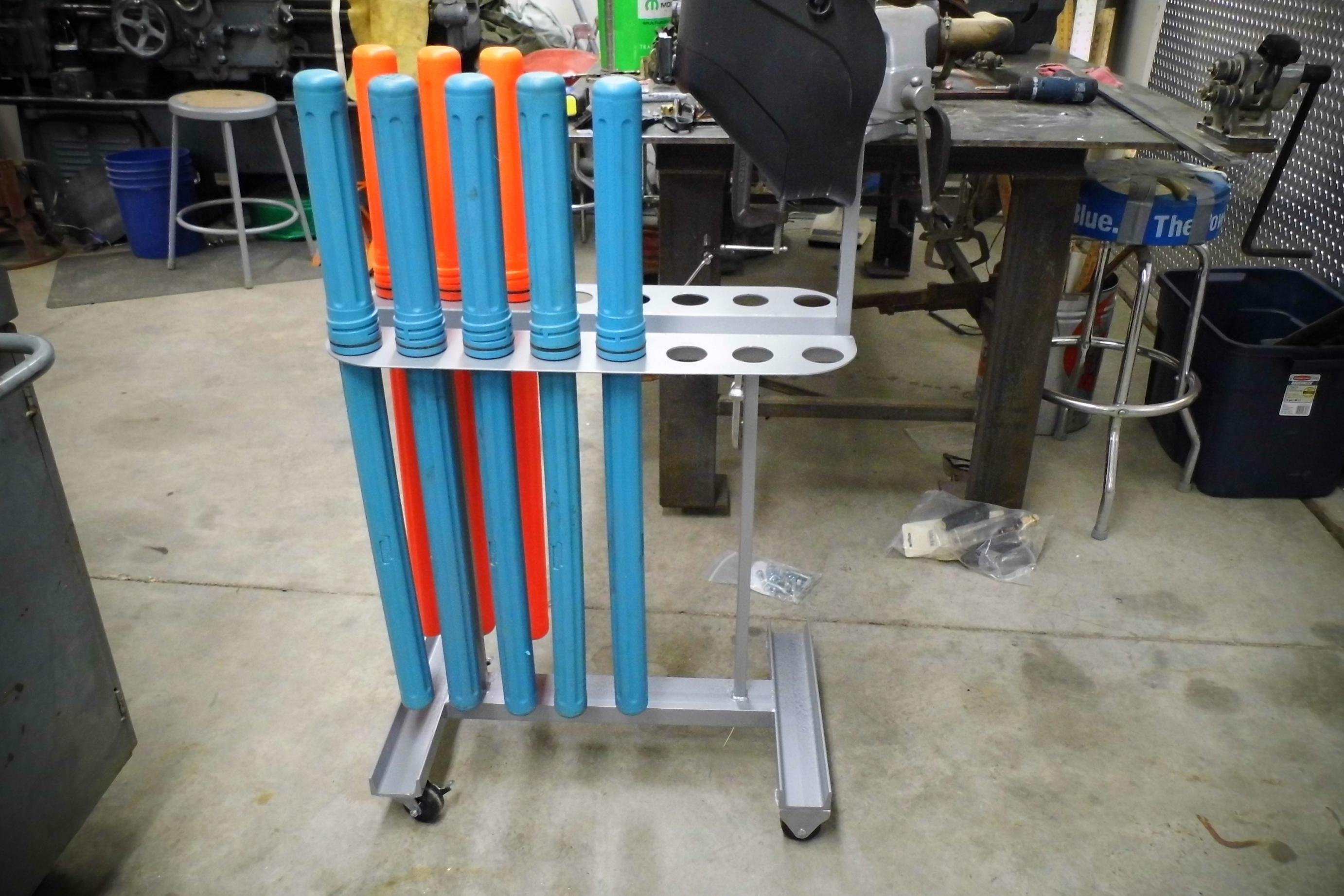

    I got tired of stumbling over the bucket that i had all of my tig rod guards in so i made this caddy for them and my helmet. DSCI0045.jpg

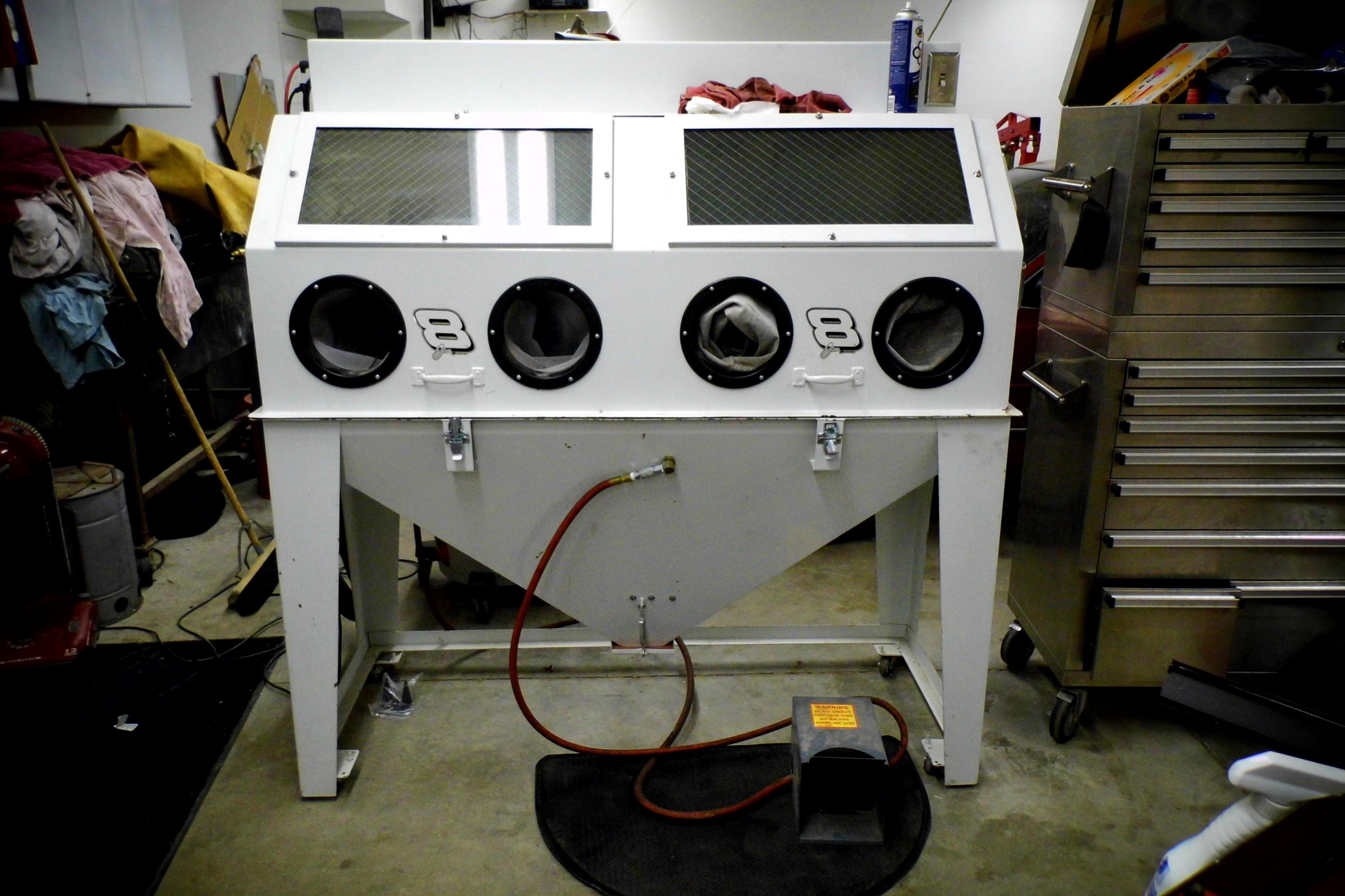

    DSCI0047.jpg This is a gl*** bead blaster that i made with the help of a friend with a large sheet metal break!

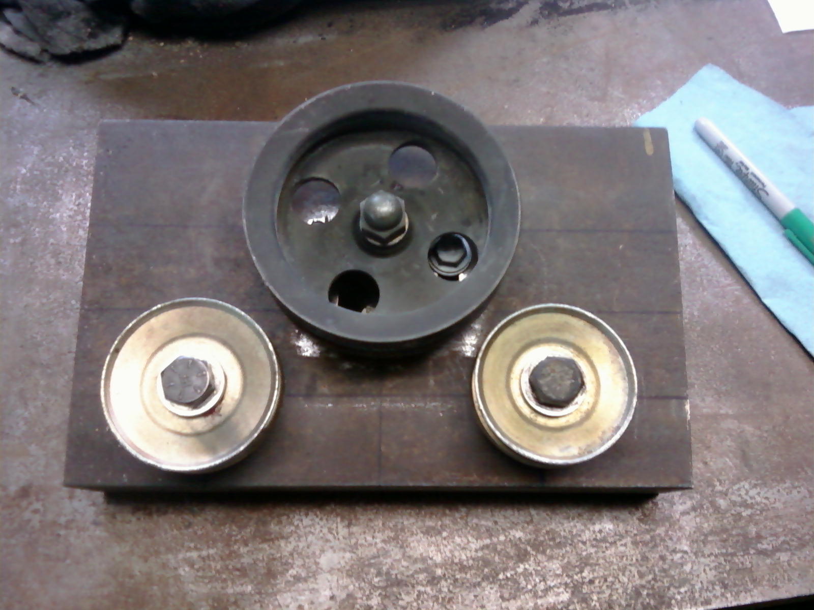

    I made this tool for straightening coiled brake and fuel line.
    I used a subaru power steering pump housing and some alternator pullys.
    You can just push the tubing through the thing and works good .

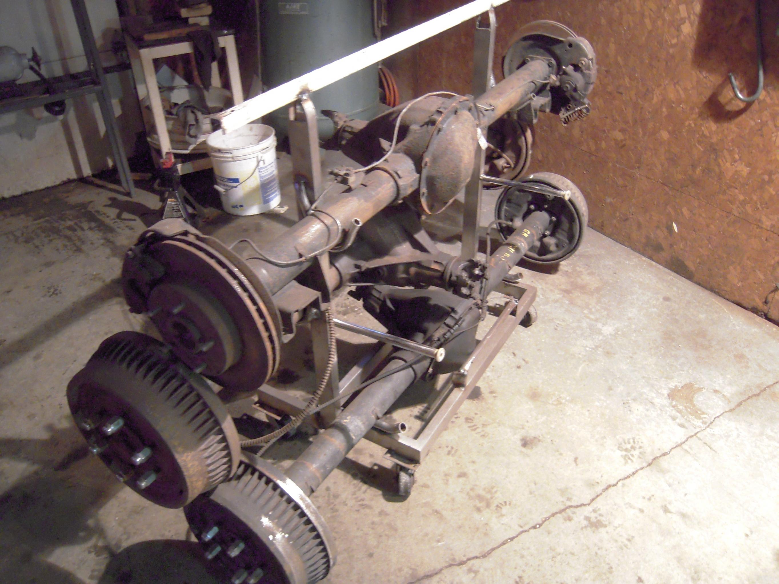

    Nothing really special about this rig. I keep a two wheeler in my shop so I welded up a fixture to mount on it. It makes moving a rear axle around in the shop a bit easier. It mounts on the two wheeler with just a couple bolts. I 've added a a brace to the front to hold the pinion shaft horizontal not shown in the picture.
    It has come in handy when picking up a rear axle at the salvage yard.

    Seems like rear ends are not a big fan of sitting out side for any amount of time. every time i would move one over to cold storage,,, The Wifes side of the garage,, There was one already there. So I stacked,em. It will also fit threw a doorway.
