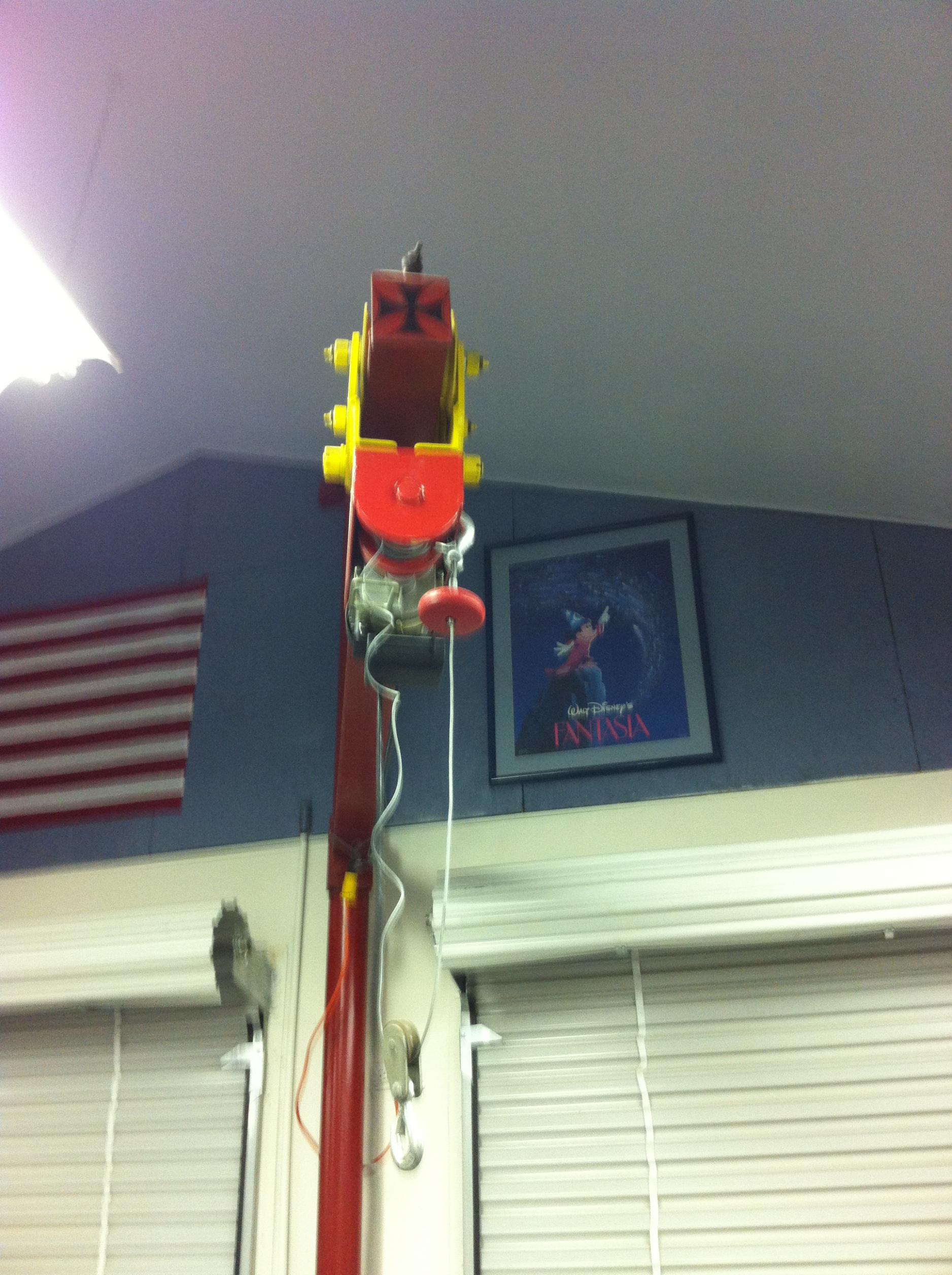

    This is my home made crane. Now that I'm old and wornout I needed some help lifting heavy items in my shop. This will life a SBC into a pickup bed. Works greats :eek::eek:

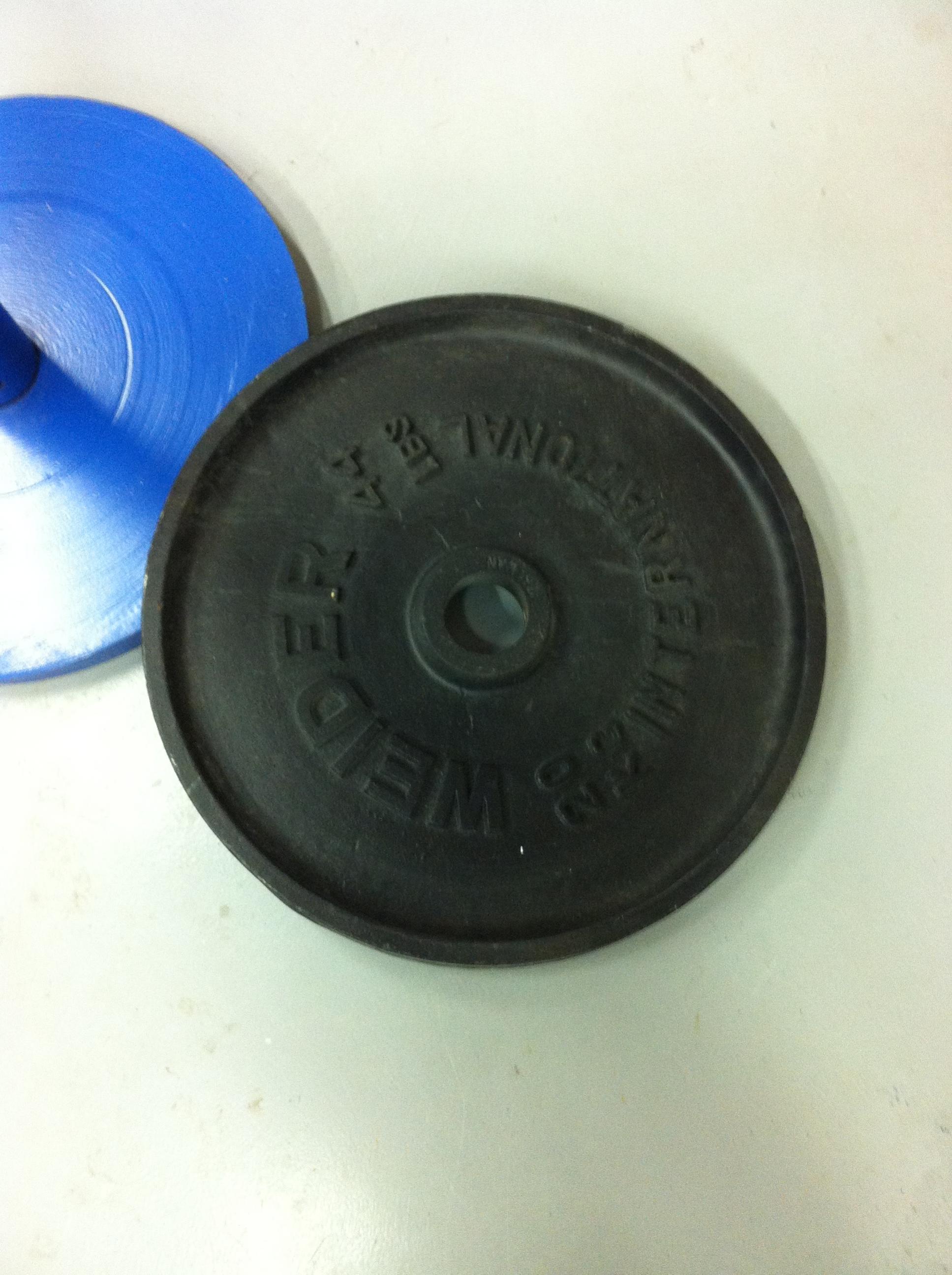

    What do us old farts do with 44 pound dumb bells when we no longer can lift them:confused: We make stand bases out of them:eek:

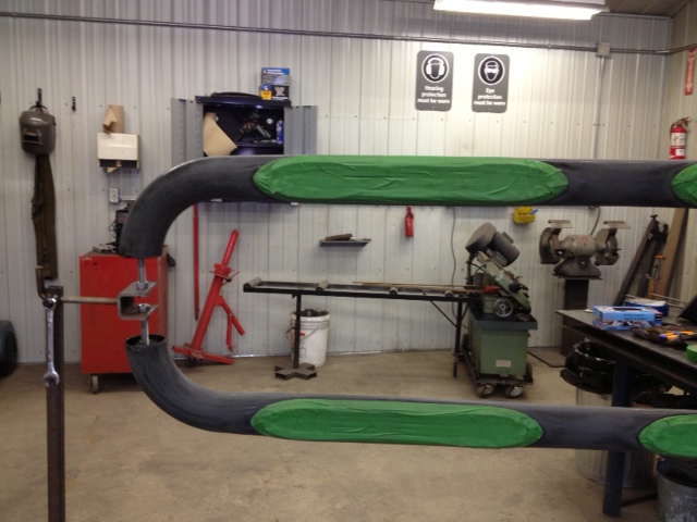

    rotisserie for truck tube steps,how to manage these things for painting.

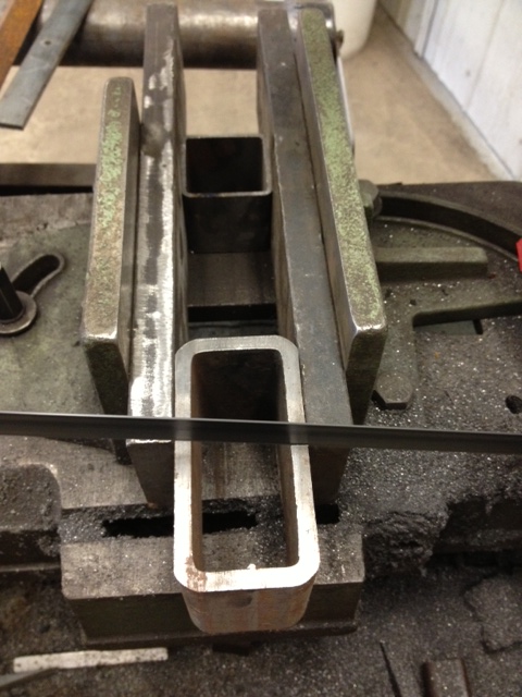

    bandsaw save,had to cut a piece of rectangle -the other way.

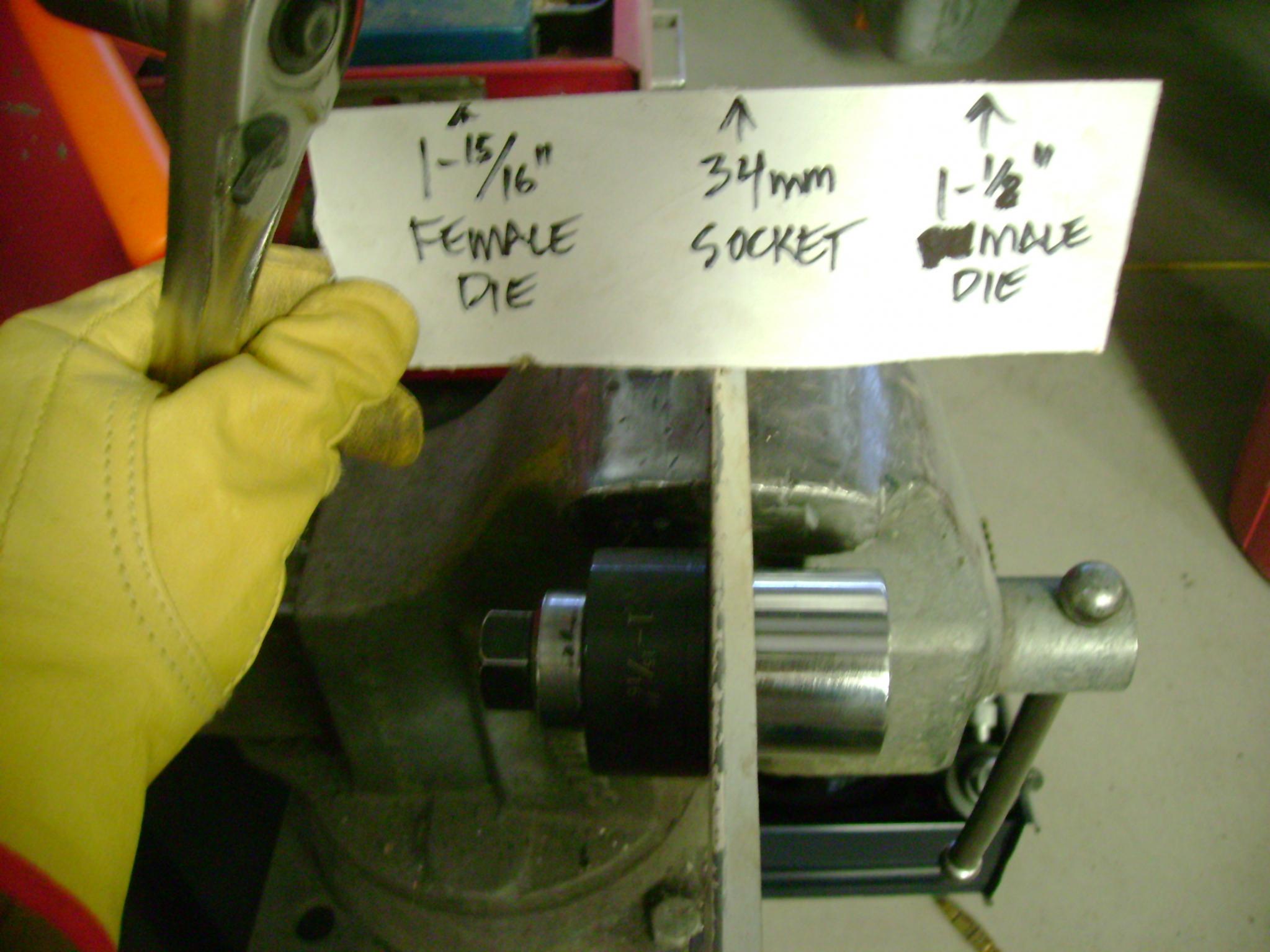

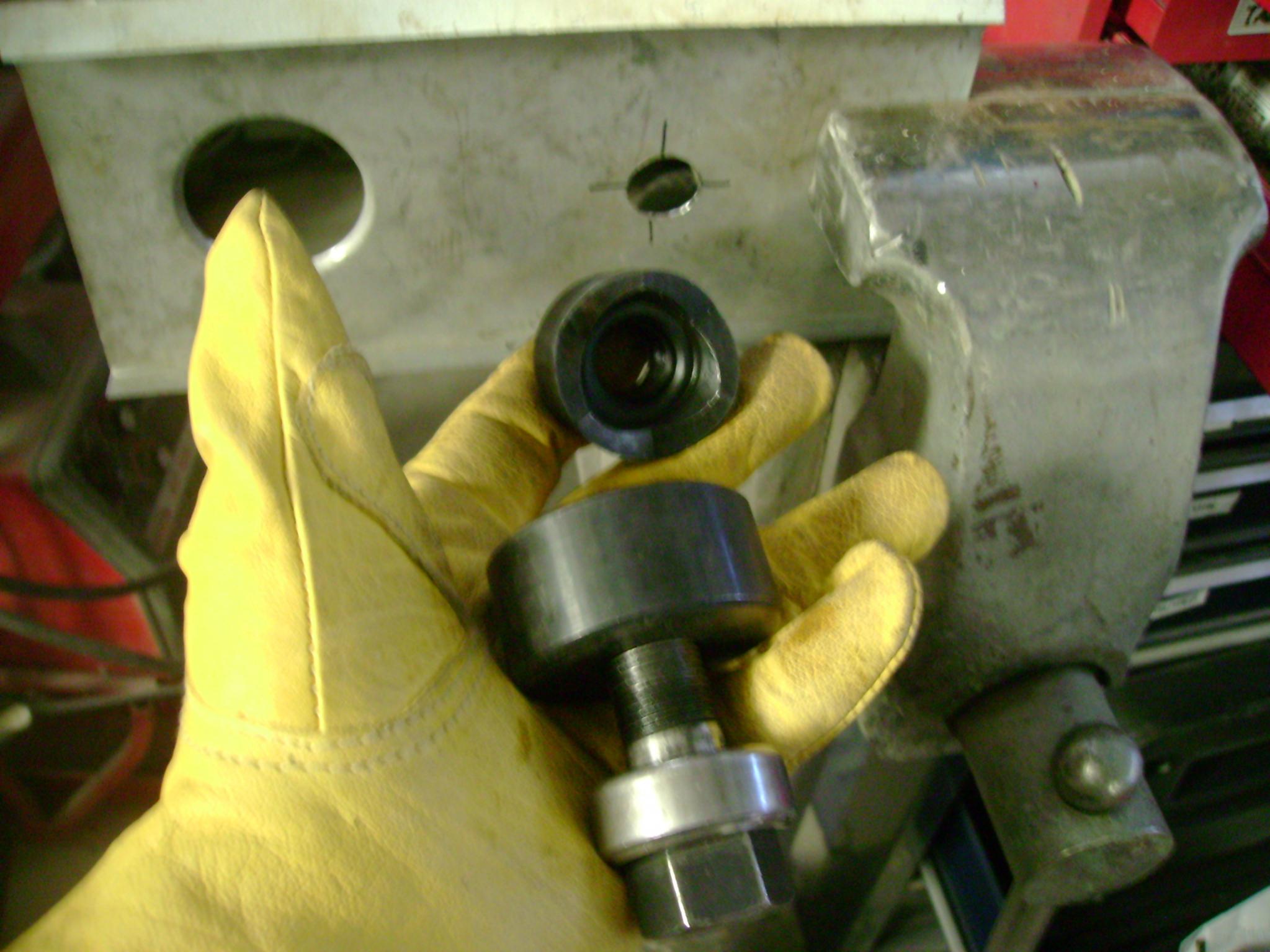

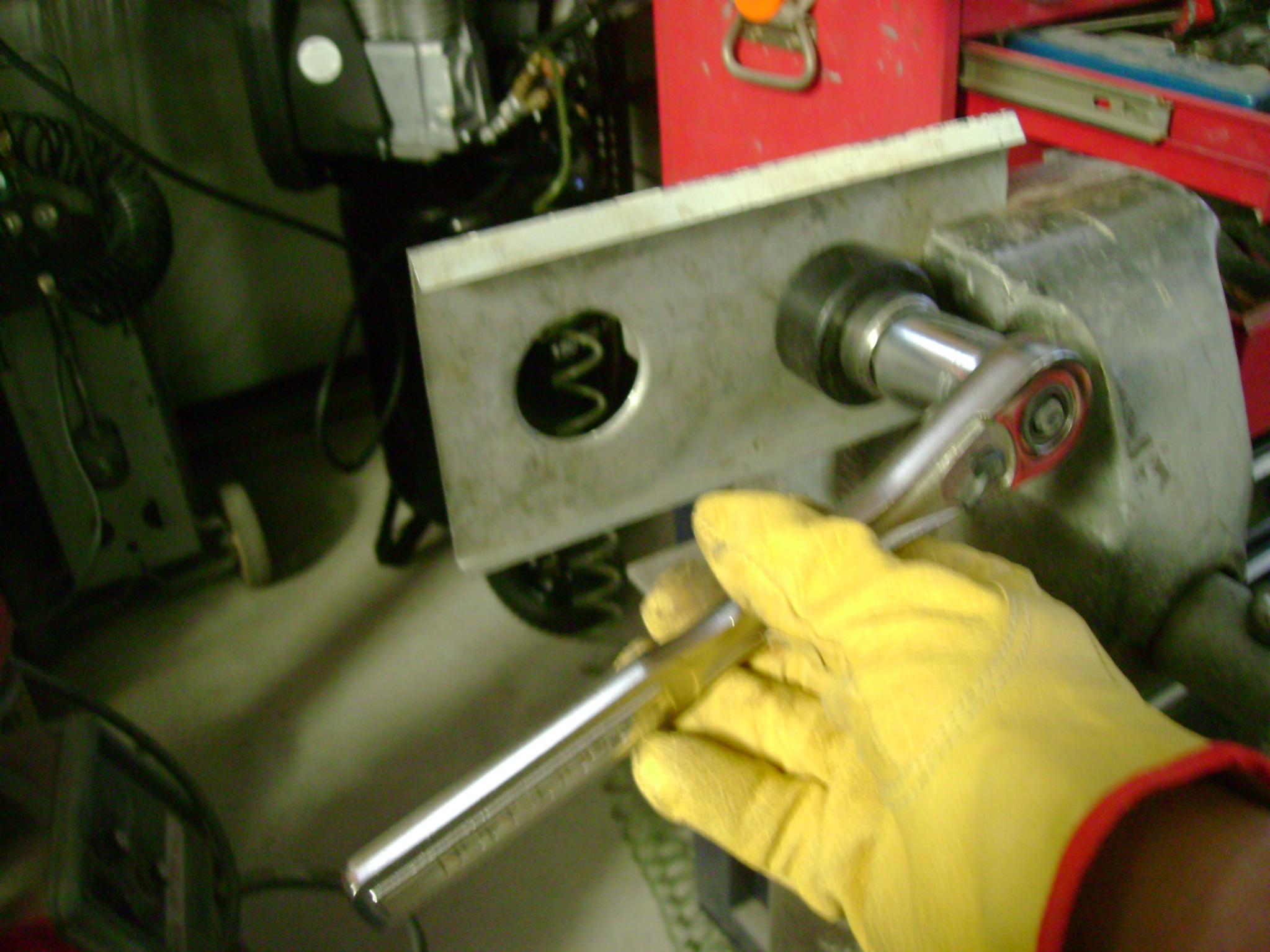

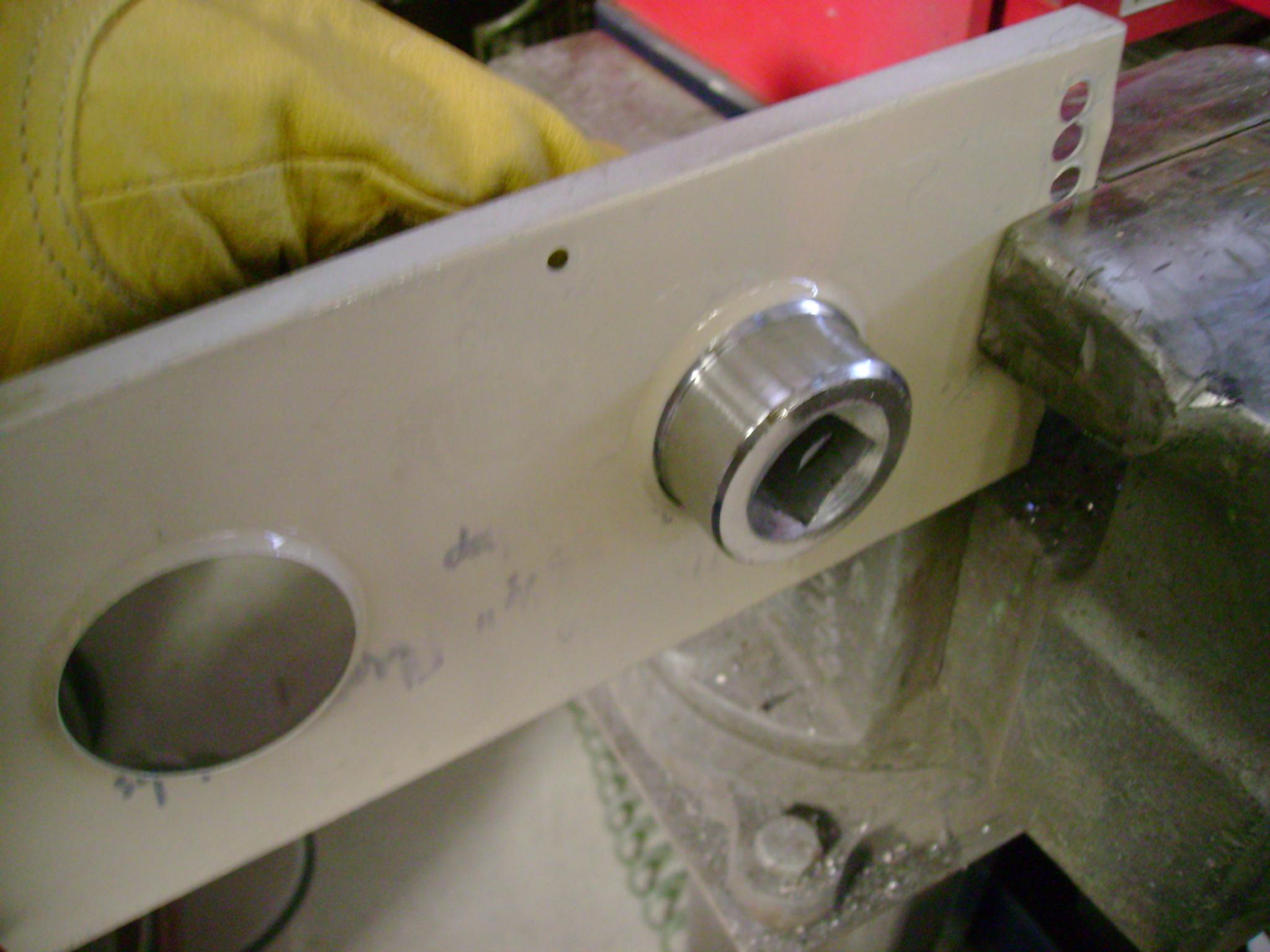

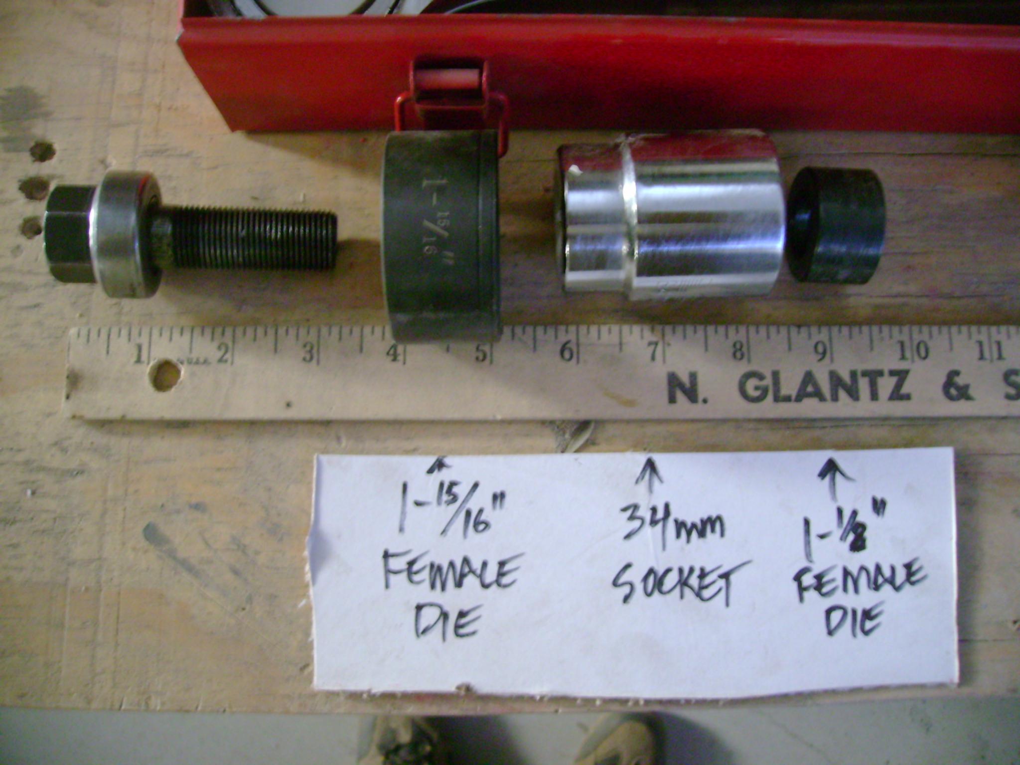

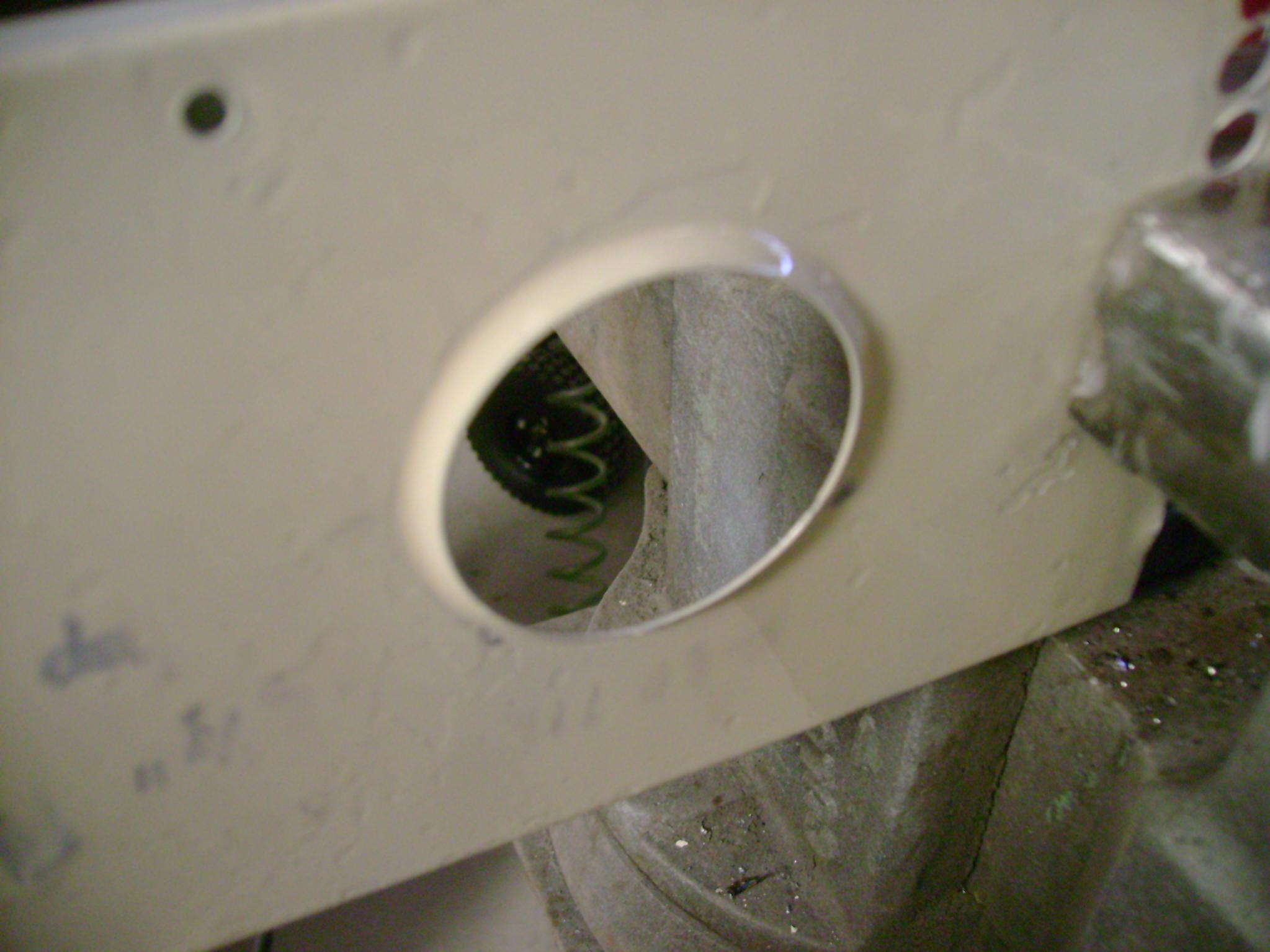

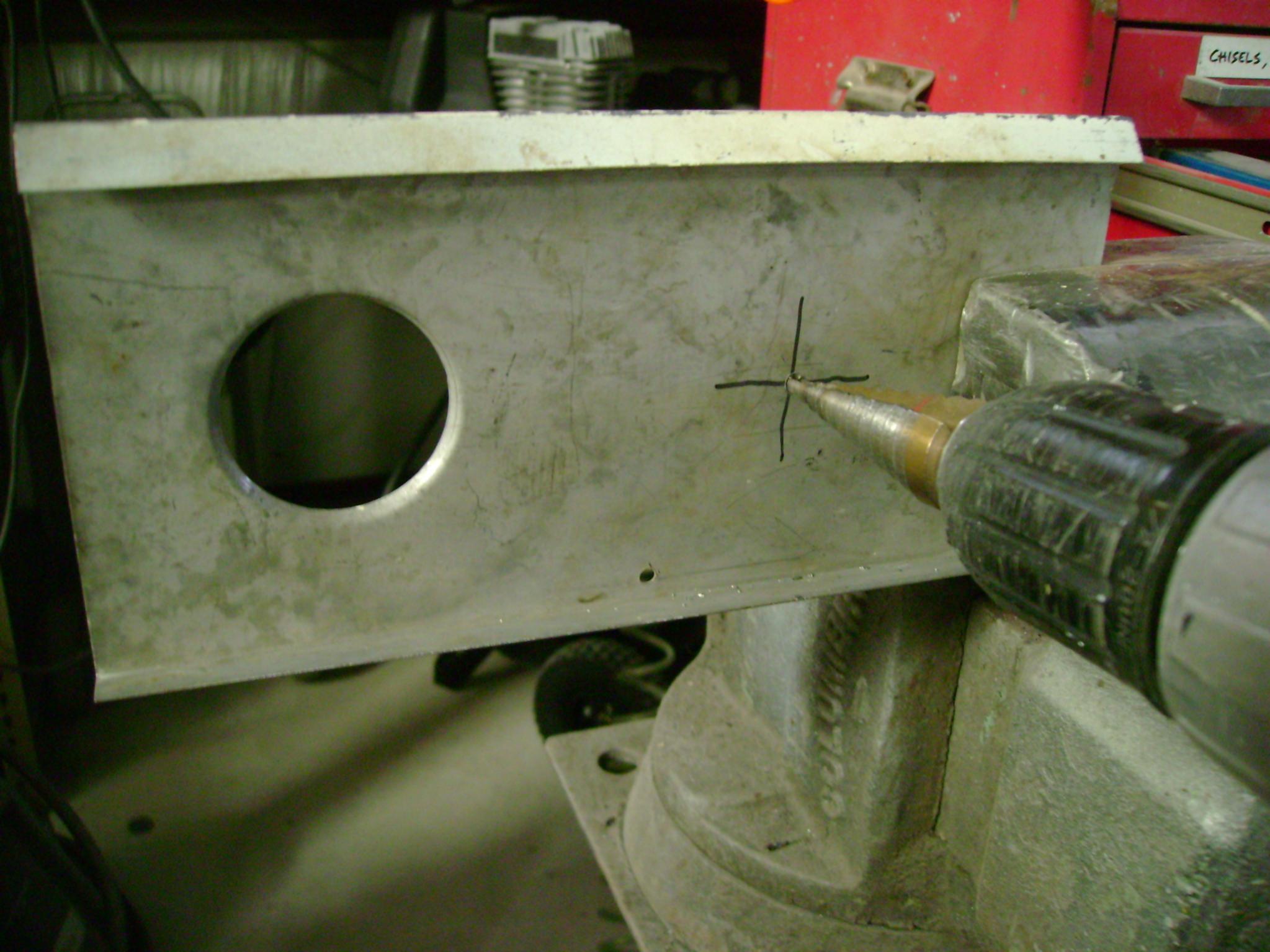

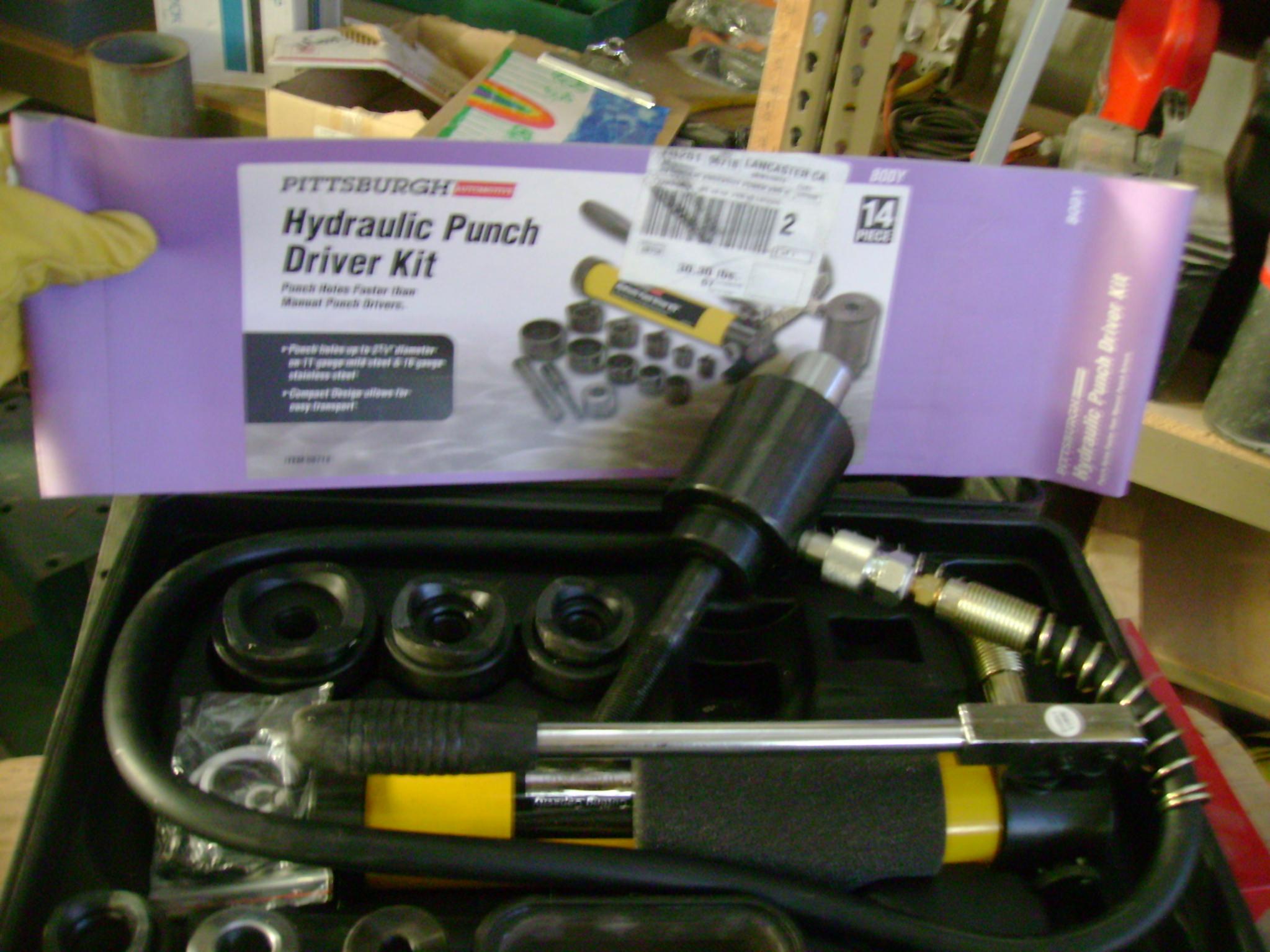

    If you want some inexpensive dimple dies, you might already have the tools you need. I realized I did. Don't ask me how this came to mind, but here is the idea.
    Look at the next few postings to see all of the pictures.

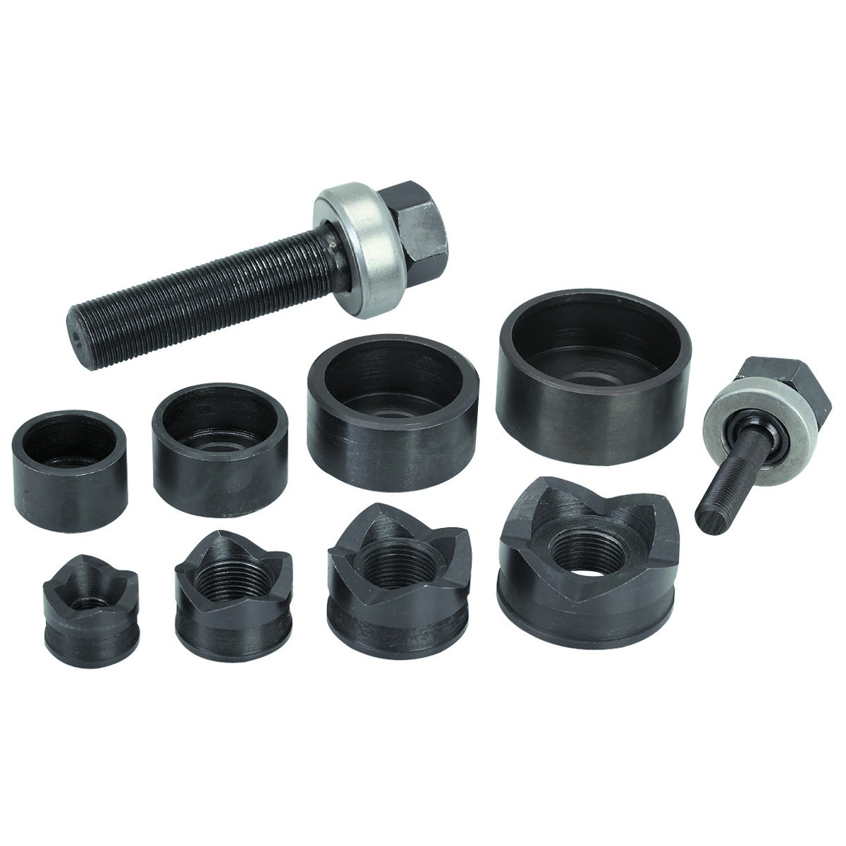

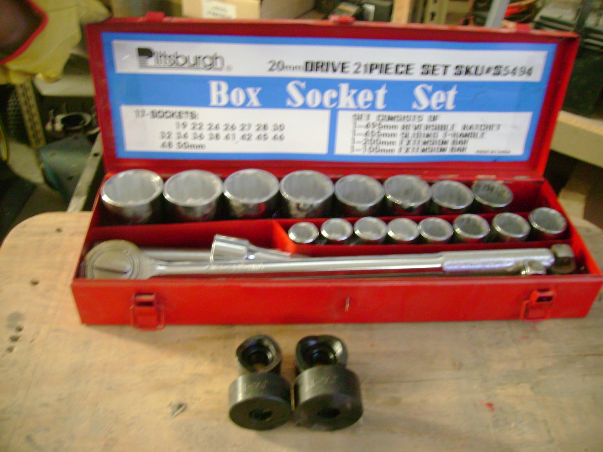

    I used a large 3/4-inch-drive socket from a set I got from Harbor Freight as the male die. Here's the HF 3/4" socket set. $60 on sale, but $48 with the 20% off coupon found in the newspaper and car magazines. See the picture of the Harbor Freight knockout punches. $25 on sale, but less with a coupon.
    I used the female die from a set of metal knockout hole punches used by electricians. I had both the hydraulic set ($80 on sale from Harbor Freight) as well at the manual set, pictured in a post, below. The hydraulic set is quick and easy if you want to do a lot of them, but a manual punch is fine for just a few.
    The great thing about this method is that you don't have to do it in a large shop press. Some pieces are too large. I used light-gauge sheet metal, but I imagine that the dimple could be made in at least 18-gauge.
    Here is the method I used to do easy dimples in sheet metal. The hole to the left in the picture is the first test hole that I made just to make sure it worked.

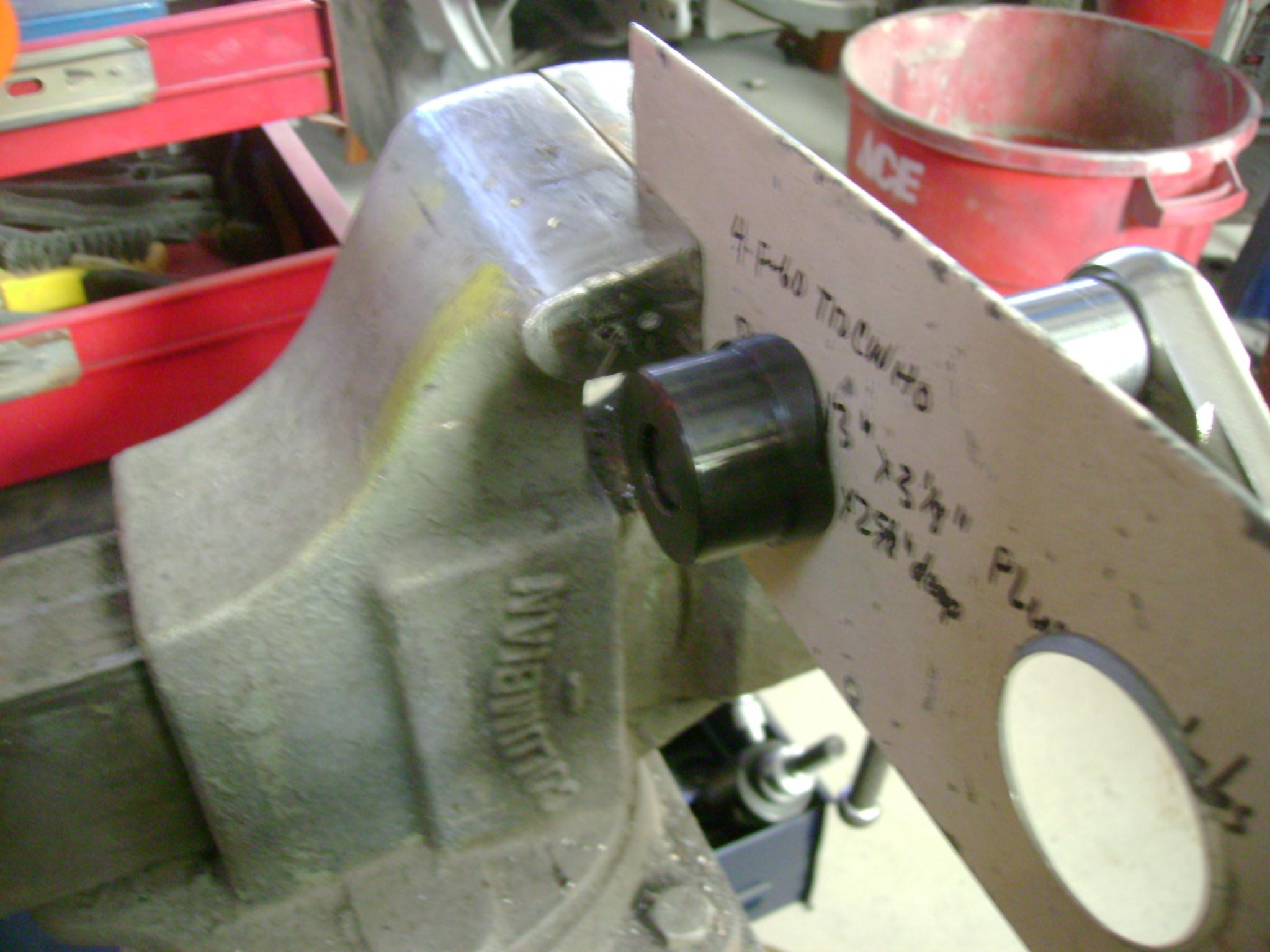

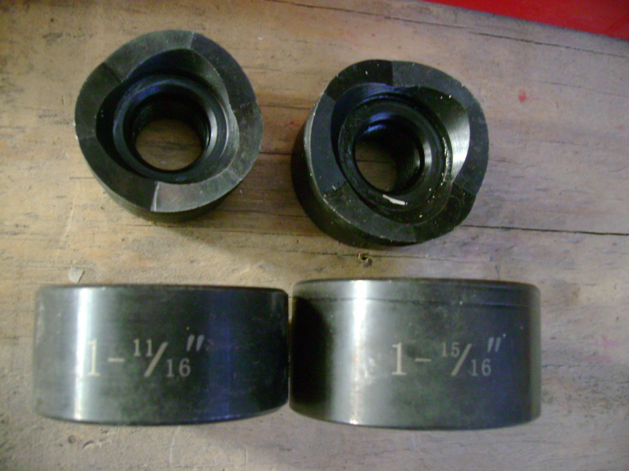

    See the picture for the size of the punches I used. The small die is for cutting the hole, and the larger die is for the dimple. I used a step drill for the bolt or shank that holds the male and female dies together. To punch a hole, if you are not familiar with these punches, go by the directions in the set you have.

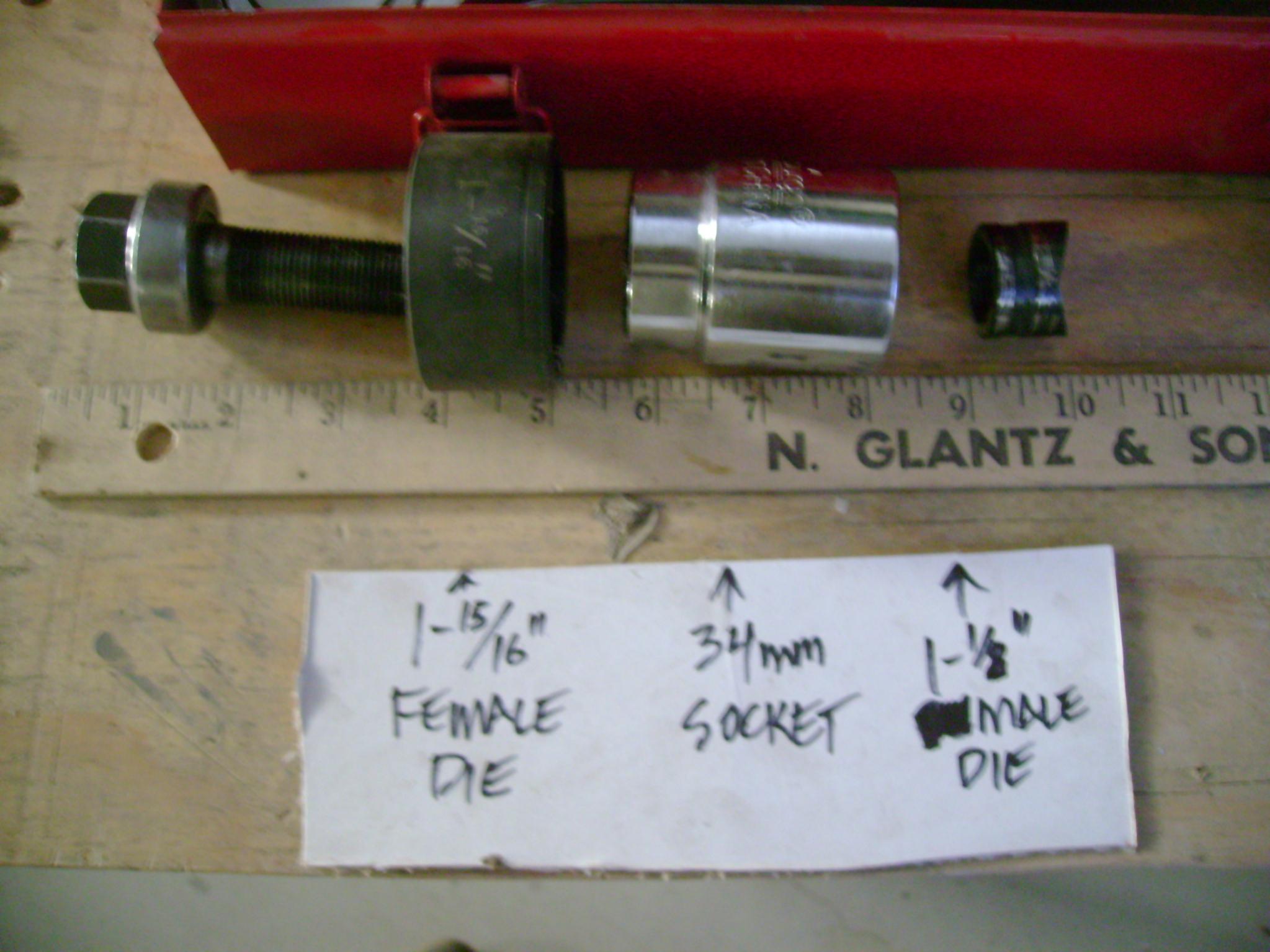

    I inserted the bolt through the hole in the sheet metal and ***embled the two dies, one on each side. Then I cranked down the bolt until the hole was punched.

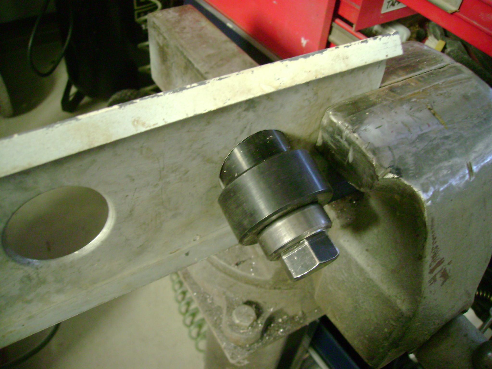

    You can see the manner in which I ***embled the punch die set to make the dimple. I used a large socket as the male die.

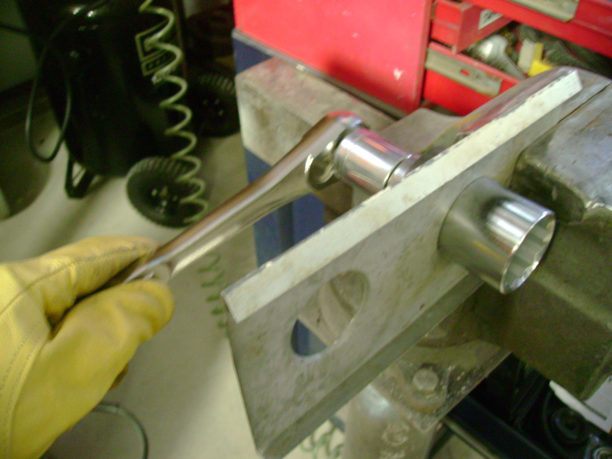

    For the dimple, I used the a slightly larger female punch die than the die that I used to cut the hole. I used a socket with an angled shoulder that just fit inside the larger female die, but too large to fit through the hole in the sheet metal.
    To hold the ***embly together on the punch die bolt/shank, I used a small male die as a retaining nut that fit into the large socket since it is threaded and fit the threads in the punch shank. In the picture, you can't see the small male die because it is inside of the socket, threaded on the bolt/shank.
    The last picture shows how the socket's angled shoulder fit the dimple.
    For other sized holes, there are several more combinations of dies and sockets that will work. All you have to do is experiment.
    Hope this helps someone. Thanks to all who post their ideas for all of the great inspiration that you have given me.

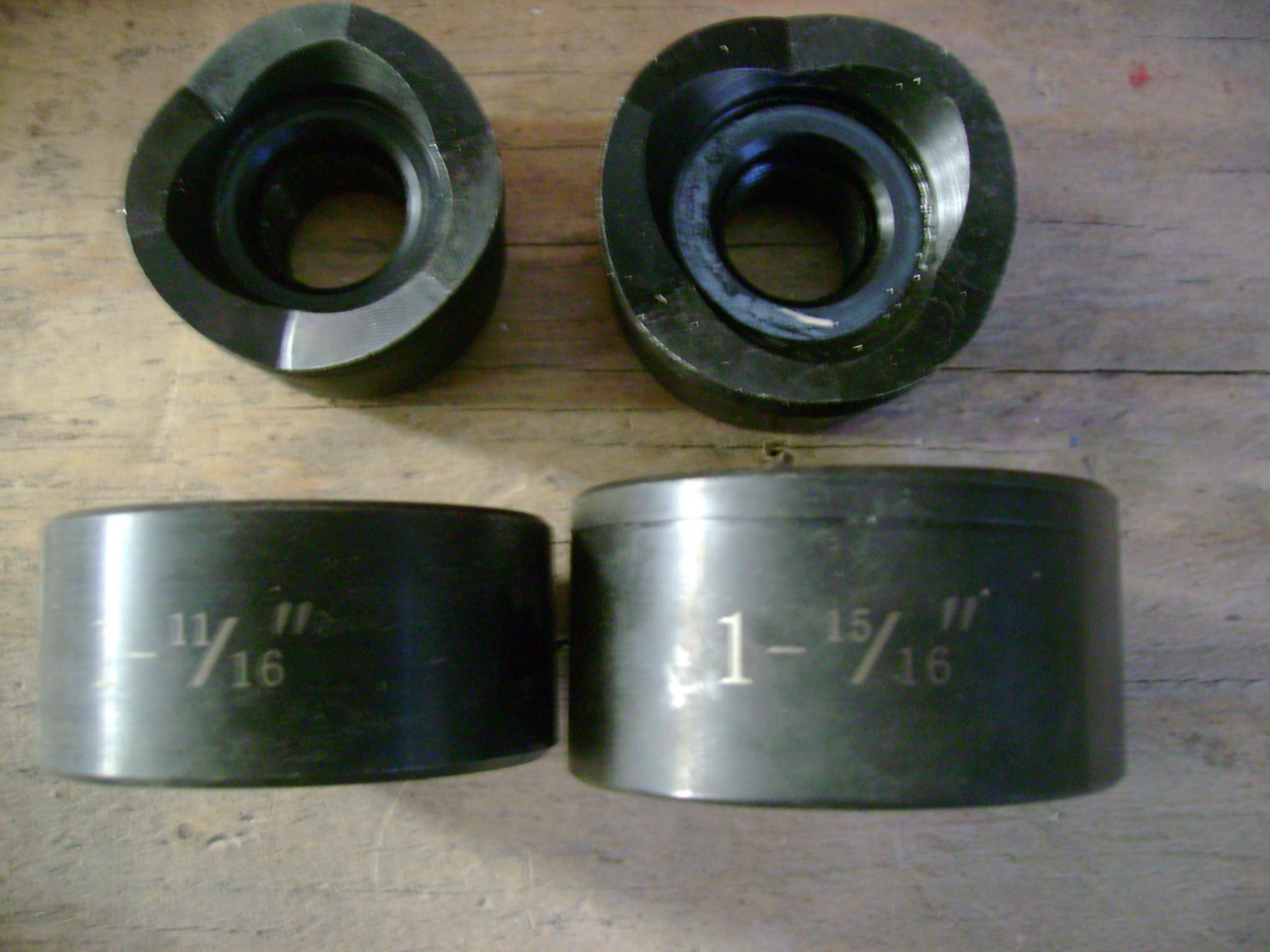

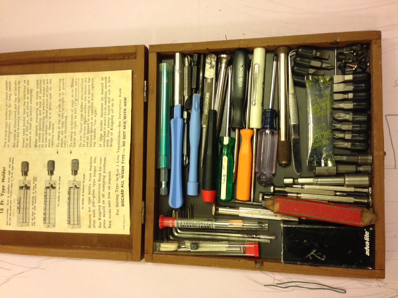

    I have this little wooden box that I use to keep small allen wrenches, screwdrivers, etc. handy. No matter how neatly I put things away, as soon as I would move the box everything would jumble.
    Then I had a brainstorm. I grabbed a couple of those calendar magnets that seem to multiply on the shop refrigerator. Put them in the box upside down, and they provided just enough magnetism to hold things in place.
    I also keep some really small screws in that box (eyegl*** screws, like that) and now they stay in place where I can easily get them.

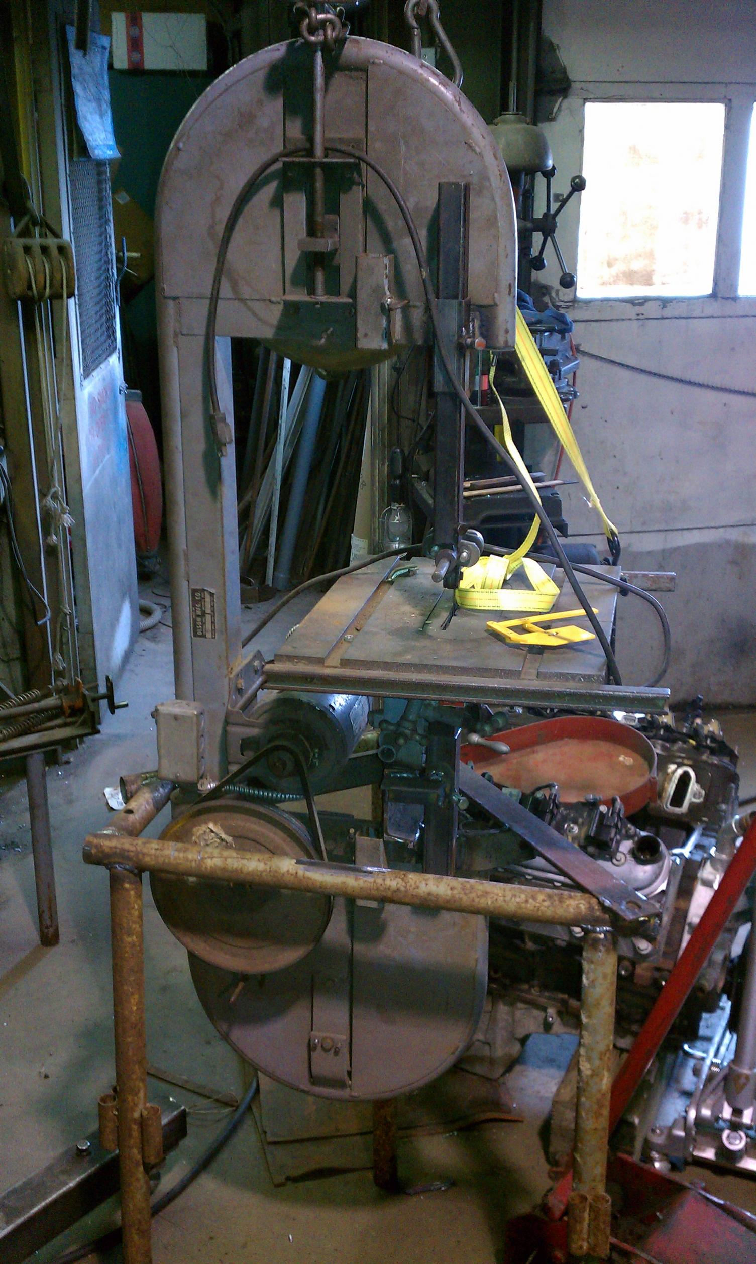

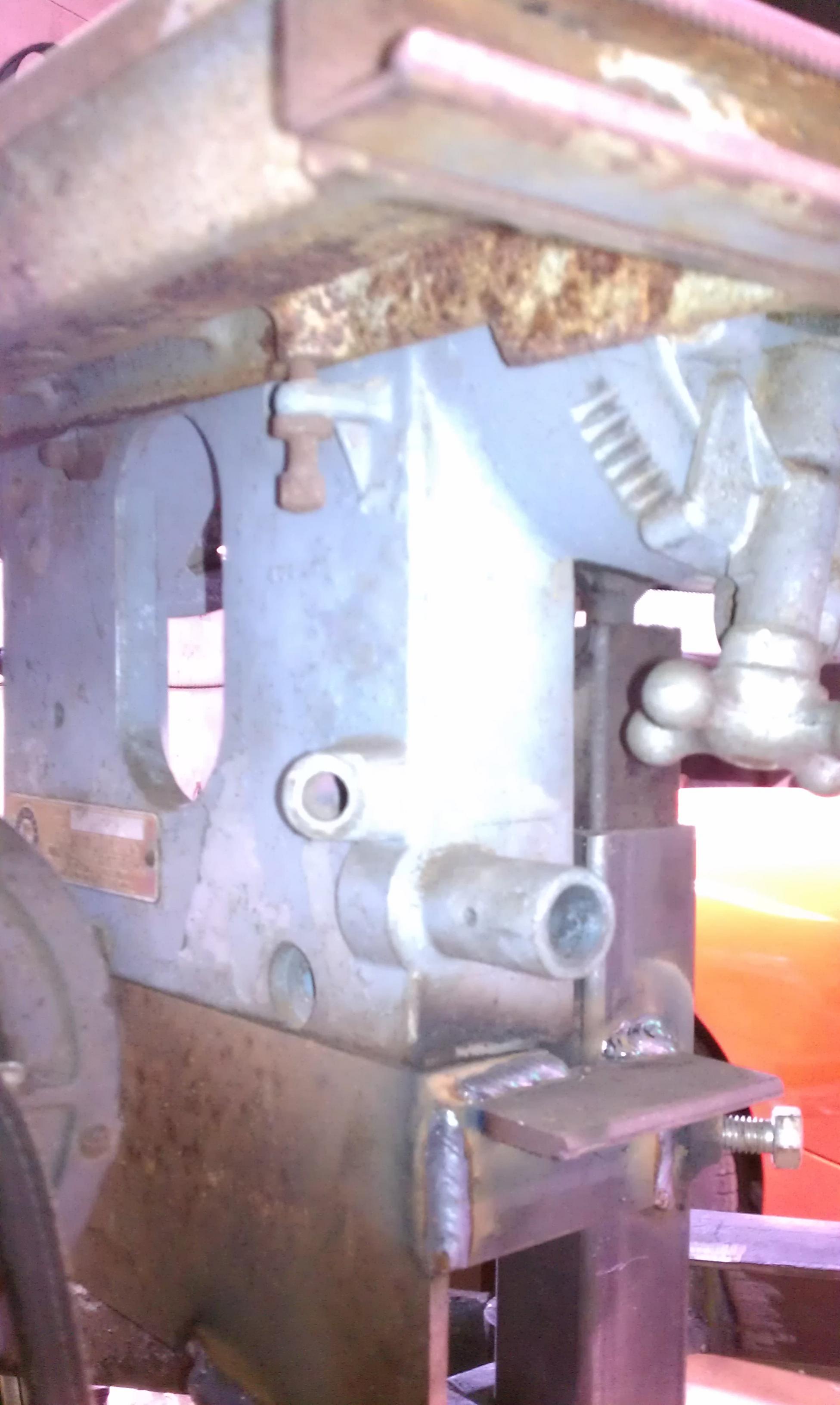

    I have been working on coverting my horizontal band saw to virtical saw. I used an old table saw table and was able to salvage the tilt option. Have working on the blade speed now I think it needs to be faster.
  26. If you are converting a wood saw to cut metal, it needs to be slower.
