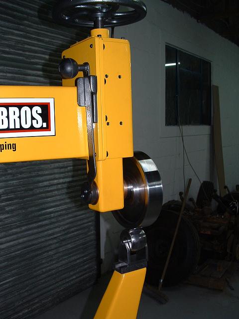

    Here's my "portable" E-wheel that I take to shows for metalshaping demos. Made it look fancier than it needs to be, but it works great. I don't like those wimpy frames much.....
    Adjuster is Kerry Pinkerton type - search on Metalmeet.com. Quick release is just an offset shaft in bronze bushings.
    Now I just need to build something I can post on here with it...no wait I've got a bunch more tools to build still:D:eek:......

    Nice wheel Barry!! I like your lift. I had to have one of those disc sanders. I had a brake shoe grinder laying around so I stripped it down and mounted it on a stand. It had a 3200RPM motor on it. I'm using 3M 40 grit stickit sandpaper on it. It rocks!! Thanks for posting all the disc sanders. It was a kick in the *** I needed to git it done:D
