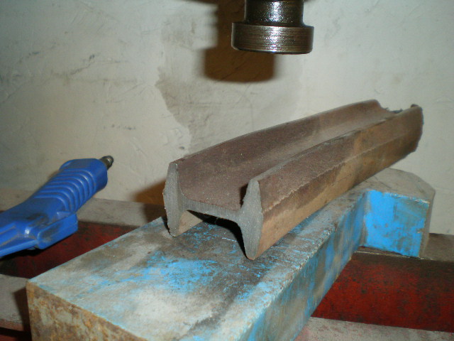

    RICH B
    This is pretty "caveman"; but it worked for me.
    I wanted to put three bends in a piece of 1/4"X4" flat bar. I had picked up an old press last summer; but hadn't got around to making any tooling. Wasn't finding anything in the steel rack to fabricate a lower die; but then I noticed a section of a '40 axle, used that with a short piece of DOM and made quick work if bending the 1/4"X4" bar.

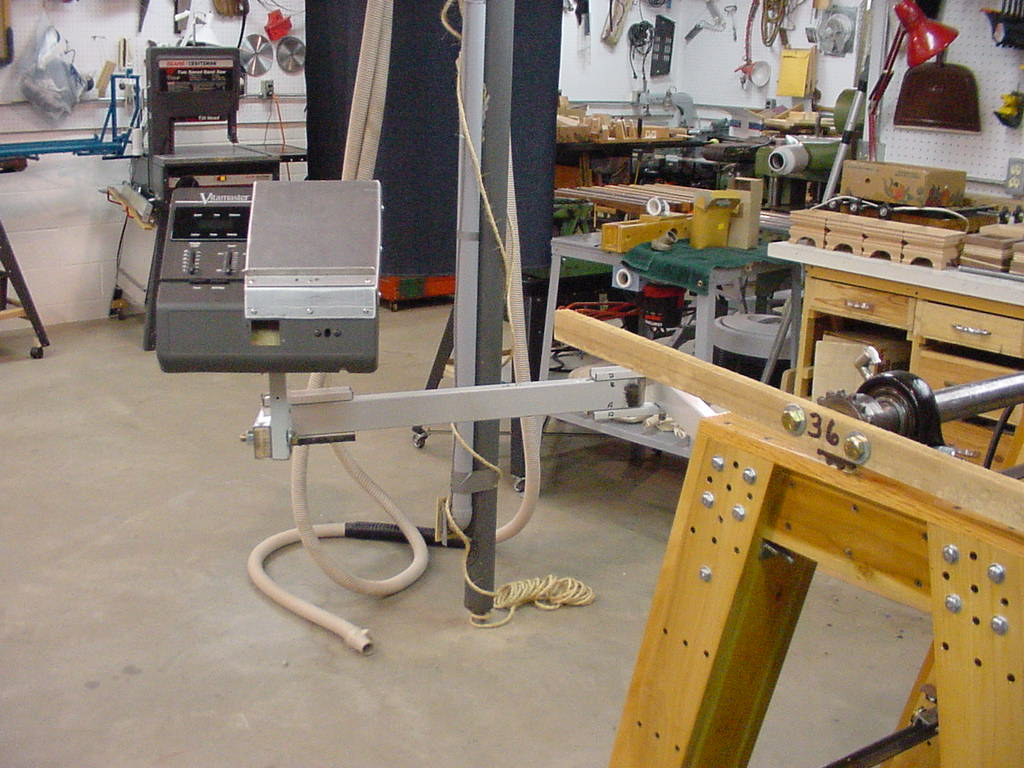

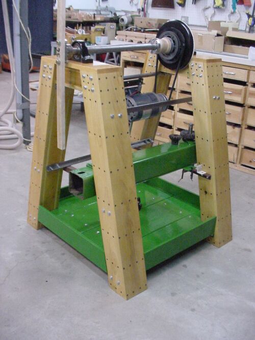

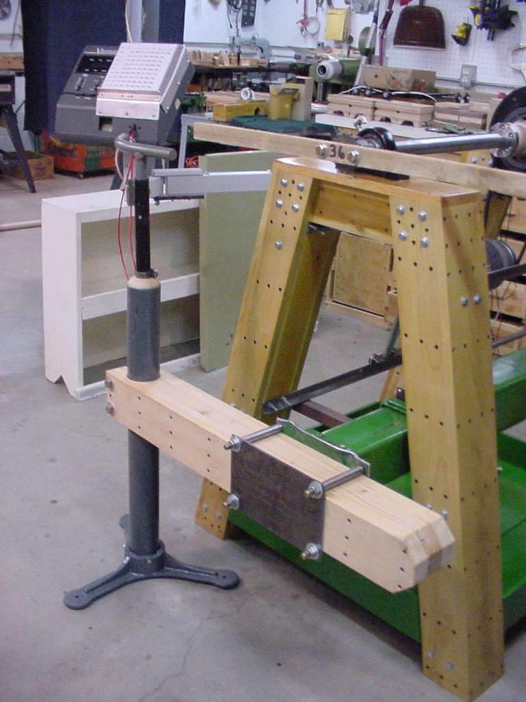

    Posts: 2,263
    gatz
    Here's a Wood Lathe that my brother built for his son to make up to 36" diameter "bowls" or other wood turning. It will swing up to 36" diameter. There's a modified chain sprocket on the front end of the spindle to mount various work-holding plates.
    He used the motor and controls from a treadmill. In the one picture, you can see a Delrin disc with magnets epoxied in place for feedback to the controller. Some experimenting was done to find the right number of magnets. The motor/spindle ramps up and down smoothly. Pulleys are for ranges of speeds.
    The wooden "spool" on the shaft is for a leather-strap brake.
    The square tubing ***embly on the lower shelf provides in/out adjustment for the tool support or rest. It was made from a semi-trailer jack. There are set-bolts to tighten it up. Very stable........and heavy !
    I've got some time on it too....doing the lathe work for the spindle and mill work for the tool rest support & some welding.
    The bowl being turned in the last pic was a glued-up ***embly. The funnel-shaped thing in front is for vacuum - not a light.
    Gatz
