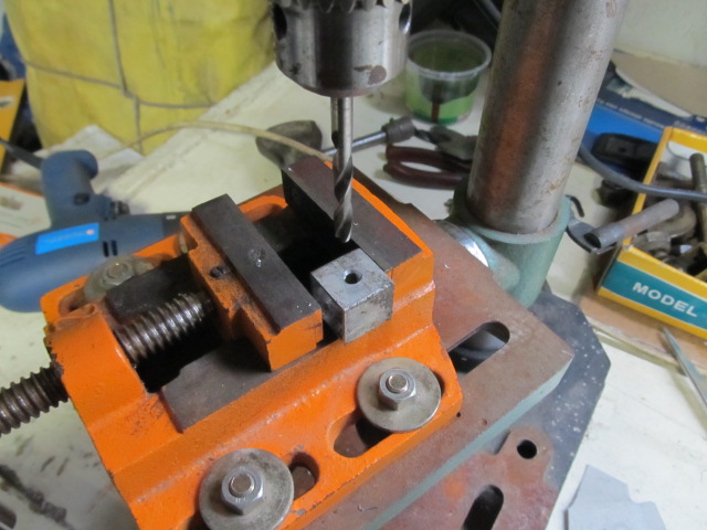

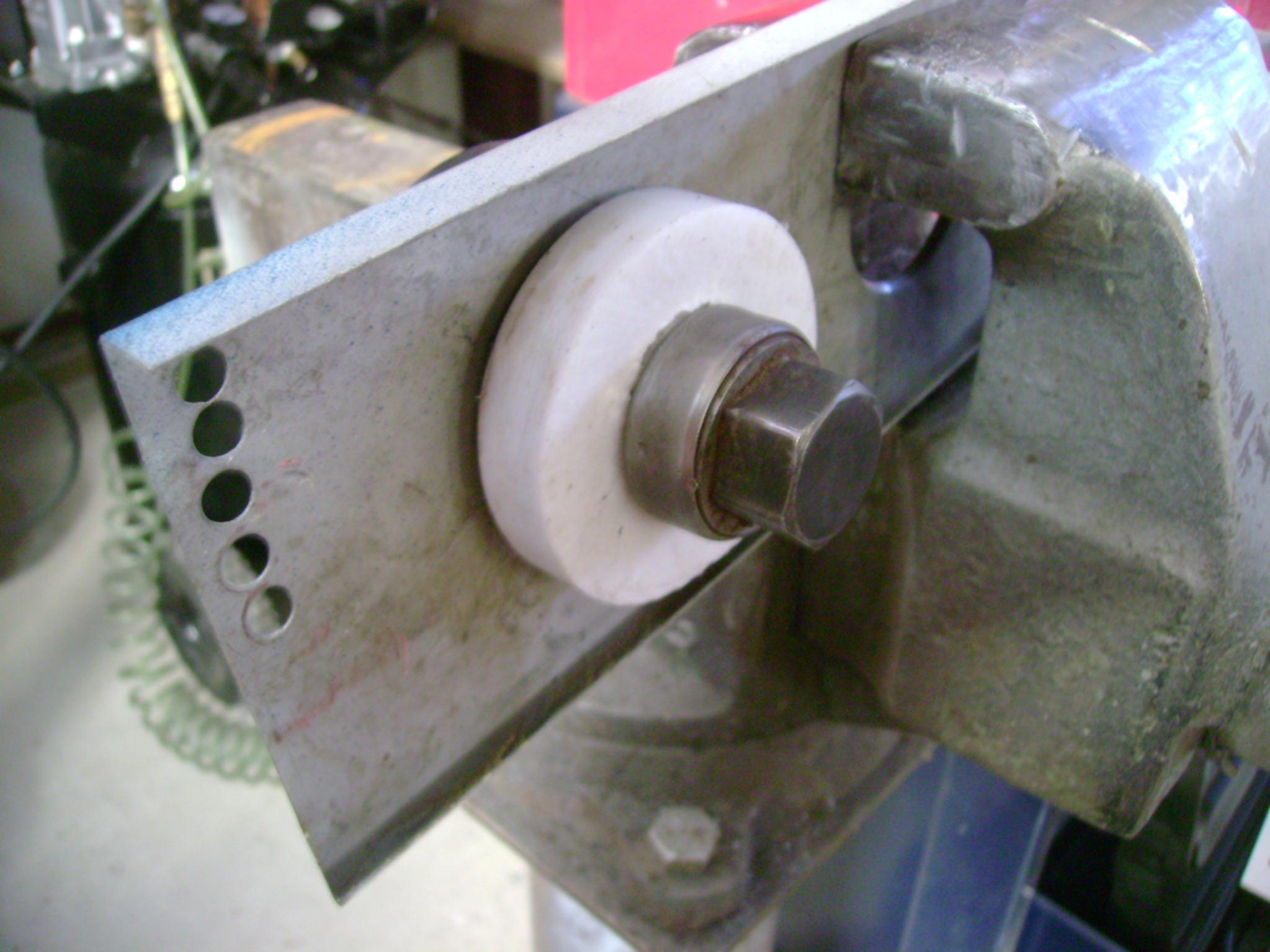

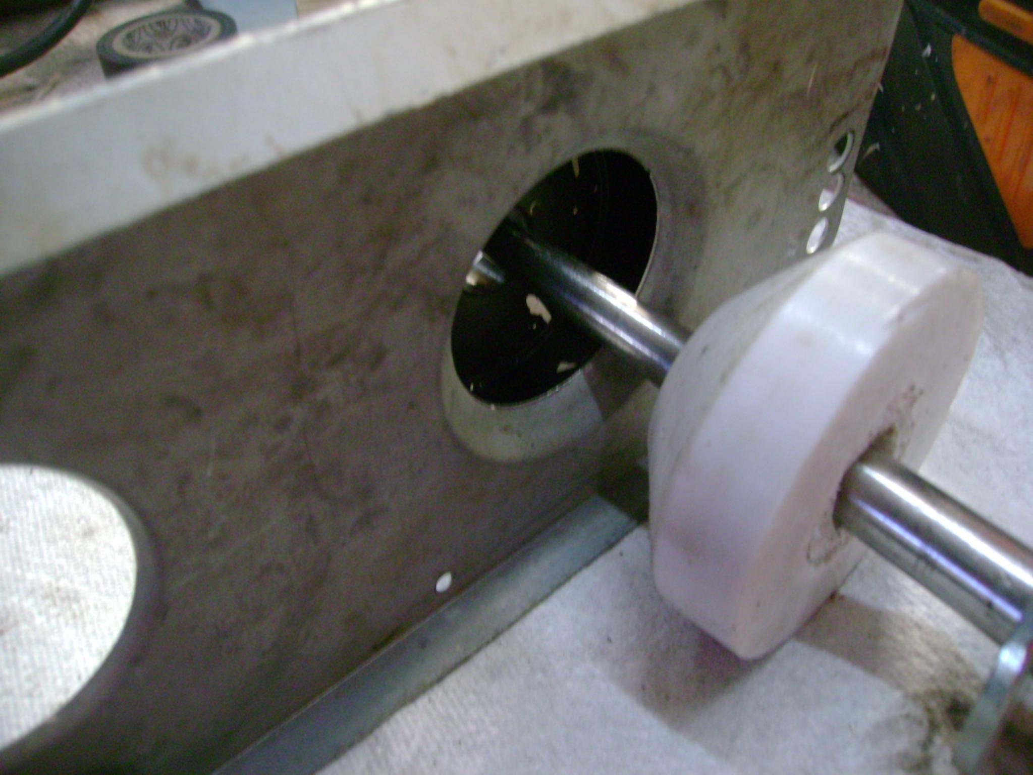

    Here's an update on the homemade dimple dies from page 89. I tried another method, still using the sheet metal punches used by electricians.
    I had a piece of some unknown solid plastic rod--about 2-1/2 inches diameter--scavenged from my Uncle Jim's 80-plus-year collection started by his father and my grandfather, Galen Wyatt, born in 1892.

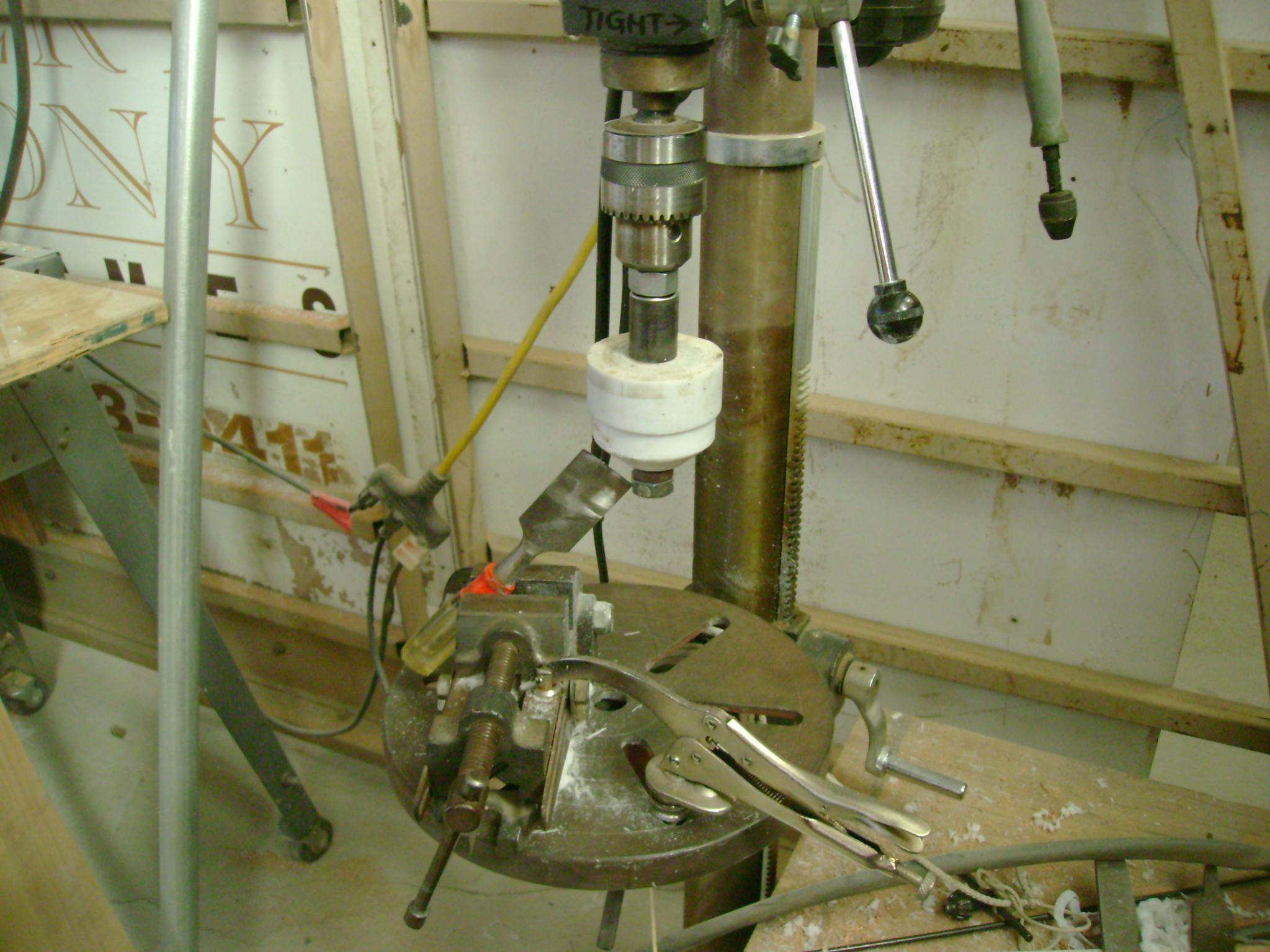

    First, I drilled a hole in the center to put in a bolt to use for the center shaft.
    I used my drill press as a lathe and jury-rigged a vise with a chisel for the cutter to cut a 45-degree angle in it. I had to feed it slowly due to the reach of the chisel. Finished the cut with a file.
    I used the bolt from the sheet-metal punch, a large female punch die, and the plastic male die that I made.
    I worked! This dimple was deeper than before. I suspect that hardwood might also work for making a die. See the next thread entry for the rest of the pictures.

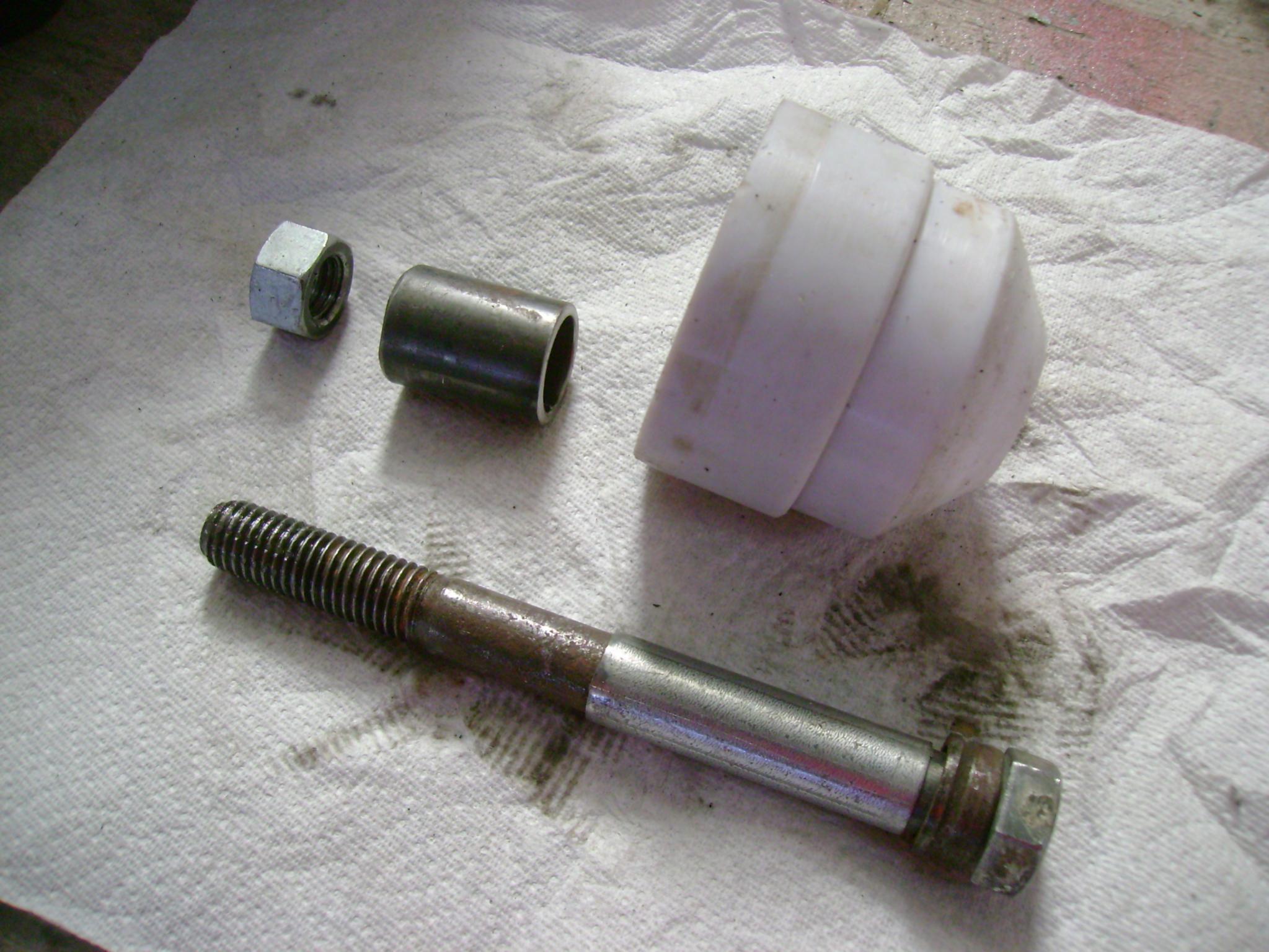

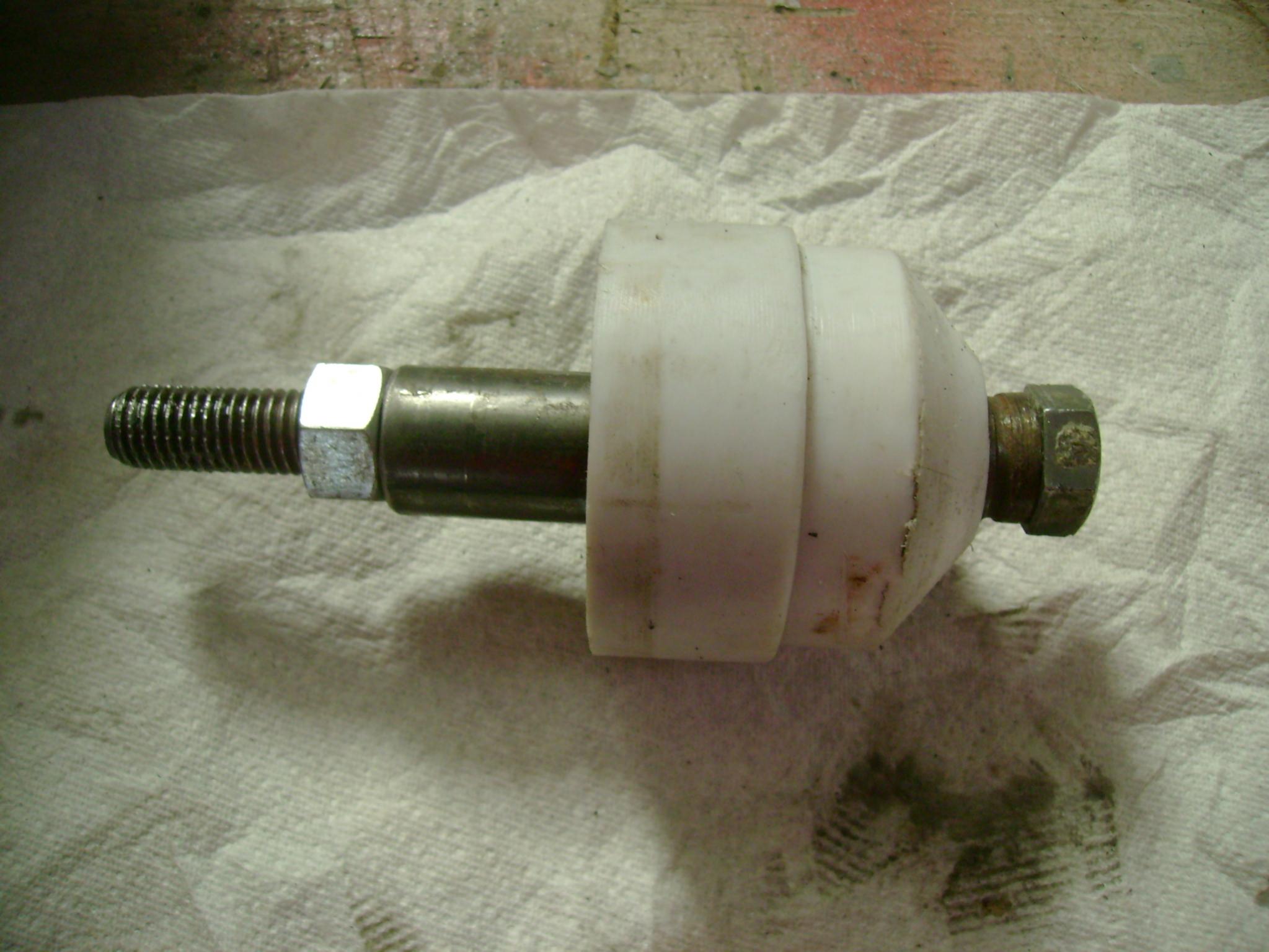

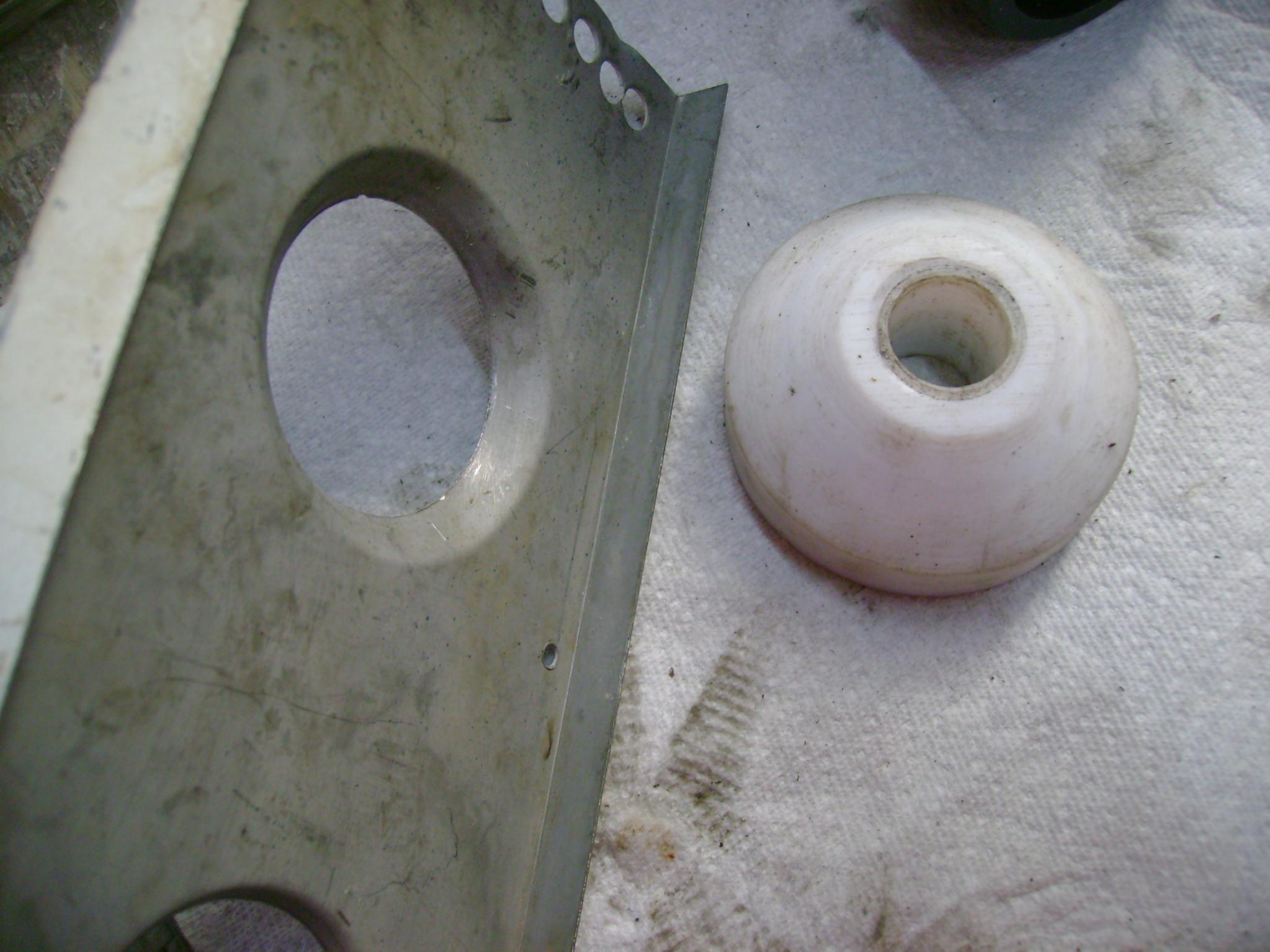

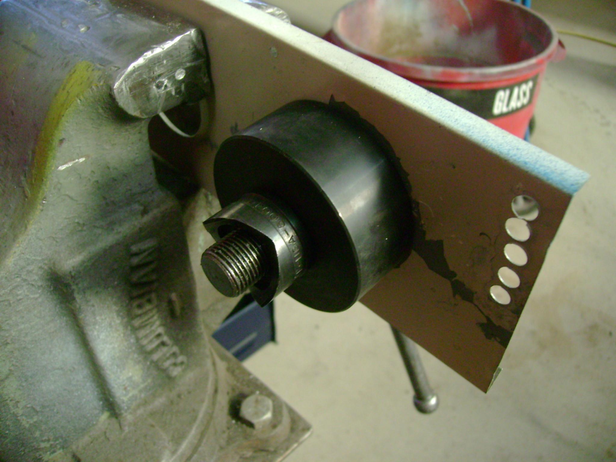

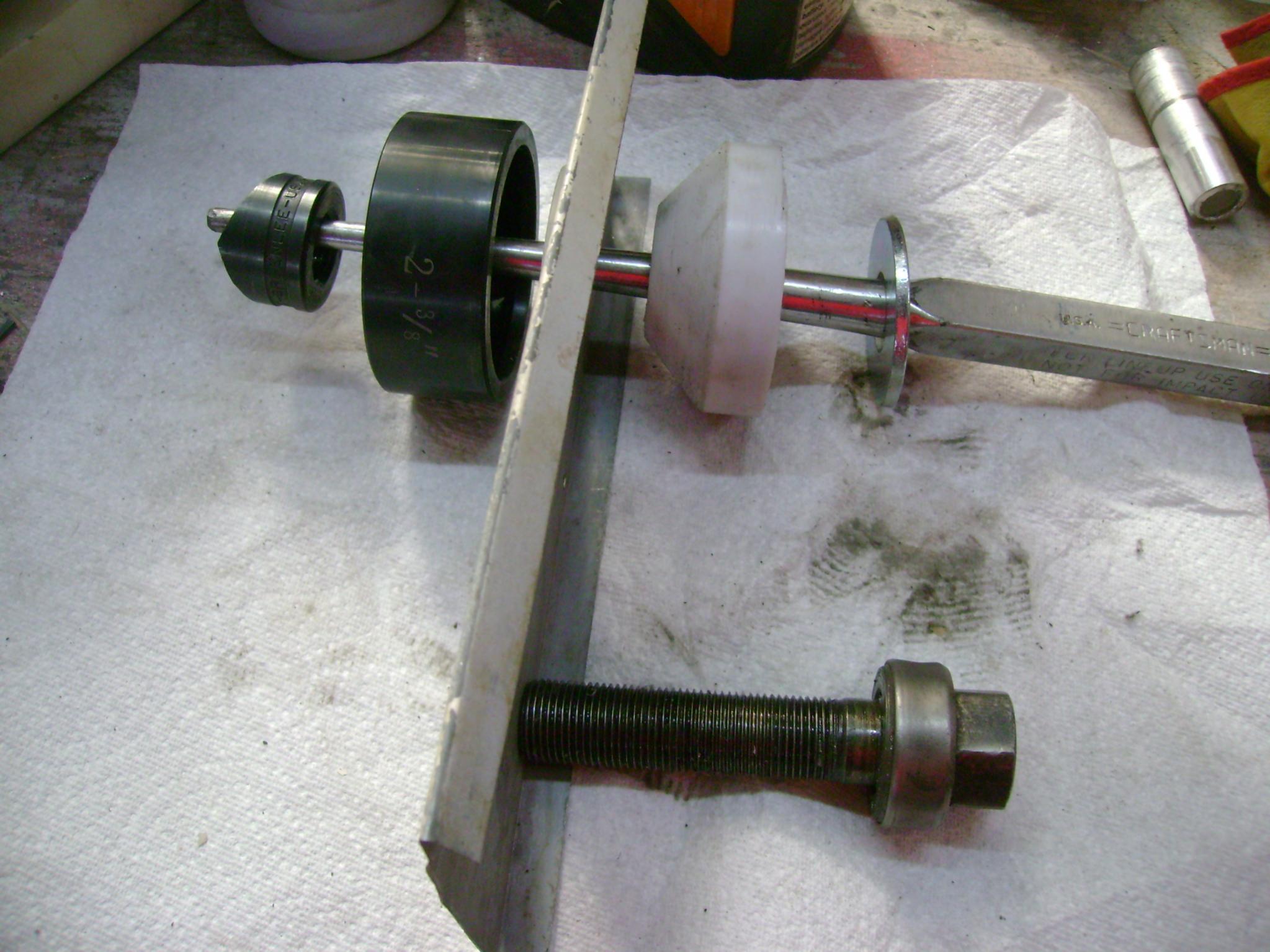

    The rest of the pictures...
    I used the long punch to hold the pieces together so you could see the ***embly.
    After I cut the 45 on the round plastic, I cut off half of the length.

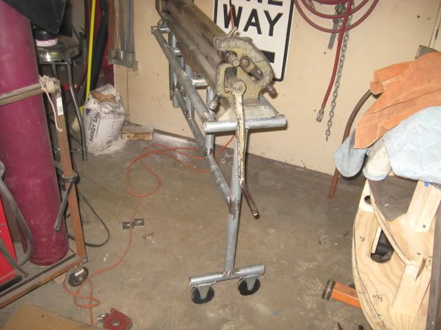

    I keep ac***ulating more stuff in the shop and Im running out of space . I had the old heavy **** slip roller sitting on some saw horses. It's one of those things that you use once in awhile and you don't move it to often. So I came up with a simple solution to get it out of the way and make it mobile.
    I fab up this neat little rolling stand thats attached to the wall. I used the kids old trampoline enclosure frame that I was going to s****. The wheels are slight arced to roll . Now I can schwing it out of the way.

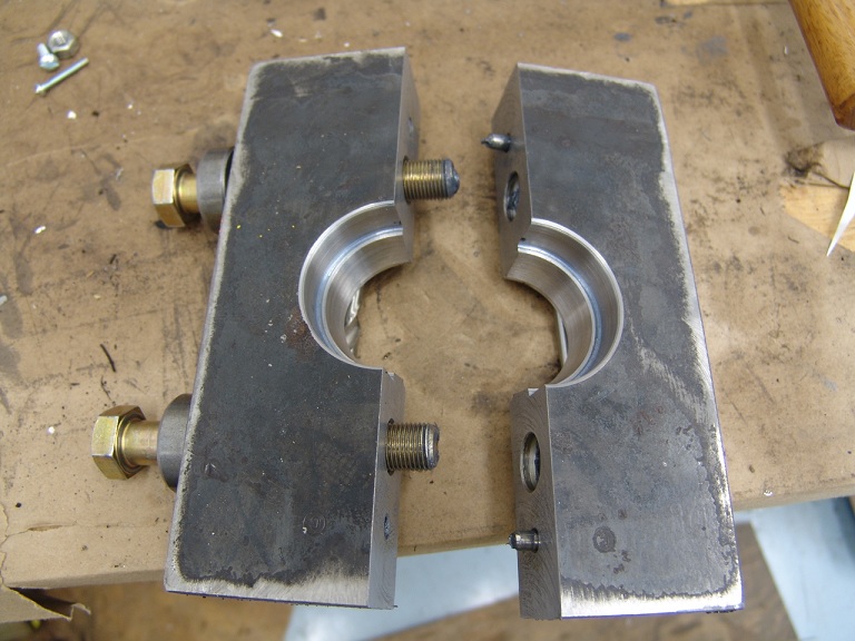

    Here is a tool I made...a press fixture to be used with a hydraulic press to allow you to remove 8-3/4 Mopar tapered axles bearings without damaging the retainers and without doing any grinding or cutting.
    It works very well and turns a PITA job into a 3 minute affair.

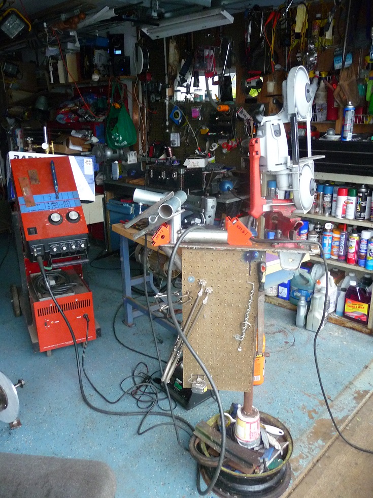

    Here's a simple metal brake for my 20 ton shop press
  10. NefariousKustoms
    Joined: Jan 27, 2013
    Posts: 17
    NefariousKustoms
    from Las Vegas
  11. NefariousKustoms
    Posts: 17
    NefariousKustoms
    from Las Vegas
    And here's my work station... Louver Press from Lowbuck Tool, Tubing Notcher from Baleigh, and Electric Bead Roller from ProTools
  12. NefariousKustoms
    Posts: 17
    NefariousKustoms
    from Las Vegas
    This is my tubing bender and die stand for the JD2 with a Harbor Freight Ram. I built the ram mount similar to SWAG Offroad's mount. I also added one extra 3" clamp around the ram body that is not pictured.
