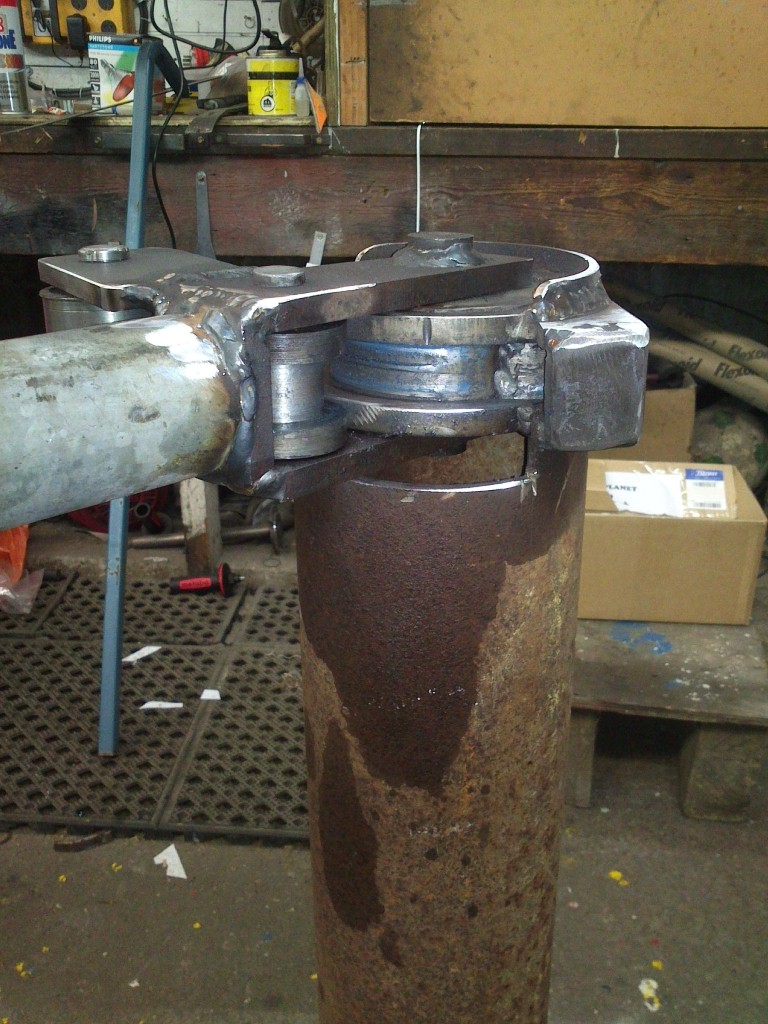

    talking about benders, I've just finished building this one to bend 1"x1" RHS tube up to 2.5 mm wall
