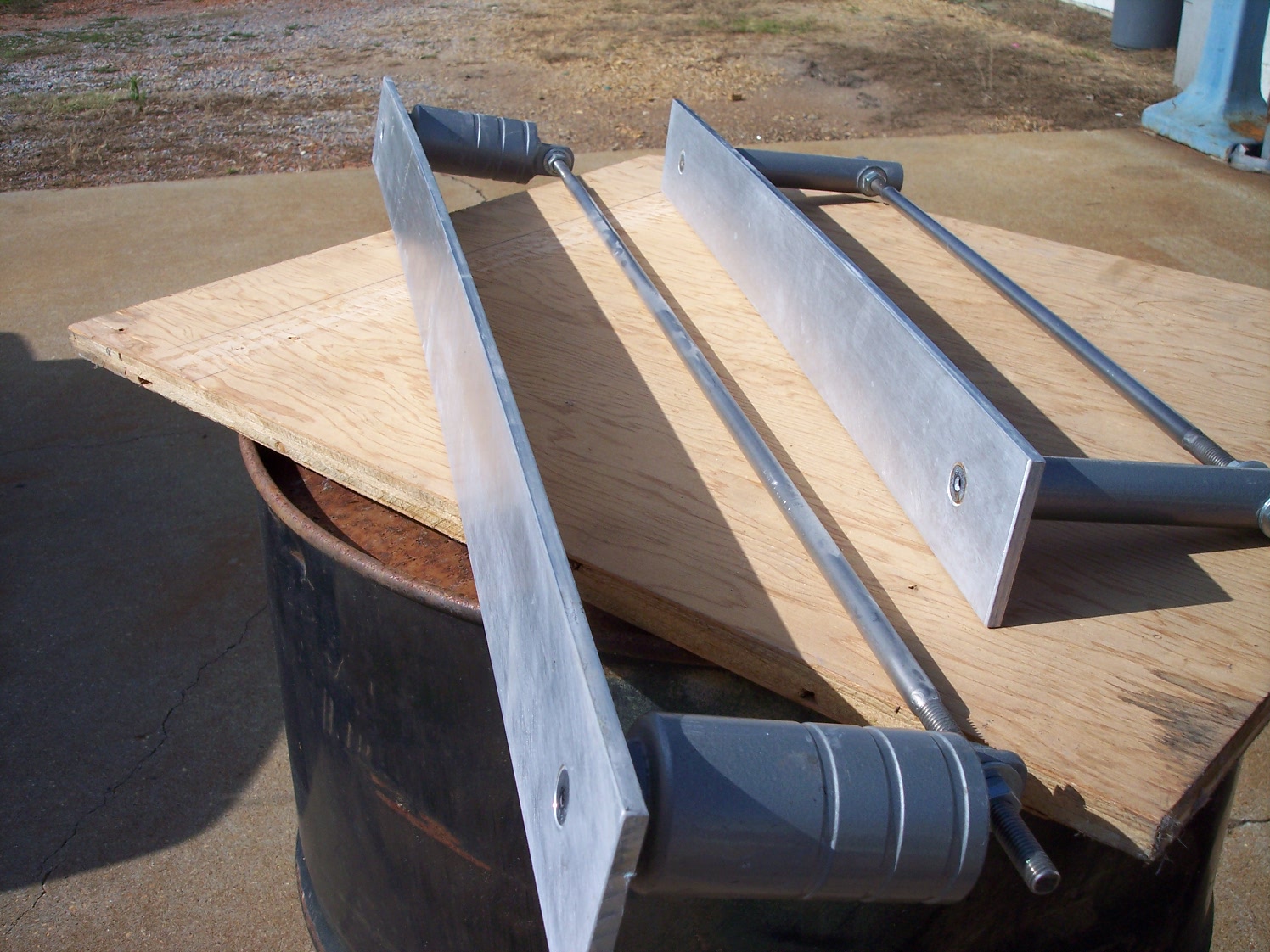

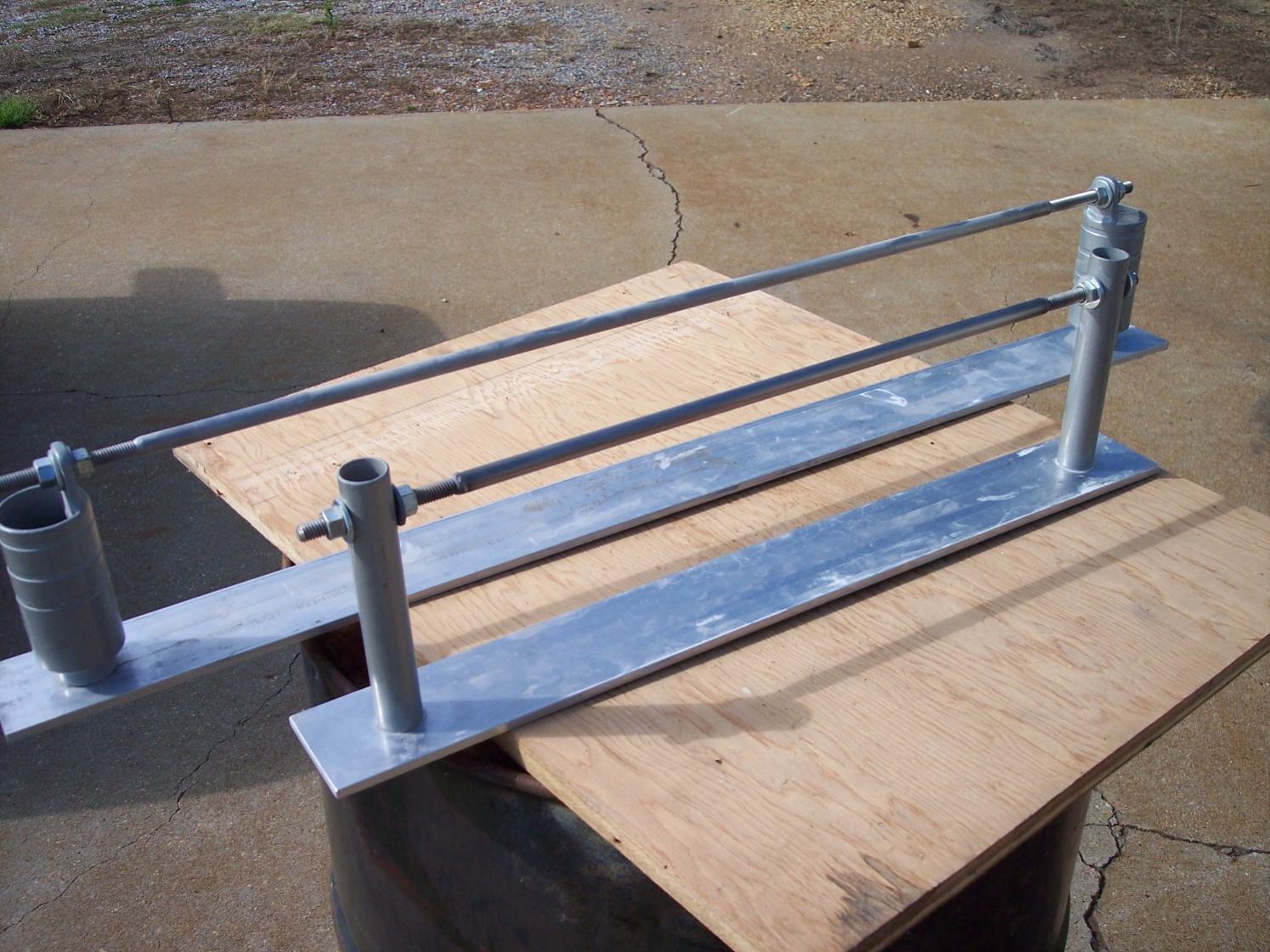

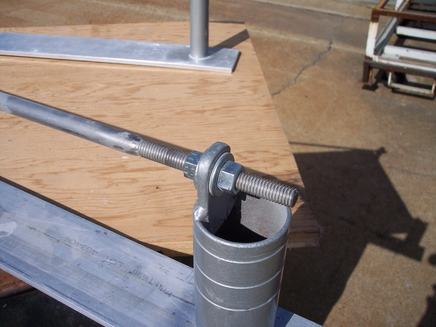

    Nothing earth shattering here, but I made these adjustable sand boards for block sanding larger low to med crown panels. One is 24" long and the other is 36" long. I used 1/4" x 3" aluminum flat stock milled down to 2 3/4" wide, to take the sticky back paper. Someone prob makes something similar, but I like home made. :)

    Did you add some kind of padding between the aluminum and sanding paper?
    I would think that the edges would tend to dig in paint and filler.

    No, I didn't add a pad, although they would probably be better with one. I just put a couple layers of green masking tape on prior to sticking on the paper. I haven't had a problem with digging in. You will quickly get the feel of the drag on the board when blocking in a criss cross pattern and the handles allow you to keep the leading edge from dragging, going away from you and coming back to you as well. I use these on the body filler and primer as well. Thanks for the comments.

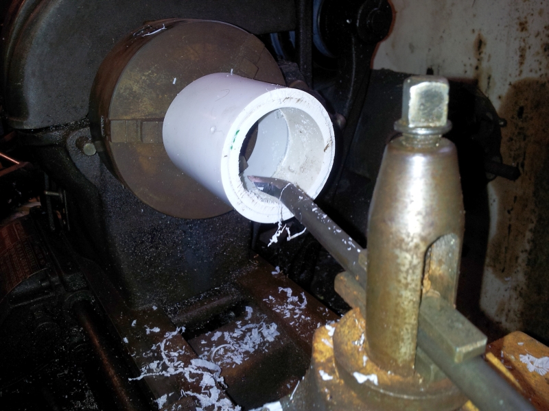

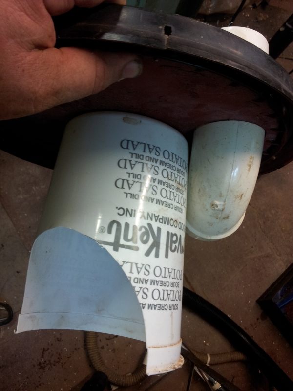

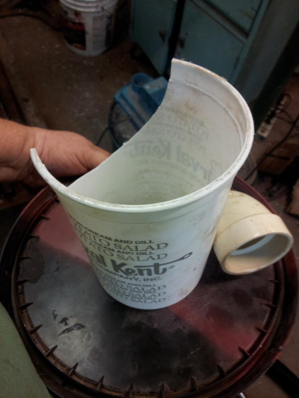

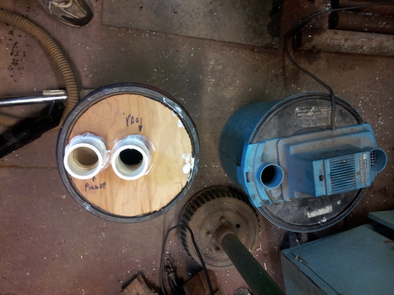

    I hate cleaning up the Bridgeport and lathe, a chip brush and a pan, spend more time cleaning up than making the mess!. Well I had to do something. So 1st version worked but the smaller diameter hoses clogged with swarfs, so made version 3 (version 2 doesn't fit any hoses???? note to self don't ask the kid to measure if you want it done right!)
    Used a 6 gallon bucket to hold more, added a 3/8" plywood board to stiffen the top. Use a bucket that had liquids in it as some dry goods do not have a seal for the lid. Fittings are glued together and silicone sealed.
    The hoses are different than pvc pipe fitting so made a adapter
    my take on a baffle to keep junk out of the shop vac
    elbow is trash inlet, center is to the vacuum

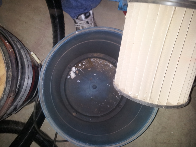

    shop vac is a Sear/Craftsman from the mid 70's with a paper filter

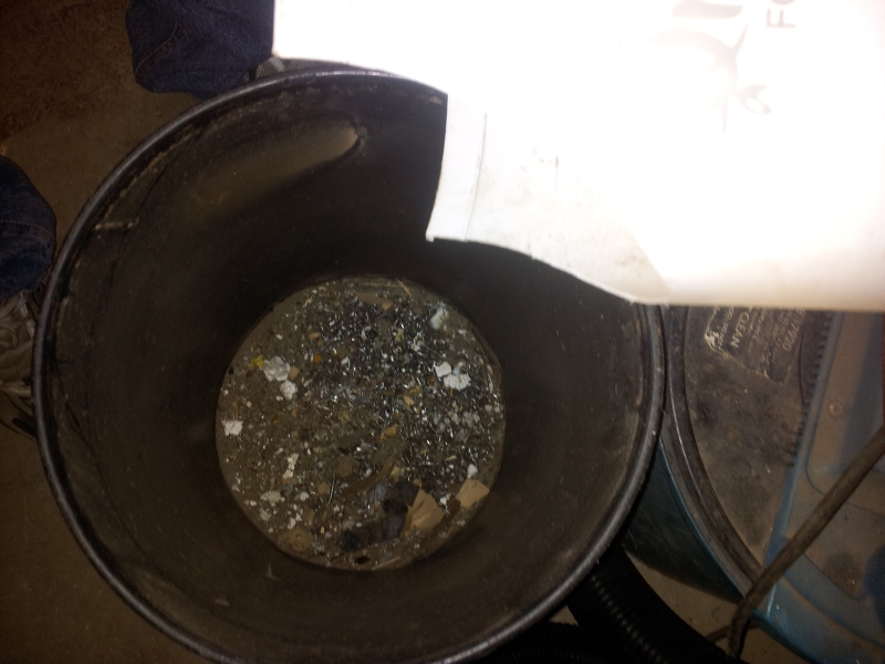

    1st time cleaning out the separator, about 2 gallons of swarfs and ****.
    only dust and some light foam **** made it to the filter, even though I knocked it over while it was running a few times
    This works, I don't see the need to make a cyclone separator, the baffle does fine keeping the swarfs from piercing the filter. This may ruin my image as a slob but it is sure nice to have a clean mill and lathes! Takes less time to clean as it does to make the mess! Such a simple thing to keep from blowing a filter! Yes I've blown two filters with that vac, one cleaning old oil furnace that I was halfway inside and the little old lady that owned the home had to poked me with a broom stick. The other was cleaning a coke machine using CO2 on one side, vac is one the other side. Yep it blew the filter again and the little old lady that owned the tavern had to poked me with a broom stick! I wish I had made this years ago!
