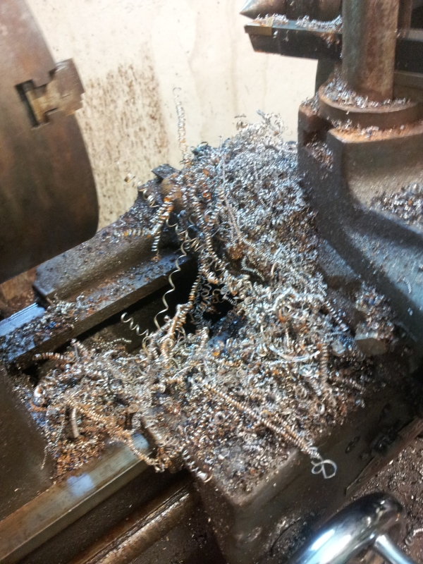

    That vacuum attachment is a great idea. I would like to see how you mounted the vacuum pick up at the lathe head.

    Gold03, just make mess then vacuun!

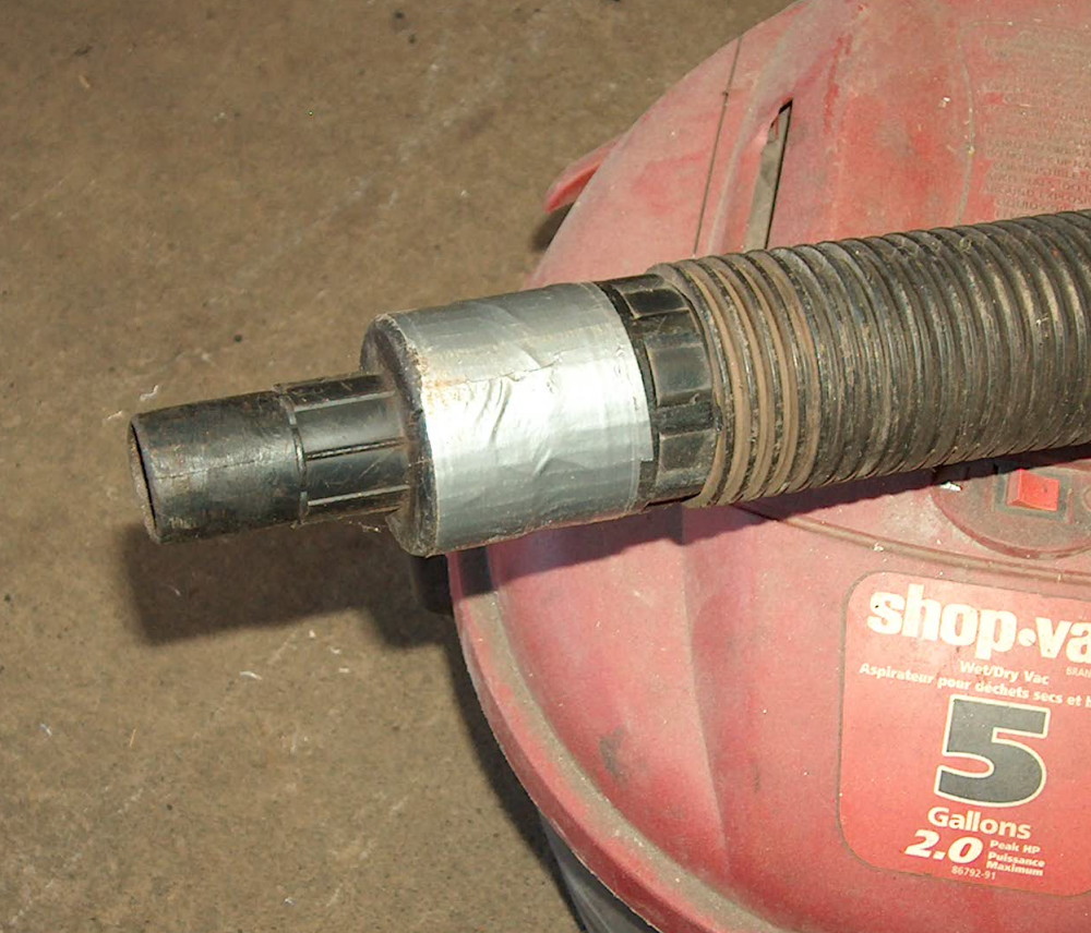

    heres what i came up with to clean my lathe, milling machine, drill press and i also use it on engines and whatever else, the large hose came with another 5hp shop vac that has long sence died, the end is what used to hold the small hose on this vac when it was new, i just duct taped it on and now any thing that can go in the small end will not get stuck in the larger hose.

    Budd,
    what type of filter does your shopvac use? my blue sears is pleated paper it will fail quickly if it tears, and the tornado vac I have is cloth material, was such a pain in the ass to clean swarfs imbedded in the material, that one can be washed.

    budd
    the filter is just a piece of foam, not much sticks to it because the airflow takes a sharp turn after in enters the vac, if i use the vac for dusty stuff i have a cloth filter that goes over the foam held on with a rubber band

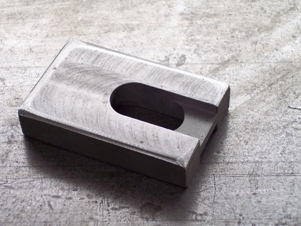

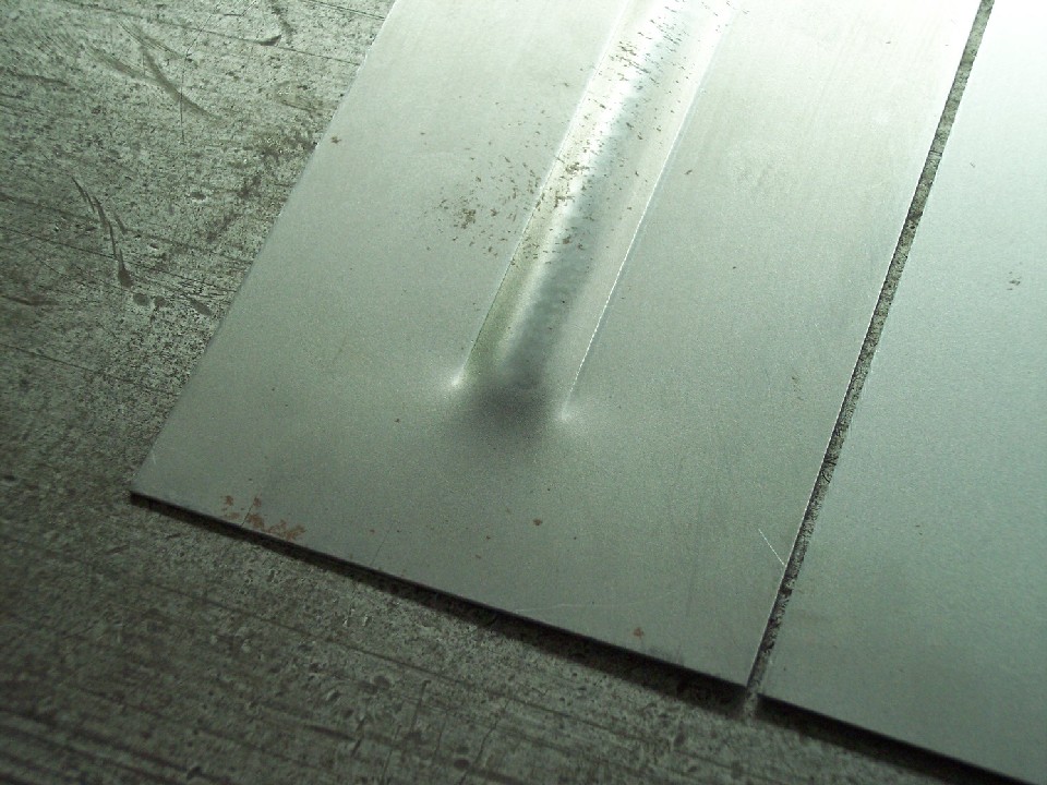

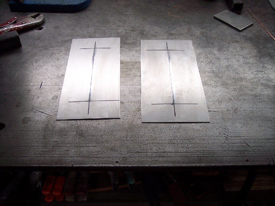

    Joined: Sep 9, 2008
    Posts: 1,424
    ronzmtrwrx
    Made this little tool to finish out the ends of beads for flat panels such as floors or whatever. Did a couple of panels in 18 gauge to show the difference it makes in the looks and how it will flatten the panel back out. Both were pre stretched with the planishing hammer prior to rolling the bead. I made this tool out of Maxell and just flame hardened it to see if this would work. This particular one is 3/4" wide, but you could make any size to match your dies. You just straddle the bead with it lined up right near the end and with it laying flat on the table, one good whack with a big brass hammer sets the end of the bead. I also kicked it up on an angle in my mill on one side and that will allow you to make a more tapered end to the bead if thats what you are after.

  24. Very cool. Why the hole through it?
  25. Kona Cruisers
    Joined: Feb 4, 2007
    Posts: 1,104
    Kona Cruisers
    I'm gueaing its the easiest way to make a radius is with a drill (end mill in this case) , correct?
    and for alignment purposes.
  26. go-twichy
    Joined: Jul 22, 2010
    Posts: 1,648
    go-twichy
    to see if it's aligned? great tool. now it looks stamped and not rolled.not that there's any thing wrong with that!
  27. ronzmtrwrx
    Joined: Sep 9, 2008
    Posts: 1,424
    ronzmtrwrx
    Thanks. Yeah, I used an end mill and the through hole is actually to align it on your bead. I left it connected on the open end to keep it from trying to spread out when you strike it. I just clearanced that area to clear the height of the bead. It looks like it needs a little tweaking to line up perfectly, but the dies I used to roll the 3/4 wide bead were ones I crudely made in my old manual lathe, and I missed the width by a little. :) I thought about making up a set for all the popular bead sizes and trying to sell them as a kit, but most guys would probably be like me and just make their own. Thanks for the compliments though.
