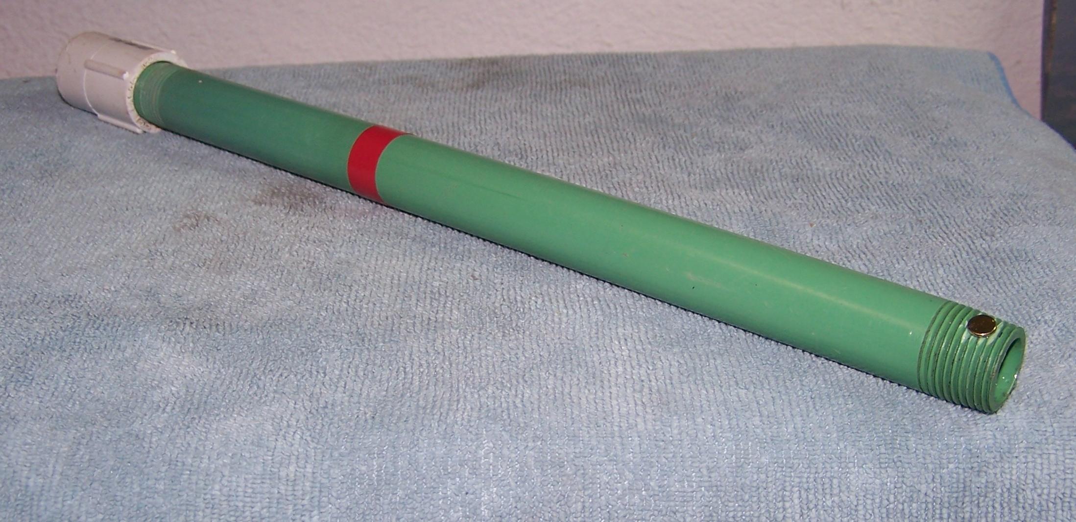

    Needed a tool to align the oil pump drive after removing the distributor for installation of a Pertronix Ignitor II. Worked like a champ, cost $0.00!
