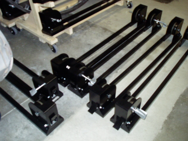

    I spent my summer vacation by building a rotisserie
    And it works too..

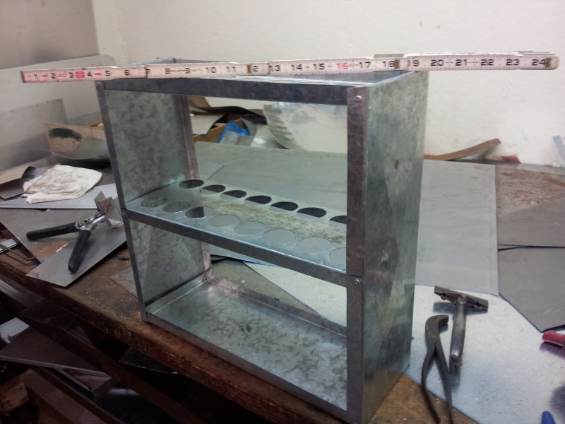

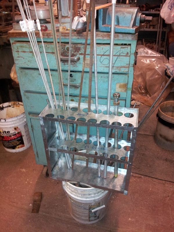

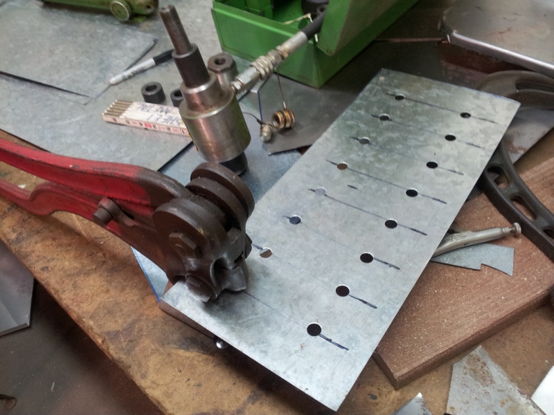

    I had such a mess of stuff stuck into a corner thought I better straighten up my act! So wanted to get the threaded rod and other small stock straightened up so made a couple of these. Should have done it years ago! After punching a set of 8 hole in one panel and could not sleep tried a different approach, when that did not work had the wife come out and work the whitney punch then using the Greenlee knock outs enlarge the holes twice. The sheet is 22 gauge, was 36" wide so made the panels 7.5" by 18" to reduce waste, a bunch of holes, .75" flanges some pop rivets and it stronger than I thought it would be, now to find a empty spot along the wall to mount them.
  11. Finnrodder
    Joined: Oct 18, 2009
    Posts: 2,971
    Finnrodder
    from Finland
    Thanks!
    I've build a lot of tools etc. because of one project,so i guess this wont be a last one..

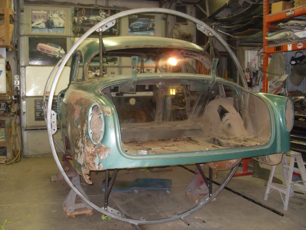

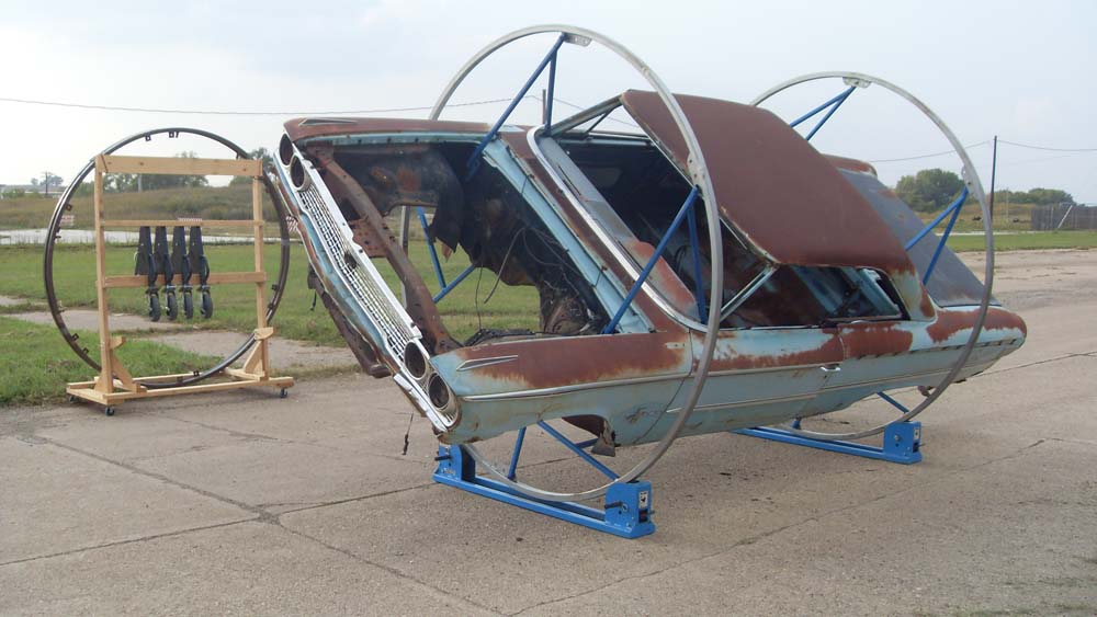

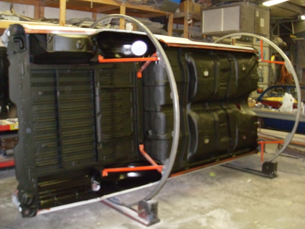

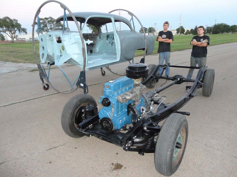

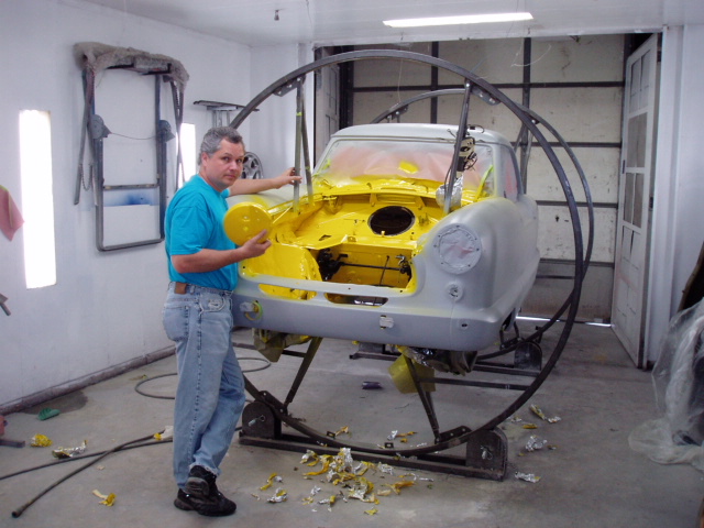

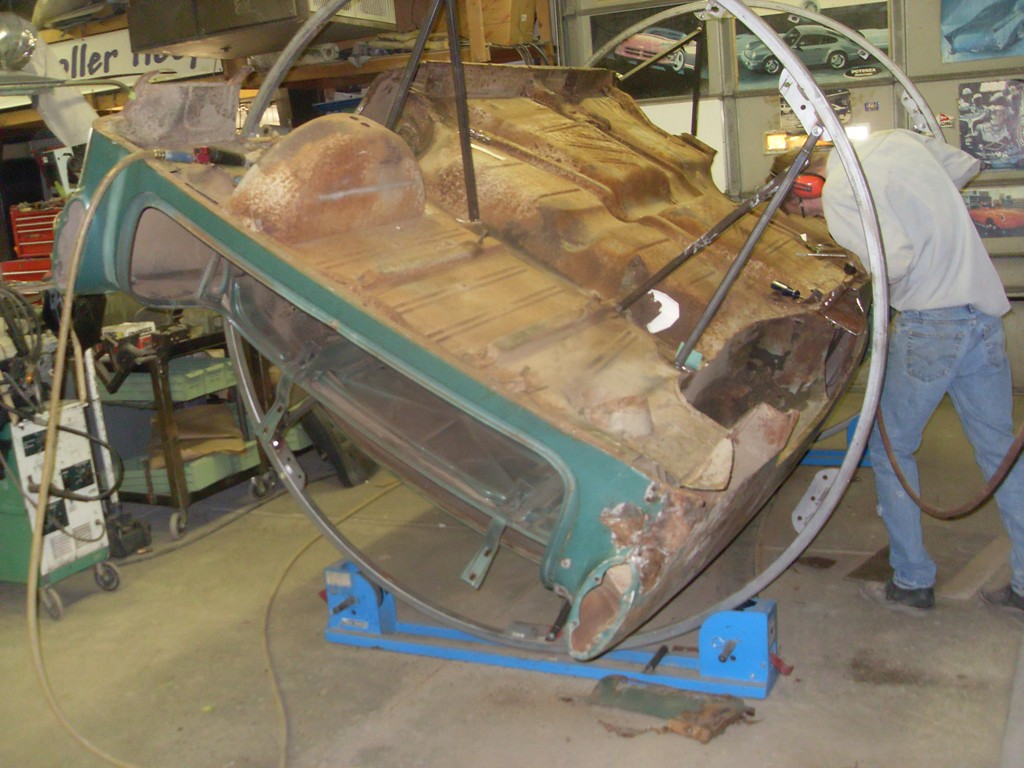

    here is my new concept on rotisseries, i train young guys at my hobby shop so I need a better way to rotate stop and lock in place. Plus the ability to load on a car trailer easily I call it Roller Hoop.
    Rastus likes this.
  18. I don't see a method for positively locking the rotation, how are you doing it?
  19. Auto Doug
    Joined: Oct 31, 2010
    Posts: 284
    Auto Doug
    Great question! it's all top secret stuff! See the picture of the two hoodlums standing on it, that's locked in and doesn't move! You simply press on one of the four foot brakes on the roller base units, stops and locks it so you can work very efficiently if you happen to need to move it a few inches or complete 360, simply toe kick it off and roll to your next desired position all within seconds and keep working!
    No need to stop and go get a wrench, or try to index a pin, no need to get Joe or bill to help spin it, it rolls with minimal effort! The foot brakes are a simple yet very effective, you only need to use one to hold in place while you perform your work, If you press down and lock all four it is like the body shell is welded to the earth!
    Rastus likes this.
  20. Auto Doug
    Posts: 284
    Auto Doug
    perhaps it seems that way and no that is not my intent here as I put the pictures out that really so how the genral build of the system. I'm just a small simple shop and this is a home built piece of equipment my home is right behind my shop and I spend most every night here until 11pm just like all the other HamBers out there. My life is and always has been to help out others and this product simply dose that, I get very excited to show it off anytime here in my shop to who ever stops by. It has cost me hundreds of thousand of $ to get this far with it and the time I put into showing it dose not benefit me much at all. I'm just simply pleased to try and help out and see another cl***ic get saved! My cousin for one built his own version it is a bit crude made from oilfield materials, but very functional i was delighted to see it and felt it was a complement to a good idea. Yes it has been out for a few years now and i do manufacture them right here in my shop along side of cl***ics & customs we build, it is a great way for some of these young guys i train to get experience in welding & such. Advertizing? no i keep it pretty basic didn't really think about that, there are better ways to do that for sure, I just enjoy p***ing along all the hard work and effort i put into this concept and rotisserie. it just shows that maybe a good home built Idea can hit the market? so keep at it is the message i guess? But I do now also see your point and please remove it if necessary I'll be more careful in the future. (uum were did your comment go? I ment you could remove my posting? if not appropriate)

  21. 56don
    Joined: Dec 11, 2005
    Posts: 10,333
    56don
    I like it except for the photo on the trailer. Looks like the center of gravity would render it questionable.
  22. Auto Doug
    Posts: 284
    Auto Doug
    Not at all! loading on and off a trailer is simple and traveling down the interstate 16 miles each way at 70 to 75 mph is now just a normal thing for me anymore, I have to admit the first couple times out on the road were worrisome but now it's standard operating procedure. I hauled the Galaxie over 220 miles round trip to a show West point Nebraska a few years back, that's when Dennis Gage of My Cl***ic Car sat in the Galaxie to do the closing of his show. Back in 07 we hauled a car from Pomona to Long Beach for the big swapmeet out there, 6 lanes of busy L.A. freeway that was a good test! always lots of looks, but never a problem! Here are a couple pictures of the 220 mile round trip with the 63 Galaxie it is a Big car and is in the larger Hoops it transports much better than the end mount style, don't need to add to the trailer or brace the body shell in the center, you can see here since i took the complete unit on the road for displaying i used the roller bases as well with the brakes locked and the rolling casters on and then just strapped it down and traveled. believe me if you can think of an issue with this system I have already addressed it and come out on top!

  23. bjinatj
    Joined: Jun 24, 2008
    Posts: 438
    bjinatj
    I just wonder how it actually connects to a car? It seems that the center supports that connect it to the vehicle would have to be different for each vehicle. I know a lot of the info regarding this product is probably top secret as you said, so I ask is this a question you can answer?

  24. RMR&C
    Joined: Dec 26, 2009
    Posts: 4,964
    RMR&C
    from NW Montana
    Seems like those hoops would constantly be in the way.....like say swapping a 1/4 panel or fender. Would **** trying to work around them. Neat idea though.

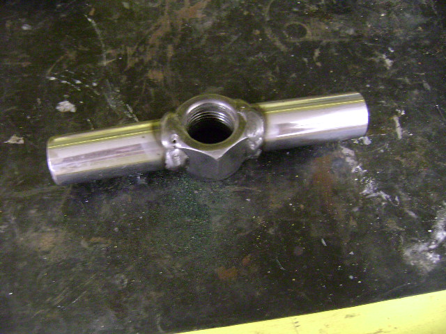

  27. I made this to remove pinion yokes off rear ends (u joint straps in place). It's used with the screw from my Snap On steering wheel/harmonic balancer puller
