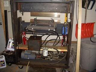

    Here's the electric/hydraulic press brake that my brother made and then gave to me!
    and a crate fill of tooling to go with it.
  27. Noland
