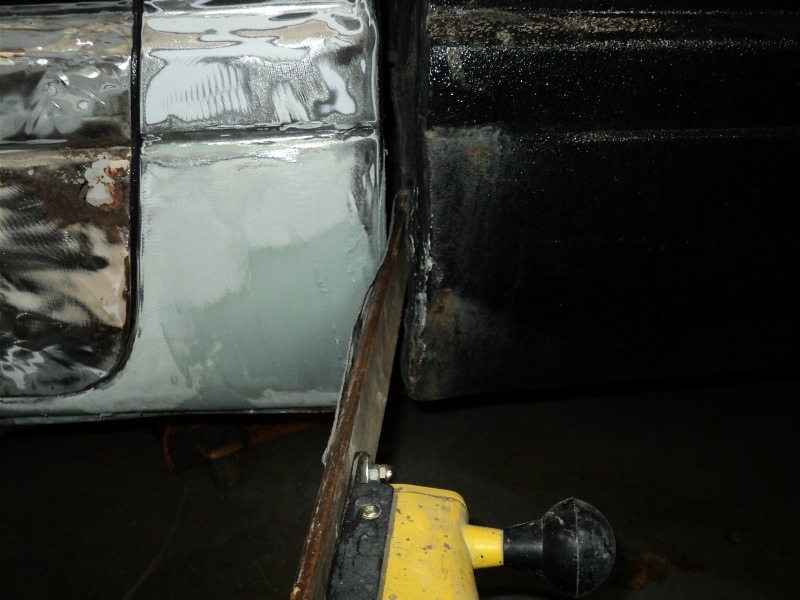

    Take an old unused long board, a little modification. Get at that hard to reach spot.
  9. tooljunkie
    Joined: Oct 18, 2010
    Posts: 209
    tooljunkie
    from manitoba
    thanks,olcarguy i can use that idea on my DD.was wondering how i was going to do that.just started chopping the rust today.

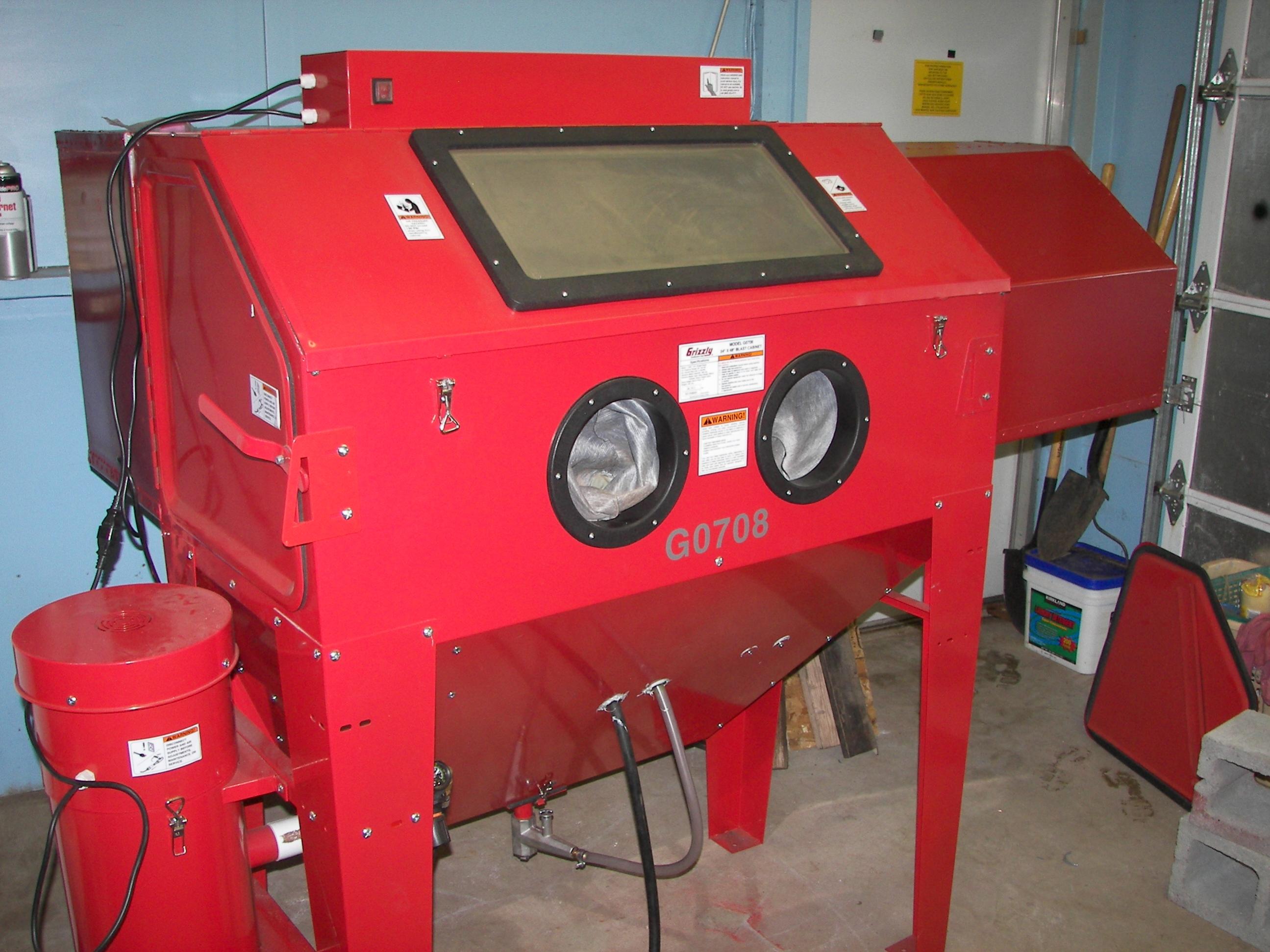

    This is my modified sandblaster - I started with the largest I could find in my price range, 24 X 24 X 48 then added a 18" pop-out on the back and a 24" pop-out on the side in place of one of the doors. As space is at a premium, I relocated the filter from the back to the side and used plastic pvc pipe as the suction hose.
  24. Old Iron Nut
    Joined: Jun 15, 2012
    Posts: 90
    Old Iron Nut
    Nice frog49! I plan to do something similar with mine.
