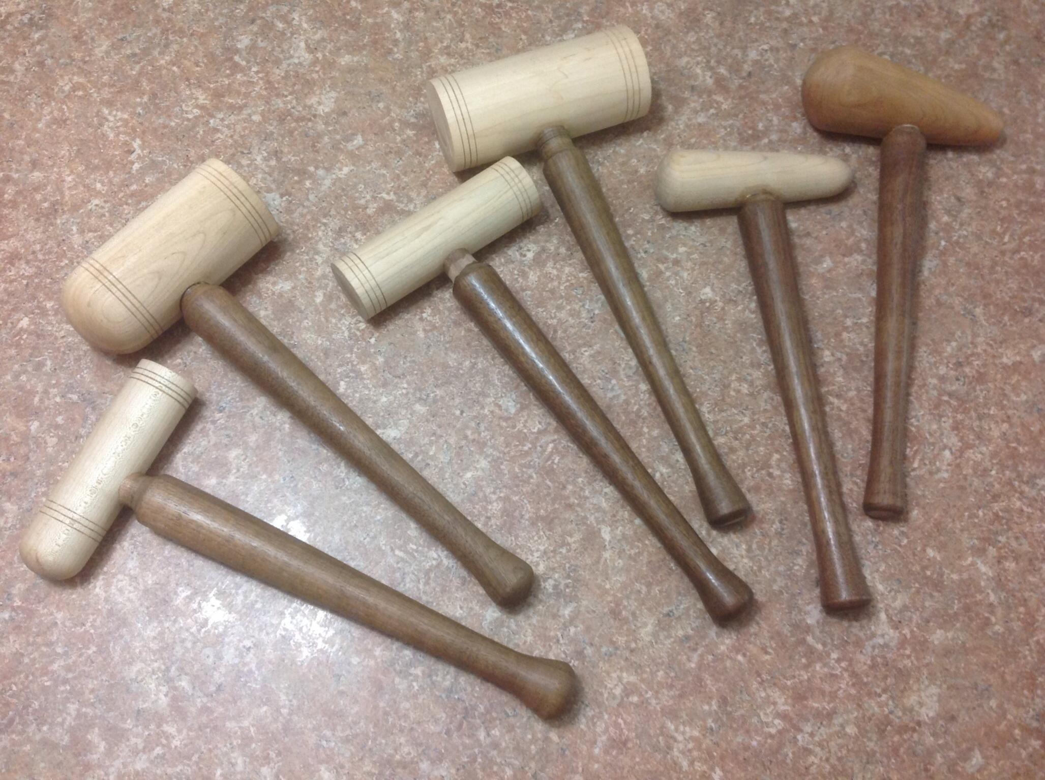

    Here is a set of mallets I made for myself.

    Nice work there buddy! If you can work sheet metal as well as you use a wood lathe, you're well ahead of the game:) RodL

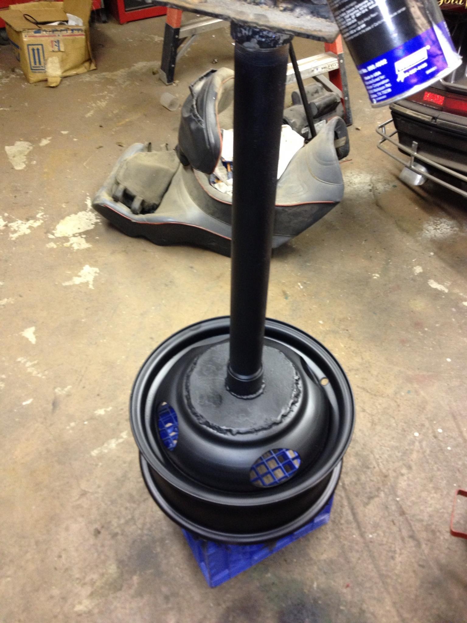

    Have been wanting to secure up the base on my grinder. My father built it many years ago. It had a 3/16 plate for a base with 4 holes to mount to the floor. I wanted to use a dually wheel to add weight to the base
    My 8 year old AKA rockstar sandblasted the wheel and I used the torch to make the square plate round. Welded the plate to the wheel and rockstar painted it flat black
    A nice project to work on together

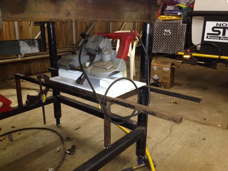

  8. Fab table. 6"x5/8" steel plates.
    Need to get some heavy duty drawer slides:
    A closeup of the sliding clamp "pucks" as I call them. They are drilled 3/8"-16 on one side, and 1/2"-13 on the other. I got a piece of 2"x1/2" flatbar, drilled and threaded it for a stud, and tacked a toggle clamp on there to see how well it works. Sure would be nice if I could find cheap toggle clamps with a stud mount!
  9. Not bad for 8 years old. Might be a good time to teach him to use the grinder as well.

    Those all from one bat? Look very nice.

    Very Nice Fab table, I can see you getting a lot of use from it.

    HF has vise grip type clamp with one jaw and a stud. They list it as 9" drill press clamp. I've got a couple at work and they're pretty though.
  19. chinese knock off, nice use of a de-sta-co clamp ...i use de-sta-co items all over the shop and great for clamping
  20. Do you know where I can get them bulk for cheap?
  21. 56premiere
    Joined: Mar 8, 2011
    Posts: 1,445
    56premiere
    Take a look at Surplus Center in Nebraska , seemed reasonable to me. Also they have a lot of things that are good for us in the shop and car. Jack

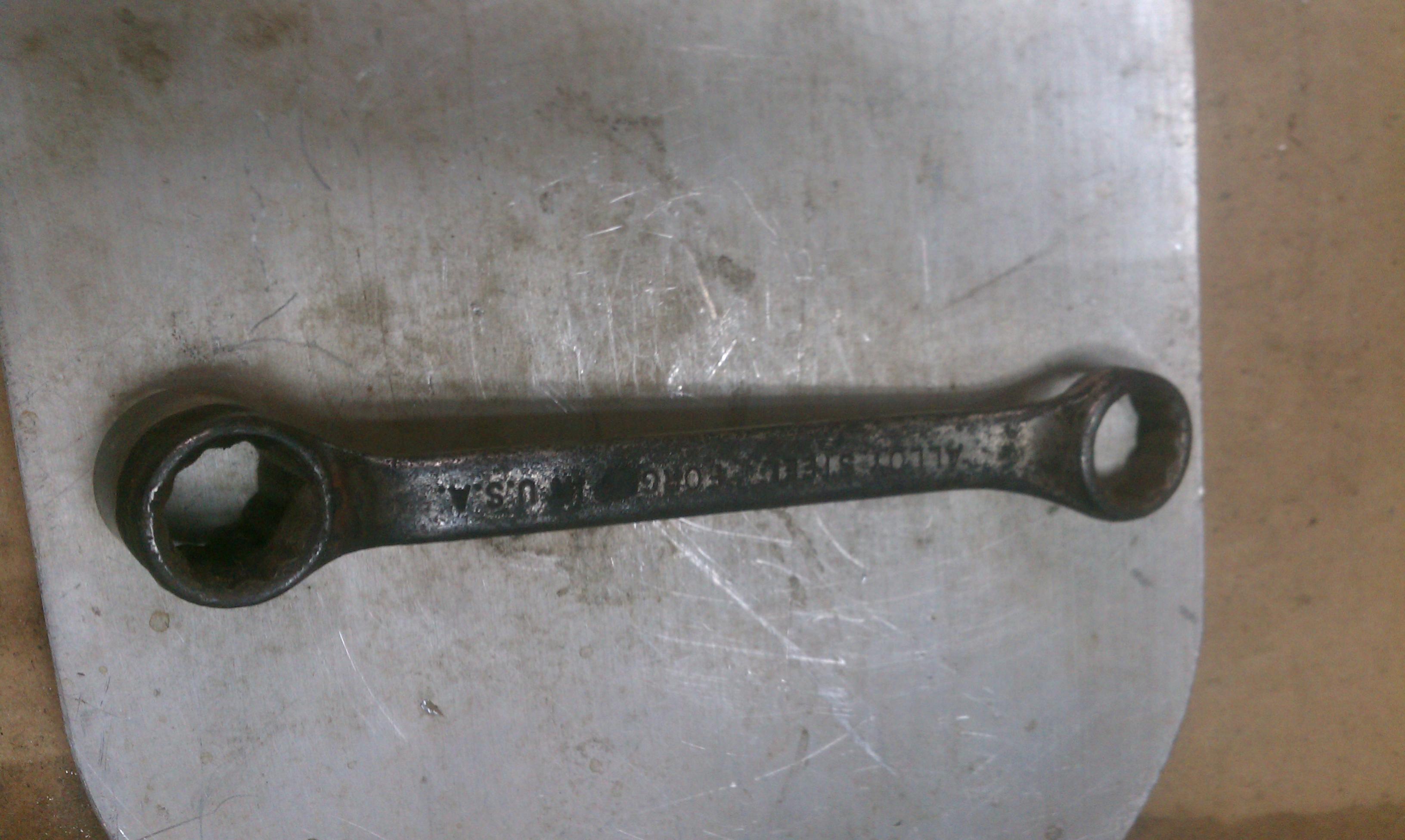

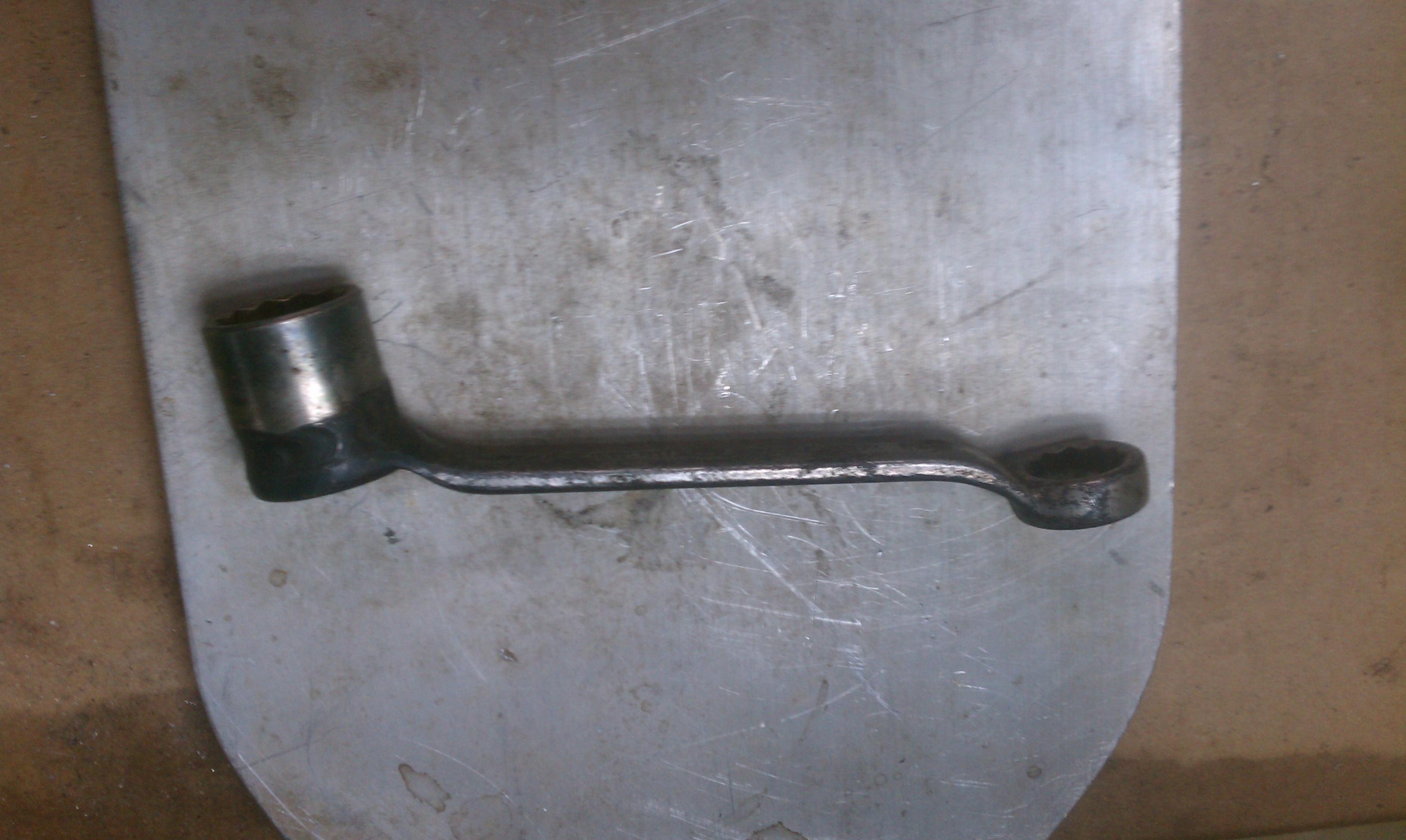

    I made this wrench to change the spark plugs in my chevelle with headers.
    I started with a 1/2 by 9/16 short offset combination wrench and cut down a 5/8 12 point spark plug socket and welded it to the 9/16 end of the wrench.
    This thing turned into 3 wrenches in one and came in handy to put the alternator belt back on countless time when I tried to get that old Saginaw to shift.
