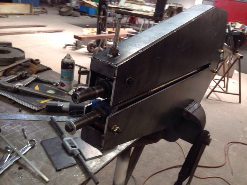

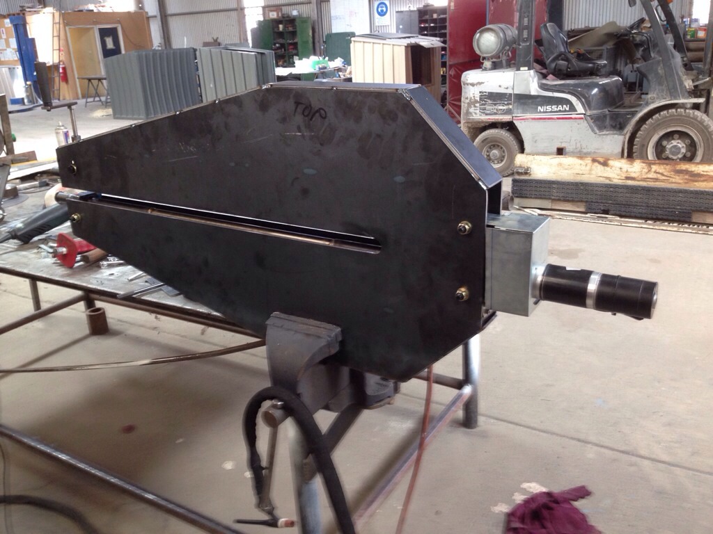

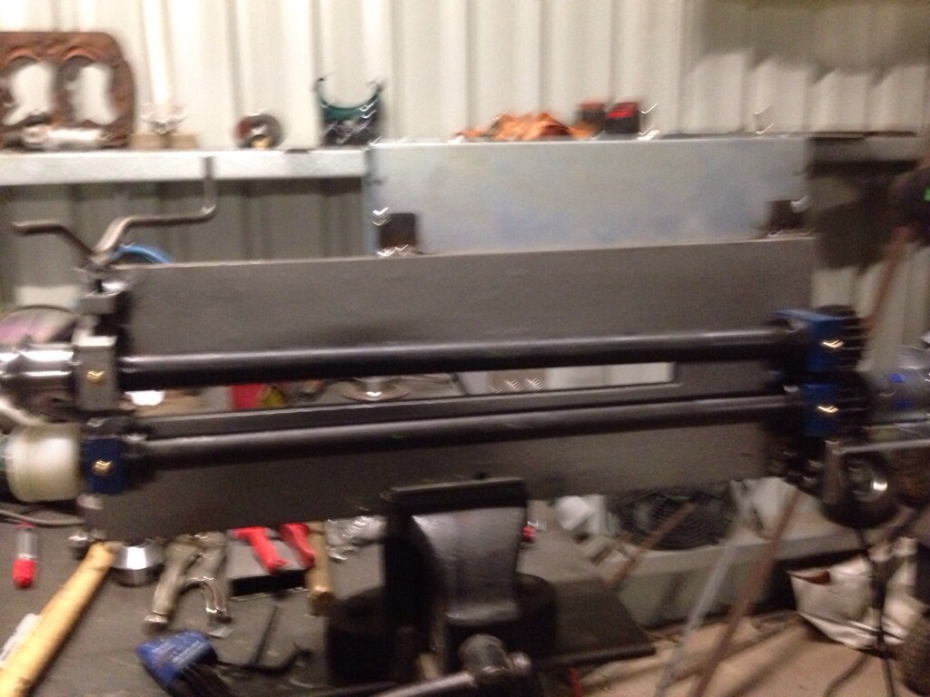

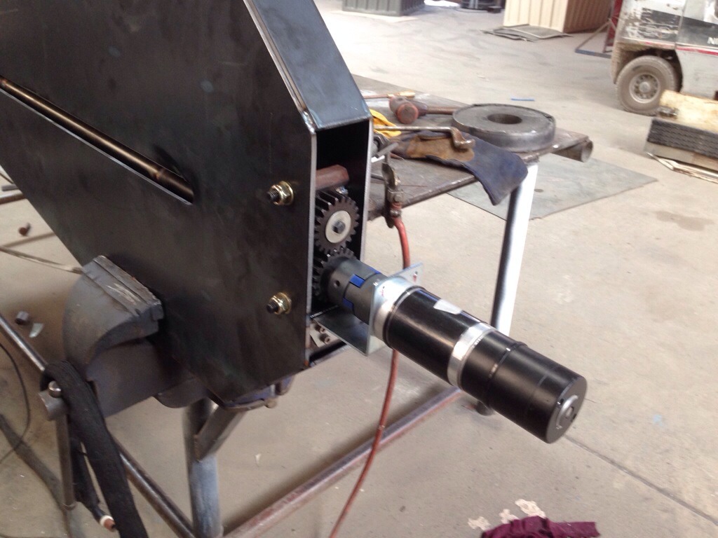

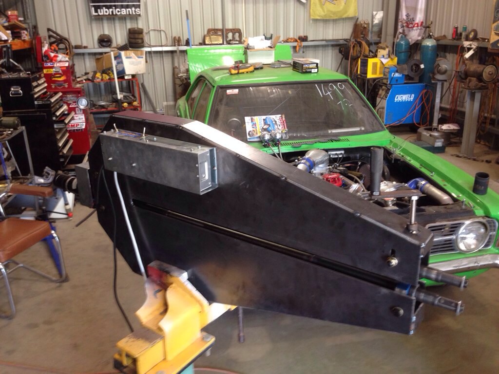

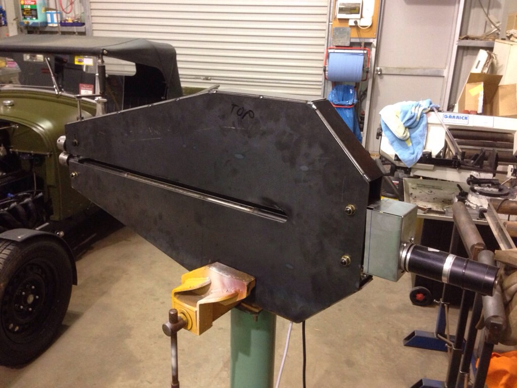

  4. willo_96
    Joined: Nov 5, 2013
    Posts: 78
    willo_96
    The motor is from a Speedwerx beadroller, there an Australian company, think its a 10:1 reduction on it with variable speed foot control. Don't really know any other specs on it

    whtbaron
    from manitoba

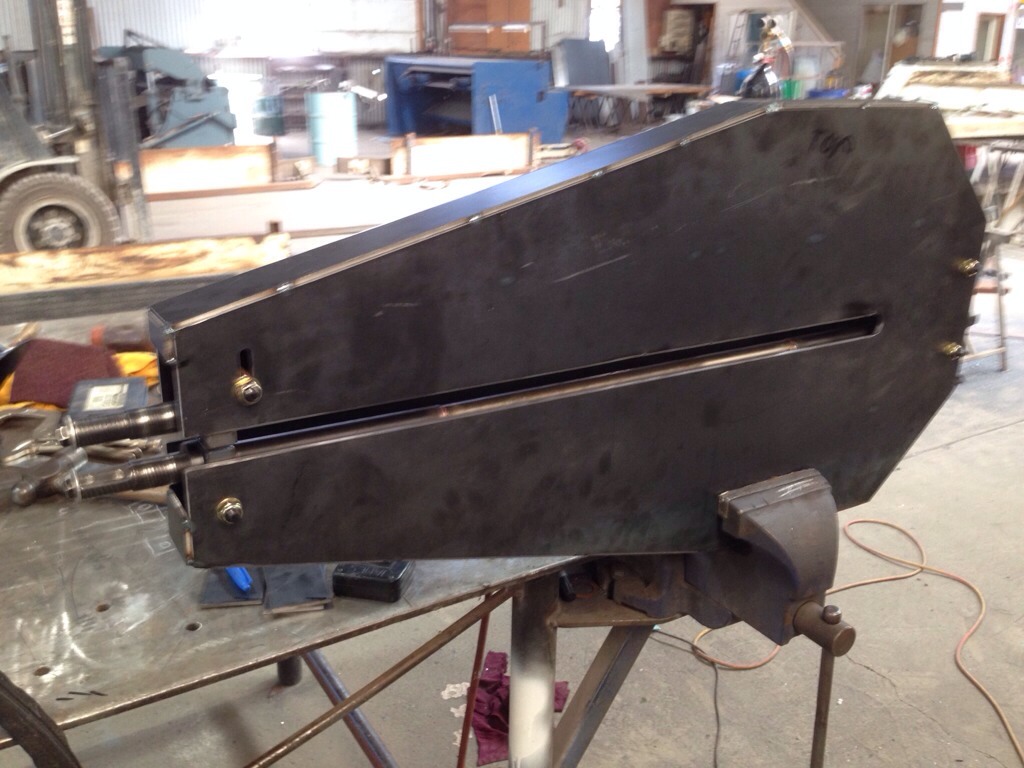

  6. rcnut223
    Joined: Oct 12, 2006
    Posts: 1,282
    rcnut223
    from wisconsin

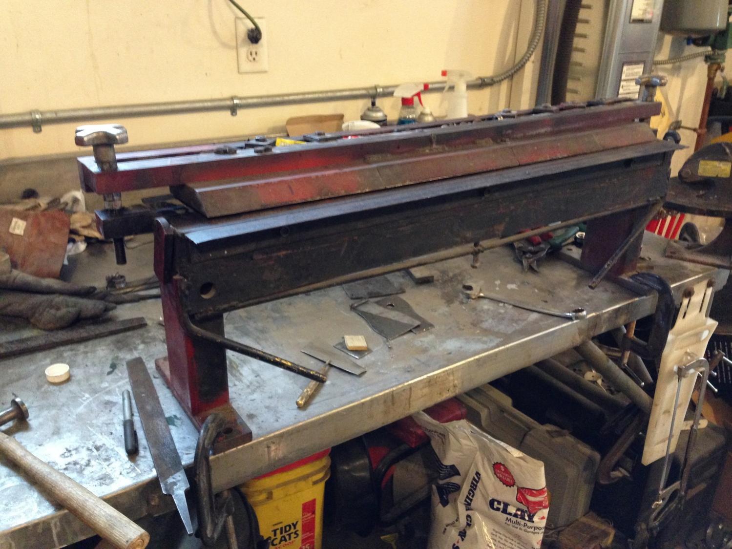

    homemade brake
  7. gatz
    Joined: Jun 2, 2011
    Posts: 2,153
    gatz
    is there a radius on the nose of the clamp bar?
    I need to make one of those, but I'd like it to be a "pan & box" brake
  8. Looks like is a box and pan if you look real close.
  9. leon renaud
    Joined: Nov 12, 2005
    Posts: 1,937
    leon renaud
    from N.E. Ct.
    looks like a few sections of commercial finger brake dies were used in this .
  10. gatz
    Joined: Jun 2, 2011
    Posts: 2,153
    gatz
    OOPS, my mistake...guess I should've looked harder.

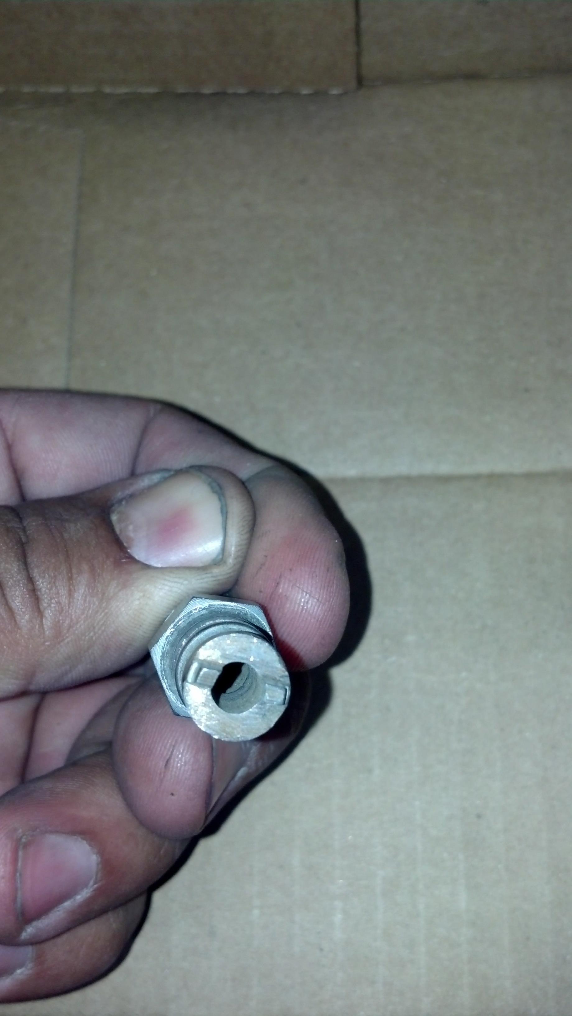

  11. crazy_tonguezz
    Joined: May 16, 2013
    Posts: 375
    crazy_tonguezz
    from glendale

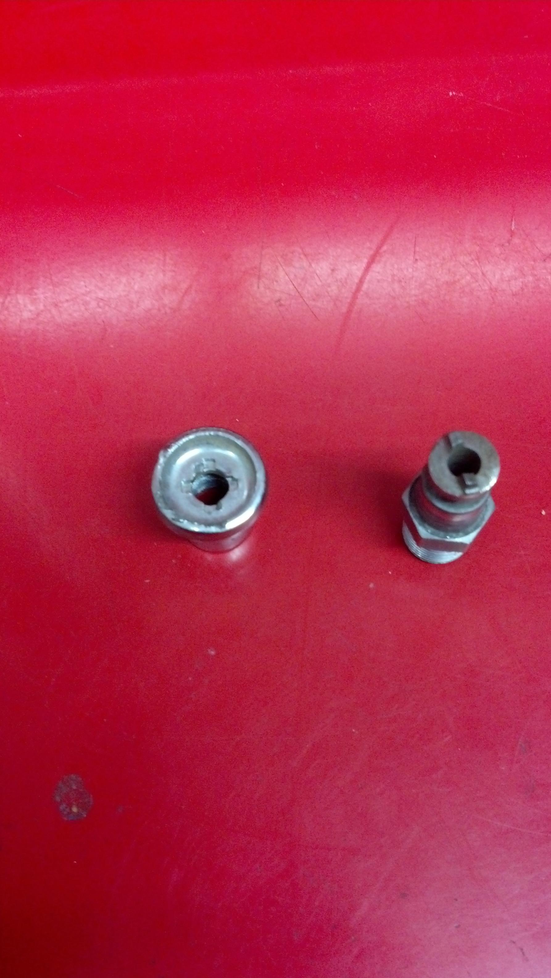

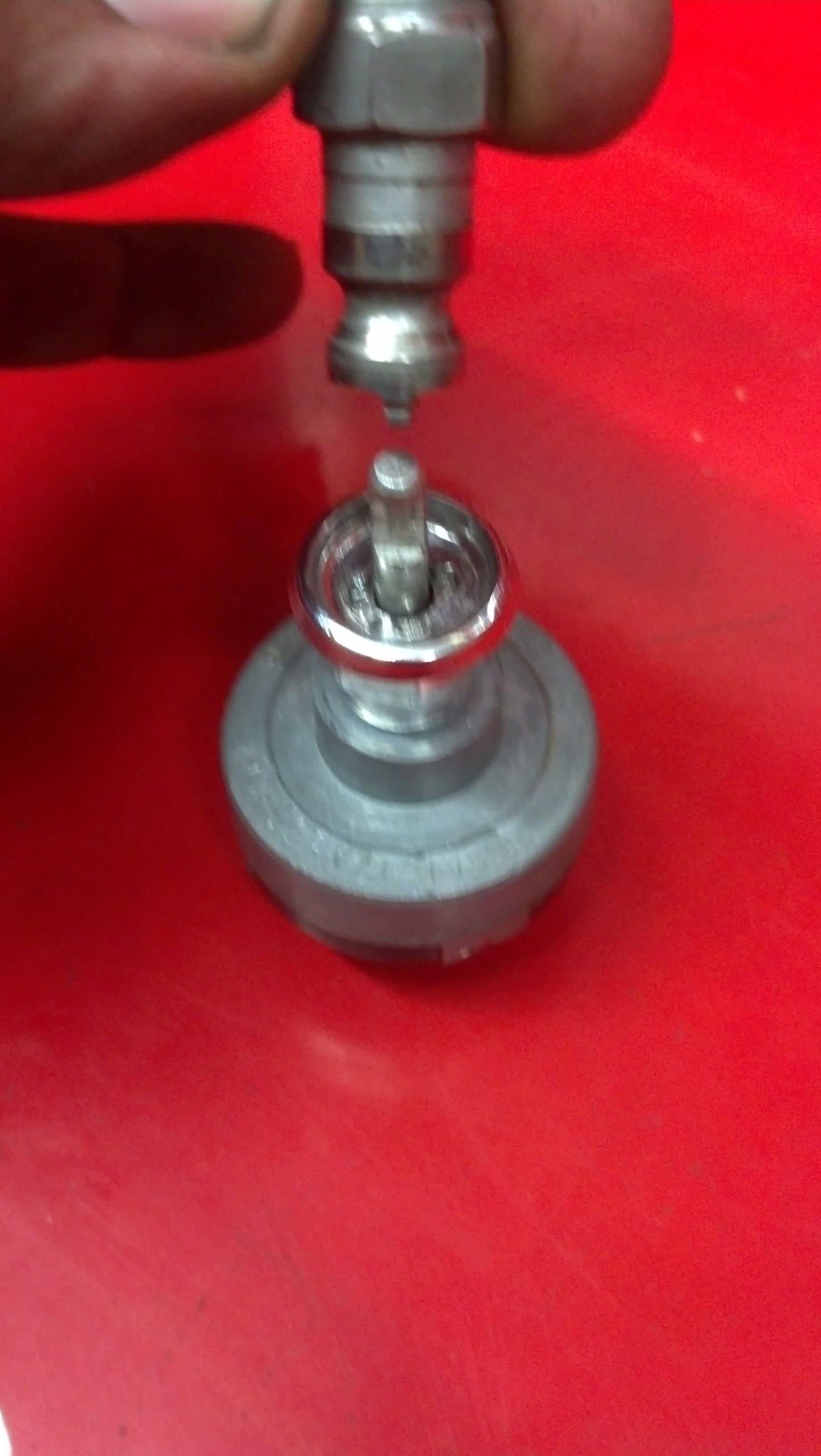

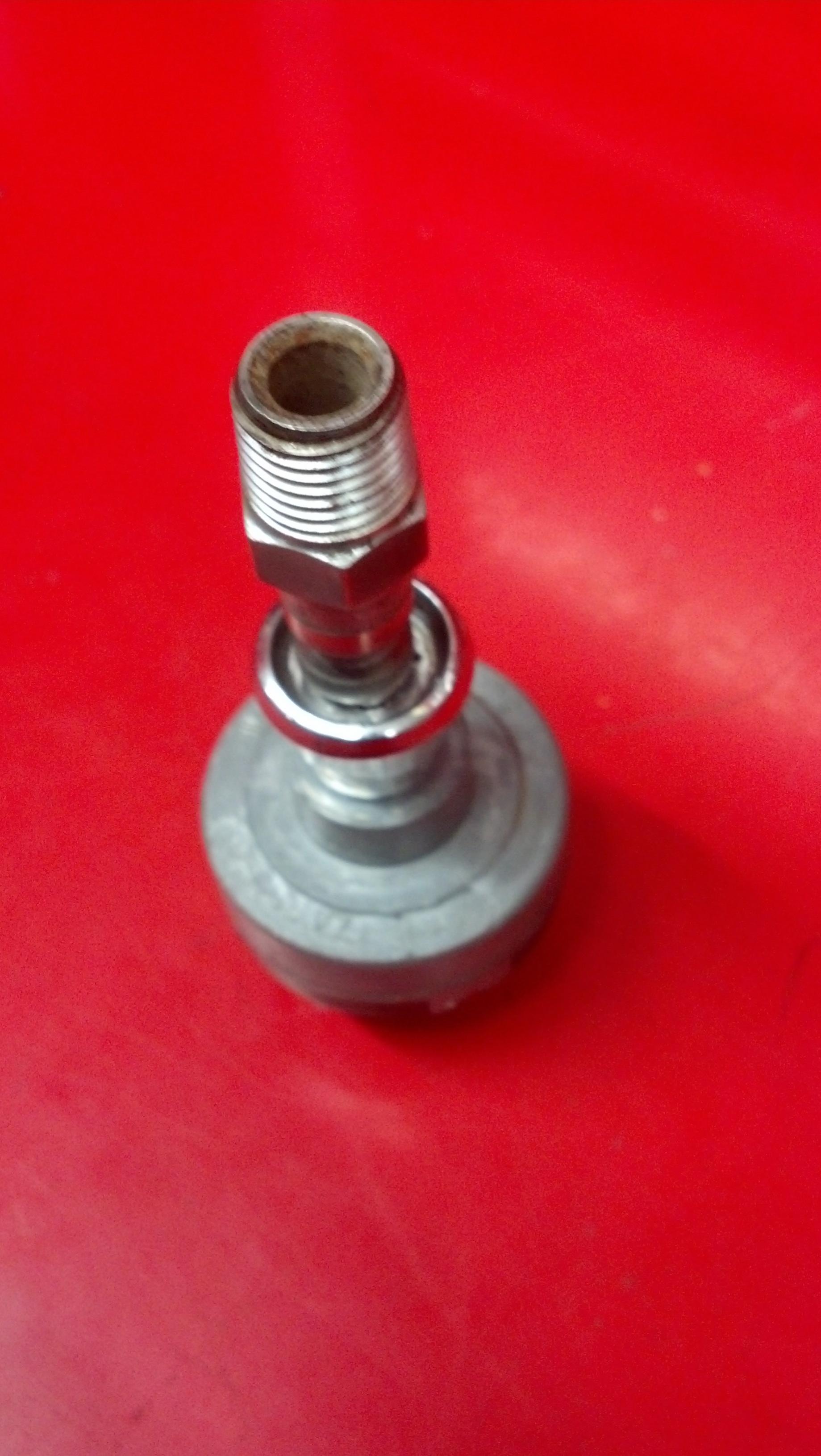

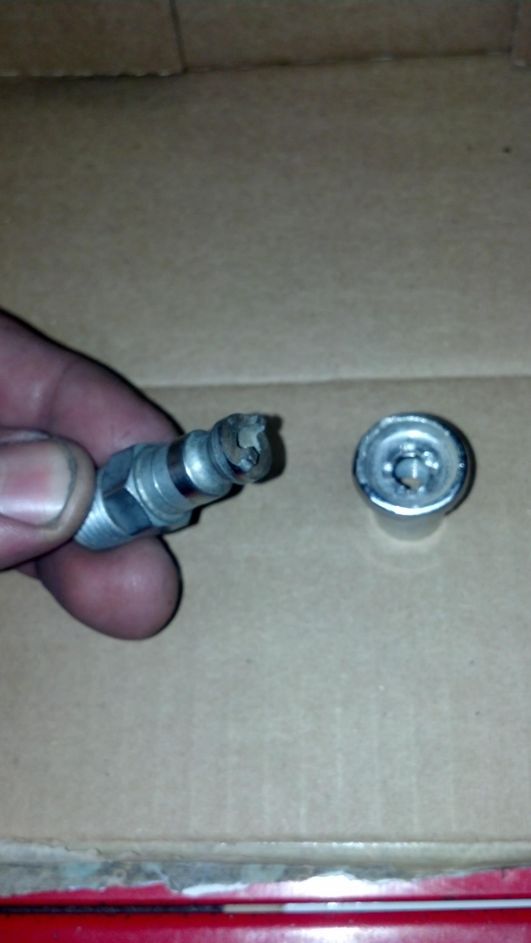

    This is nothing compared to the other tools ive looked at on here. But either way this got me out of a pinch.
    I was at a salvage yard and found a switch i needed and it had the lock nut on it ,. well i brought my kit for newer cars thinking i might actually have the one for this switch .. NOPE ! i didnt have a small enough fitting. so i went home and was thinking of ordering what i needed from eba_.
    I noticed on my desk i had a worn out air fitting and i thought Duhhh stuip use that. so i went to the garage and pull out my 3 inch roloc grinder and shaped the end to fit the smaller lock nut for switches.. took all of 1 minute and didnt have to wait 5 days to get it mailed.
    I now carry it with me evertime i go to a salvage yard.

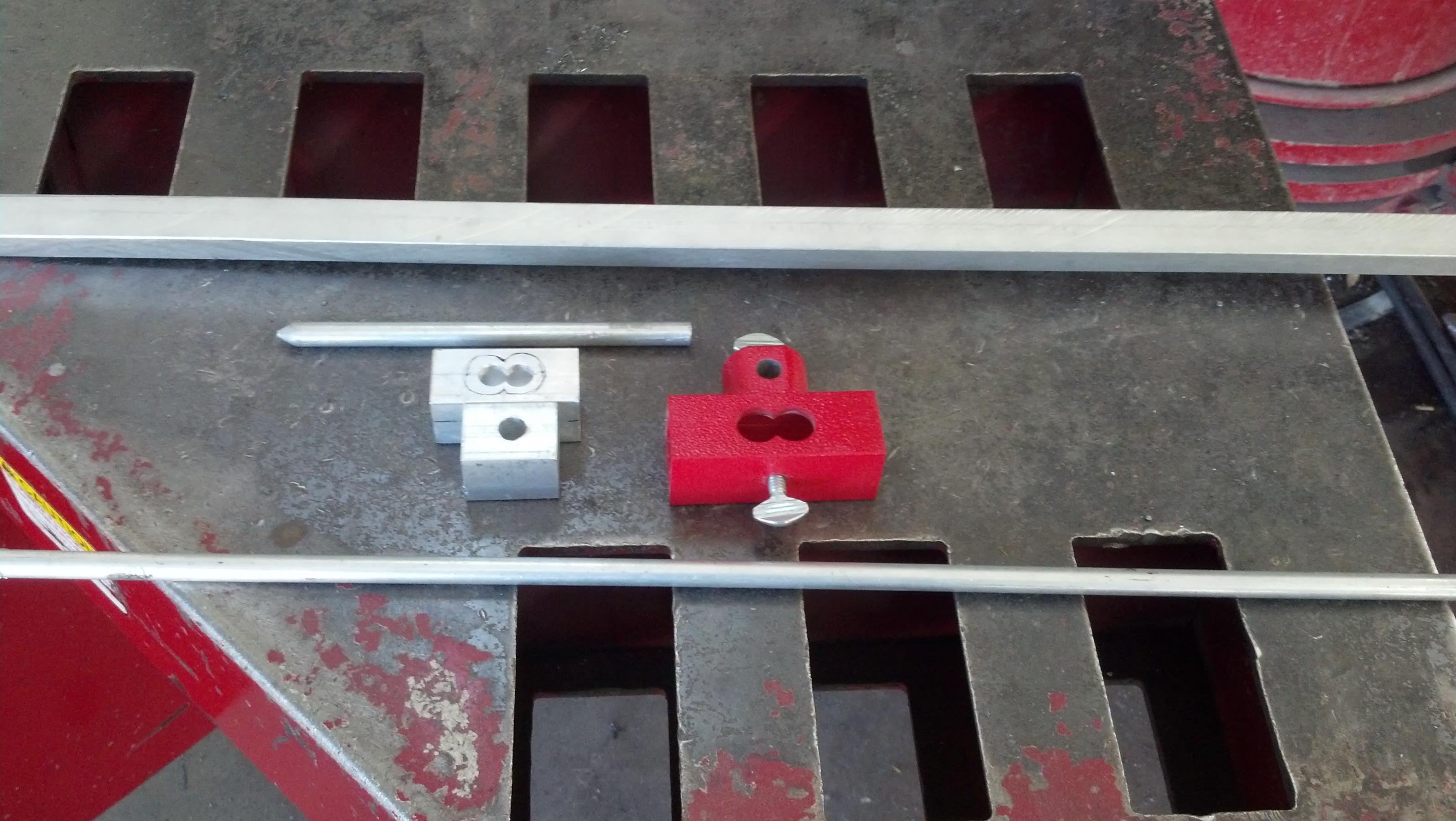

    Next time i post ill show you the aluminum adjustable tram gauge with a metric and standard rule. it measures from 2" to 12 feet, i made it a 2 piece tram so when im just tramming under hood demensions or if i need to tram under frames or bed openings, ect ect ..

  15. Color me the dummy here....whats a tram gauge and how is it used?
  16. niceguyede
    Joined: Jan 19, 2009
    Posts: 633
    niceguyede
    from dallas
    It's for body work. Basically a tape measure with pointers on each end. It's for measuring square.
    Sent from my LG-P769 using H.A.M.B. mobile app
  17. True name is trammel or trammels.
    I use mine a lot when doing body/chassis work.
  18. Oh, ok, thanks.

  20. You can buy them at the hardware store, mines got a metal rod as opposed to the wood in the previous post. Pretty easy to make though if you've got the gear, but they are pretty cheap..

    That is one type of tram. I will take a picture of mine tomorrow. The rod is on the side on mine , so that you can adjust the rod heights to clear parts in the way.

    Great deal! I find all kinds of cheap Chinese sockets as I do my inspections for work at abandoned houses. I keep them in a drawer and use them for these kind of uses. I have three or four ground down like yours.

  27. 80WTI
    Joined: Sep 16, 2012
    Posts: 319
    80WTI
    Great job on the beadroller, i am in the process of a similar project but just wanted to go a high throat design but not sure on the torque of the speedwerx motors. thanks for the pics.
  28. willo_96
    Joined: Nov 5, 2013
    Posts: 78
    willo_96
    Yeah, the Speedwerx motor is good, probably not enough grunt for 1.6mm, it'll do it but not all the time, but it's fine for what I do, where's some pics of your deep one.

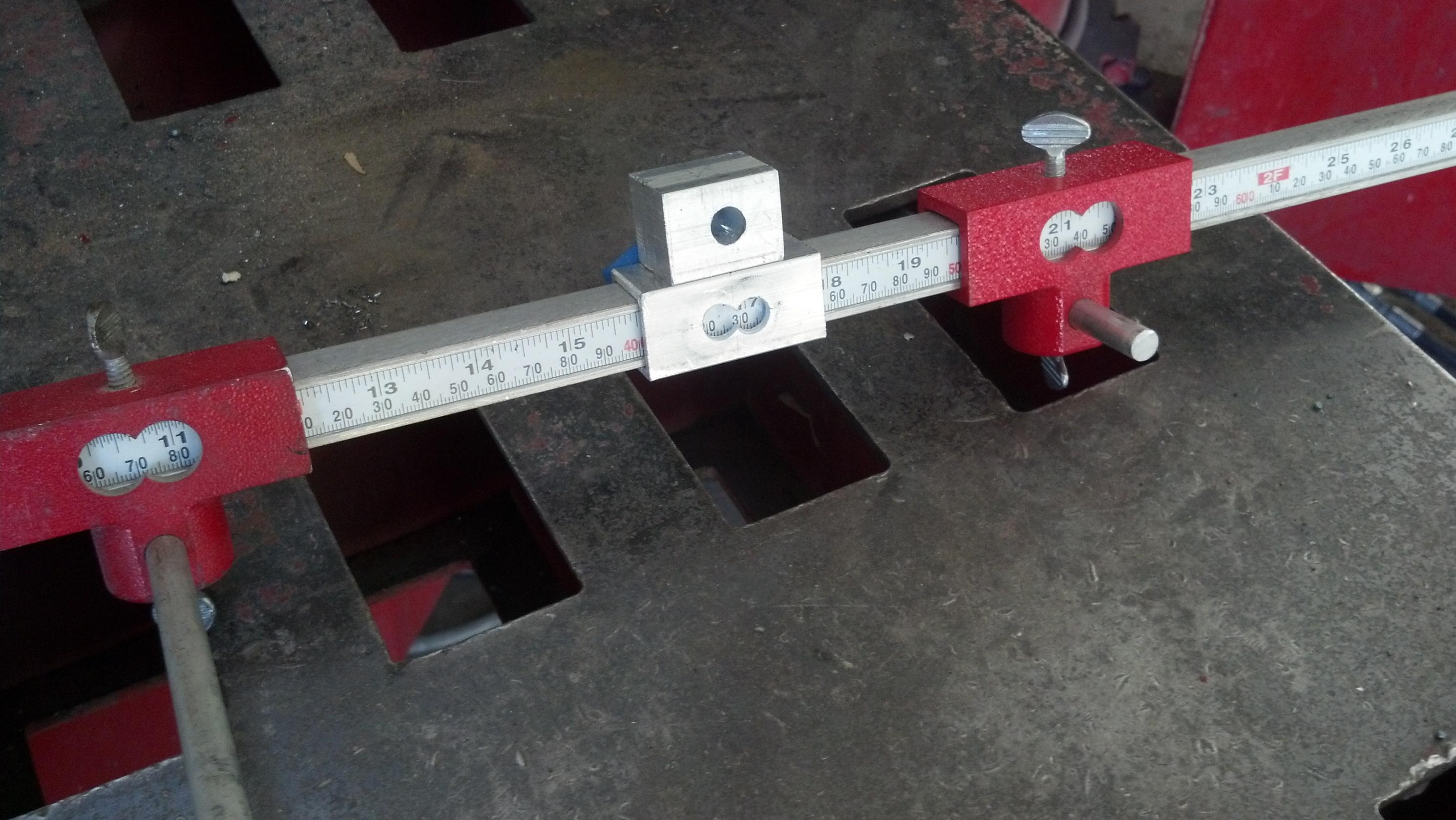

  29. crazy_tonguezz
    Posts: 375
    crazy_tonguezz
    from glendale

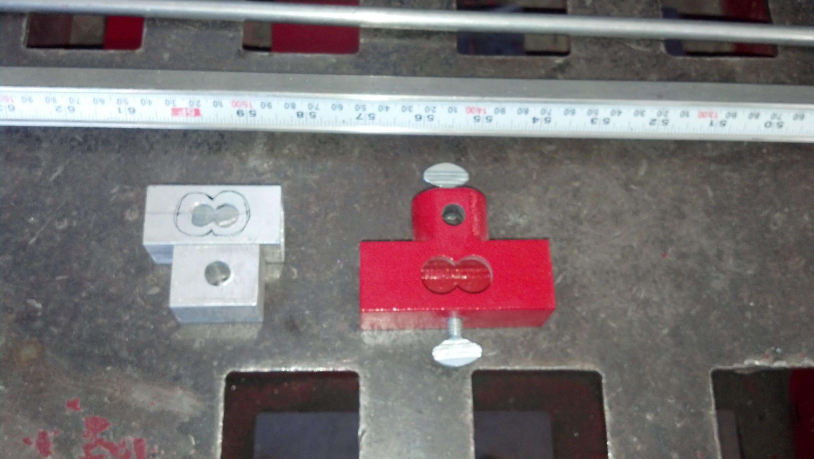

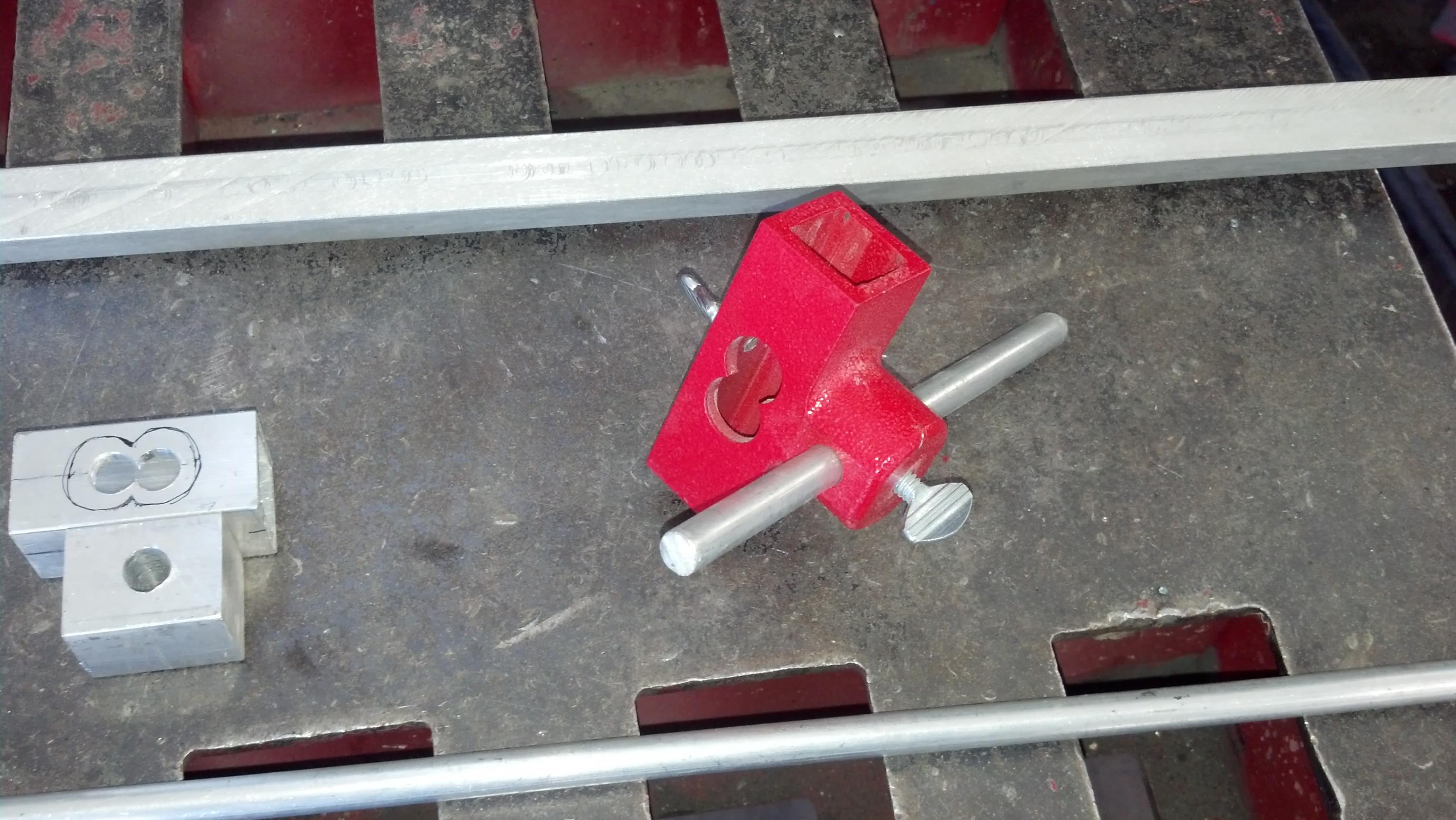

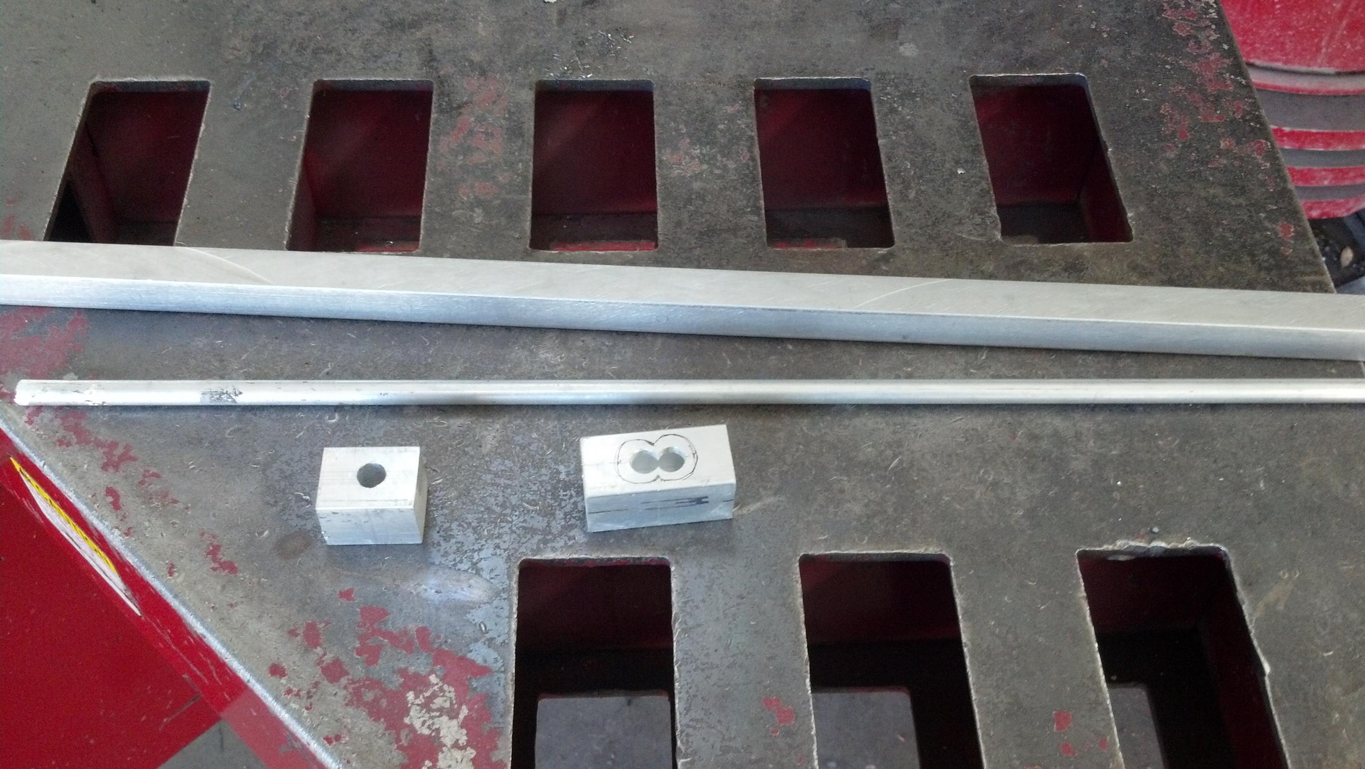

    ok here is my homemade tram. i copied it from an older style autobody tram. i like this style far bettern than the ones that are digital and one with a tapemeasure , Mostly because with this one you can do measurements from 3 inches to how ever long you want. Like i said mine is in 2 sections.
    Before i had bought the red sliders from a retired body man , I actually had made up my own sliders that did the same thing just not as nice as what you see on the red ones. Either way they both worked i found an unfinished one I made to show an example as to how easy it is to make.
    The rule tape i used is a Delta 79-056 12-Foot Right-1/2-Inch Wide Metric/English.
    On the long length i set up my table saw with a dado set to let the rule sit in just a tiny bit so that my slides didnt rub the numbers off.
    also set my router up to smooth the insert out. And no it didnt damage my blades, taking that little of material off isnt a big deal plus ive cut some hard woods harder than aluminum.
    as you can see i made my rods and ground points into them. they slide up and down to clear anything in the way. i have some longer length just incase .
    one of the fixtures stays at zero at all times and the other slides you adjust to measure square or to check side to side that things are in line,.. you get the idea i think. They make these tram gauges but are from 350 and up and most dont have the rule and you have to use a tape measure. i think that defeats the purpose if you ask me. i built mine for under 40.00
    mikeyyeah likes this.

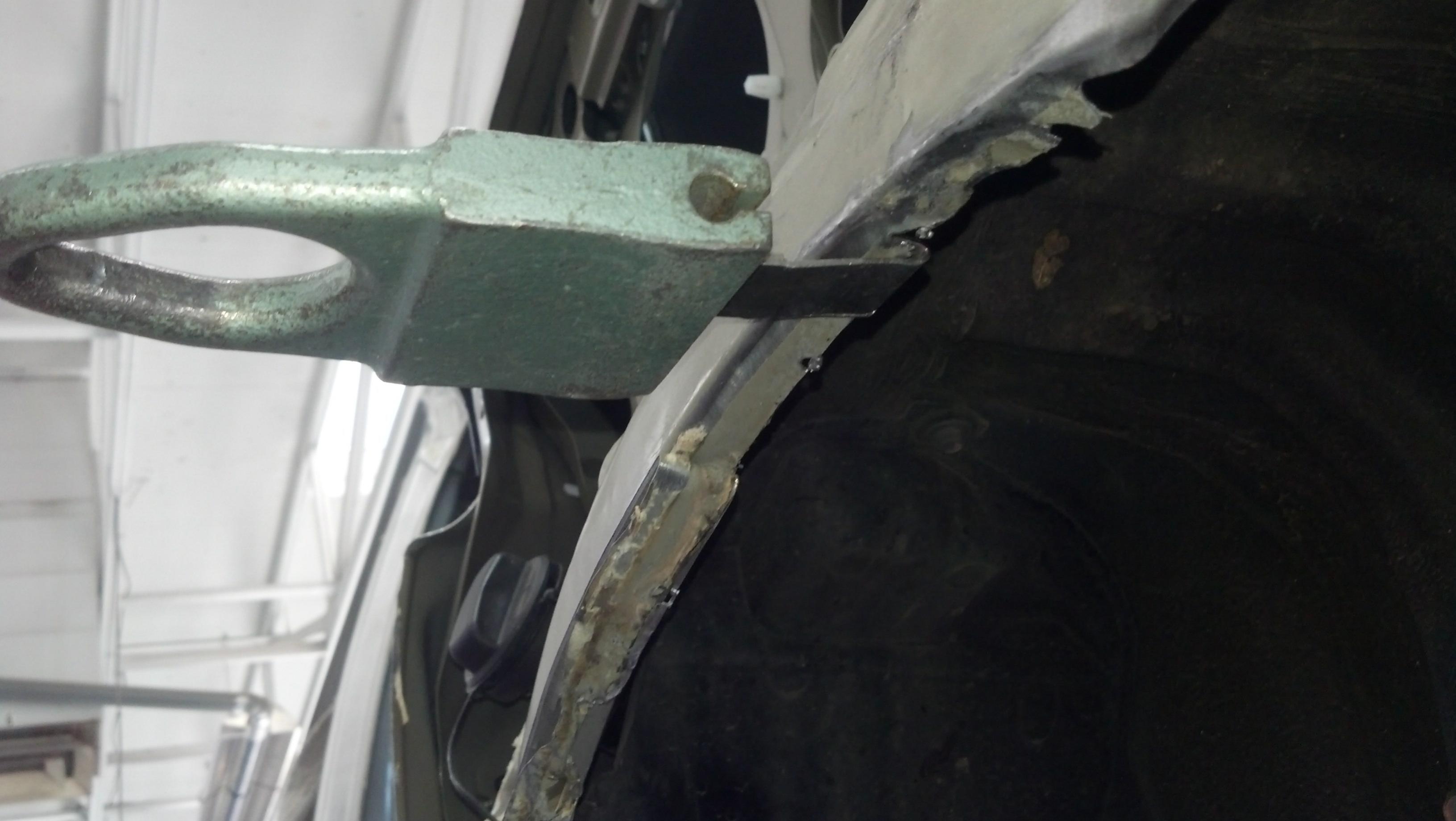

  30. crazy_tonguezz
    Posts: 375
    crazy_tonguezz
    from glendale

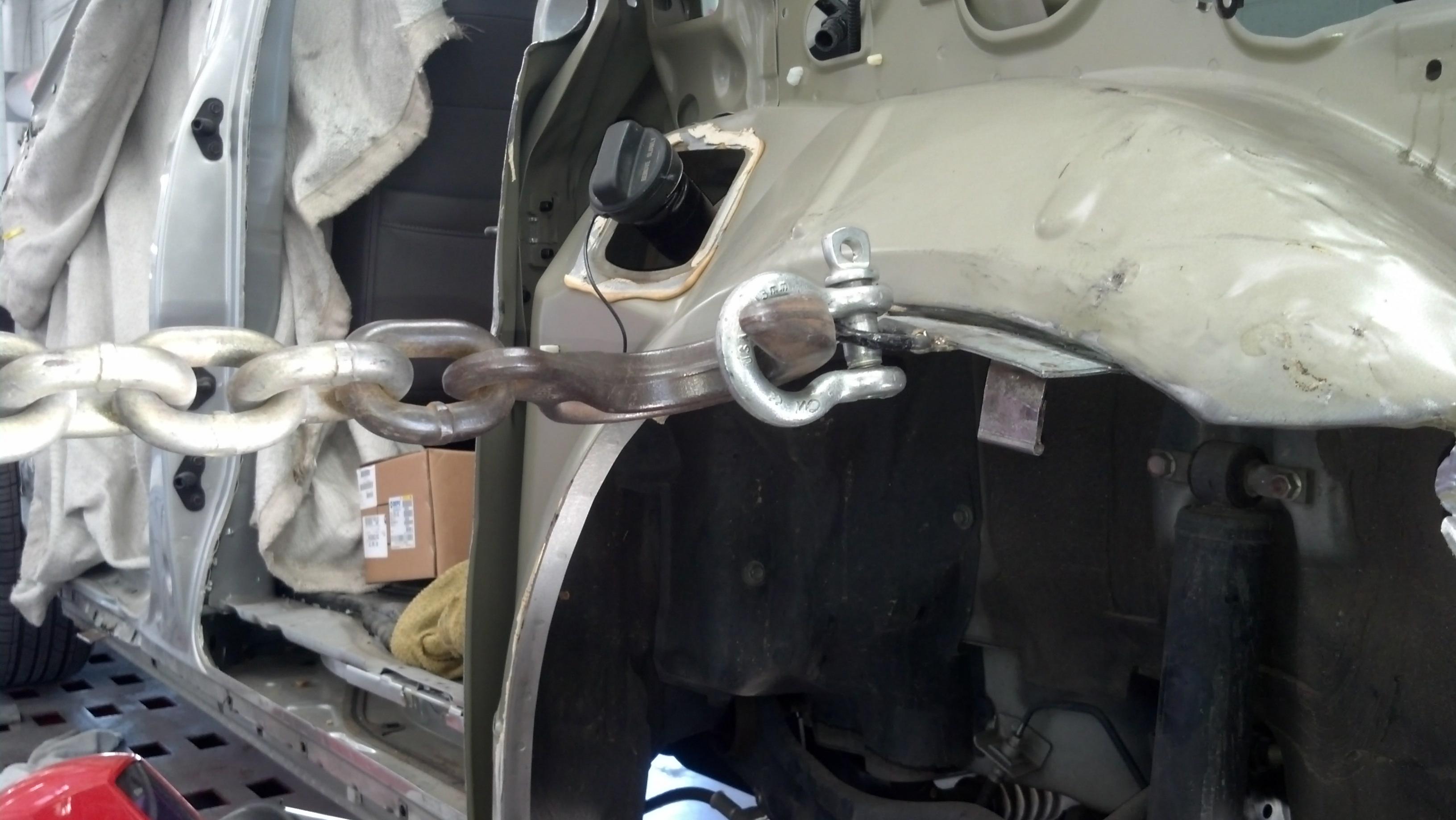

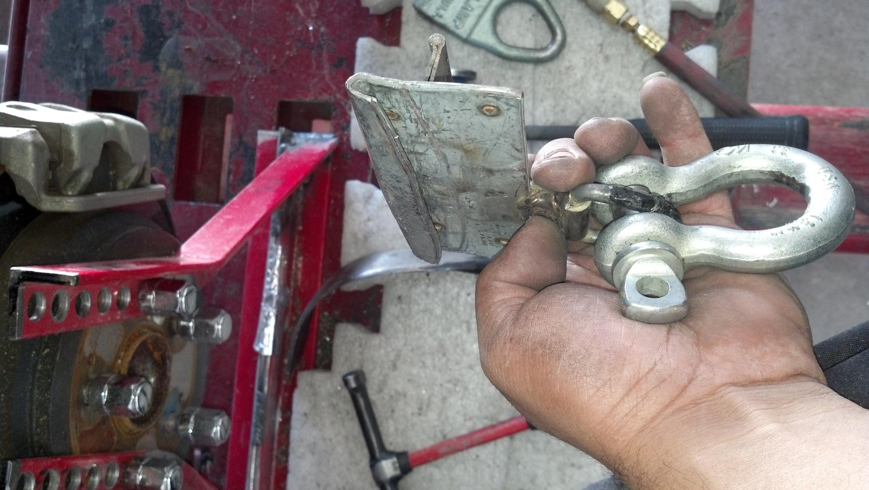

    i also made this tool for when i pull on wheel-wells. This design lets me pull from the inner corner and not the face of the inner wheel-wells.
    Unlike the other tubular style ones that always kink up the inner wheel-well.
    As you can see i also welded a pull tab to the face of it incase im doing a double pull to get a twist out . pulling out and sideways both at once.
    Oh and the wheel stand in the picture i also built from a scrap table i took out the dumpster, I made 3 of those wheel stands. instead of buying them online, which the cheapest i found was 280 a piece. i calculated even if i bought the steel it would still be under 80 to build all 3.
