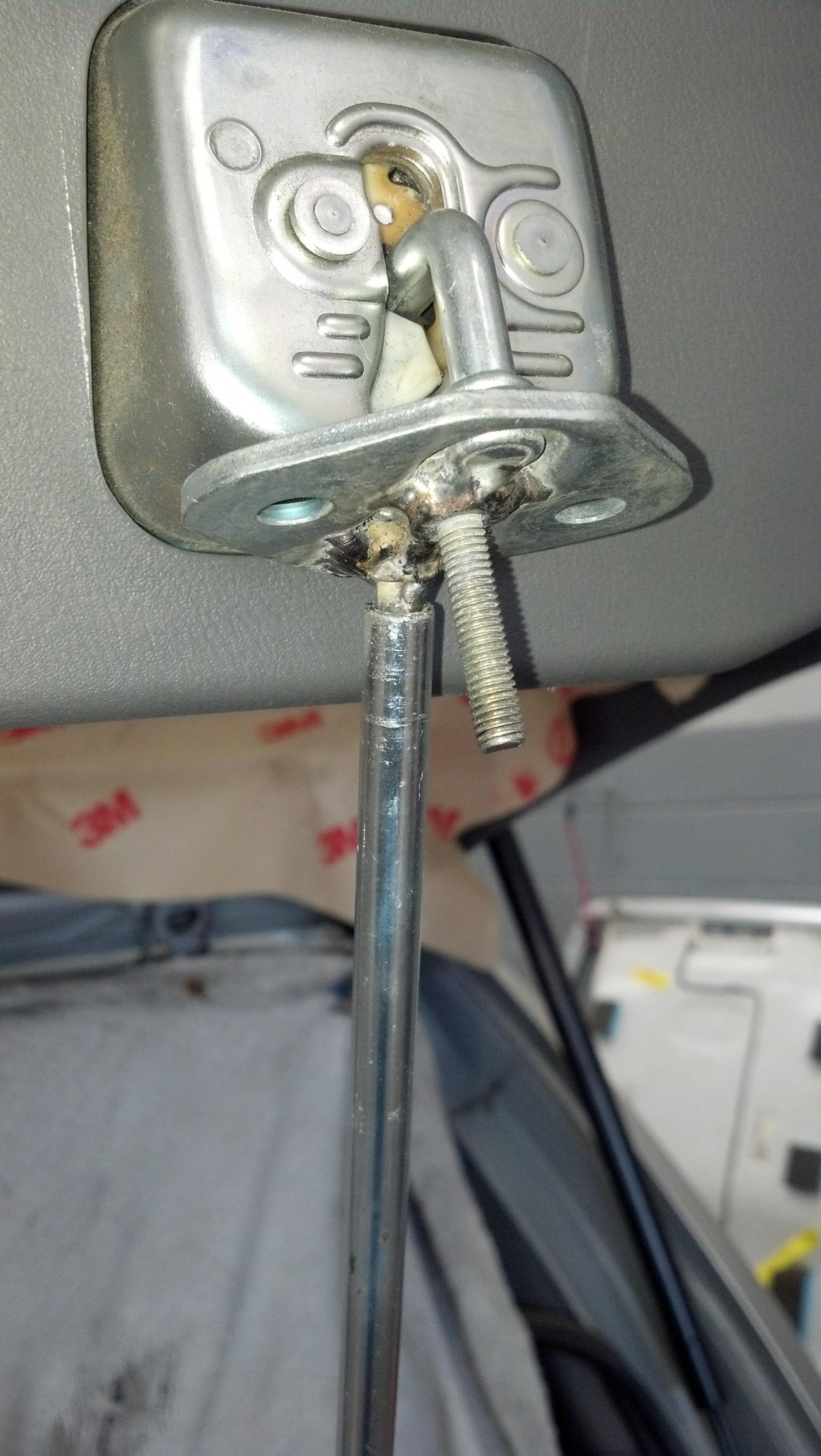

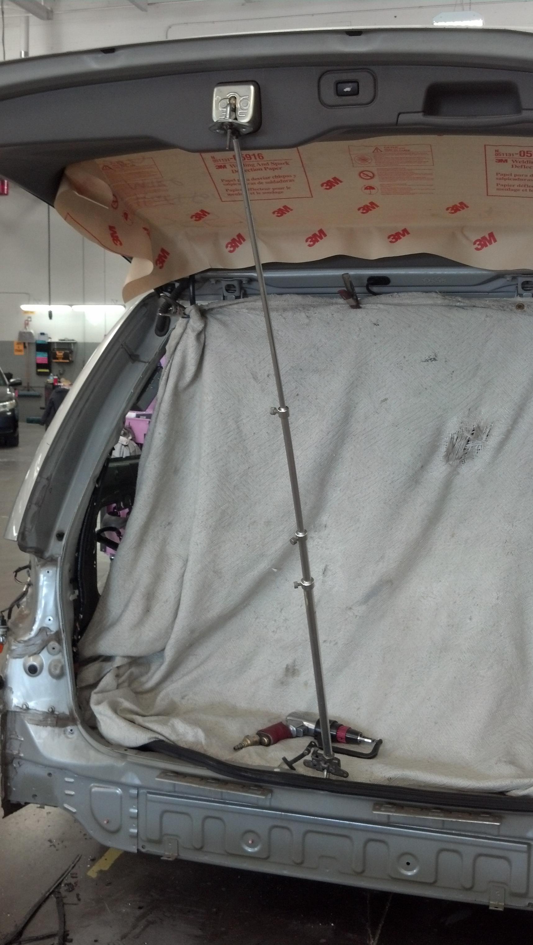

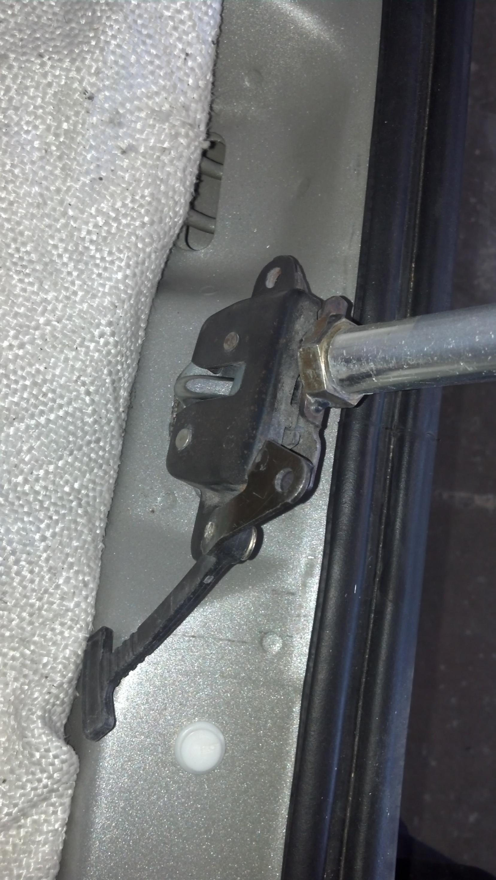

    I use this when i need to keep a lift gate open.and remove the strut to access for drilling, Sectioning and welding.
    I basicly took an old striker and welded two studs on it. one straight out and one angled , so that i had options depending on how the latch was placed on a gate.
    Thel lower part is an old latch with a stud also welded onto it.
    The stud is so i can slide it into my adjustable rod.. Which happens to be an OLD camera stand, i just removed the legs and other fittings. i picked up the camera stand for 2 dollars at a yard sale .

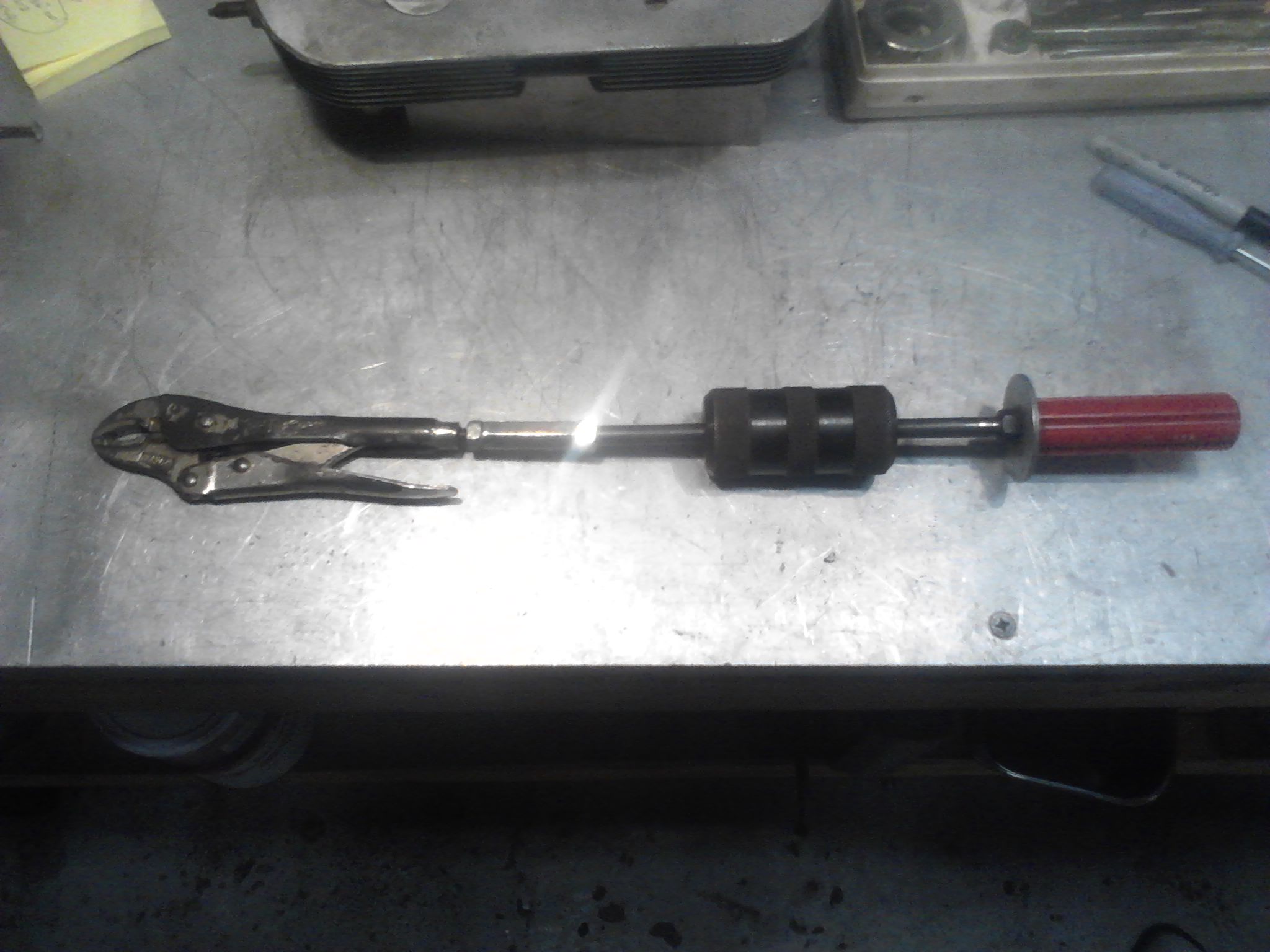

    I mated my slide hammer to a vise grip. The photos should speak for themselves.
