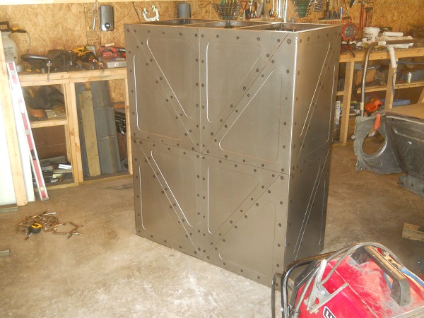

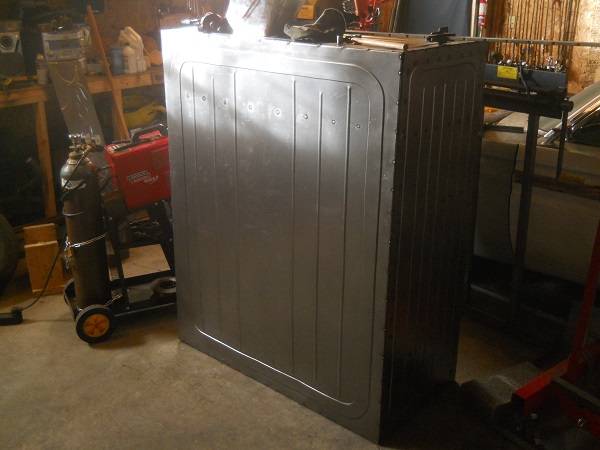

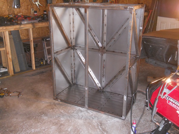

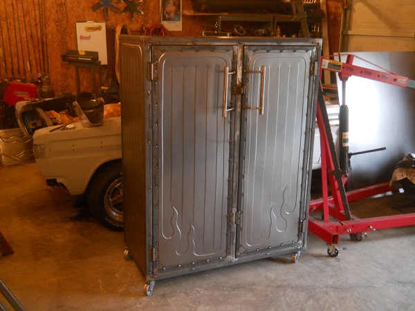

    GearHead - Here's my $0.02. If you're planning to build your own, build it with a wider bite. I've used a cheap HF roller (with modifications) for the last few years. I work in the industrial side of things and build a lot of rigging lockers, large tool storage, etc. for guys as a side hobby. If trying to roll the middle of a large sheet (see pics) you run out of room in a hurry on large panels. As soon as I finish a few items here I plan to rebuild my HF roller with a 36" depth and electric drive.
    Here's a few examples - 2 pics of 2 different projects. The first 2 pics I wanted to roll towards the center of the back panel but couldn't, as is obvious. The last 2 pics are of a different design that would've been easier with a deeper bite.
    And for clarification - guys give me the size of what they need and the rest is kind of my own "interpretation" so nothing is set in stone.

    That cabinet is awesome!!!

    Me too, please

    Dude! There is no way you have time to build cars!

    /\ /\ /\ /\ x2 - those panels look as good as ones done in a press! I dig the flames on the cabinet doors as well.

    Just a hobby on the side guys - plus it puts a little money in the "hot rod fund." And there's always time to build cars.

    Dan, that cabinet is awesome!

    Big dan, those are awesome!
    Could you give a ball-park price on that one as an example? Thanks!

    I keep it simple. Materials x 2. Then I get to experiment and see what I can come up with.

    Wow, that seems extremely reasonable- almost too cheap for such nice creativity and work!
    Granted, I don't know the exact $$ for the material, but comparing it to some other stock I can get an idea.
    Thanks for the quick reply and keep posting!

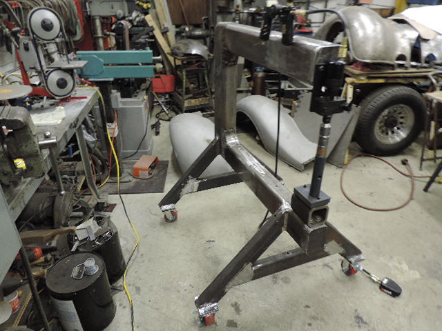

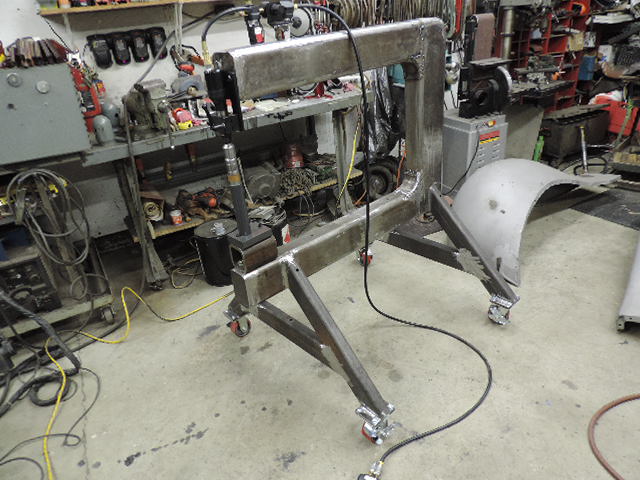

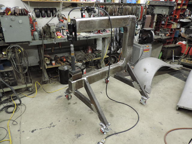

    Ben building a new planishing hammer 39 in throat depth 23 height Kent White Motor, holder, die receiver & master die set. Frame is 1/2 in wall s**** I had sitting around.
