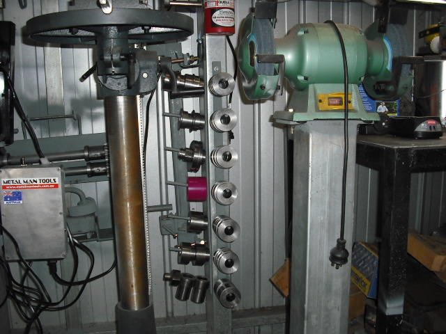

    Great work! What type of dies do you use to do the flames? I ***ume they are stepping dies, but how do you get the tight points on the tip of the flames? I currently have an old Pexto roller with a set of beading dies, but hope to make some more dies for it soon.
  2. Thanks Mtw fdu,
    I figured that the dies had to be pretty thin to get the fine points at the ends of the flames. Lazze makes it look so easy!
    I'll have to see what my dad has laying around for round stock the next time I visit him, and try to make some new dies for my roller.
  3. No worries...happy to help where I can.
    Speaking of dies...here is a pic of the ones I made for my bead roller.
    Mtw fdu.
  4. Nice! My dad has a lathe and I will be checking out his metal stock when I visit this week. ;) Just not sure how to get keyways cut in the dies, might have to take the dies to a machine shop after I make them. Do you need to use any particular type of steel for the dies?
  5. All I have done is used normal bright bar for my dies. I have in the past also harden them. I have also just used them straight from being machined up without hardening them at all and they are fine, I have not had any trouble with rolling beads.
    Mtw fdu.

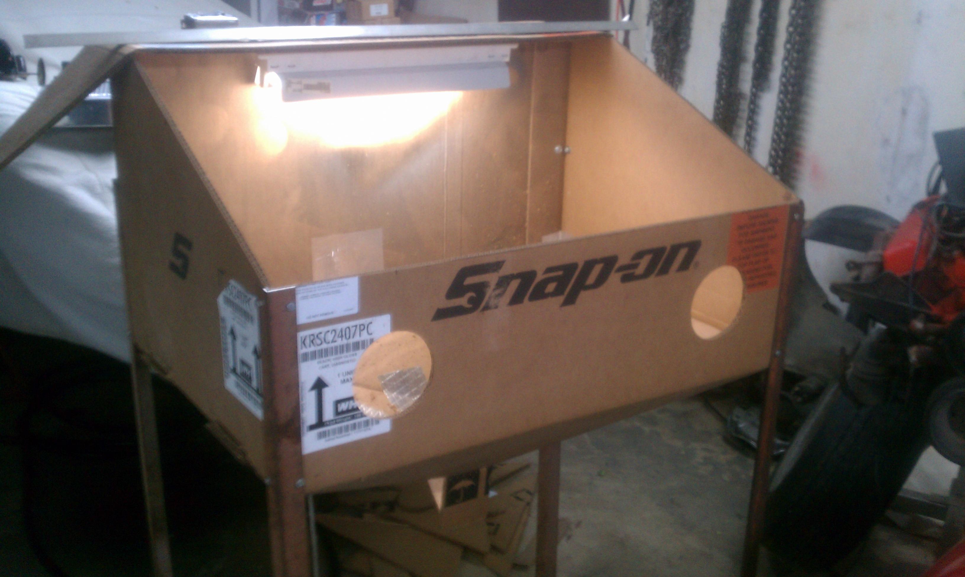

    I purchased one of those HF soda blasters and wanted a cabinet to blast some parts in and sense I shot my wad on the blaster I put together a cabinet out of a cardboard box. I used bed rail frame for the legs had a light out of a cigarette display case some lexan a buddy gave me and hooked up my Kirby vacuum and there you have it.

    Show off! A Snap-On cardboard box! Some of us can only afford HF cardboard. ;)
  10. saltflats
    Joined: Aug 14, 2007
    Posts: 13,572
    saltflats
    from Missouri
    I am just glad I didn't have to buy what came in it.

    Let us know how well the blaster works.....do you think it will sand up......

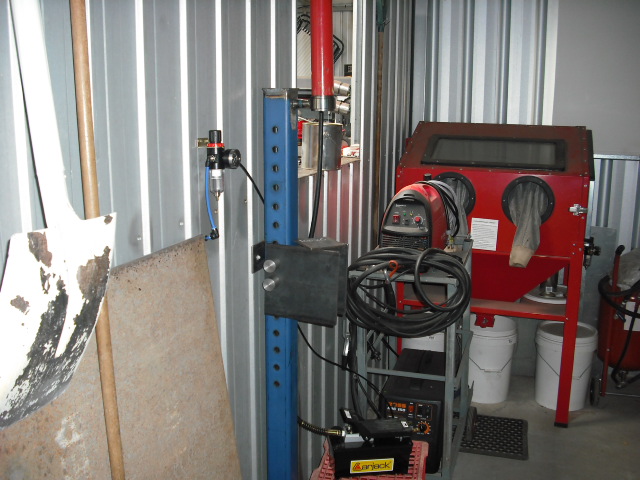

  17. I have 2 sets of keyway broaches (metric and imperial sets) which I use now. I used to use my mill. It was very slow but it worked ok. Back then I didn't do many but now I do them all the time. I made a keyway broach press using a air over hydraulic ram and foot pump. It only take a few seconds to cut a keyway now.
    I actually got the design of it on Youtube and modified it to suit my needs. Here is a pic of it.
    Mtw fdu.

    Got any more pics and info on that home made broach press?
  19. @willo_96
    That is the only pic I have of it. Just to give you some info...I got the ram and air over hydraulic kit from Speedwerx it cost around $1000. I got the bracket kit as well which was $60. I actually got 2 complete sets as I am also changing my louver press to air over hydraulic ram. It has a hydraulic ram from a porta power set up on it now and am changing it over soon...1 of many tools I have made and use frequently.
    The measurements I made to suit myself but you can do anything you like. There is not much to tell otherwise if you can zoom in on the pic above for details.
    Hope this helps.

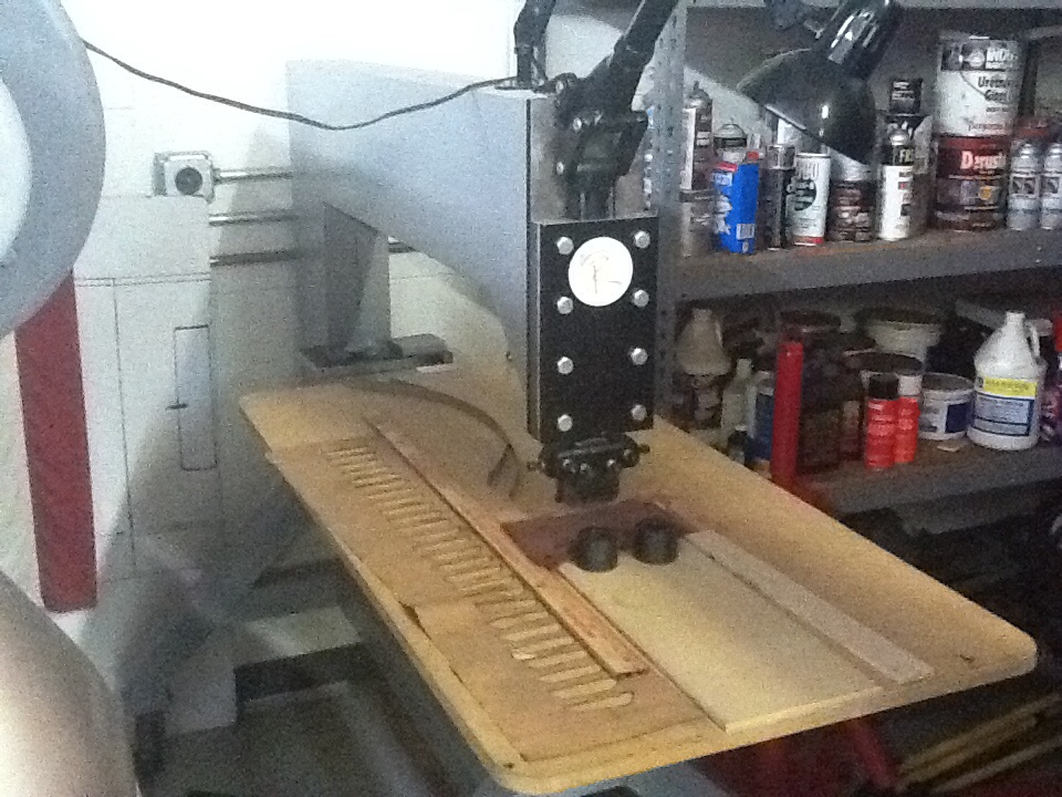

    I built this a few years ago. It can punch 3" and 4" traditional louvers.
    It uses a toggle to exert the force. Very easy to use. I have punched hundreds of louvers with it. It is large enough to put a '40 Ford hood in it.
    All was designed and fabricated by me including the dies.

  24. I have got a 14 inch stroke on the ram I have on my keyway broach press. Saves a lot of time not having to use a piece of bar when the stroke runs out and there is still part of the broach not through enough.
    My louver press has only a depth of 360 mm. I am going to make it able to be turned 90 degrees so I can do longer pieces...just have to find the time at the moment!!
    Here is a pic of it now with a porta power ram on it. I will be putting a ram with a 14 inch stroke and a air over hydraulic foot pump...just will make the job of pressing louvers a lot quicker.
    Mtw fdu.
