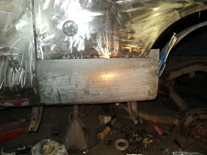

    I use self tapping screws to hold patch panels in place while doing fit ups. It's fast and easy. A strong magnet in the bottom of a fish can holds the srews for easy and quick access...

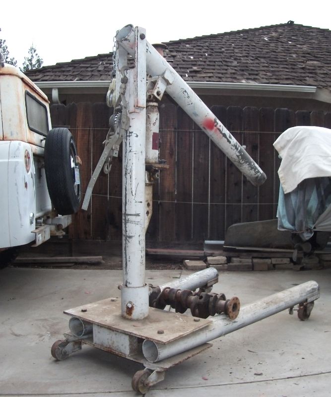

    I built this engine hoist for my dad when I was 17.
    He was tired of renting them. ;)
    (The rusty mopar 218 crank is just lying there for scale. :D )
    Hoisting the engine off my boat:
    All the steel was gratis, a gift of the US Taxpayer. (It was military surplus) so I built this thing pretty stout & it weighs like 300 lbs. The steel flat plates and the stub pipe are 1/2 thick. That was the first time I'd welded anything over 1/4" thick, and it was a challenge. It has a couple real ugly welds on it, but overall it's pretty good.

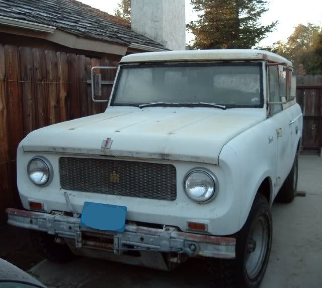

    In 1973 we extended the legs, mast and boom another 3 feet+ each, by telescoping them and adding some big set screws. Then we lifted the body off of this scout (sans hood and doors.) We did a second one & swapped the bodies, so this has a '63 ch***is with '67 4-cyl engine and '67 V-8 body.
    After 42 years the jack is leaking, and currently runs on 50 wt oil instead of 10 wt. Works OK, but you must lift the pump slowly for the thick oil. Eventually I'll rebuild the jack.

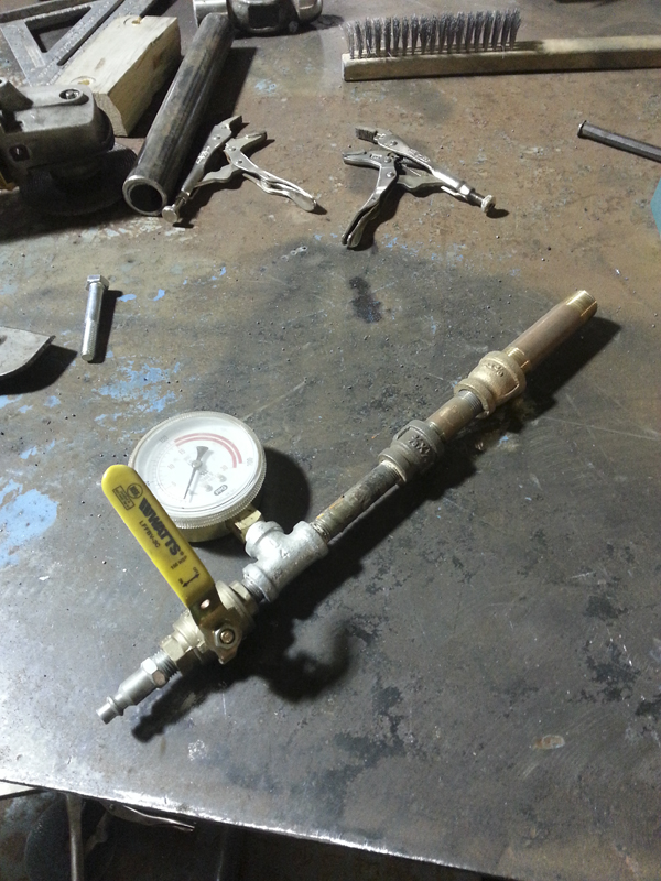

    Pictures of my tank tester, for pressurizing tanks to check for leaks. Took a old low pressure gauge off a oxygen regulator, the big one with a fitting welded into the cap is for testing bulk tanks.

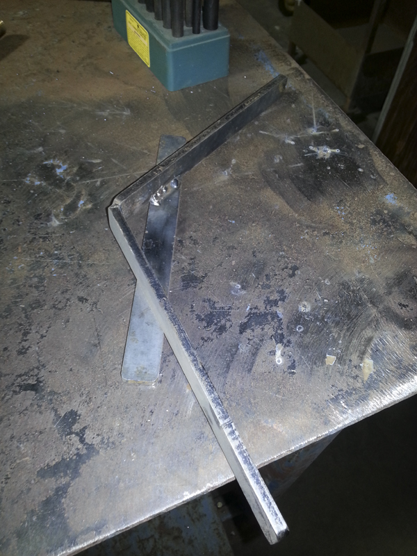

    The angle piece is for spacing when I need to make a stand with 3 legs.
