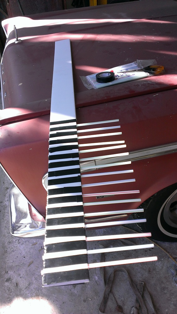

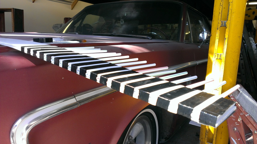

    Contour gauge. Cheep, easy to handle, easy to make. Sign board straws and black tape. Inspired by another thread.
    Straws can be lengthen by sliding two together one inside the other. This one is four ft. long. Attach two for eight feet.

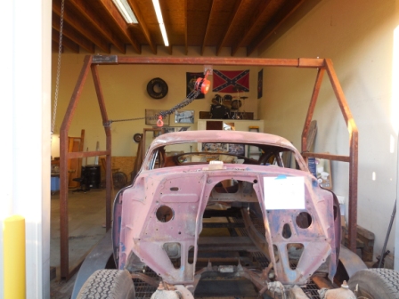

  14. I will put up pictures this weekend of my "Swingset" I designed this swingset to separate bodies from frames on my own. Nothing new there except mine is portable and has no angle braces getting in the way when lifting and the biggest deal I like is it has 1/8" beam deflection at 2 ton. It does weigh a 1000 lbs. and takes 3 to 4 people to set it up and take it down and 2-8' step ladders. I have set it up on the ground before and then rotated it to a standing position(it took 3 of us and it took everything we had to rotate it). Did I mention it is 10' tall 6' deep and 12' wide, each side section is about 300 lbs give or take 50 lbs or so and the top is about 150 lbs give or take 30 lbs or so, bottom is 150 lbs give or take. I built it in tech school and the professors and engineers wouldn't let me finish adding the gussets at the center drop down plate, which would of made it be able to hold up to 8 ton. Right now it is rated to hold 4 ton with no gussets. Every piece of steel is quarter inch thick and is either 4" square or 5" square. It is handy to have when you got to lift something in the field and set it on a trailer. I have to design a trailer to haul it with maybe make it where it is set up on the trailer then have it be able to slide backwards to lift the object then slide forward to set the object down on the trailer. Wow after all that I need a beer. The trailer idea came to mind while I was typing this.
  15. Here are a couple pictures of the swingset, like I said simple in design, m***ive in abilities

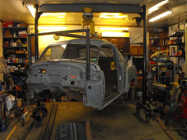

    ]My gantry hoist, electric hoist on trolly, Serious swivel castors, could`nt live without now.

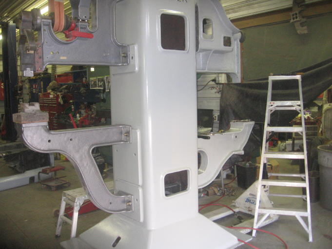

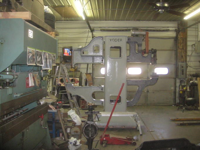

    Wingnut Dan is building a Yoder clone, a 1920-40's style power hammer for shaping sheet metal. 90 series machine if I remember my Yoder model numbers.

    That is a Yoder 90 on one side and a P-2 pettingell on the other . The yoder is a 120lb hammer and the P-2 is a 90lb one .

    I haven't talked to them in a while, I think they have Jimmy's to copy from and any mods he came up with. I am going to miss the rarest of all Yoder equipment.
    The yoder TC (trash can)
    Btw I was thinking that looked like a Pettingell but lacks the ram safety guard. You probably won't need it, that was something operators added so the ram doesn't kill them, like many of the Little Giant B/S hammer had a catcher for the spring.
